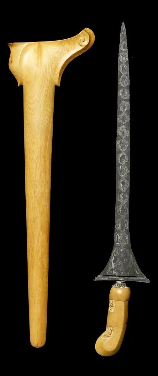

I couldn't resist placing an bid on this keris sepang and won it for the opening bid. No sheath and the quality is nothing too great, but these seem to be a fairly rare dhapur and it seemed worth picking up for the price. I'd be real happy if the hilt turn out to be horn, though i think i see a chipped piece that reveals it as wood.
Feel free to comment, but i would really love to here impressions on the form itself. What ideas do people have on keris sepang?

Could be a keris sepang, but i have some doubts because of the ganja. It should be equal to both sides and it doesn't fit very well. Could be the age,but...
Nice ukiran for sure. I also do believe it is a wooden one.

Henk, i am pretty sure the gonjo fit has to do with age. As for the equality issue, i have seen all kinds os variations on the degree of equality. If not a keris sepang, what would you call it?

good buy indeed, only the handle is worth the given price. Hope you will post better pictures when you have received the keris. Have seen it as well but was unsure about the blade and still have enough restauration projects.

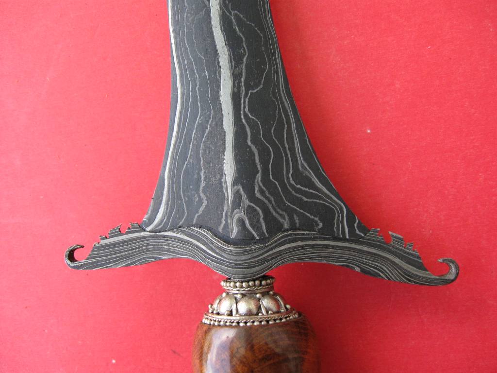

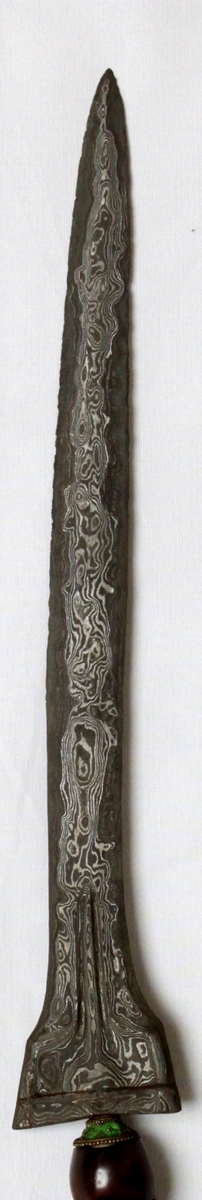

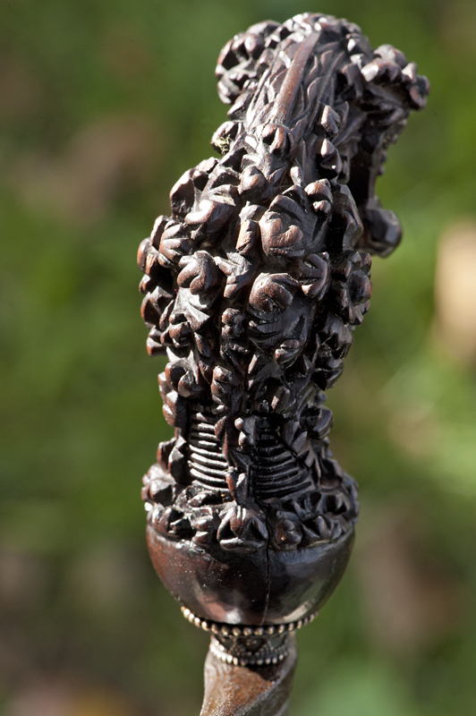

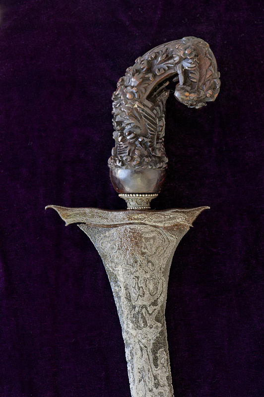

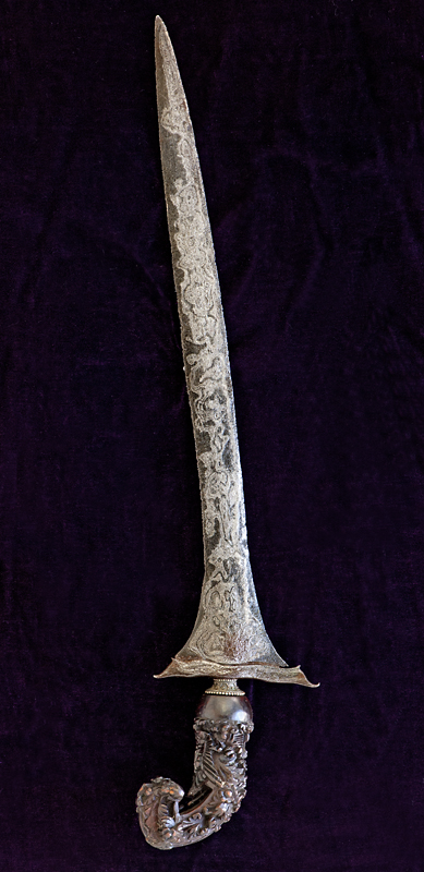

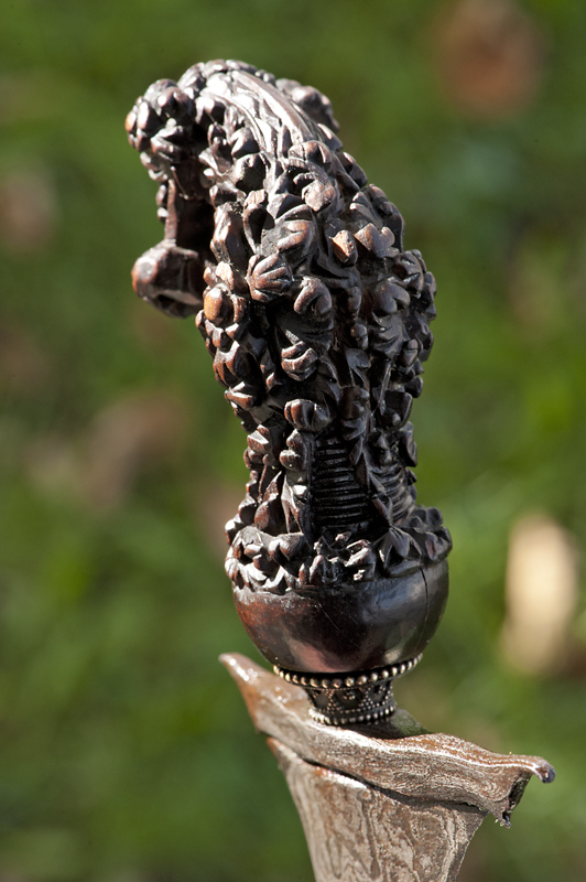

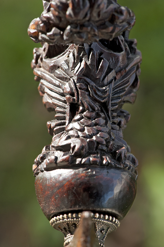

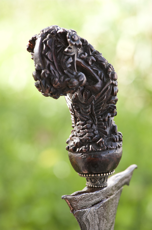

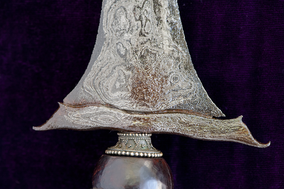

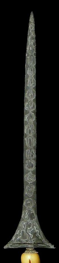

In the interest of re-sparking the conversation here are some shot of this one i just received. I spruced it up as best i could, but it seems obvious that it will need the full treatment to eliminate remaining rust.

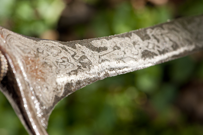

I think it is clear in these photos that this is the original gonjo. The iron and pamor are identical. I am also intrigued by a line of brighter high contrast pamor that appears along the edge when the blade is held at an angle. It isn't easy to photograph, but i think you will be able to see what i mean in at least one of these photos.
So, any thoughts on the sepang dhapur in general or this keris in particular?
Old 7th October 2012, 01:05 AM   #8
Posts: 7,193
Looks a better quality piece in these shots.
If this keris were mine, I probably would not restain it, its acceptable as it is in my book. I'd certainly WD40 it, good long soak and then carefully work over it to remove as much of that surface rust as possible. Good scrub with a stiff brush and hot soapy water to start with. You can get into the grooves and hollows with fine steel wool wrapped around a sate stick --- bambu skewer.
I do not believe in cleaning and restaining a blade simply because it is slightly less than immaculate, the less you can clean a keris the better off you are. Even when a blade is heavily rusted its possibly not a good idea to try to get it 100% perfect with the first clean. I'll usually come back to a very badly rusted blade several times over several years, especially so if it is a quality blade.
Old 7th October 2012, 03:16 AM   #9
Posts: 7,285

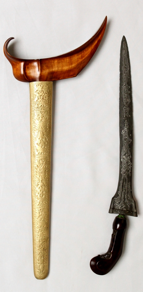

Thanks Alan...yes, i also think it turned out to be a somewhat better keris than the auction photos showed. I agree about not restaining if i can get rid of the existing rust residue without removing much of the existing stain. As i stated, i only gave this a quick sprucing up to get a better idea of what i had bought and get some pictures done. It only had a fairly quick working over with WD-40 a toothbrush and then some fine steel wool.
Do you have any thoughts on that line of brighter pamor. Only shows super bright at about a 45º angle. You can see it best in photo #3.
Old 7th October 2012, 11:37 AM   #10
Posts: 7,193
I'm not at all sure of what I can see David, but whatever did cause this uneven distribution of contrasting material it was simply some sort of lack of control in process.
Old 7th October 2012, 02:27 PM   #11
Hello David & Alan,
from the pics, it looks like a grinding mark to me?
Old 7th October 2012, 03:27 PM   #12
Posts: 7,285
Originally Posted by kai
Hello David & Alan,
I thought that at first as well Kai, and that just might be, but it reacts really differently from the rest of the pamor and seems to be of a higher contrast material than the rest. As Alan points out, it does seem rather uncontrolled...

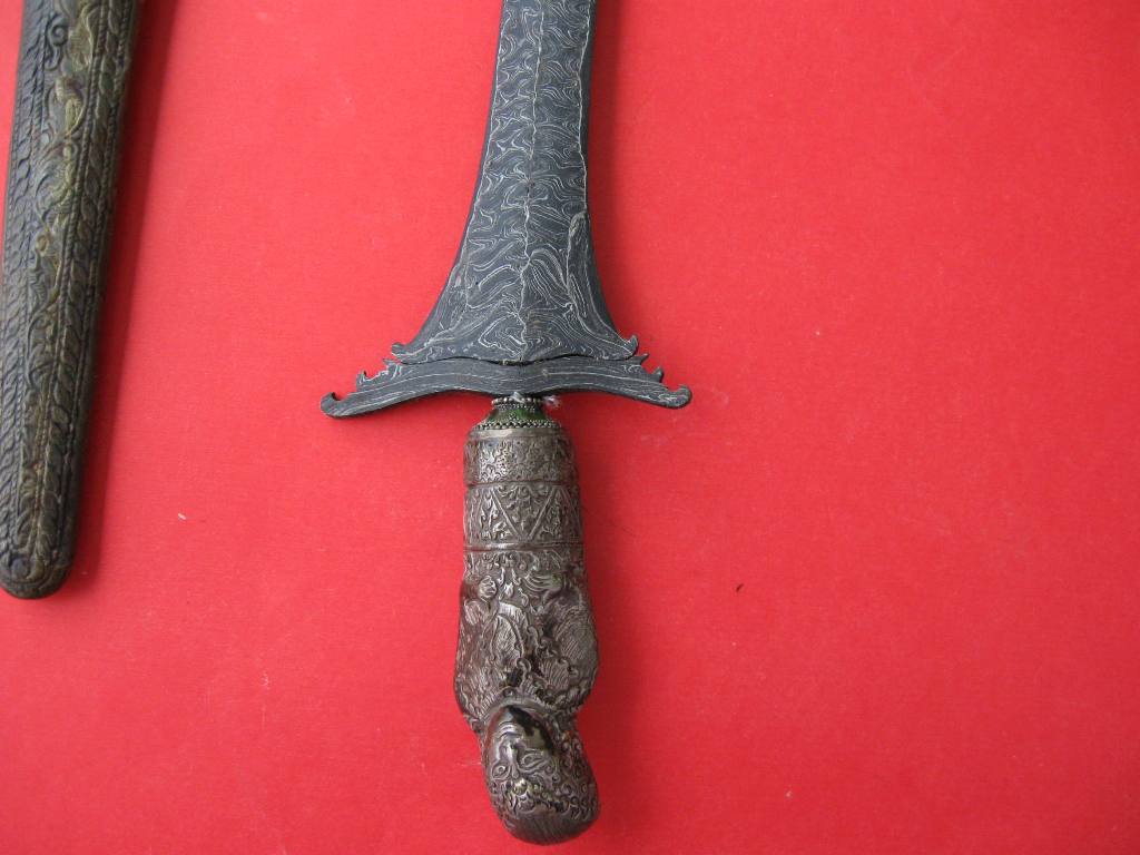

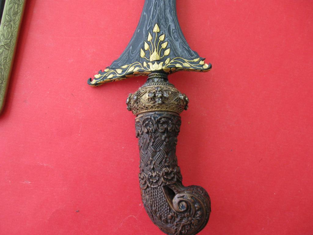

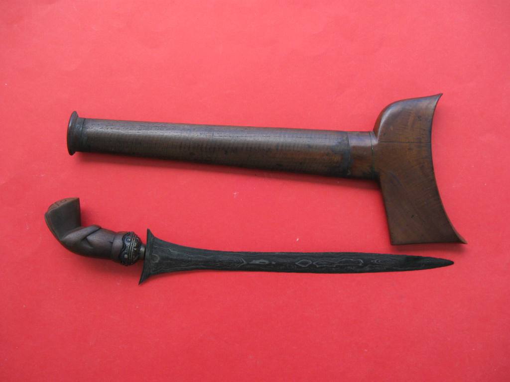

Naga Sasra
Naga Sasra's Avatar
Location: Boca Raton, Florida, USA
Posts: 108
Arrow

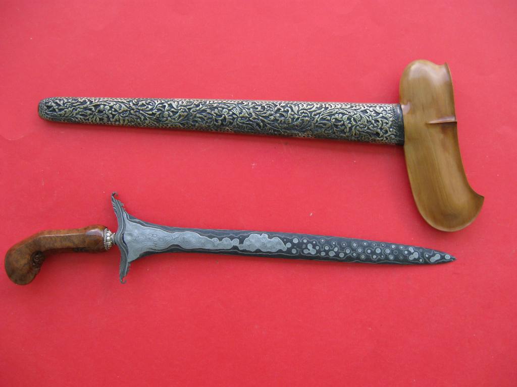

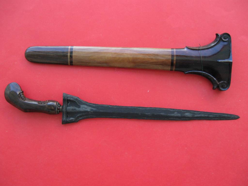

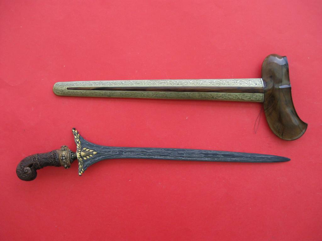

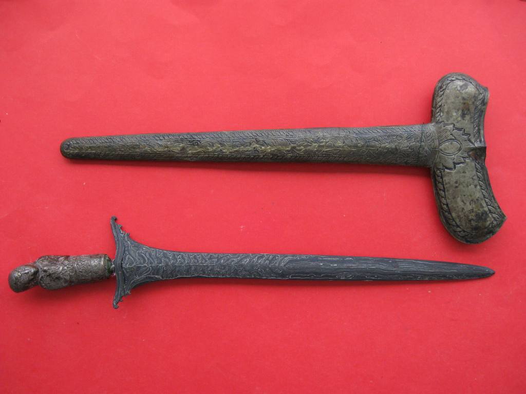

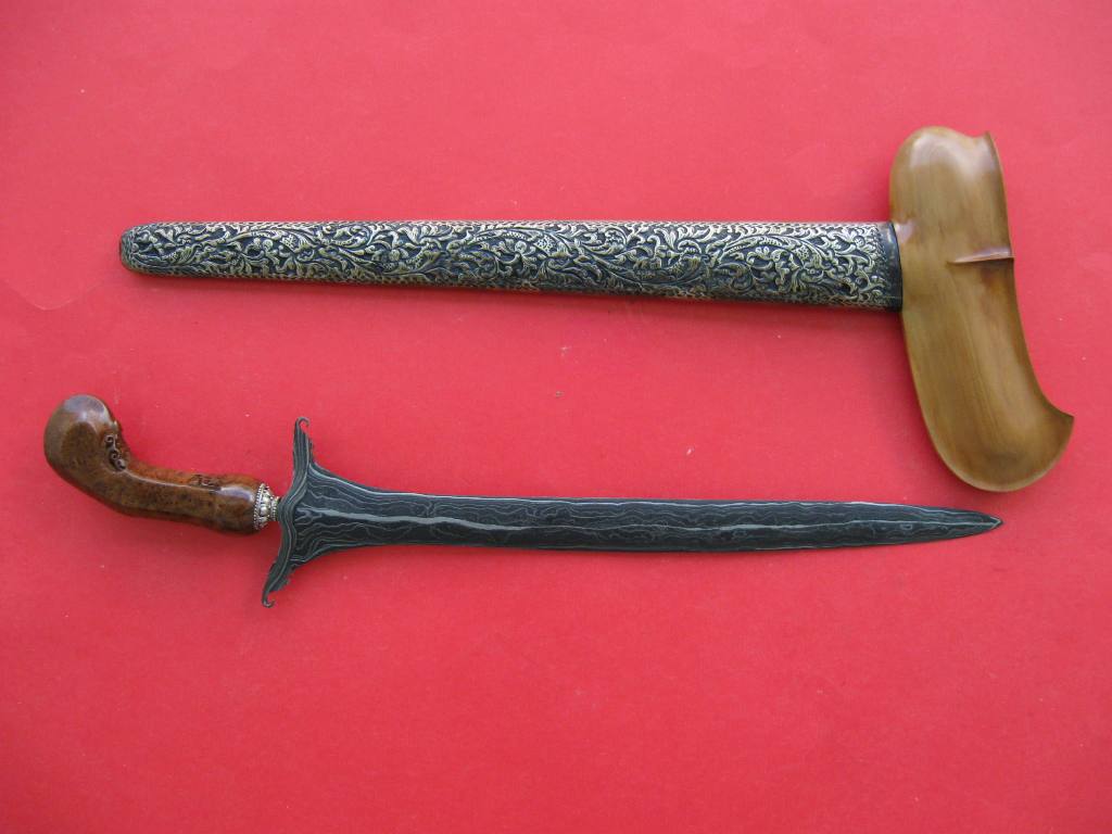

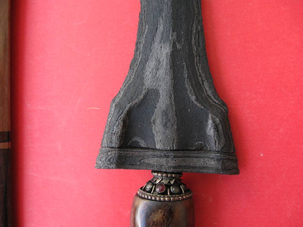

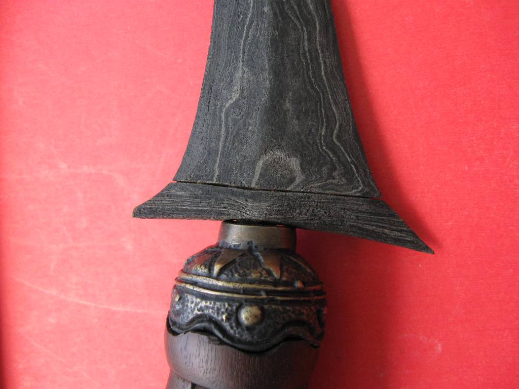

Okay David, I will attemps to be the "anybody" here Attached five pieces from various area's that with one exception would qualify as the dapur Sepang

Old 14th October 2012, 12:18 PM   #15
Jean
Join Date: Jun 2009
Posts: 1,740
Hello Naga Sasra,
According to the EK (but not the book Dhapur), the kris shown on your first and last pictures has a dapur Regol (with twin gandik). I attach the pictures of a similar kris from my collection, and of my only kris with dapur Sepang.
David, sorry I have no information about the origin of this dapur, I consider it as just a variant symmetrical dapur like dapur Regol or Karna Tinanding. There is another variation of dapur Sepang with a gandik as indicated in the EK and shown in the book Dhapur.
