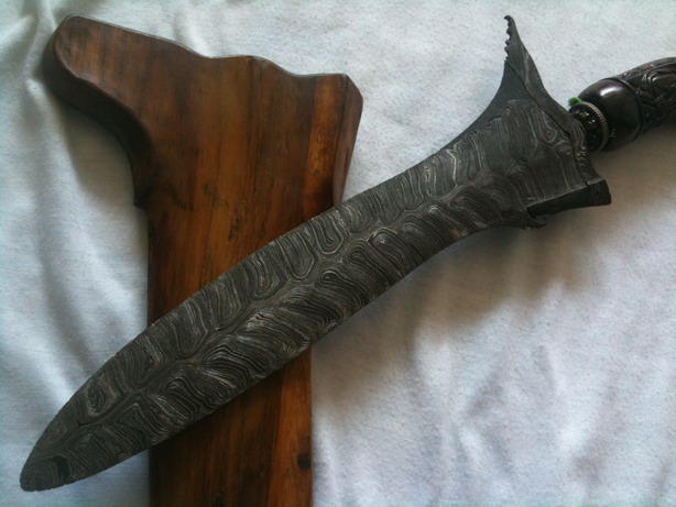

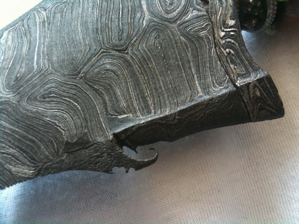

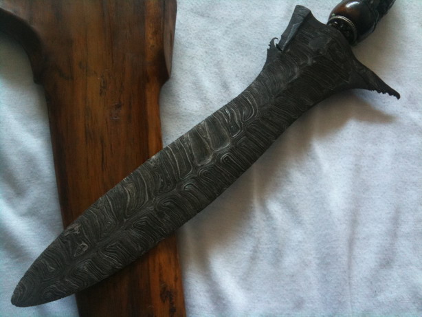

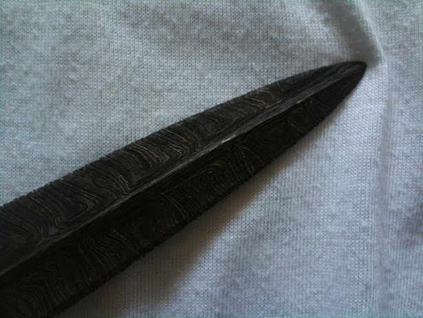

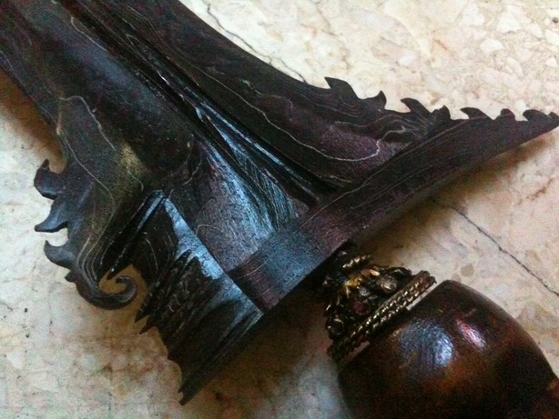

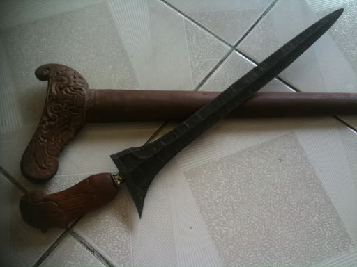

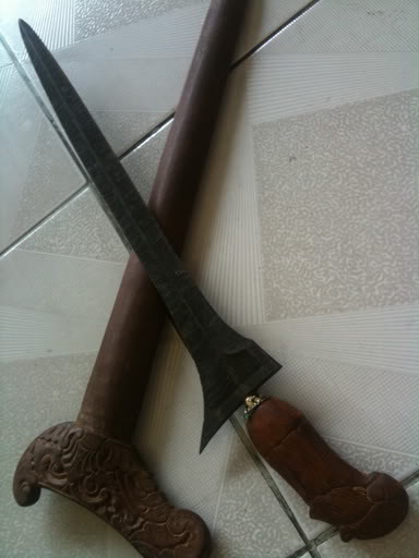

Hi all

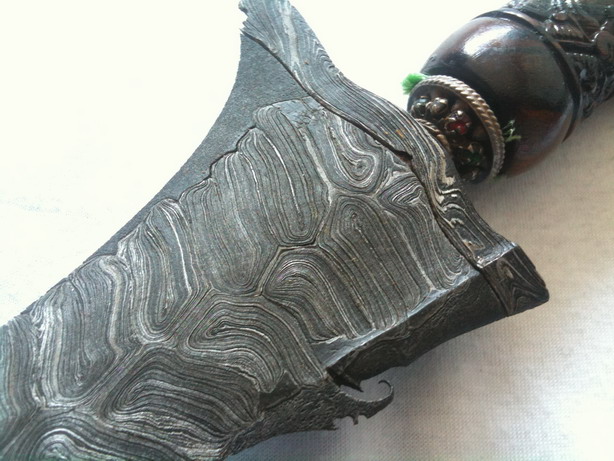

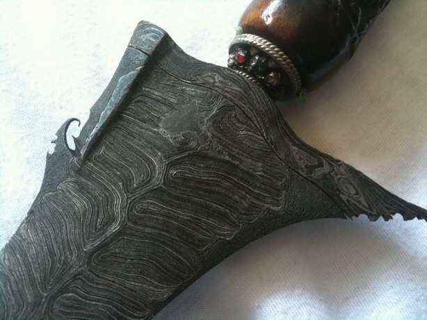

in spirit of sharing knowledge, here it is another keris of mine.
This keris is simple. What makes it nice is the pamor
I believe this dhapur is known as Jalak Ngore (CMIIW), and this one is not stained properly due to poor storage before
this one has "Unthuk Banyu / Unthuk Segara" pamor
Unthuk banyu means = froth / foam of water / sea water
it is believed this pamor will help in terms of relationship with others
this pamor is unique, apart from it is rarely seen, this kind of pamor along with time and maintenance, the different metal will corrode differently, and producing saw-like edges (can be seen in the pictures)
the "wood" powder you see in the pictures is sandalwood powder
about the age ... say this one has been someone's family heirloom for 30 years, so at least it is 30 years old

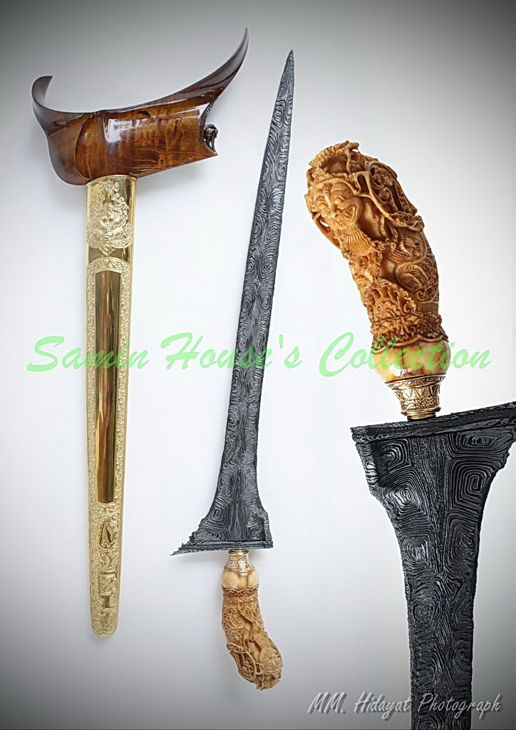

first, I have to borrow one pictures of friend of mine in Indonesian forum about similar keris, but thought to be made in 18th century, courtesy of Mr. Hidayat - so comparison can be made
pardon my pics as I took it using iphone
enjoy!!
regards
Donny

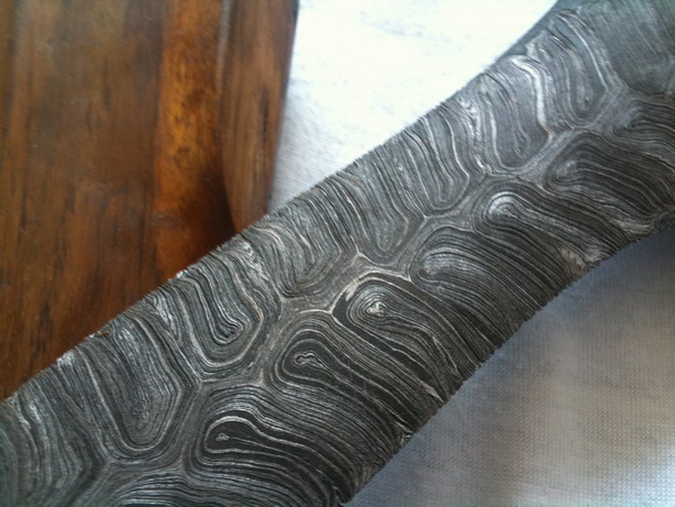

Fascinating pamor. Is the this recently made stuff?
Old 18th September 2012, 01:16 AM   #3
Posts: 6,414
Looks like two different pamors to me, first one looks like balls of string ; yes, the second example's style has been done in recent times .
Both are not unknown in newer keris .

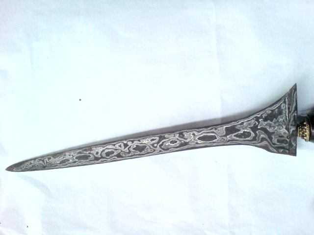

Not sure just how much comparison can be made. I agree with Rick, these are not the same pamor patterns. Also agree that Donny's is current era.
Hard to say solely from photos of Mr. Hidayat's example. Lovely current era dress, but i am afraid i don't know how to spot a well made and expertly aged modern piece from the real thing strictly from a couple of photos. While complex pamors of this sort are known to have existed in older blades, well preserved examples such as this are few and far between. It (Mr. Hidayat's) is a beautiful keris regardless.
I believe so
newly made (kamardikan) in terms of keris could mean somewhere between 0 - 67 years

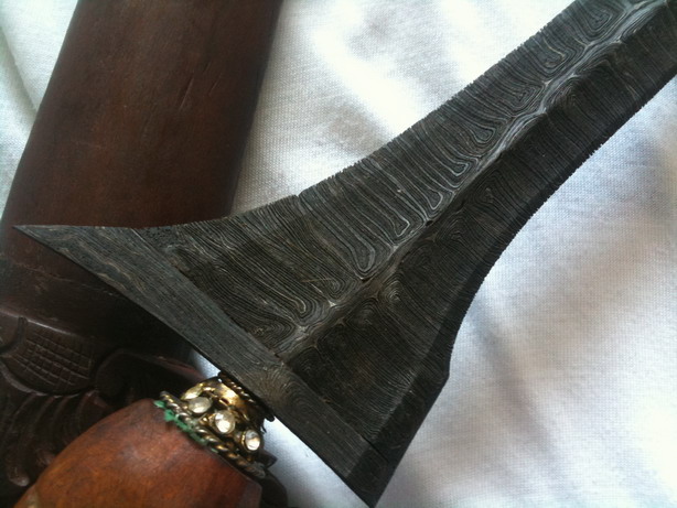

I agree with you, as with books I attached below, the unthuk banyu pamor is confined within the blade, and in mine, it is becoming parts of the cutting edge.
you mean that the pamor, which like )))((( is the 1st pamor
and the spine consists of another ??
if so, what pamor do you think this keris is ??
if you see this example, http://agenbiteofinwit.com/keris2.html
and according to couple friend of mine, my keris above still categorised as unthuk banyu pamor
but I am agree that there are differences between both blades. Therefore, what pamor do you think it is ??

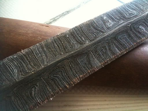

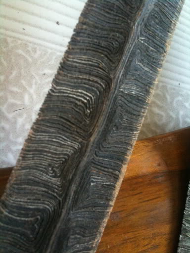

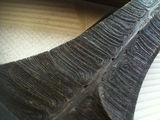

here's more pics and also a page from my book explaining about pamor unthuk banyu

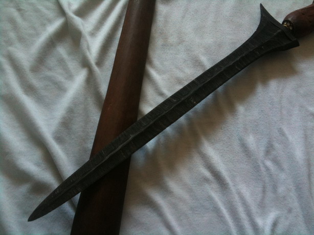

continuing the story ...
this particular keris comes in pair ... there's another one in different dhapur but with the same types of pamor when I bought it
perhaps the previous owner needs popularity so bad as this type of pamor is believed to boost in relationships and popularity
pictures will be posted, soon
satsujinken is offline   Reply With Quote
Your pamor does seem to be closer to the one in the above link.
As to what pamor to call Mr. Hidayat's keris, i couldn't really say. Personally i don't spend too much time trying to figure out pamor names since they tend to sometimes change from era to era, region to region and even village to village.
yeah, I know that
but in light of education, I personally tend to use familiar terms in books rather than following local dialects

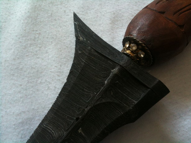

now this is another keris, which comes with the jalak keris and definitely kamardikan (according to me)
any comment is welcome

From a bladesmith's point of view those two different pamor are quite wonderful. The first one is more difficult to forge than the second.
Well worth stealing those for my own work.
Thank you for posting them.

Perhaps Donny, but i thought we were all in agreement that these examples are made by modern smiths...

I don't think Hidayat's keris is recent David, I've only ever seen old examples of this pamor, also the style of the blade is an old style. I've got an example of this myself.
Old 20th September 2012, 05:42 PM   #13
Posts: 7,284
Thanks Alan. I wasn't making any serious challenge of this keris in regards to age, merely commenting that my ability to be able to judge the difference between an actual old example of this pamor and a newly made and expertly aged example solely based upon this photograph is basically nil. And it is a beauty regardless. A very intriguing and complex pamor in beautiful dress. In my comment above i was really referring to all the other examples shown which still seem to me to be a completely different pamor pattern than Hidayat's keris

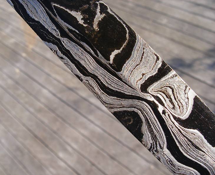

Here's a portion of a what I suspect is an uncontrolled pamor on a Wilah attributed to Pak Budi .
The black Iron has a couple of shades that I could not bring up with my limited image manipulation skills .

Pamor colour depends on four things:-
1)--- material
2)--- the skill of the person doing the stain
3)--- the materials available to carry out the stain job
4)--- the weather
these four factors provide the answer to every variation noted in the colour of stained blades
1)--- material
4)--- the weather
CMIIW, as I am a newbie in this field, but as far as I know, balinese tend to stain their blade blacker than javanese keris ? my friend here named the style of staining of balinese keris as dongsalibing
the final result is the balinese keris is much darker and smoother than its javanese counterparts
I may be wrong, as I never encounter this information on any books, but from several friend of mine, who are in this field for couple of decades
look at the comparison below, keris bali first, keris jawa second

Donny, the reason that Balinese blades often appear to be darker than Javanese and other blades is because Balinese blades do not have a textured surface.
The factors that I have listed do cover the reasons for blade colour.
Here is a link to a blade that I made some years ago.
http://www.kerisattosanaji.com/PBXIImaisey2.html
It is a Javanese form, but a Balinese finish. If I had done a textured finish to the surface of this blade it would not appear so dark. However, some Javanese blades even with a textured surface can be pretty dark, its all about the factors that I've listed. Use the "INDEX" tab on the linked page and and you can see recent blades made by other craftsmen working in Surakarta 20 years ago:- some are very black, others are not.
One thing is true:- you cannot alter the colour of the material with which a blade is made. Most older blades are simply impossible to get really black. Really old blades often have pamor that provides contrast by use of high phosphorus and low phosphorus irons, and all you ever get there is dark grey and light grey.
