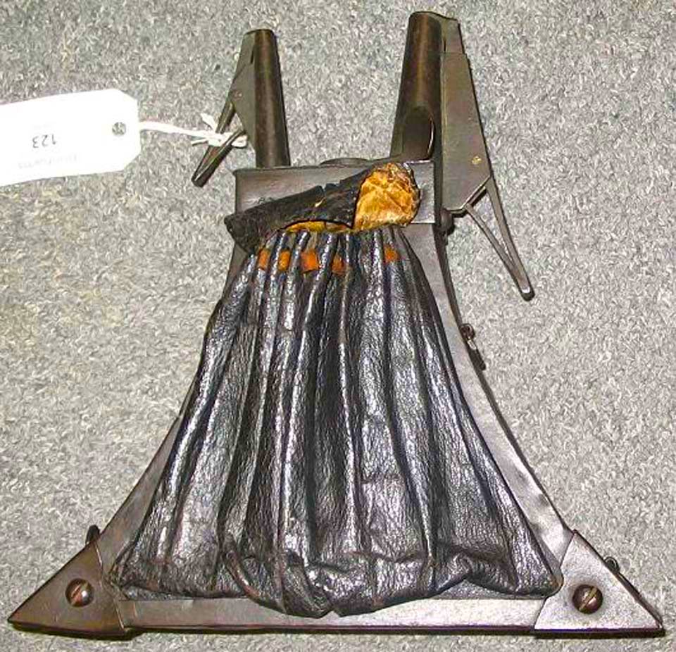

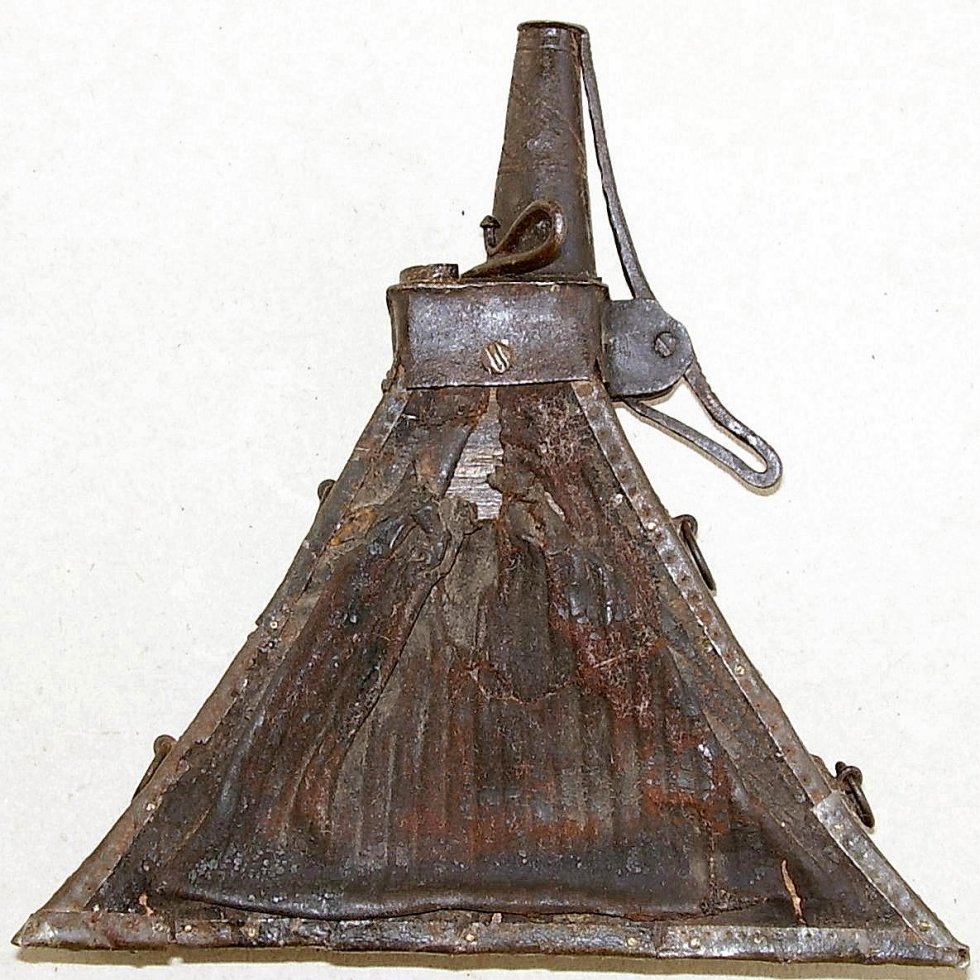

Yet another question. Are the L shaped iron strips on the sides of the flasks held in place with small iron nails or pins? From your photos I can't tell, but some appear that they are.

Hi Yancey,
Actually there are no L-shaped strips.
During the first half of the 16th c., the mounts along the edges are held by either small nails or pins; from the mid 16th c. onward, they are just laid on, fixed by the top and bottom mounts, and four small triangular mounts attached by screws or nails are used to reinfore the lower corners.
