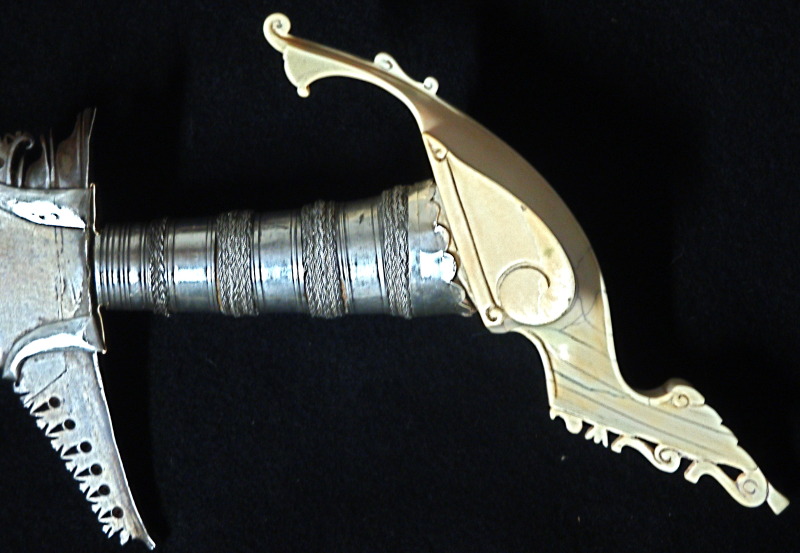

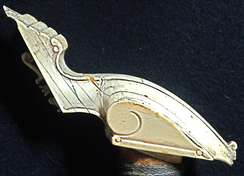

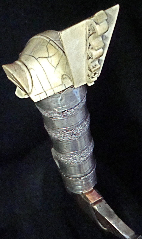

Greetings folks!
I got this back in March at the Louisville Military Show of Shows.
Here are pictures of how it was when I got it. It was missing some of the back tail decor, the nose, and a silver band.

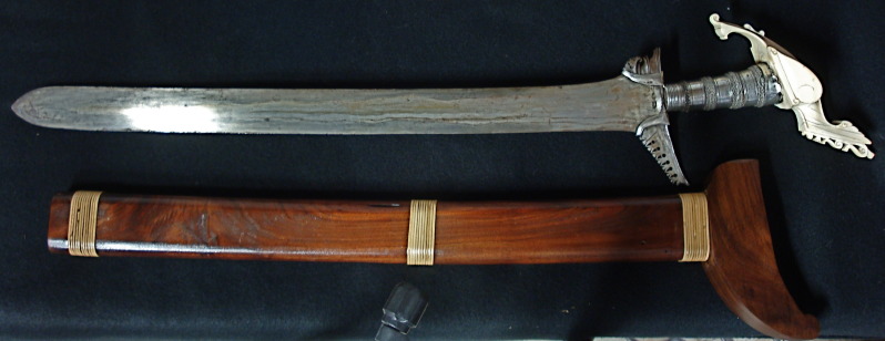

Old 1st August 2012, 07:31 PM   #3
Posts: 7,416

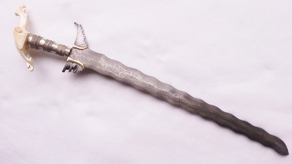

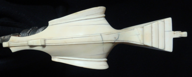

Here are pictures of the fully restored piece. I did the replacement silver band, the scabbard, and took the rust off and etched the blade.
What was amazing is that Maggie, who restores ivory, did the missing ivory parts, and refitted the tail which was poorly glued. She did amazing work!
Enjoy!
Old 1st August 2012, 07:39 PM   #4
ThePepperSkull
Join Date: Aug 2009
Posts: 338
Speechless. That large fissure in the back of the kakatua has completely dissapeared. and the "beak" looks to be incorporated just as seamlessly.
Compliments to you and Maggie.

Beautiful work. What wood did you use for the scabbard?

Posts: 7,416
Thank you folks.
As far as the scabbard is concerned, it is made of stained walnut.
The kakatua pommel is 3 7/8 inches wide and 8 inches long from nose to tail.

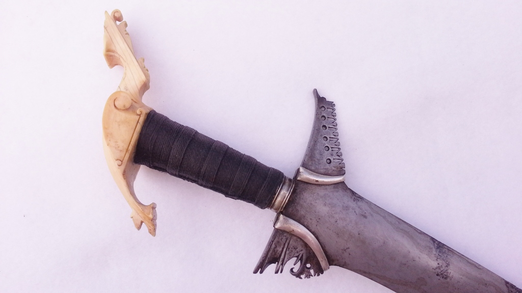

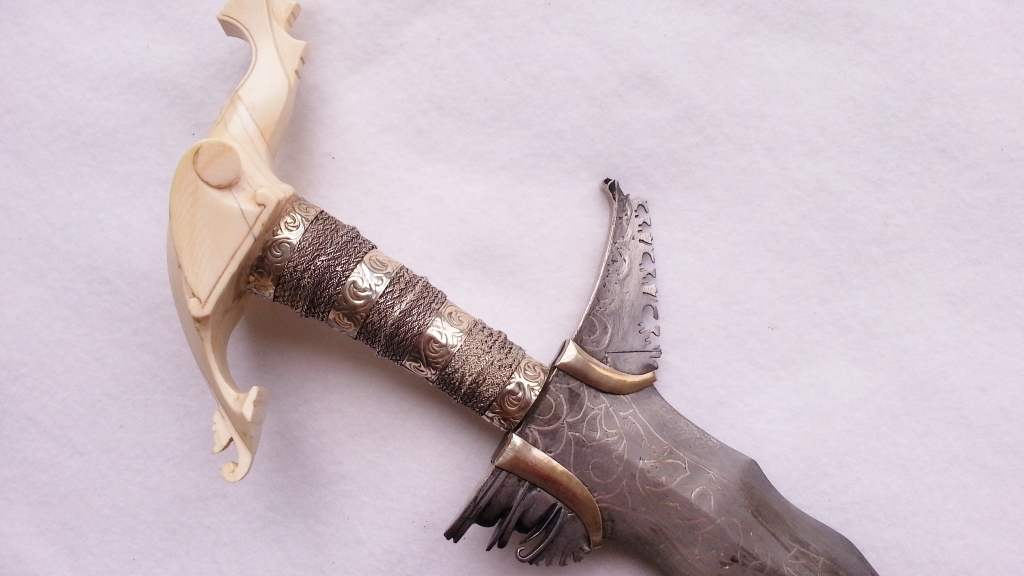

Posts: 7,416

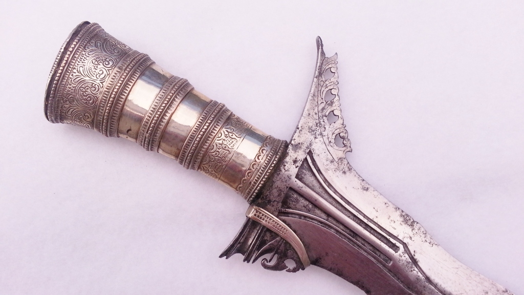

I have re-examined the "elephant" section of the ganga on this sword and it has a slight elliptical form to it even though the lines beneath it are straight. According to Cato this makes it more of a Maguindanao rather than a Maranao blade.
However there is a style that is not mentioned in Cato that I have noticed in documented pieces and pieces that in scabbard form (according to Cato) are Maguindanao. This form is what I call the "eagle" form and is distinct from the "elephant" form (note: there are a number of details and things that not mentioned in Cato, for example, gunongs).
Here are some pictures of 2 Maguindanao pieces - notice the the "eagle" form of which I speak. I also had another one like the silver hilted one with a nearly identical back and front of the ganga that was brought back from a GI when he was in Maguindanao country in WWII (I will admit that my piece on top does look a little more Maranao than the other one).

never was a big fan of categorizing these blades; it makes everything static. there's just too many variations to make a conclusion that a particular elephant's head and trunk design is a surefire indicator of what tribe the kris came from. what everyone seems to forget is that these were mere hypothesis put forth by cato, nothing concrete. but for the sake of this thread:
here's a close up of that silver pommeled kris, and based on cato's classification this is suppose to be Maguindanao. i believe this is what he meant by elliptical...

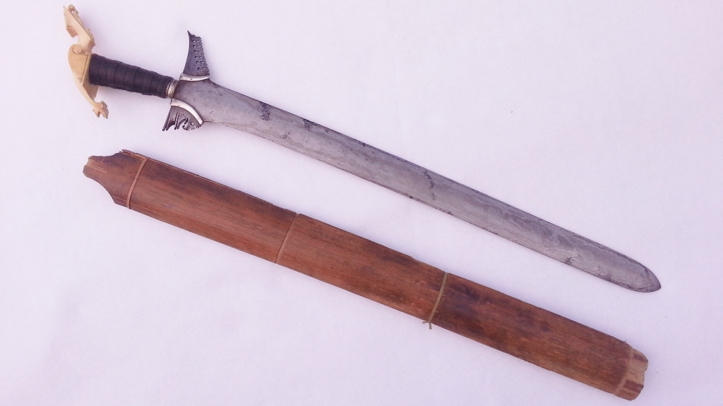

now let's compare that with a junggayan pommeled kris with the same elephant's head and trunk design
("The Maguindanao style, like the Sulu, exhibits an elliptical elephant's mouth that is still somewhat pointed on the innermost end.")
per Jazz's post:

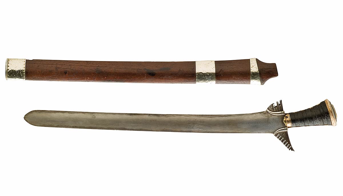

Jose, you mentioned:
The documented Maranao blades I have seen do have some "jutting" out of the bottom of the ganga, but the "elephant" section of the ganga does not have an "eye" and are a little larger, whereas the documented Maguindanao ones I have seen have an "eye" and do not stand as tall as the Maranao and the top of the "trunk" has deeper cuts than those of the Maranao.
so here's a junggayan that has the jutting jaw,and to top it all, it doesn't have an eye. now if we go by cato's classification once again this particular kris is a classic Maranao, and the one above is Maguindanao. incidentally the so called Maranao is much larger than the Maguindanao.
