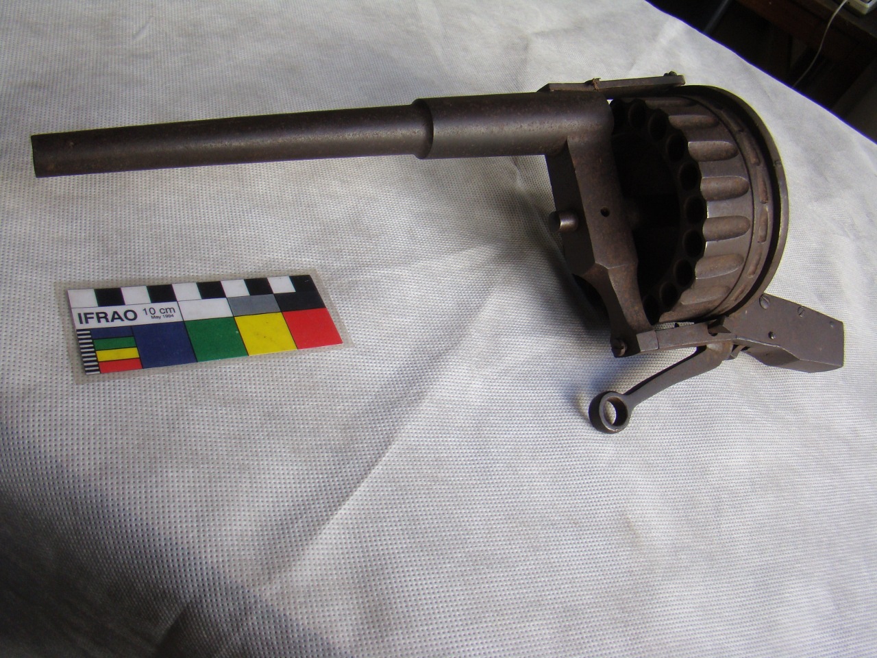

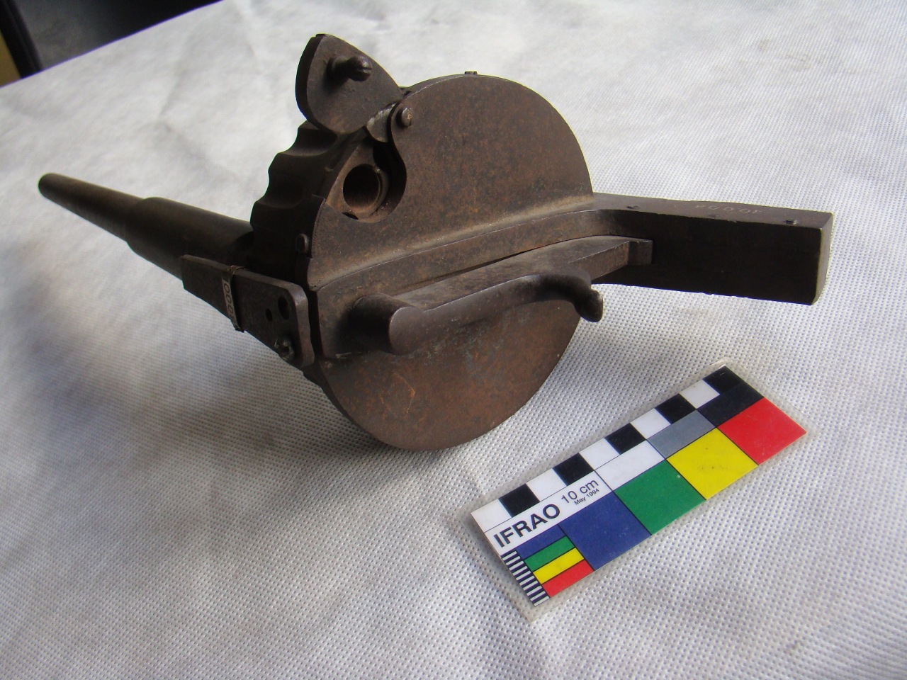

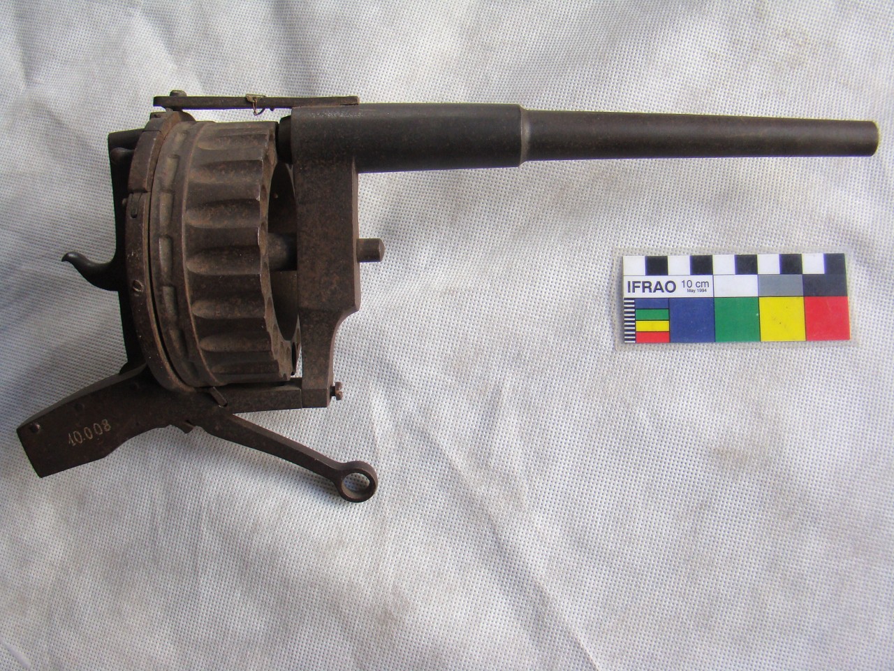

Request assistance in identifying this artifact which exists in a Historical Museum, is a revolver with a cylinder containing 20 sockets, center fire. triggered by means of a rope.
Affectionately. Fernando K

Many of these made their way to the U.S. via Francis Bannerman and Sons, the famous early military surplus dealer. You should find them in the old catalogs which abound both in original and reprint form. I don't know what Bannerman said of them, but a US dealer I asked told me they were used in the bows of small landing boats when conducting an amphibious assault. They are supposedly of French or Belgian manufacture. I've seen enough of them at U.S. antique gun shows to think that Bannerman must have imported at least several, if not dozens of these odd weapons.

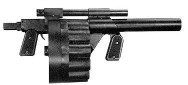

What came to mind for me was the bizarre rotating drum gun used by Christopher Walken in his 1981 movie "Dogs of War".
Apparantly this 'street sweeper' type gun (in the movie the fictional XM-18) was based on a 1936 development by Charles Manville in France, originally for 12, 12 guage shotgun rounds, but stated actually for tear gas grenades and flares. Later a 25mm version with 18rounds was developed for grenades however because of its weight loaded, was scrapped by 1943.
The movie sparked interest in these attention getting weapons, and a Frankford Armory began production of a version as seen attached with the movie poster for "Dogs of War".
Unclear on what weapon actually was used in those boats, but of course multiple and rotating barrel arms have been around since medieval times so not surprising..but would sure like to know more of them. Not really sure if this gun is one of the old 'Manville's' but possibly.

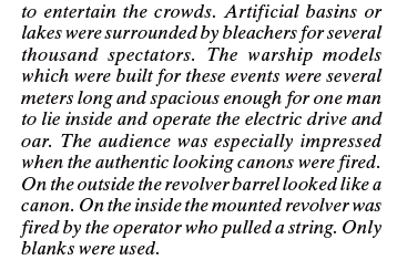

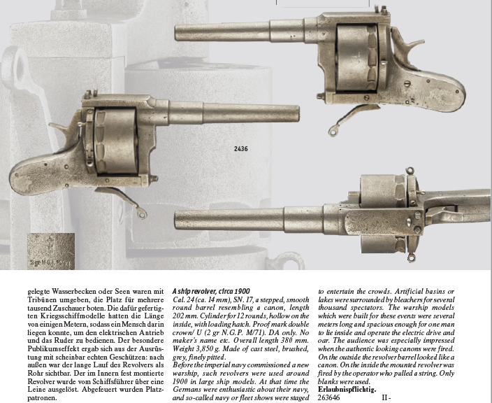

Hello
Looking at a Hermmann Historica catalog, I found a similar revolver, but of German construction. According to the text, it is a revolver of salvos, built for a representation of a battle at sea, around 1900, a spectacle. See the text

They only fired blanks in these events, as is written. How would rifles be of any use ?

I think everyone can see that the HH gun and the one in the museum are not the same.
Fernando K, is the muzzle bored all the way through?

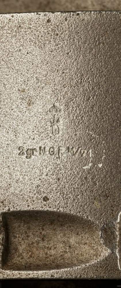

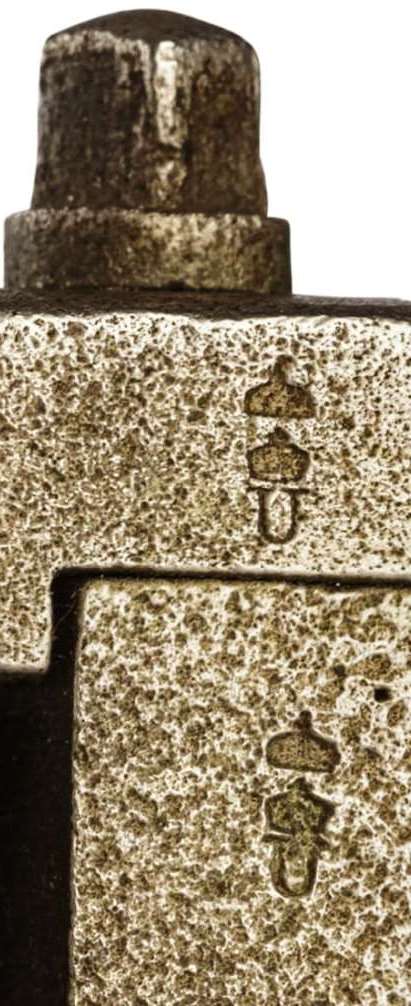

Two things bring my attention in this so called ship revolver.
- The weight; why would a gun of small dimensions weigh 3,850 grams ? This is the weighjt of some rifles.
-The marks; would the double crowned U and the cylinder inscription be those for blanks, as the caption claims to be? Would the 2 gr stand for 2 grams of gunpowder ?
Old 16th April 2021, 11:43 AM   #17
corrado26
corrado26's Avatar
Join Date: Dec 2014
Posts: 1,268
The "U" under a crown is the German blackpowder proofmark used since 1891 until 1939. 2gNGP = 2g Neues Gewehr Pulver = New Gun Powder
If Neues refers to smokeless gunpowder, then 2 grams is a substantial amount.
2 grams is 31 grains. For reference, a 9 mm Luger round takes 5 grains of smokeless powder.
I am still curious about this revolver. There are no sights on any of these examples. There appears to be no provision for mounting it on a stock or stabilizing it somehow. The trigger is for distance pulling. A possibility is a burglar alarm, triggered by opening of doors or windows. 20 discharges is a lot though, for any burglar alarm.
If this was, as HH describes it, a gun for some kind of naval theatrics, it would've been designed to look like a cannon, not a giant revolver.

If you look at the photo, there is behind de 2g NGP an M/71, so this was certainly not a nitro based powder but always still black powder. First nitro cartidges in Germany came in 1888 with the infantry rifle M/88.
Old 30th April 2021, 11:24 AM   #21
This HH example has a cylinder for 12 capsules with a considerable caliber (over 14 mm).
Could it be that 2 gr stands for 2 grains and not 2 grams. In any case, if this gun was made to shoot blanks, the amount of powder would be (much) less than for shooting a projectile; notwithstanding it needed to be noisy for the show purpose.
We ignore how these pistols were positioned in their niche; could be that they were introduced through some kind of orifice in that only the fairly long barrels stood out the boat hull, thus giving the impression of a cannon, as the HH caption seems to suggest.

Having checked a few sites where wizards discuss these things one may find that:
NGP M71 (Neues Gewehr Pulver) is an improved version of black powder developed for the Mauser rifle 1871.
So ...
The model of these (HH) revolvers doesn't have to be as old as from 1871, but instead the type of gunpowder to produce the effect needed; big bangs with blank ammo. Also in this case, i guess, 2 grams of this powder would be a plausible dosis, considering the fairly large cartridges used.

Fernando K
Join Date: Apr 2010
Posts: 672
Hi Dimitry and everyone
The recent problem in the vikingsword page has prevented me from participating. To Dimitry's question, he replied that I have only had access to the photograph of the revolver, taken by a friend employed at the Museum. I cannot tell if the barrel is scratched, and there is no cartridge either. But note that there are no marksmanship, which indicates that it was only for firing salvos. Interesting is the dialogue that was achieved by the composition of the gunpowder. I humbly suggest that someone write to the experts at Hermann Historica to find out more. My ignorance of the German language prevents me from doing so.
