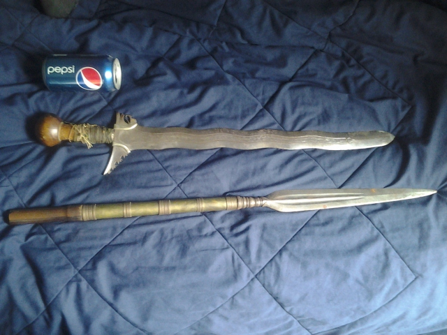

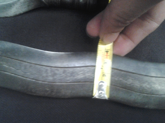

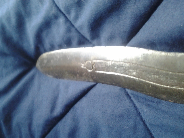

I inherited the kirs from my grandfather's father who fought in the phill. war. it had some rust issues. i used a double ot steel wool to remove alot of the rust. i hear vinegar can help as well. i would like some ideas on how to get the rest off if anyone can help. and if anyone can help me with identifying this sword and spear and what people think of them would help. thanks for the feedback!!
MrLyon101 is offline   Reply With Quote
Old 1st August 2012, 07:07 PM   #2
Posts: 7,397

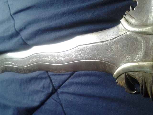

Yes this is a Moro kris. Probably Sulu in origin. What is very nice is that the blade is has a twist core steel center section. Very desirable.

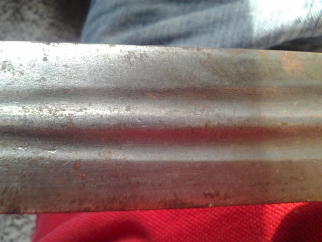

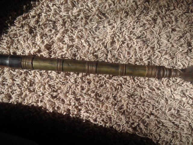

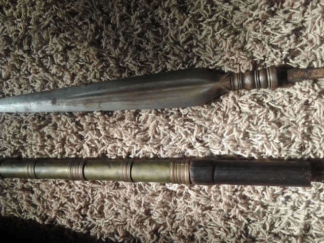

The other piece in the picture is a budiak, a type of Moro spear. Would you show close ups of the blade on that too?

I have owned/handled older, more dimnutive Sulu twistcore pieces and newer monosteel Sulu pieces. However, in person, I have yet to encounter a Sulu twistcore from this era of manufacture from in between. Very nice piece! I am green with envy, sir!

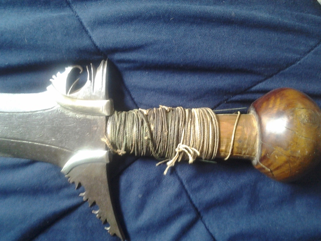

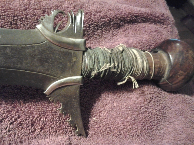

I also believe this is a Sulu kris (kalis seko) from around the turn of the (19th) century. Really a neat twistcore blade and also the round pommel (bunti wood) is a rare feature! Only the remaining grip wrap may not be original - maybe a makeshift repair. I'd consider to have it wrapped in traditional braided and "lacquered" style. The blade certainly deserves a careful etch: a little diluted vinegar (keep repeatedly working with a plastic brush) will take care of any remining rust and a following etch with hot vinegar may be enough to enhance the pattern; the result will be traditional - maybe kinda subdued though. You may also want to try a ferric chloride etch (neutralizing much more important with this approach) or other approaches to get a more bold pattern (I'd recommend vinegar first which is much safer). Please try the search function with kris and, as the second keyword, vingar or ferric, respectively; that should get you to several threads with detailed info. Please ask if you need any additional info!
Just need to be the first on record with this plea: If you ever decide to part with this kris, please be so kind and let me know!
As mentioned, it's well possible that the budiak also has twistcore - if it doesn't show any visible pattern already, some hot water may bring out the laminations enough to verify their pattern. With a few close-ups we can work from there...

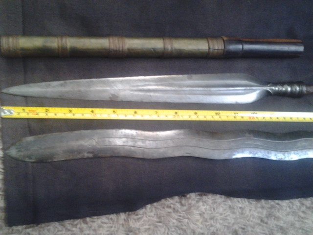

Seriously thought, both are very gorgeous pieces. Any information about them reagrding dimensions? How long is the blade on that twistcore?

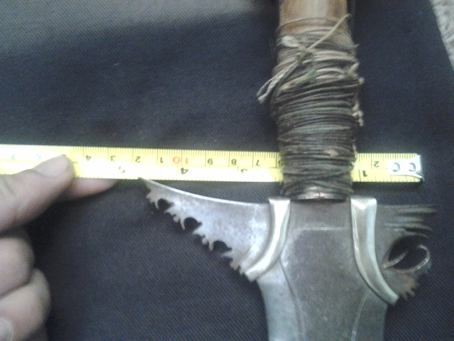

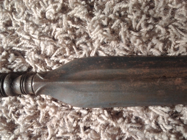

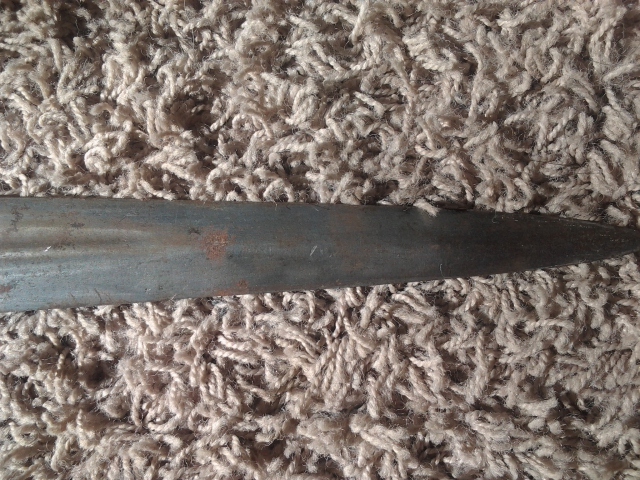

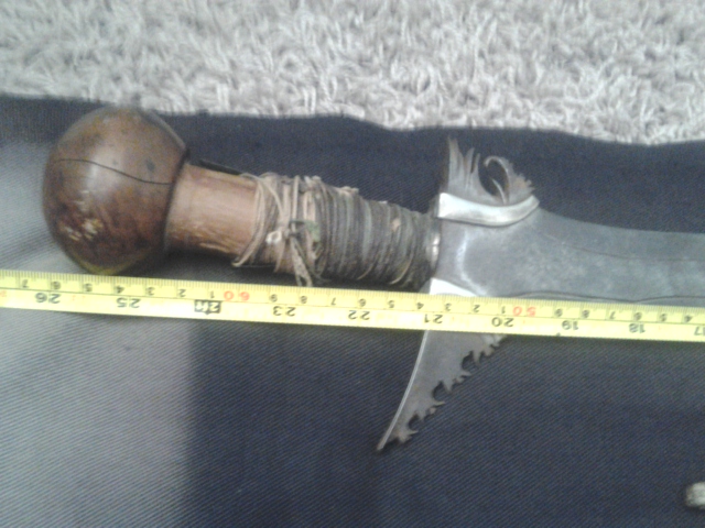

I took some pics with a tape measure. as requested but not the best pics.sorry

Regarding the budiak: even a smooth blade like this may show some nice laminations upon etching (and even a twistcore surprise is not unpossible yet). Please keep us updated and post a close-up once you soaked the blade in diluted vinegar for removing the remaining rust.
BTW, it should be fairly easy to remove the hilt (and both silver asang-asang) from the blade of the kris once you carefully remove the grip binding which is loose, anyway. This will make working on the blade much easier!

Honetly they are nice pieces and you should keep them. Worthy of our envy but worthier I think to keep within the context of family heirloom. Hopefully you can find out via the diary how he came into posession of these wonderful pieces.
Kai: How does one go about safely removing the asang-asang? On most pieces I have with asang-asang like this, they are locked onto the blade tightly. Is it a simple matter of removing the thin copper/brass sheets on the bottom of them that extend onto the hilt? I'm only guessing when I say I think this is how this style of asang-asang was tightened onto the blade, but having no experience in removing them I do not know for sure

If i can ask what makes the wooden pommel unique? I see more elaborit designs and mine is just a wood ball. and sorry for my questions. these are my first pieces and lack the knowledge. im a newbie lol.
not unique but rare. Search here a little bit and you will see that a "ball" pommel is a rare find.
