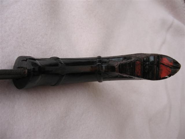

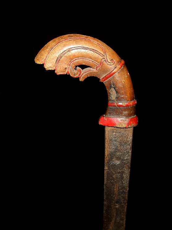

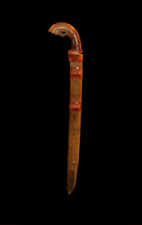

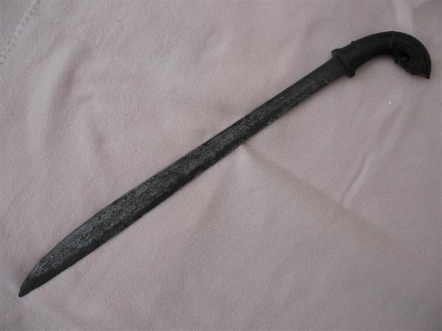

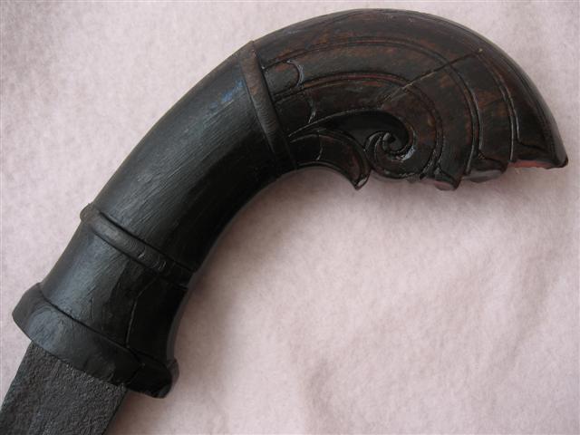

Hello.
I've had this blade for a while and could never quite figure it's exact origin. I've seen similar shapes to the blade and pommel, but every time I run across a similar handle it has a generic Malaysian or Indonesian origin. If so, is it Borneo? Sumatra? Celebes? In the book Traditional Weapons of the Indonesian Archipelago on page 72 the Klewang Tebal Hujong looks similar, but I was hoping to get some input from other forumites on this blade. The overall length of this is 2 feet long.
Joe

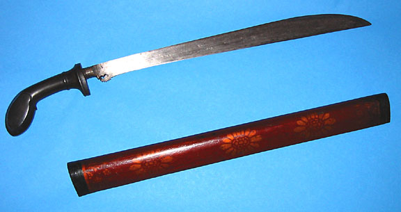

Hi Joe

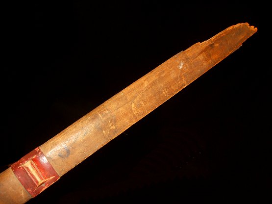

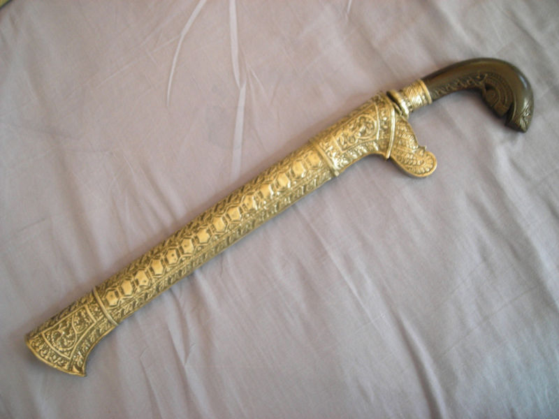

It's definately a klewang probably from Sumatra. I had one in my collection it was quite unwieldly and about ten years ago and foolishly sold it. Here is pic of it . Btw the one on the bottom I still have and it handles like dream very lively and quick in the hand.

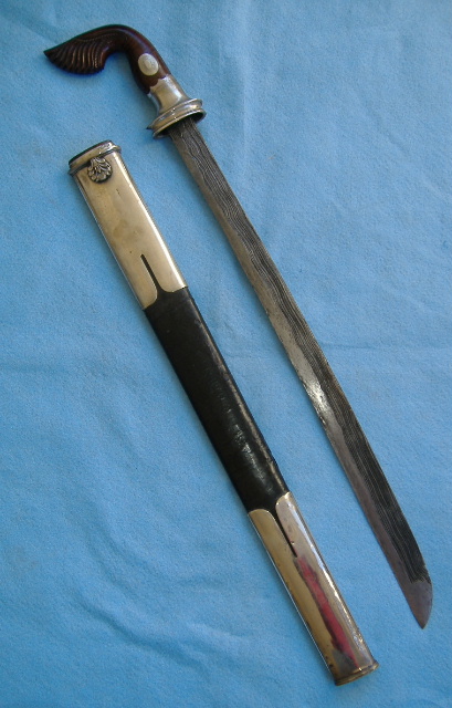

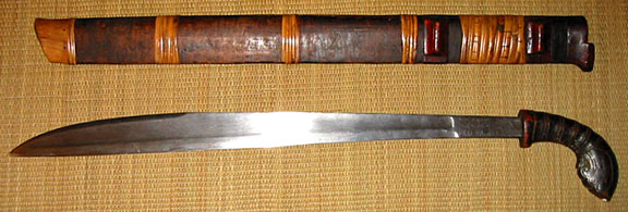

Hello Joe,
think as well that it is a klewang from Sumatra but this handle form I have seen already by a klewang from Sumbawa.
Attached a picture from this one and from a klewang from Sumatra.

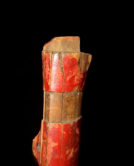

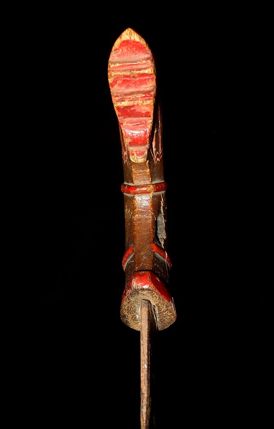

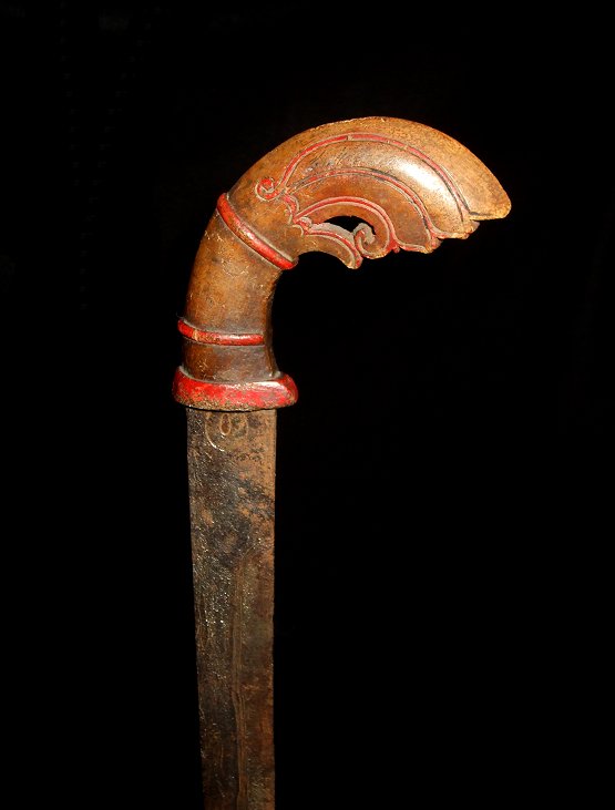

This one is not from Sumbawa nor from Sumatra.
It's a banjar klewang from South Borneo.
Also the red paint is typical for this region, and original and not painted later on it.
Maurice

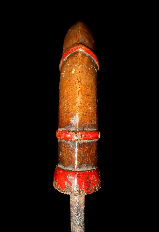

Posts: 1,464
Here some images of the one I once had some years ago.

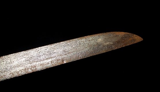

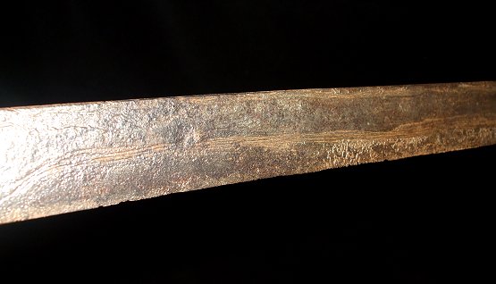

Interesting piece, it shows the typical forging pattern seen in many swords from Suawesi.
Those more learned will be able to explain who influenced who with the manufacture of that pattern within the blade.
Gav
Hi Gav,
This wasn't a dayak weapon.
The Banjar klewang was in use by the Malay/Javanese/Sumatran/etc., who were traders around Banjarmasin and the estuary.
A bit further upriver you find the cultivated Moslim converted dayaks (who mixed up with the Malay/Javanese and other people who lived or wandered in the South, trying to earn a living by trading stuff) , and more further upriver the dayaktribes appear.....
The non-dayaks did the forging of this klewang from Banjar.
Maurice

Originally Posted by Lew
Hi Joe
BTW Lew, the upper one with painted scabbard is a Sumatran pedang.
The one you still have, the lower one is indeed a klewang from Banjar..
Maurice
Maurice
Maurice
The pictures are reversed the one with the painted scabbard is still with me the other was sold some years back.
