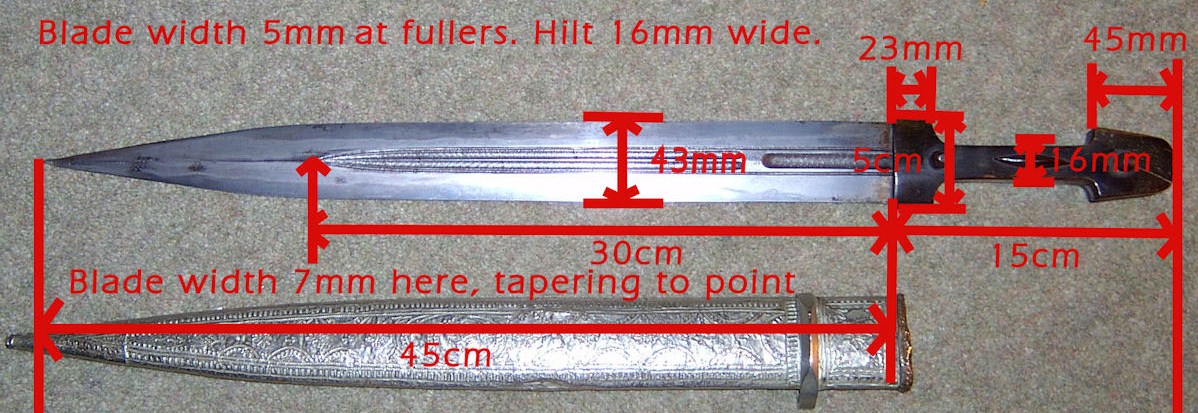

Here is my Kindjal for your consideration. I only have the one, but luckily for me it has a rather special blade (In fact apart from one on hermann-historica it's the best I've seen by a country mile).
The blade is not flexible. There is no distal taper until the parallel edged section ends, then it's quite a mild 'thinning'. The fullers mean that the widest part of the blade is just after the end of the fullers where the distal taper starts, which leading to a long diamond sction point is almost like an Indo-Persian armour piercing point. If you need any dimensions, want to discuss construction or POB etc, let me know.
my Kindjal

About the thickness of the blade : my feeling is that is could be around 8mm (0.31 inches) Could you please tell me how thick is yours ?

Hi Bernard.
Weight: 573.8g. POB 11cm from hilt.
It's ok to post photo's from eBay as long as the item is sold not currently for sale (so not an active auction).

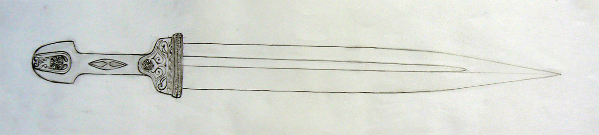

I'm currently discussing the blade details with my customer before I begin the work itself.
Here is the last drawing of the ongoing discussion.
We still have an issue to solve : my customer would like to add the engraving of a russian coat of arms onto the base of the blade. Single fuller blade usually have a deep and narrow fuller. On the other hand, engraved blades usually have several large and shallow fullers.
I'm currently thinking of making a single large and shallow fuller and make the engraving onto it, or maybe starting the fuller a few centimeters after the base of the blade in order to leave enough free space for the engraving.
None of these options is fully consistent with genuine kindjals...
What do you think of this ?

Looks great Delor.
How about the coat or arms on the scabbard throat instead?
