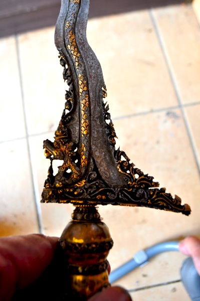

Dear forum friends,
appreciate if you could help identifying tangguh of this javanese keris, 11 curves, rather small compared to standard javanese dragon kris. tq so much in advance. mykeris.

Tangguh Kamardikan, without any doubts.

Hi Mykeris, a keris Kamardikan is a keris that was made in recent times. Regards, Heinz
I agree, and probably from Madura.
Kamardikan means independence (krisses made after 1949) and it is by far the most common tangguh on the market

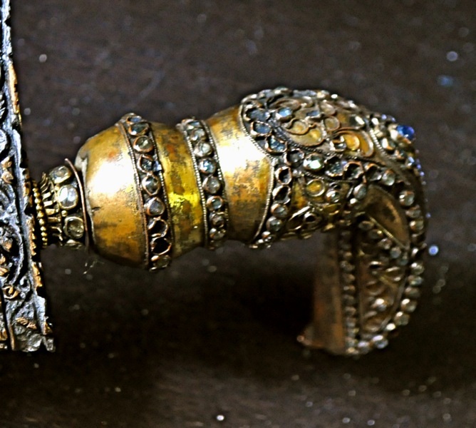

The hilt is from Banjarmasin (South Borneo).

Possible to see the hilt? Thanks

From pic the banjar hilt seems old with (probably) two new blue stones. Nice hilt

I agree with others that yours is contemporary (post Independence and most probably post 1970s) and the Banjarmasin hilt is inappropriate for this form.

I can understand your "feeling" that this is an older kris from the worn-out kinatah and deep carving especially and I was hesitating when I first saw it. However the carving is overdone and does not seem to be finely made in the cavities, and in the kris world I have learned that "too much or too nice is suspect"
