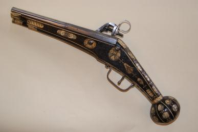

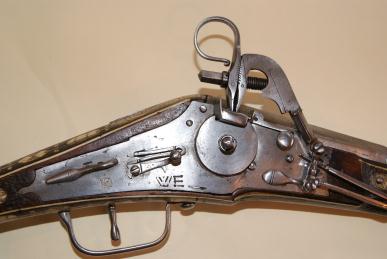

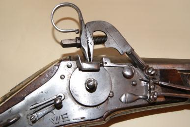

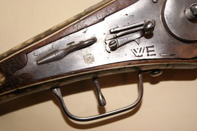

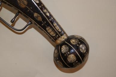

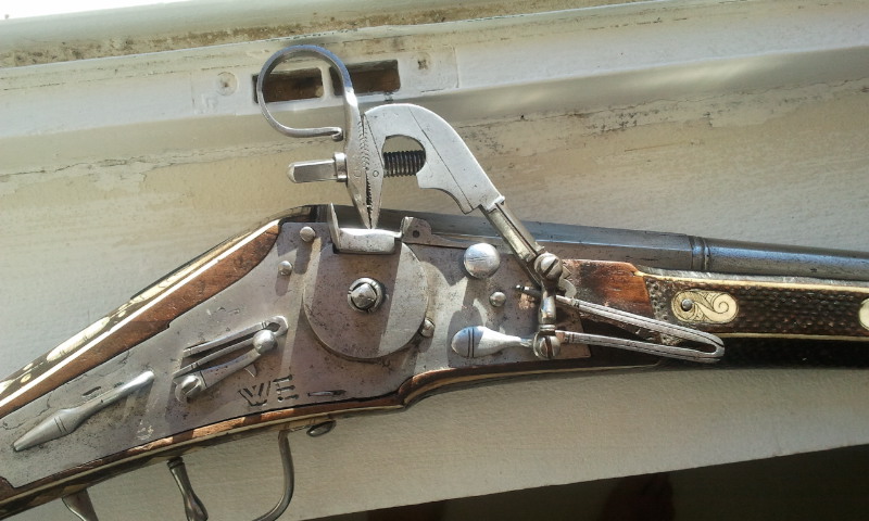

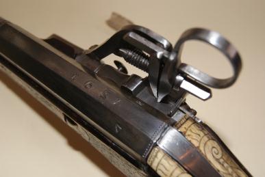

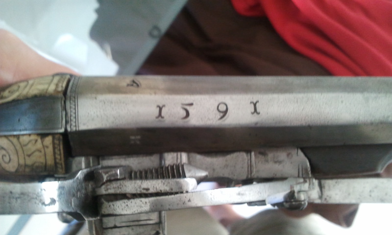

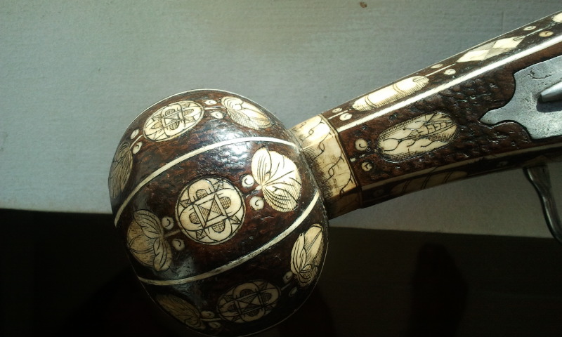

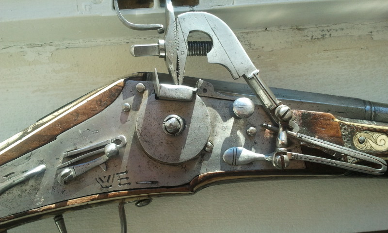

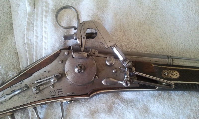

Please, would you know what is the meaning of 'WE' marking on this 1591 'Puffer' pistol ?

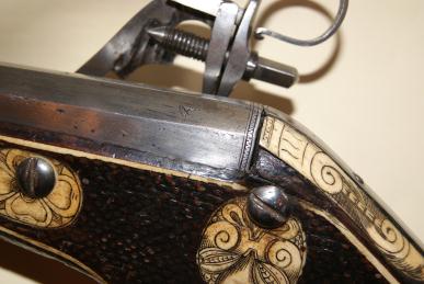

Also there are some 'A' and 'K' markings close to the 1591 barrel date. Any information on these letters ?
Thanks,
jm

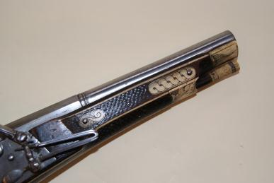

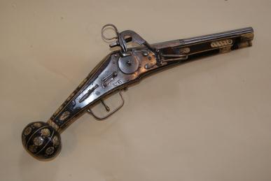

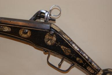

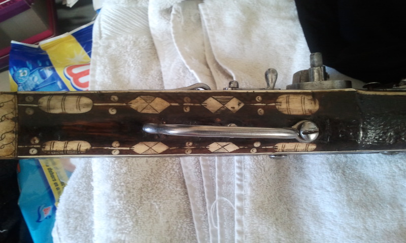

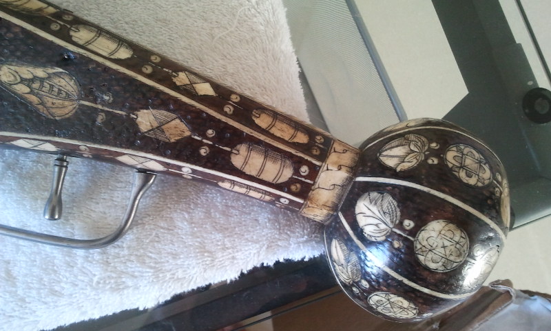

Some additional pics.
Is is a pistol for Schwarze Reiter (also called 'Black Riders') ?

I cannot identify the marks but the shape of the dog points towards Augsburg as the city of origin, and to ca. 1590 perfectly matching the date 1591; I would not assign this puffer to the 'Black Riders'.
Stylistically this is one of a rare group of short-barreled ball-butted pistols (puffers).

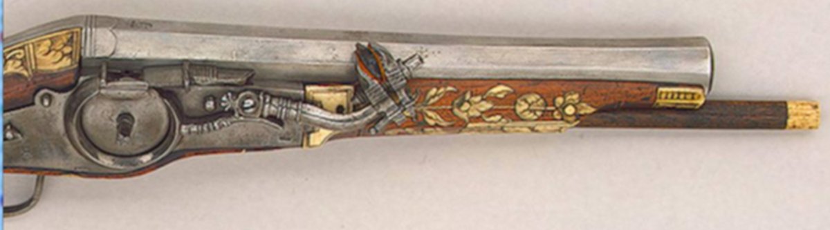

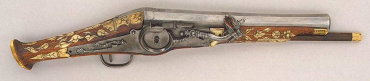

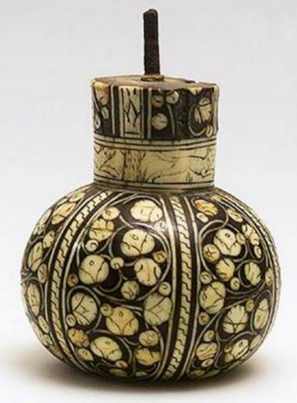

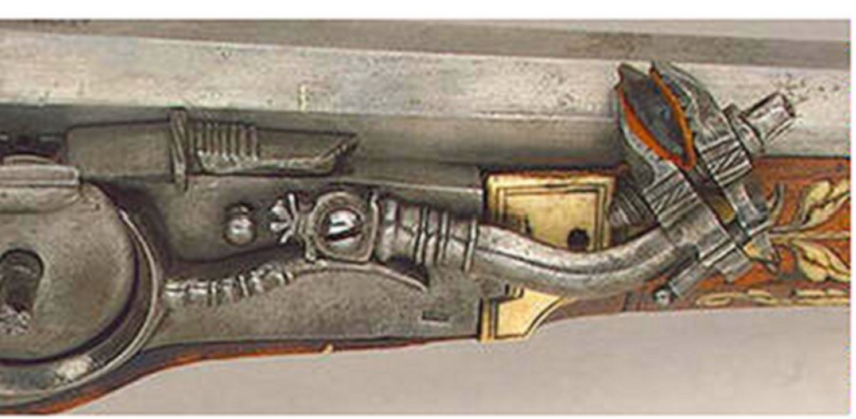

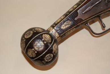

Default What the ball butt was actually for
I have heard various interpretations on the actual historic use of a ball butt on a wheellock 'puffer', the most common being that it was used as a club after the gun had been fired on horseback.

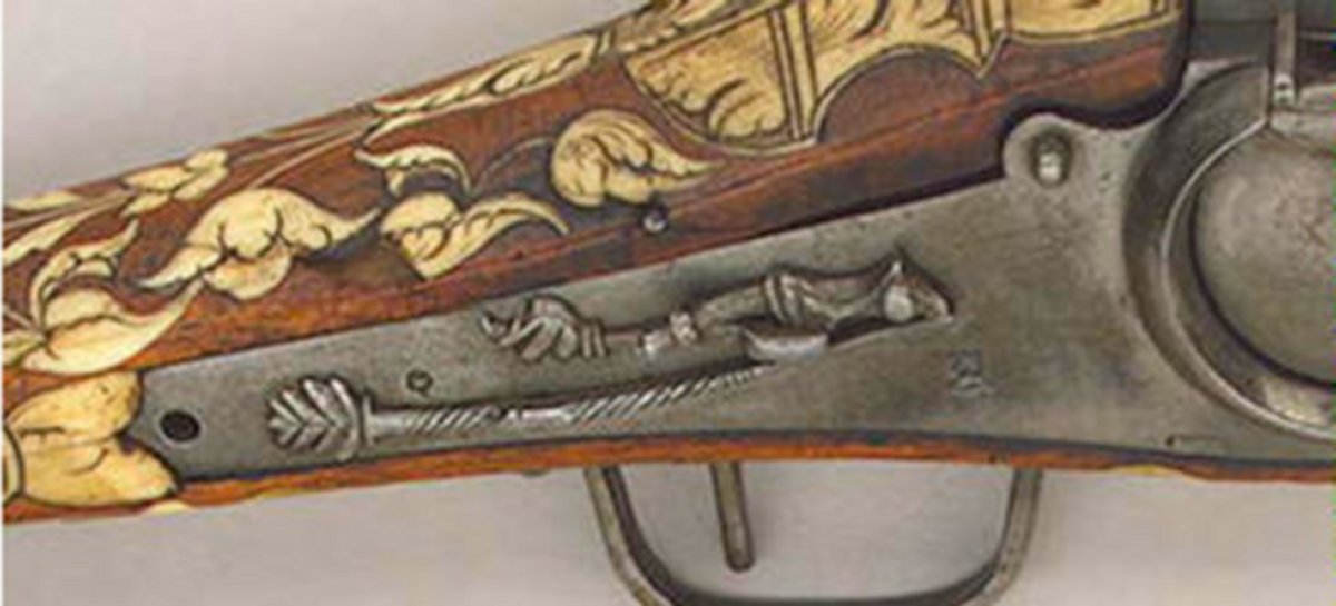

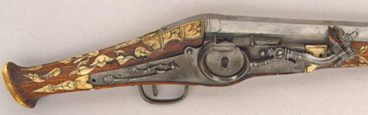

Here is a very rare image showing a detached late-16th c. ball butt and the central wooden rod for attaching it to the butt stock.
We cannnot categorically exclude that the putts of pistols and guns were employed as clubs in case of emergency but they certainly were not constructed to survive such a treatment.
Basically, the ball butt provided a safe grip for the gloved horseman's hand when reaching for the heavy pistol to draw.
The earliest, and smallest, precursor of the ball butt appeared in the 1550's, developing from the fishtail-shaped rear end, and the design was finally given up at the beginning of the 17th c.
One of the earliest pistols presenting the prestage to what was to become a ball butt is seen on a ca. 1550-55 Nuremberg pistol, struck with the mark of Hans Stopler, and the sickle-shaped dog spring running around the wheel, preserved in the Hermitage Museum St. Petersburg (attached at bottom).
m

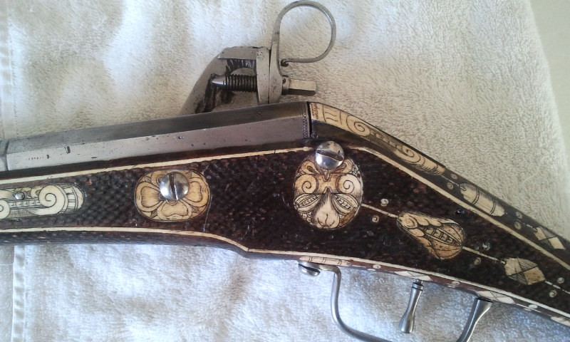

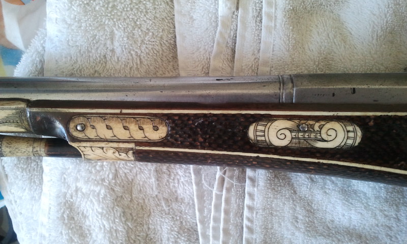

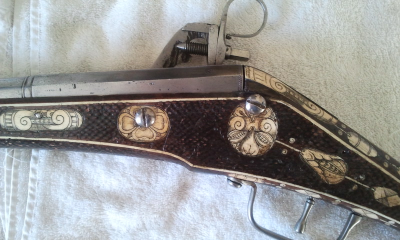

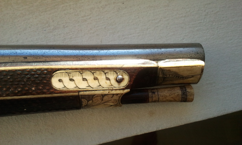

Default More detailed pics of wheellock pistol
Here are some more detailed pics of the German wheellock pistol.
jm

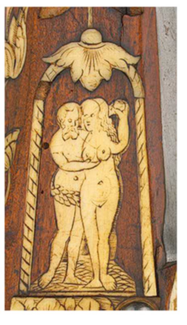

Default 'A' and 'K' barrel marks also found on a 1592 Puffer pistol from Trabanten Leib Guard
For information, I found the same 'A' and 'K' barrel marks on a German Puffer wheellock pistol (dated 1592) from the Trabentan Leib guard of Christian II (Puffer pistol at Bolk antiques).
jm
