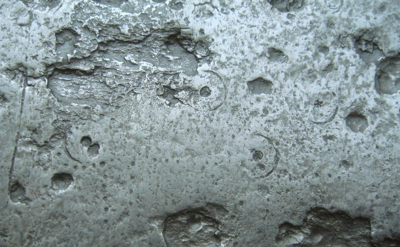

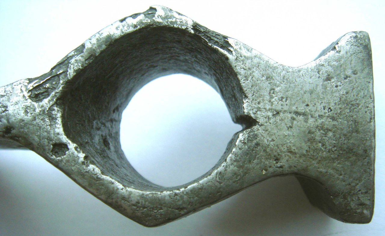

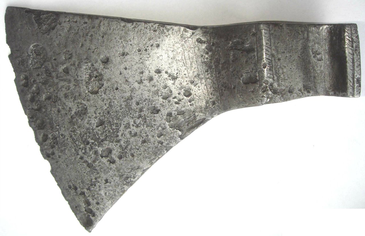

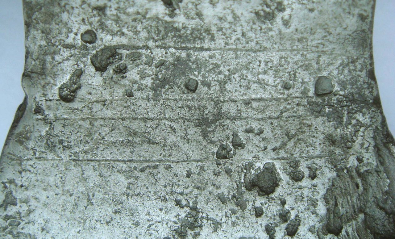

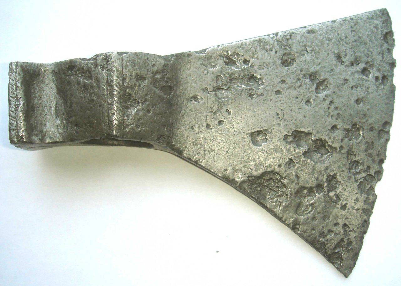

Dear colleagues,
I would be very grateful for the help in identification of this battle ax found in the European part of Russia, near this place:
Evgeny_K is offline   Reply With Quote
Old 30th March 2012, 08:14 AM   #2
Evgeny_K
Evgeny_K's Avatar
Join Date: Mar 2011
Posts: 217
here is the axe

Judging by both its general Late Gothic formal criteria and the roped frieze decoration, I would date this axe head between ca. 1500 and the mid-16th century.

here are dimensions of the axe:
lenght - 175 mm
width - 135 mm
Michael
Thank you, Michael!

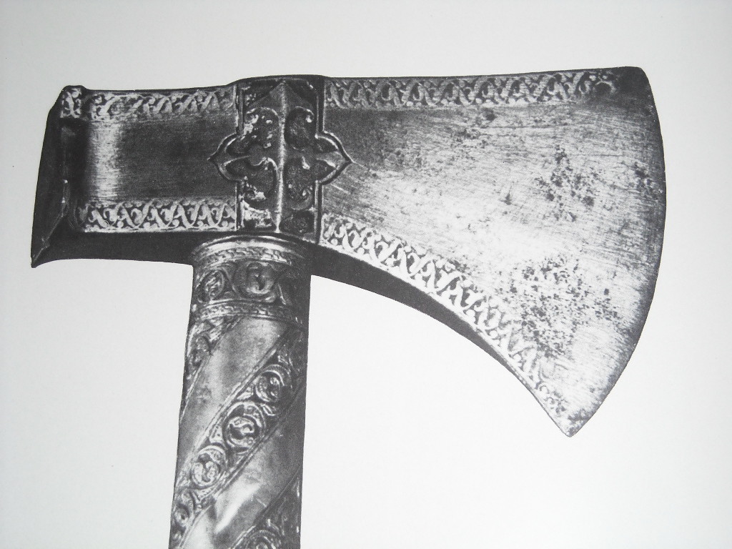

Hi Evgeny,
i might be a russian item, because it was found there also.
Here is a photo out o the book:
"russian arm and armour"
This axe is called a parade hatchet from 17 century.
Hope this helps a bit.
Dirk

Hi Dirk,
This is a ceremonial axe, which explains for its 17th c. assignation.
The basic Late-Gothic stylistic criteria are as I stated.
Michael
