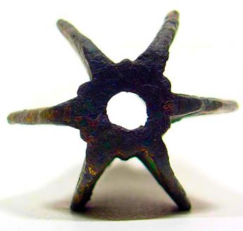

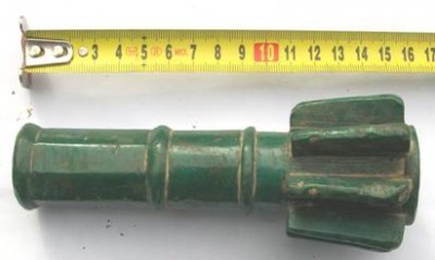

Default Mace-handgonne

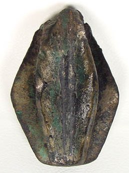

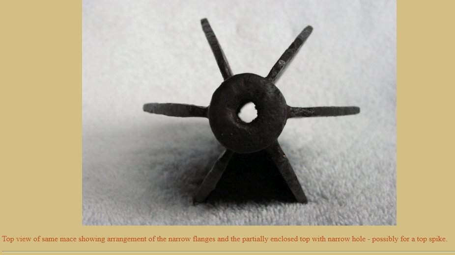

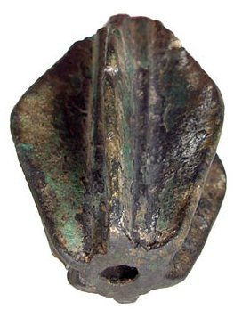

Bronze mace-handgonne was found in Ukraine in Винницкая область. This mace have iron partition which split mace-head on barrel and socket for fixing on a pole

That's an unbelievable find indeed!
Where is this item now, and are there better photos?

Fascinating specimen indeed !

Hi Alexender,
I do not quite understand what you mean by 'iron partition' - I cannot detect any iron parts and I believe that the item is all cast-bronze.
m
Old 26th March 2012, 09:08 PM   #5
Matchlock
Matchlock's Avatar
Join Date: Sep 2008
Posts: 4,310

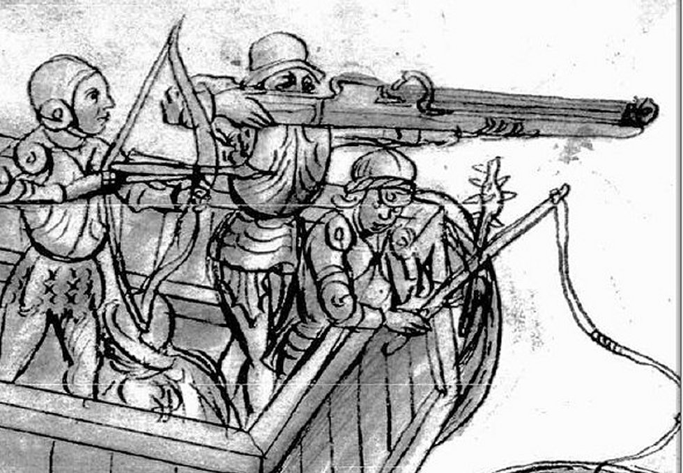

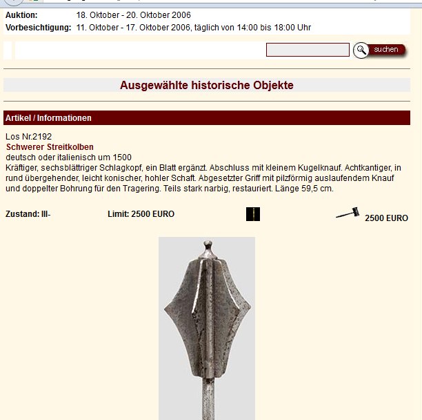

If I were to assign a date to this, I would - based on the period artwork attached by Alexender - say 'around 1470', give or take a decade or two.
m

We need to look at maces typology... I think, that shape of mace head would help us to determine the correct date.

Posts: 4,310

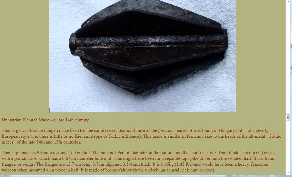

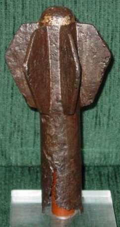

I'm afraid all it would provide would be another terminus post quem.
As studies in combination weapons have proved - and this was doubtlessly a combined weapon - , they seem to reflect the earliest possible shapes of the basic (!) weapon.
This means that when you investigate a combined mace and wheellock gun, the mace head - as a relic of the basic weapon - will reflect the latest development of maces while the wheellock will closely mirror the taste of the period of actual manufacture.
I will do research into the shape of the flanges on the mace head, as I have been planning on getting back to this topic soon anyway, with good basic material of course.
What I can state with authority today is the fact that the pronounced sectioning of this barrel points toward the end of the 15th century. No such sectioning by moldings or other stages can be found on pre-1460 barrels.

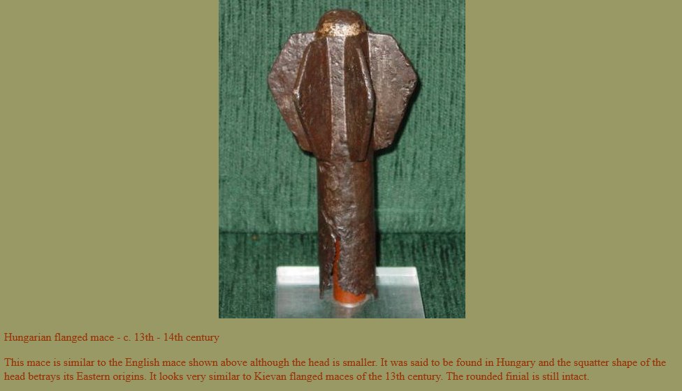

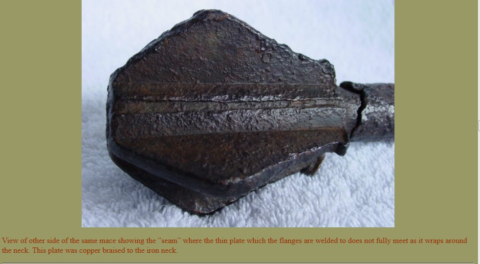

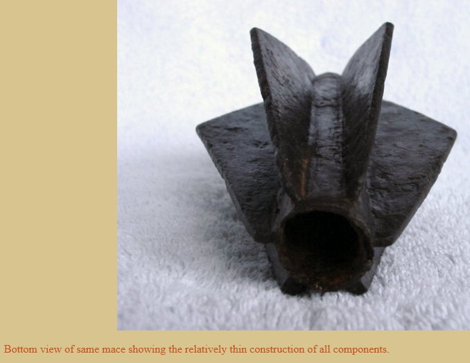

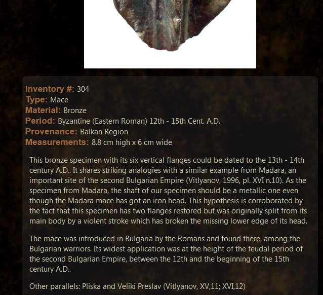

For today, I would like to link you with

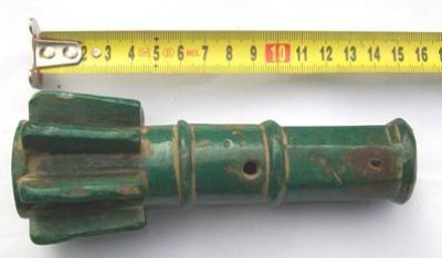

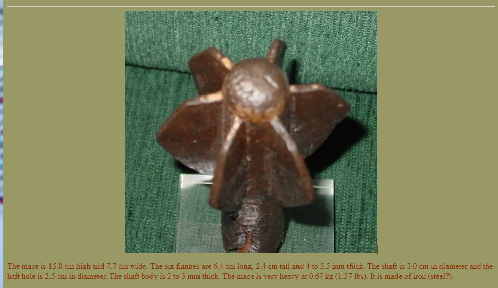

http://otlichnik.tripod.com/medmace3.html
The attached 14th-15th c. samples, which come pretty close to our combination weaon in discussion, are from this site.
On the other hand - and this I hope makes the dichotomy understood that I have been talking about - , they are very close to the sample attached, ca. 1500!
And: in order to make the similarity of mace heads thru the millenniums perfectly clear, please see here for a nearly identical Byzantine sample, 12th-15th c. (attachments at bottom):
http://www.google.de/imgres?q=mace+h...:0&tx=30&ty=58
Michael

Of course, the armored knight in the piece of period artwork attached was obviously not able to fire his combined mace and gun single-handed. How he could have possibly done this on horseback is left to speculation. Even if he did not have the reins in the other hand, this would have had to be much longer than the one that held the club, in order to reach the touch hole!

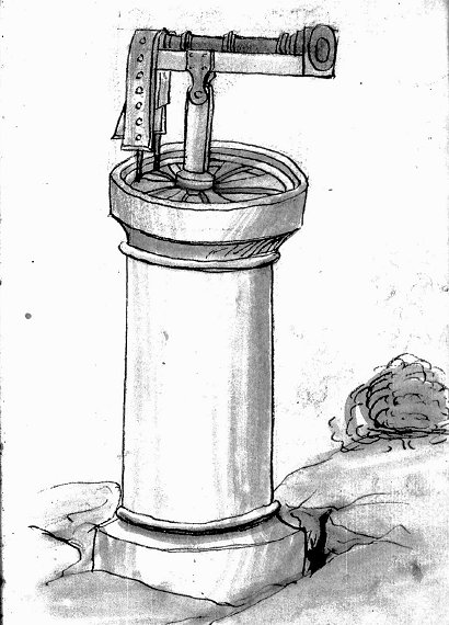

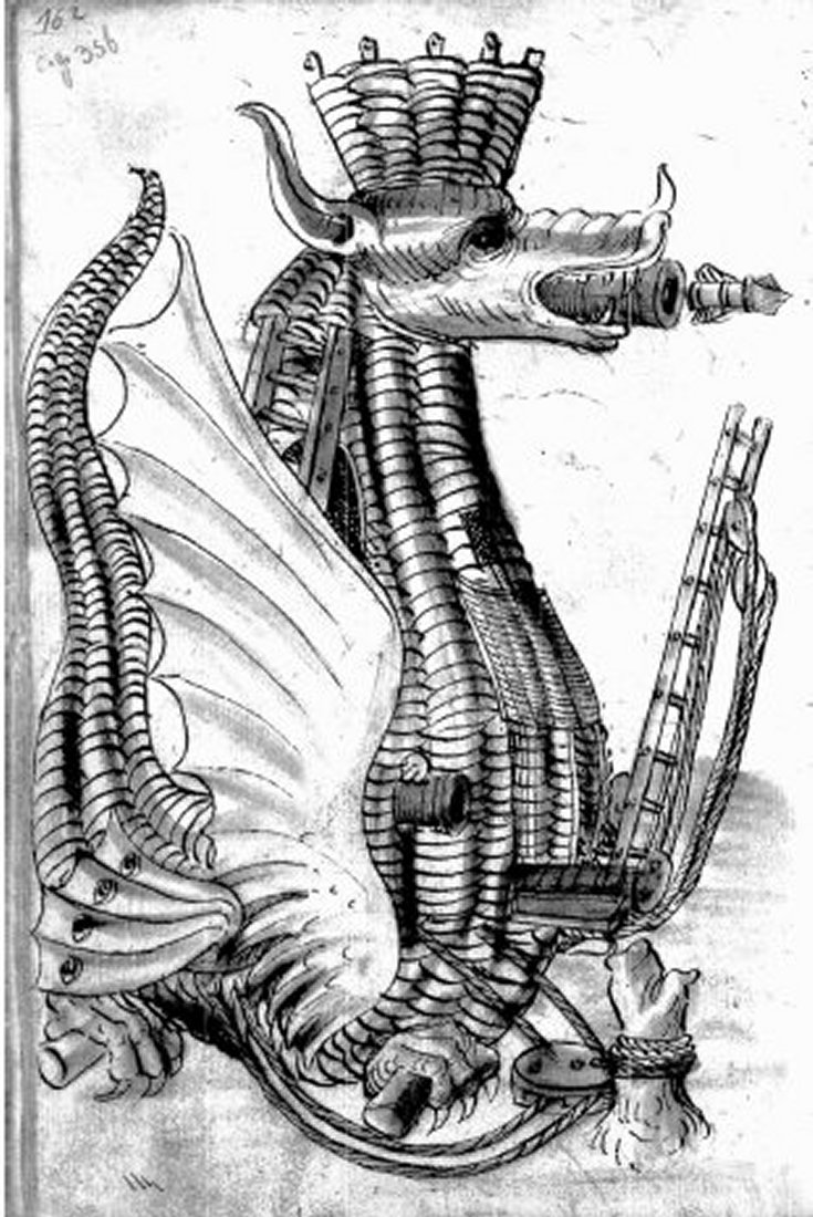

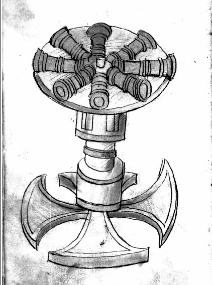

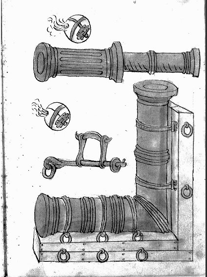

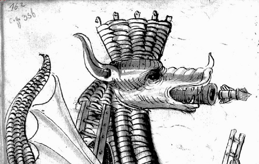

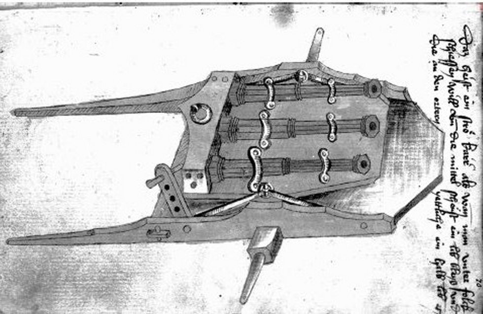

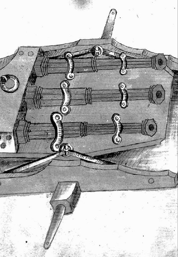

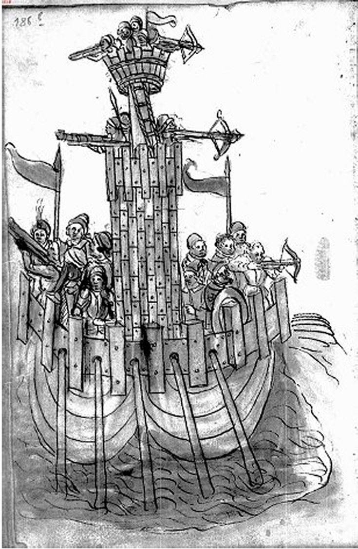

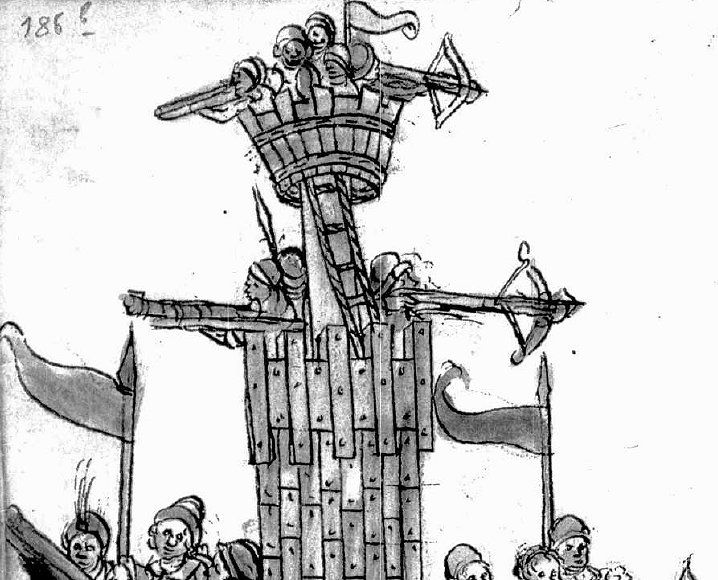

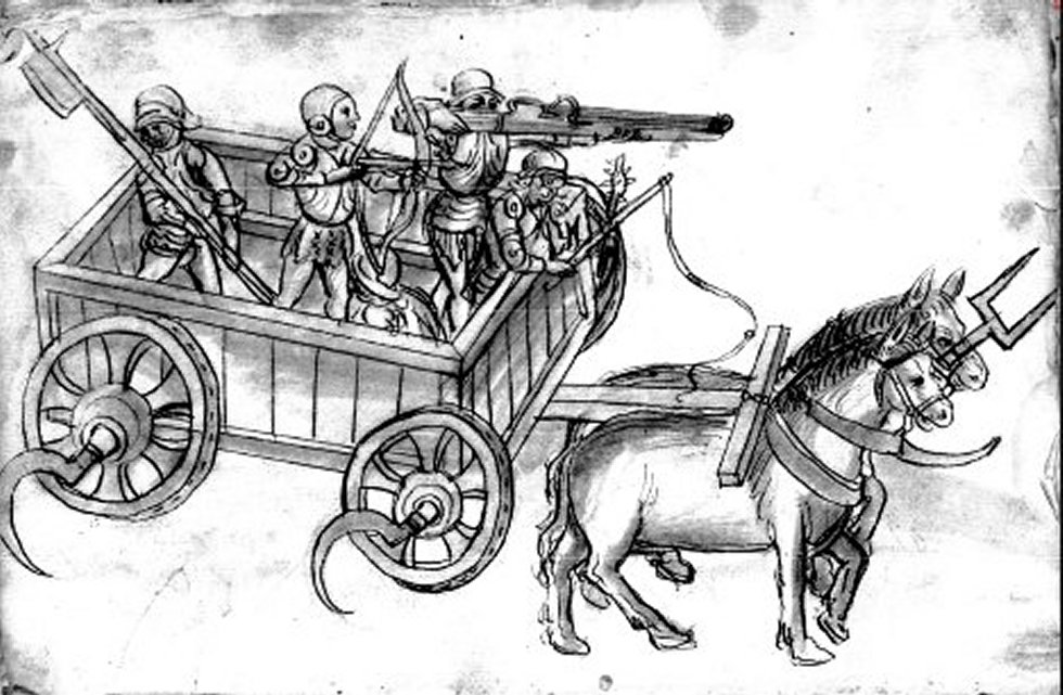

I wished to give the source of the period artwork posted by Alexender in post #1.
It is taken from the cod. germ. 734, dated to ca. 1460-70, a so-called Büchsenmeisterei-Buch (book on gunnery), preserved in the Bayerische Staatsbibliothek Munich.
Concerning our interests, it also contains the illustrations attached.
m
