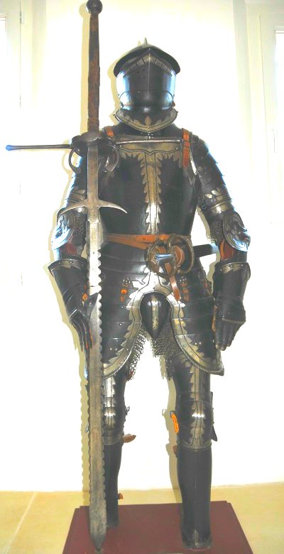

Default Two handed swords

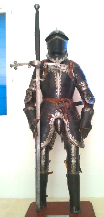

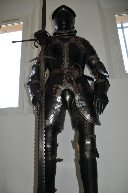

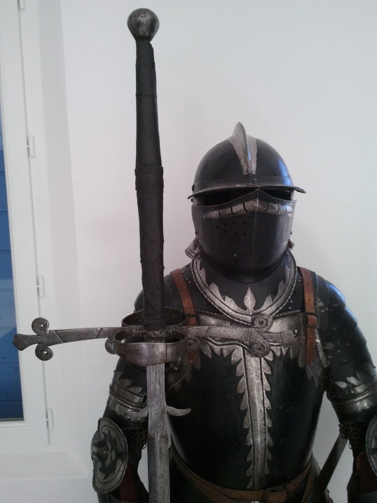

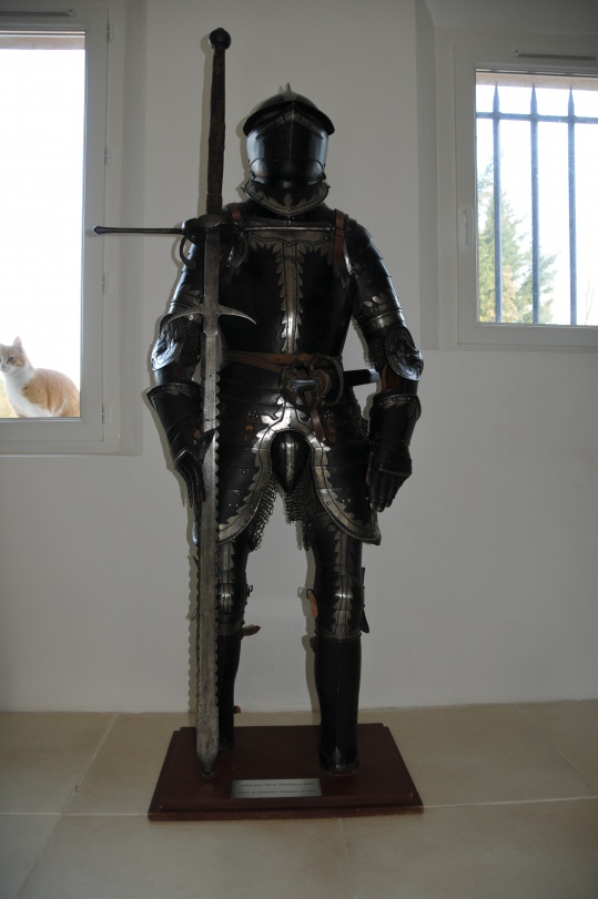

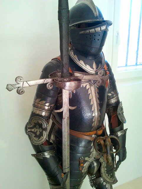

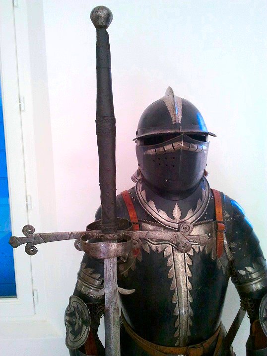

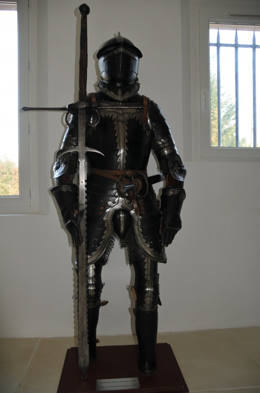

Here are some pics of the same, plus another two handed German sword (16th century). Any information as to the second one too (origin, shape, etc.) ?
Thanks for all,
jm

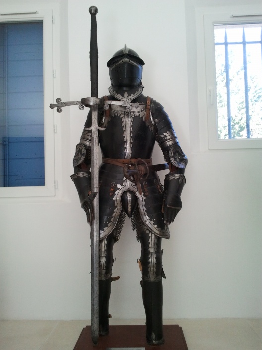

Though the cat is no doubt by far the cutest thing in the pics , I think the sword might be genuine as well.
What I do not like about this 'traditionally thought to be historic' kind of presentation in general is the fact that a) two-hand swords were not used by armored men, and b) the suit of armor is much smaller than the sword ...
Michael

i don't know, the cat looks like a modern reproduction.
interesting serrated blade. reminds me of a tulwar recently posted (like today )
the knights look a bit short*. i'd probably blame the display stands.
the cat looks like it's the right height tho.
*- just saw matchlock's post a minute earlier than mine GMTA.

I tried to brighten up the images because I think the sword is worth a discussion. I like the wavy line ornament on the ricasso often found on such big swords.

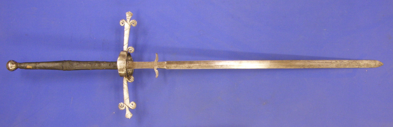

The second two-hand sword seems to feature a genuine North German early-17th c. blade.
It should however not be presented together with a late 16th c. horseman's armor and an early-16th c. style Katzbalger because this ensemble does not convey a homogeneous impression.
Michael

Thanks for all this interesting information. At the Barcelona Citadel Museum, you can also see the weavy ornament at the ricasso of a similar two handed sword (see link below).
http://www.flickr.com/photos/6830857...n/photostream/
My German two handed sword was previously on display in a Dutch Museum. It has been dated to ca. 1570 according to the information I have on it.
It is 184 cm length and weighs 3.8 kg (ca. 8 pounds) .

As to my cat (Katz), it remains outdoor because it probably saw that the 16th century Katzbalger is missing its original scabbard....

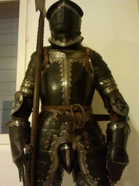

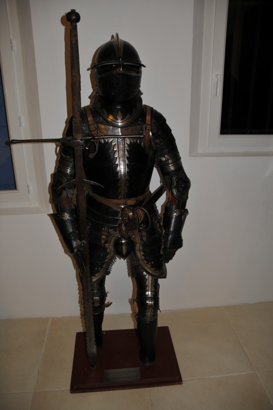

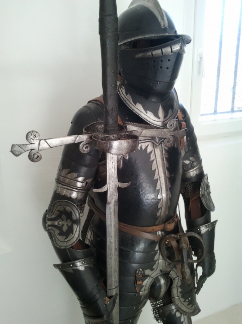

Wink Landsknecht captain full armor, ca. 1560
Hi Michael,
This is a Landsknecht officer (captain) infantry full armor, ca. 1560. They are described to wear a close combat katzbalger, as well as either an halberd/pike, or a two hand sword, as they were fighting on foot at the front ranks of their infantry company (fahlein), consisting of 400 landsknecht mercenaries. Only the colonel and the second in command, lieutnant colonel, were horsemen among landsknecht officers. This katzbalger should be mid 16th century (later period of landsknechts), due to the shape of the passau running wolf etched on blade and quillons.
The match should not be so bad !
Isn't it ?
Jm

Hi Jean-Marc,
Thanks for responding so fast.

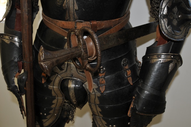

As concerns the Katzbalger:

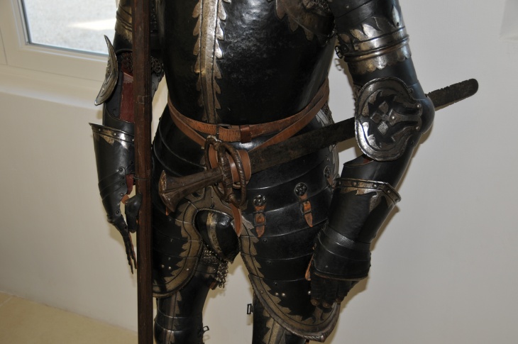

I feel that we really need to see good close-ups of the ricasso section and the characteristic fluting which should be there. The overall length of the weapon should not fall short of ca. 88 cm, possible wear and working time shortening theoretically included.
As regards your ensemble: I did not mean to say it was bad by any means - which of us can present anything approximating that? Anyway, it is of museum quality, no doubt. It is both decorative and optically imposing. A fair compromise, no question.
After all, and just judging by a few pics, I think you have been doing very well!

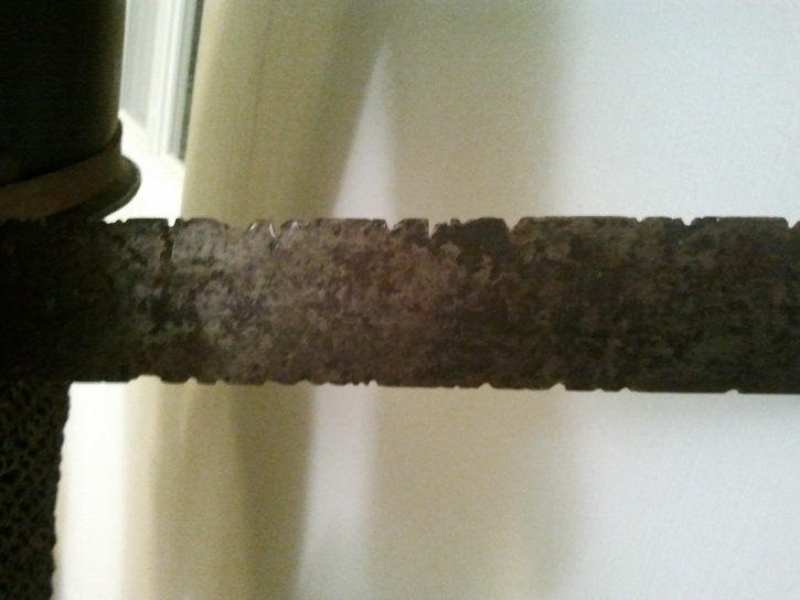

Smile Katzbalger
Hello all,

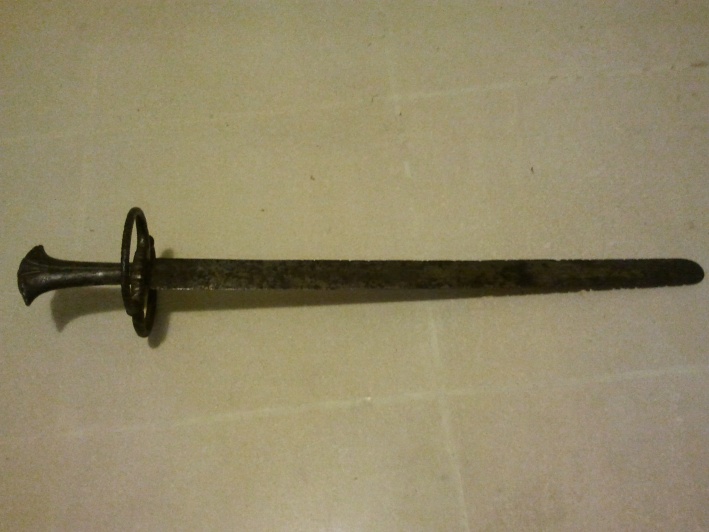

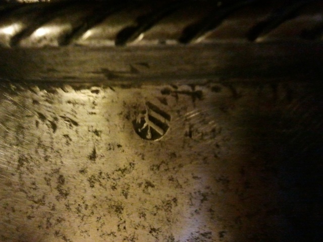

Thanks for the interesting comments. Indeed, the katzbalger has been purchased in the Netherlands (at Bolk antiques, European dealer of fine antique Swords and Armors). It was previously in a 40-year old private collection. The seller in the Netherlands (Ton Bolk, highly recommended) got only one period katzbalger in almost 40-year business (this one) while many later 19th century replicas were obtained by the same and sold over the years...
Concerning the two hand sword (straight blade), I will look inside the ring guards later today and will let you know for the 'fleurs-de-Lys'.
The length of the Katzbalger is 74 cm. There are a mid 16th century 'Passau running wolf' (at center blade on two sides), and also (at ricasso) three 'cross and orb' motifs (in a triangle) one one side, and three moons (also in a triangle) on the reverse side of blade.
My best ,

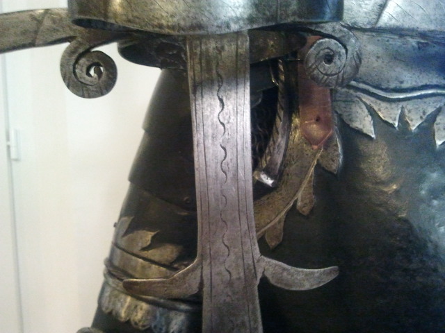

Hi Jean Marc.

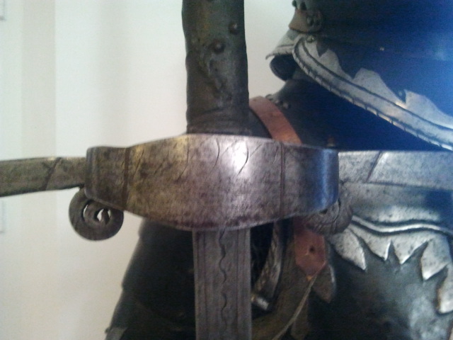

Could you show a close picture of the opposite (left) side of the katzbalger guard ?

Hi Jean-Marc
Beautiful armour and swords!
Can we see some close-ups of the second two hander please (the straight edged blade one). Especially the hilt and guard please.
Thank you

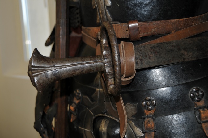

Can you please post some detailed pictures of the Katzbalger, if possible of;
the hilt , the running wolf and all the marks in the ricasso, also of the extremely damaged edge.

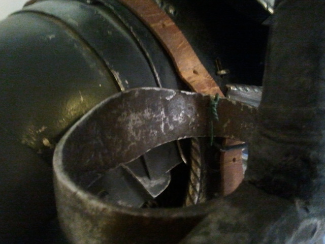

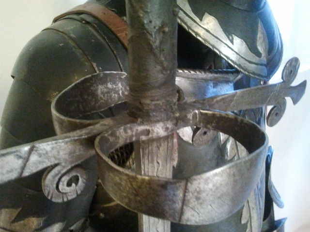

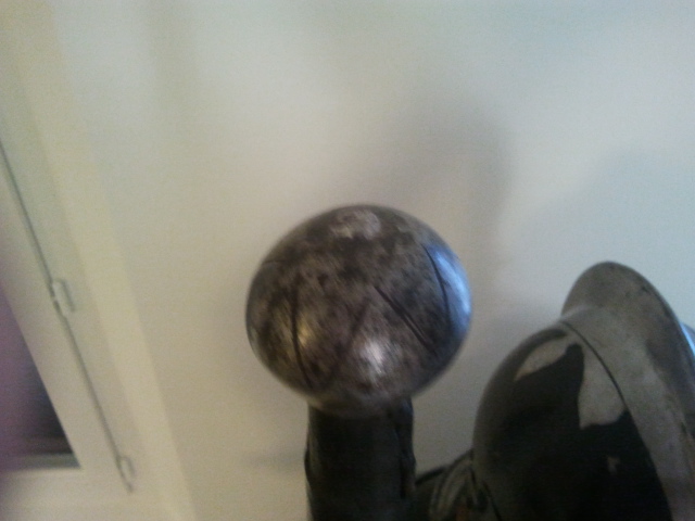

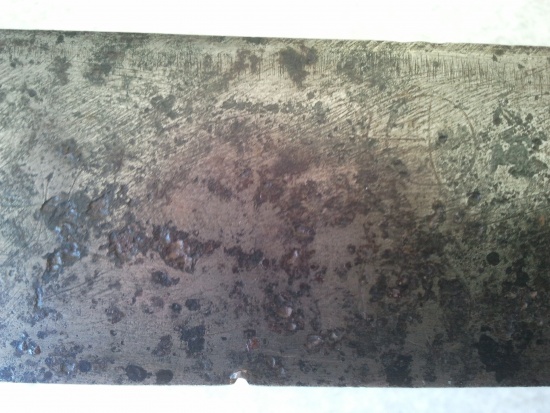

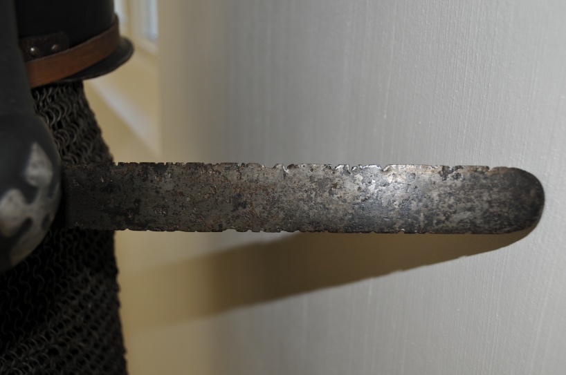

Default Additional pics of two hand sword and katzbalger

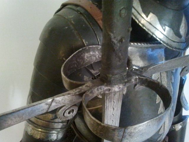

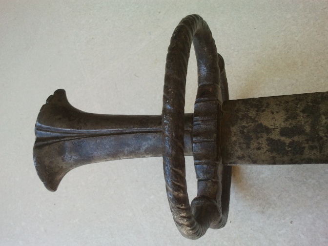

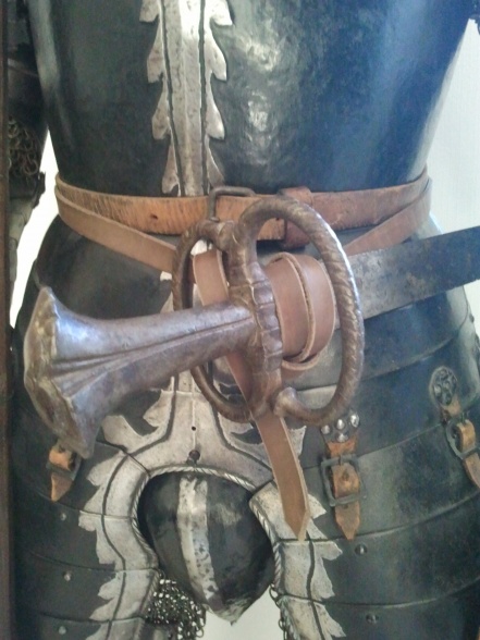

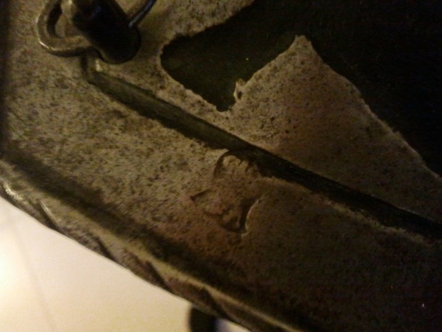

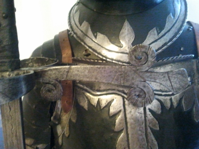

Sorry for the quality of some pics...

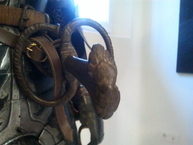

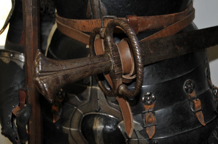

Jean-Marc S. is offline   Reply With Quote
Old 21st March 2012, 06:53 PM   #20
Jean-Marc S.
Jean-Marc S.'s Avatar
Join Date: Mar 2012
Location: France

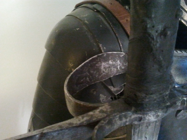

Posts: 104

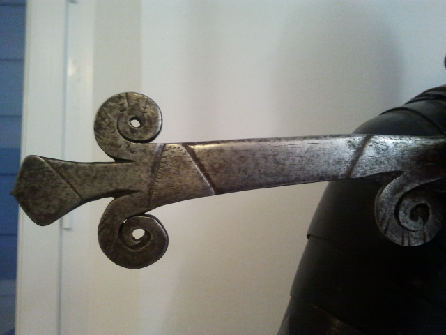

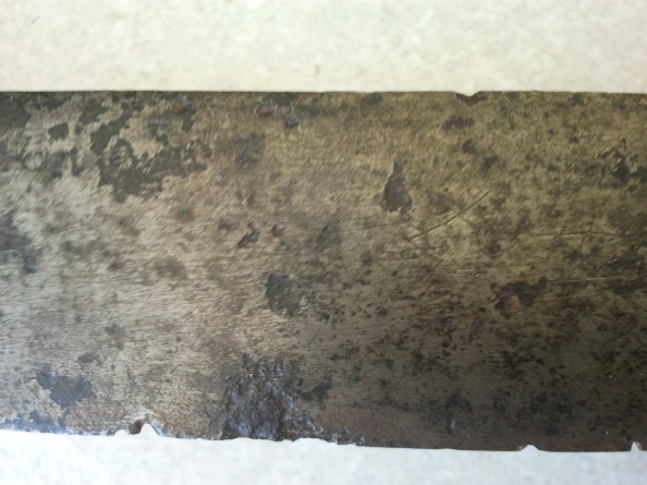

Default Additional pics for details

Default Continued (pics)

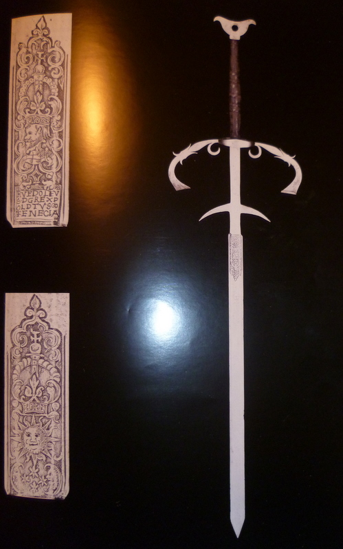

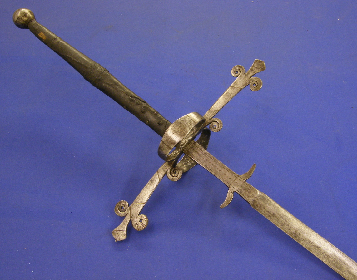

Hi Jasper,

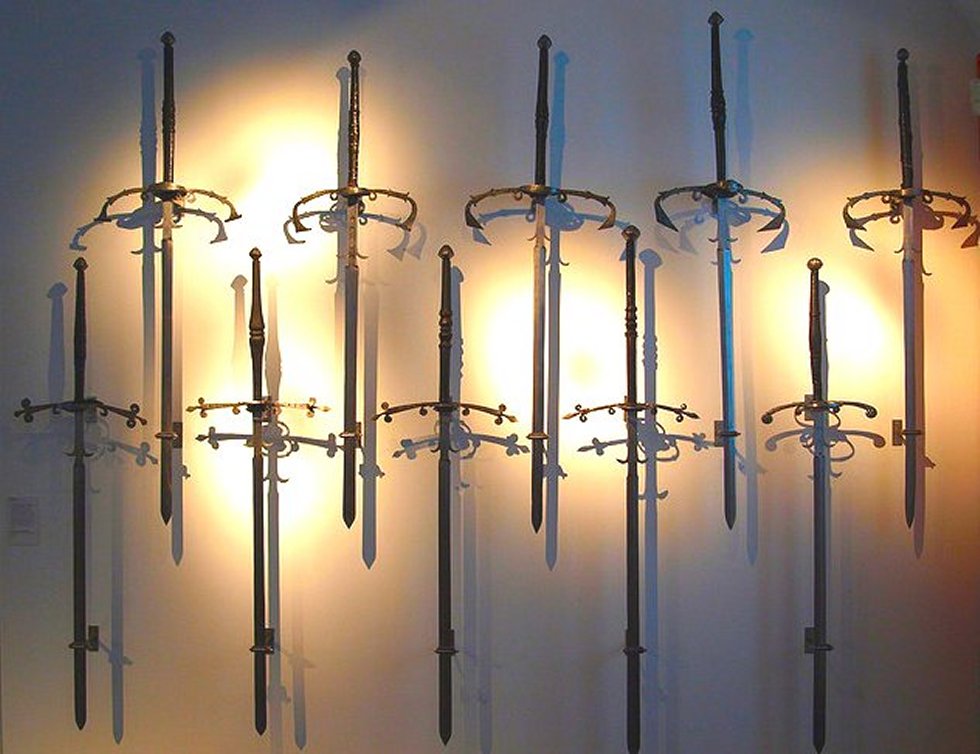

My friend - and I am completely with him - states that that was an old-fashioned first-half to mid-20th century dating unfortunately adopted by Seitz; weaponry has made progress ever since and the correct period assignment for this latest North German type of two-hand procesional swords should be '2nd decade 17th century'.

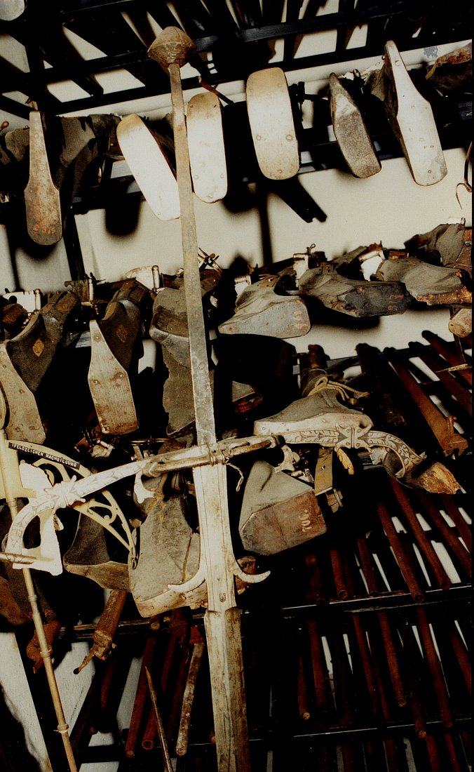

I attach images of a group of those North German two-hand swords acquired as 'Vortragschwerter' (processional swords) by the town council of Emden in ca. 1615 (!), and still preserved in the Emden Amory; one of them (see close-up) is comparable to the one in discussion.
The lower three photos taken by me in the Emden reserve collection in 1992 show a similar North German type, early 17th c., the grip missing, the ricasso with comparable engraved line decoration.
Michael

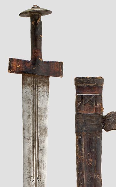

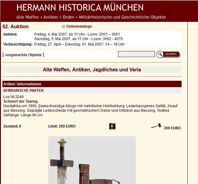

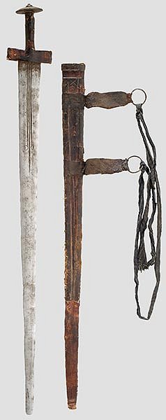

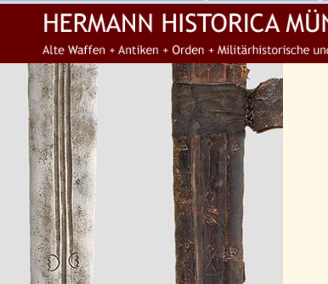

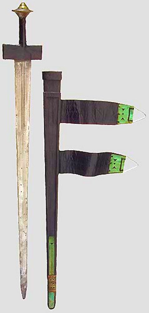

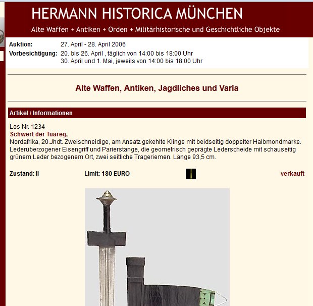

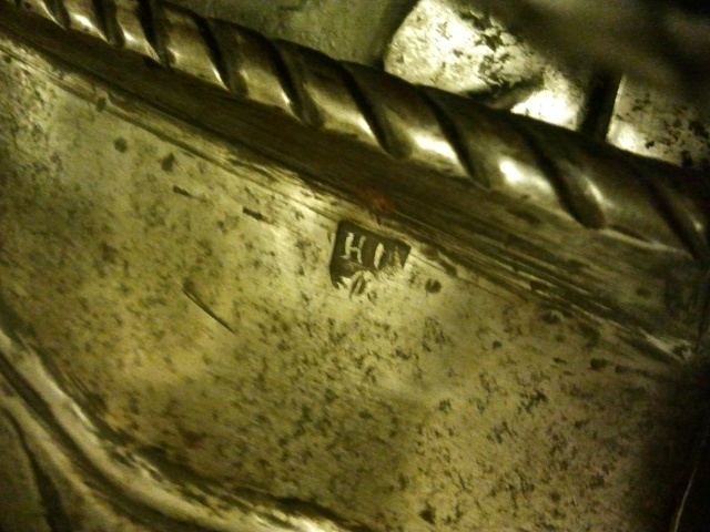

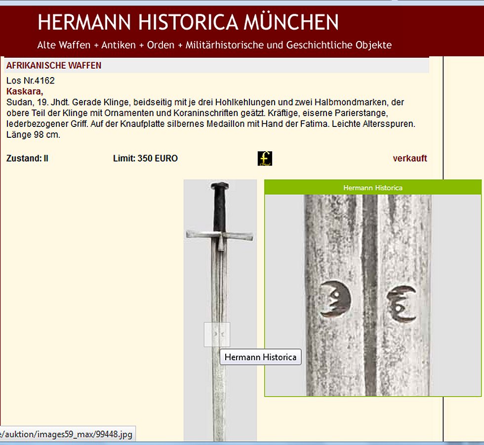

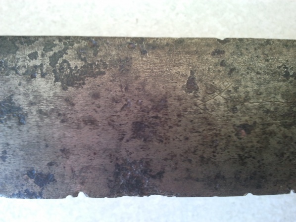

Hi Jean-Marc,

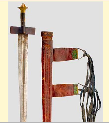

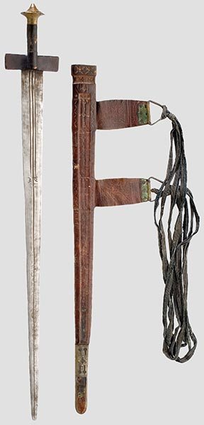

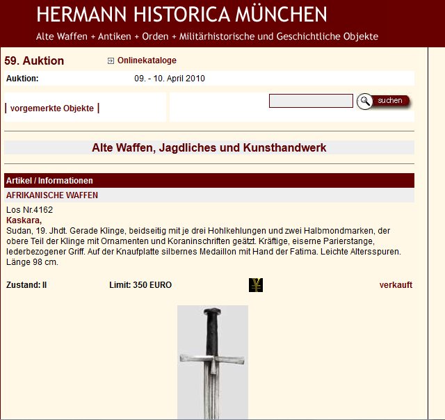

This 'Katzbalger' blade was shortened from a Tuareg sword (kaskara) and bears the characteristic crescent marks which were struck into the cold iron, in contrary to Northern European blades where the makers marks were always deeply stuck into the red-hot iron. The so-called 'wolf' and 'orb and cross' are just primitively and crudely scratched instead of cut with an engraver's gouge - nothing else! All original orb and cross marks are inlaid with yellow metal (line tausia).
In short, I am sorry to state that this is one of the most brutal forgeries I have ever seen ... my word on it! Return it as soon as possible.
Please study my thread on Katzbalgers and show me just one genuine sample with
- this kind of marks
- this kind of blade without the ricasso flutings!
Sorry but best,
Michael

Hi Michael,

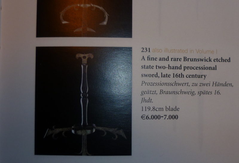

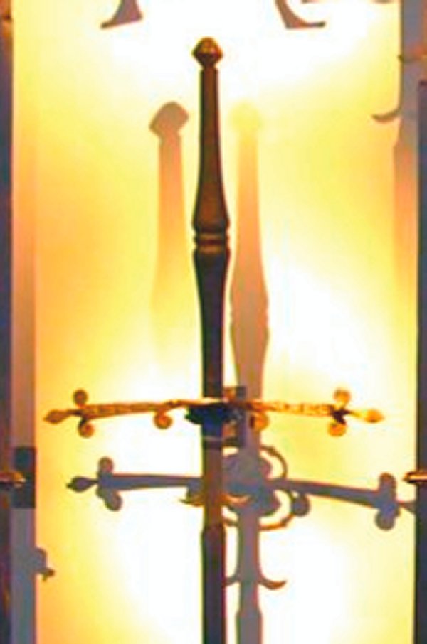

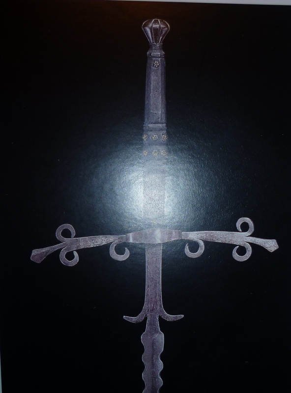

A sword similar type of the sword under discussion is also dated by Thomas del Mar end of 17thC.
see picture. but maybe he has also read from Seitz
The sword you show in the last 3 pictures is a composite 2-hander.
with a cross-guard from the processional swords almost certainly made for the guard of Julius, Duke of Brunswick and Luneburg in Heinrich Grubenhagen.
most of these swords have original blades which are dated 1573,1574,....
a composite Guard of Julius sword with a similar blade as the composite you have posted has been sold by Sothebys 5-15 oktober 2005, schloss Marienburg and is dated end of the 16thC.lot 231.
lot 224-lot230 are original Julius guard swords and all dated 1573/74
I think the 17thC processional swords you are refering to have diamand shaped bars at the guard and flat blades. (Io flat bars and diamands shaped blades)

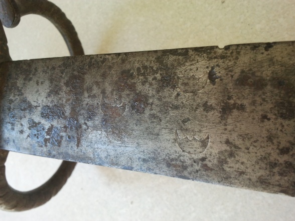

I know nothing about genuine katzbalgers but I'm pretty sure that blade isn't from a Tuareg takouba or a Sudanese kaskara. The half moon stamps used are quite different on Saharan weapons (outline only, not stamping the entire shape like this, and are found in pairs, not the triple arrangement seen here. The profile of the blade also wouldn't fit for a kaskara or takouba. The scratched wolf and cross and orb are similar to some native African imitation marks however.
I don't have the expertise to judge the sword and obviously would bow to superior knowledge, but just wanted to say that the blade and the half moons do not correspond to any kaskara or takouba I've ever run across.
Old 21st March 2012, 11:00 PM   #26
Matchlock
Matchlock's Avatar
Join Date: Sep 2008

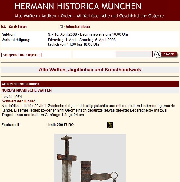

Posts: 4,310
Hi Iain,
Here are just a few samples of Tuareg swords with double crescent blade marks from German sales of the past years; the sales dates are shown in the scans.
The marks on the last one are hardly visible but the description states that they are there.
Please cf.
http://www.swordforum.com/forums/sho...on-Makers-Mark
http://www.google.de/imgres?q=half+m...42&tx=16&ty=68
http://www.vikingsword.com/vb/showthread.php?t=14266
I should say that the experts on the Ethnographic section could tell you more on this topic.
Michael
Old 21st March 2012, 11:12 PM   #27
I am afraid you didn't get Iain's point, Michl
Old 21st March 2012, 11:14 PM   #28
Iain
Iain's Avatar
Join Date: Mar 2010
Location: Olomouc
Posts: 1,720
Hi Michael,
Actually those illustrate my point precisely. The form of the marks is different and typically focused only on the outline, they are also always encountered in pairs. On the katzbalger in question three half moons are stamped which would be incredibly unusual for a Tuareg sword. That is not to say it couldn't happen but it would be entirely unique in my experience.
The profile is also not correct for a Tuareg sword, if it had some decent age the tip would have long ago been narrowed from excessive sharpening and would show heavy sharpening marks as Tuaregs typically use stones to hone the edge with leave very distinctive long striations.
By the way the first sword is in fact a kaskara from the Sudan, not a Tuareg sword, in the case of kaskara the tip is almost always a sharp point, not rounded.
I actually only collect takouba so I am fairly comfortable on the topic which is why I thought I would leave a comment on this thread. You can look at http://takouba.org if you like, which is my website.
Of course takouba and kaskara blades unfortunately often do turn up mated with basket hilts and the like to form modern fakes, but just looking at this blade, I don't think it's from a takouba or a kaskara. However I can't comment on the authenticity of the entire sword as it's very much out of my area of study and experience.
Cheers,
Iain
Old 21st March 2012, 11:15 PM   #29
Matchlock
Matchlock's Avatar
Join Date: Sep 2008
Posts: 4,310
Sorry if I didn't.
I just tried to back up my thesis.
m
Old 21st March 2012, 11:18 PM   #30
Matchlock
Matchlock's Avatar
Join Date: Sep 2008
Posts: 4,310
Originally Posted by Iain
Hi Michael,
Cheers,
Iain
Excellent, Iain,
I guess we are on the same page now - thank you! And I do like your site although this is not my expertise; this hopefully will explain for my mixing up the terminology.
Anyway, my post did not mean to criticize, just clarify.
Michael
