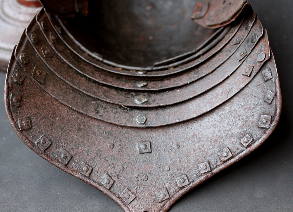

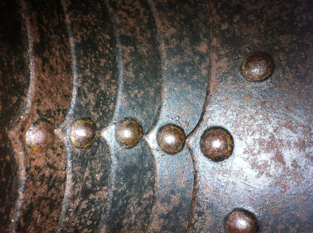

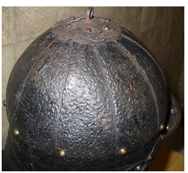

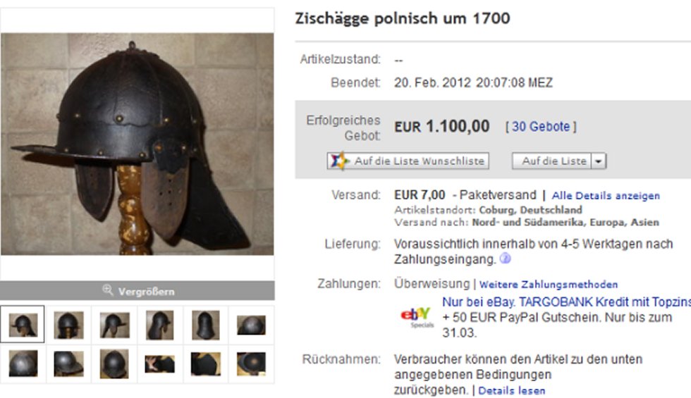

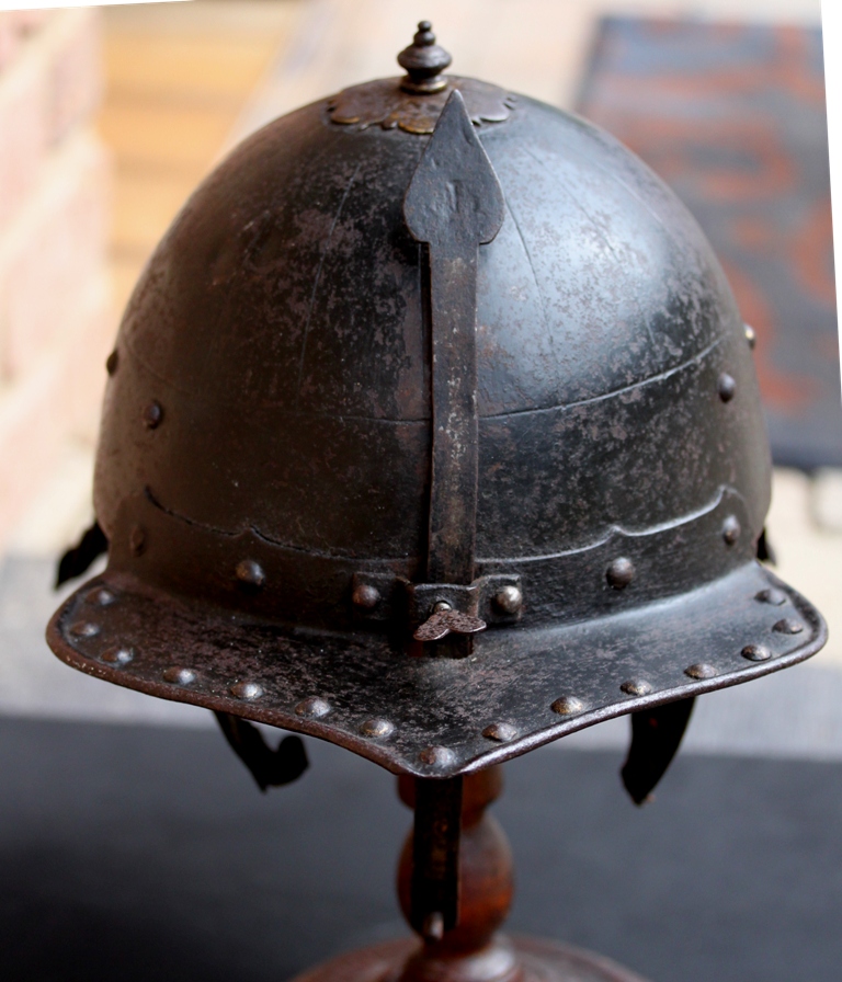

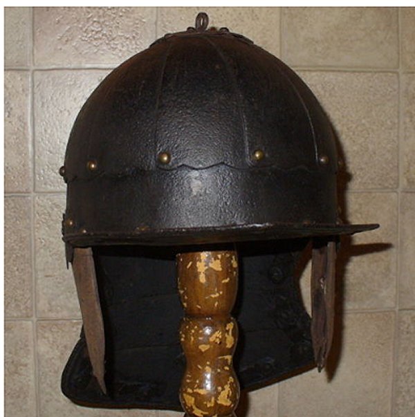

Hi everybody,
I urgently need an opinion on this NORTHERN EUROPEAN HELMET ZISCHAGGE said to be from the 17 TH Century, as i don’t have any knowledge in this kind of helmets. I ‘m sorry for the bad quality of the pictures, they were taken with my cellphone. I will be very happy to have some opinions and to be informed in the case that this helmet has something suspicious, for example the Nasal protection or Ear plates ….
I hope I will have some advice about this helmet.
Cerjak

Old 3rd March 2012, 02:07 PM   #2
Cerjak
Cerjak's Avatar
Join Date: Jan 2012
Location: FRANCE
Posts: 1,065

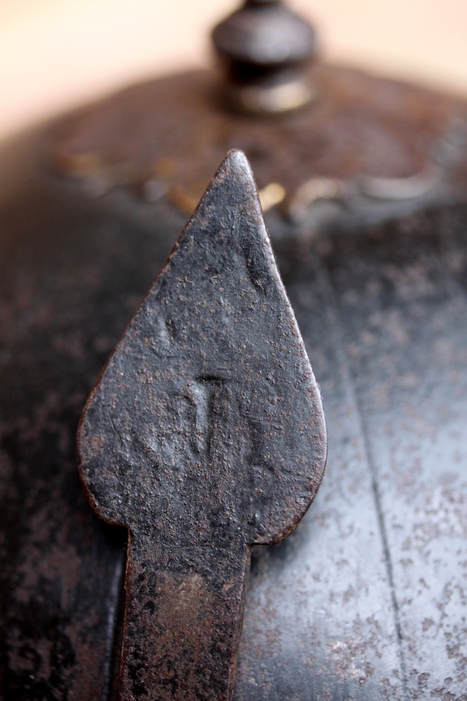

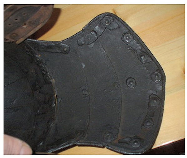

Default more pics
more pics

Hi Cerjak,
Sorry to see that nobody has responded so far.
My expertise in parts of armor is very limited, and my expert friend whom I linked with your query has not yet replied.
Telling from the surface condition and the visible criteria of manufacture, like the patina, washers etc., I would not doubt that this is an original Zischagge from the second half of the 17th c., probably of Polish origin.
Sadly I cannot answer your detailed questions with sufficient authority but I noticed a similar piece ending on ebay a couple of days ago, which my friend thought was a fake; I differed from his opinion and it fetched 1,100 euro.
Hoping this will be of at least some help,
best,
Michael

Hi Cerjak,
Finally my friend contacted me. He, too, thinks that the Zischagge is completely genuine but might be a bit younger (later) than I thought it was, probably from the period of Prince Eugen, ca. 1700, and most probably from the Balkan region.
Michael

Hi Cerjak,
Michael
Michael
Many thanks for those information’s.
I could see some differences on the fabrication between those 2 helmets. This one from your post don't have nasal protection and the Ear plates seems to not fit with the helmet. The laminated tail over the back of the neck is build with 3 plates of metal only.
and fabrication process is hidden by the black paint ,it seems that a double layer of metal was used to made the bowl but we can't see from the inside the rivets.
I would like to say more but with my Basic English it is difficult to translate my full opinion.
I will have a look too in this fantastic book from George Cameron Stone "A Glossary of the Construction, Decoration and Use of Arms and Armor in All Countries and in All Times "
On it there is so many photos (only small size and black& white) but it is a so exhaustive book for the period!
Kind regards
CERJAK

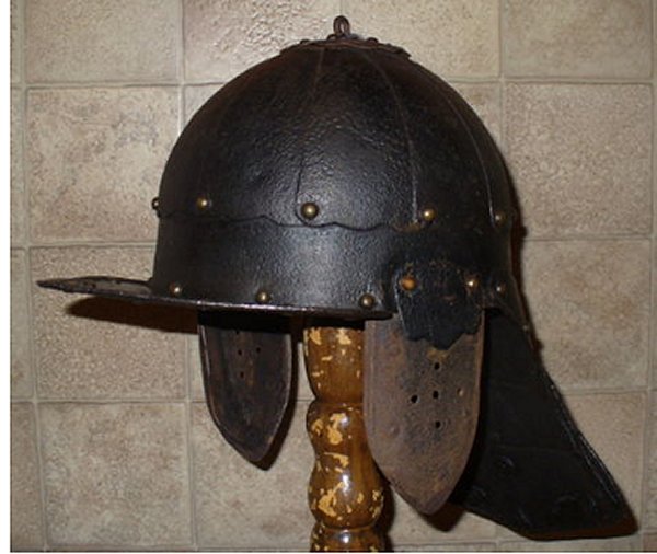

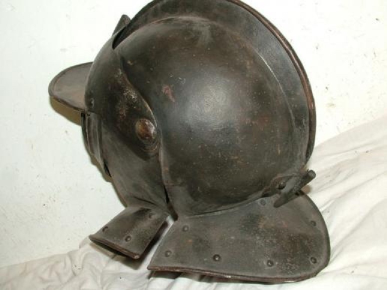

Old 4th March 2012, 05:23 PM   #7
Norman McCormick
Norman McCormick's Avatar
Posts: 1,657

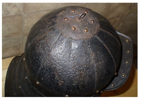

Hi Michael,
Any ideas on this one of mine, I long thought it was a Victorian creation but one never knows.
My Regards,
Norman.
P.S. Cerjak, please excuse my hi-jacking of your thread but as it is in the same vein I hoped you wouldn't mind.

Hi Norman,
As far as I can tell from your images, the one you posted is definitely a Victorian (Historismus, 19th century) copy. It shows no traces of hammering, and the rivets do not have the raw but useful washers, let alone does the surface have the rich rust patina above an old layer of black arsenal lacquer.
And: sometimes one does know ... and can tell.
Michael

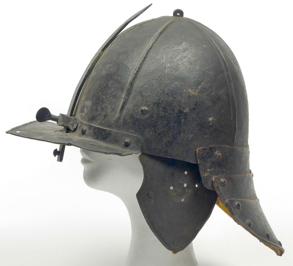

SERGIU
SERGIU's Avatar
Join Date: Jan 2012
Location: Timisoara, Romania
Posts: 32

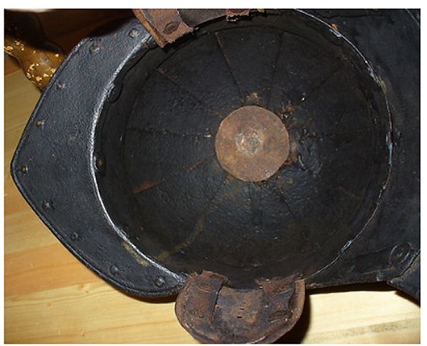

Cerjak, the lobster tail helmet expert was right, it really is an austrian helmet from around 1700, prince Eugene s army fought major battles in the Banat region taking Timisoara from the turks in 1716, and in our museum helmets identical to yours are clasified as austrian, army of Eugene of Savoy .
SERGIU is offline   Reply With Quote

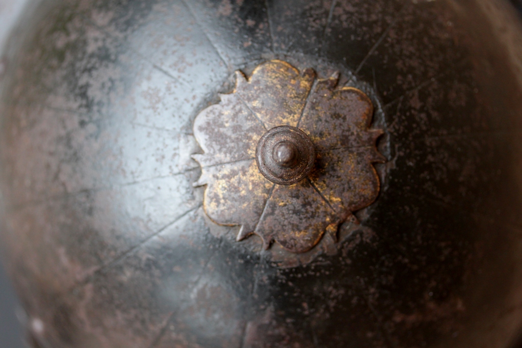

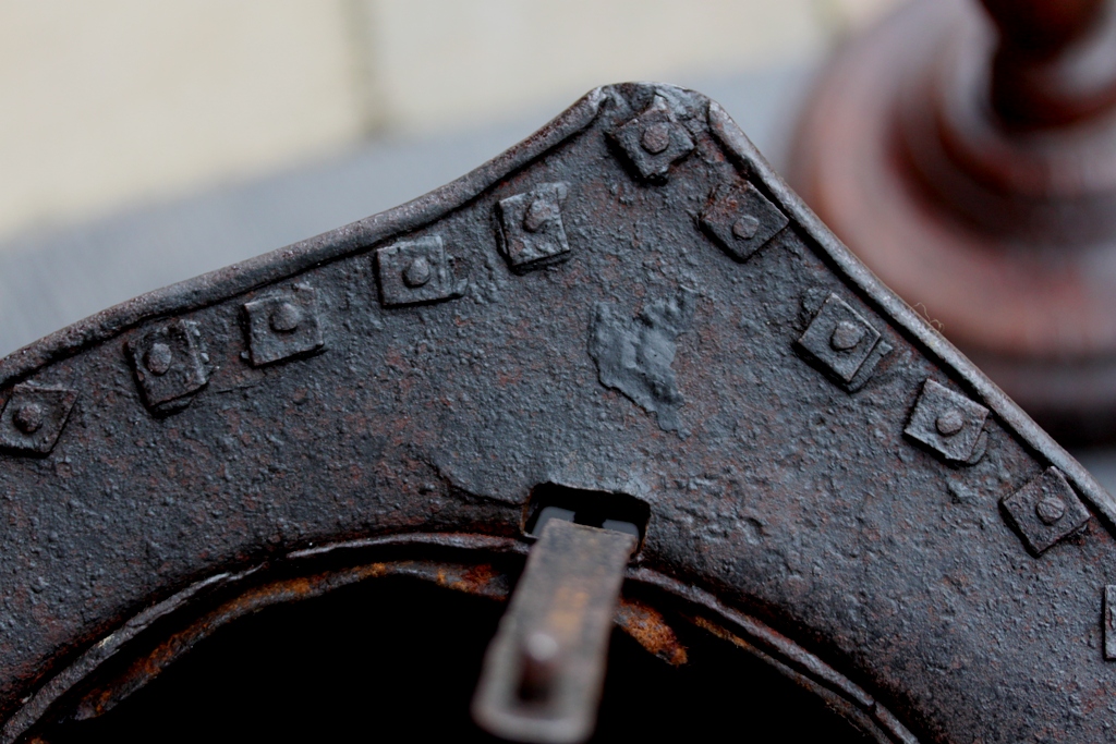

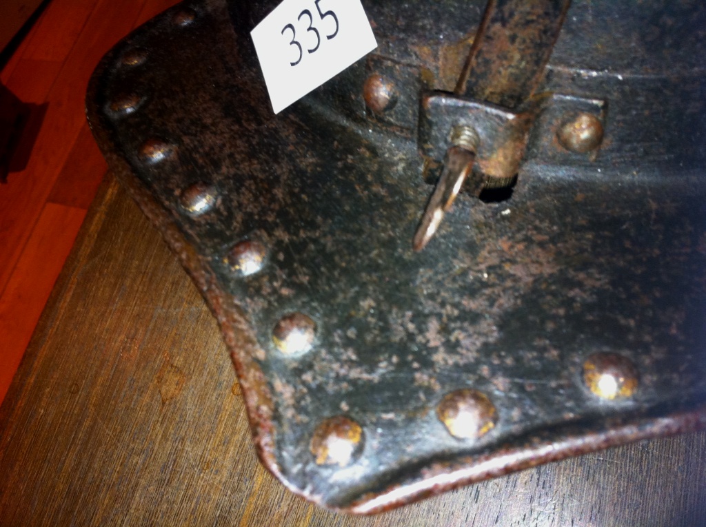

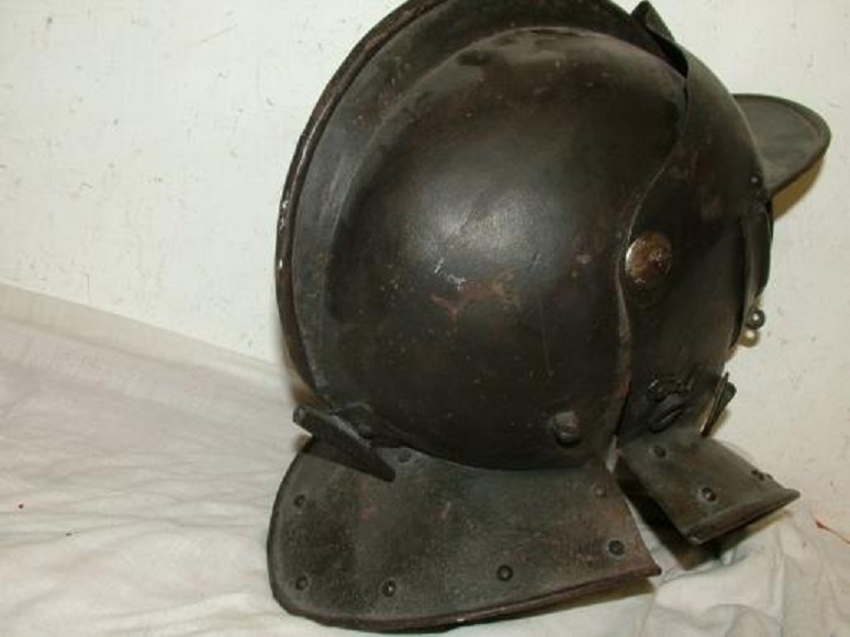

Default new pics
Dear Sergiu
I just add some better pics ,the last one was not so good.
You could see that there is some rest of black paint ,Do you thing that it could be the original colour ?
I will be great if you could post some pictures from similar helmet from your museum.
Kind regards
Cerjak

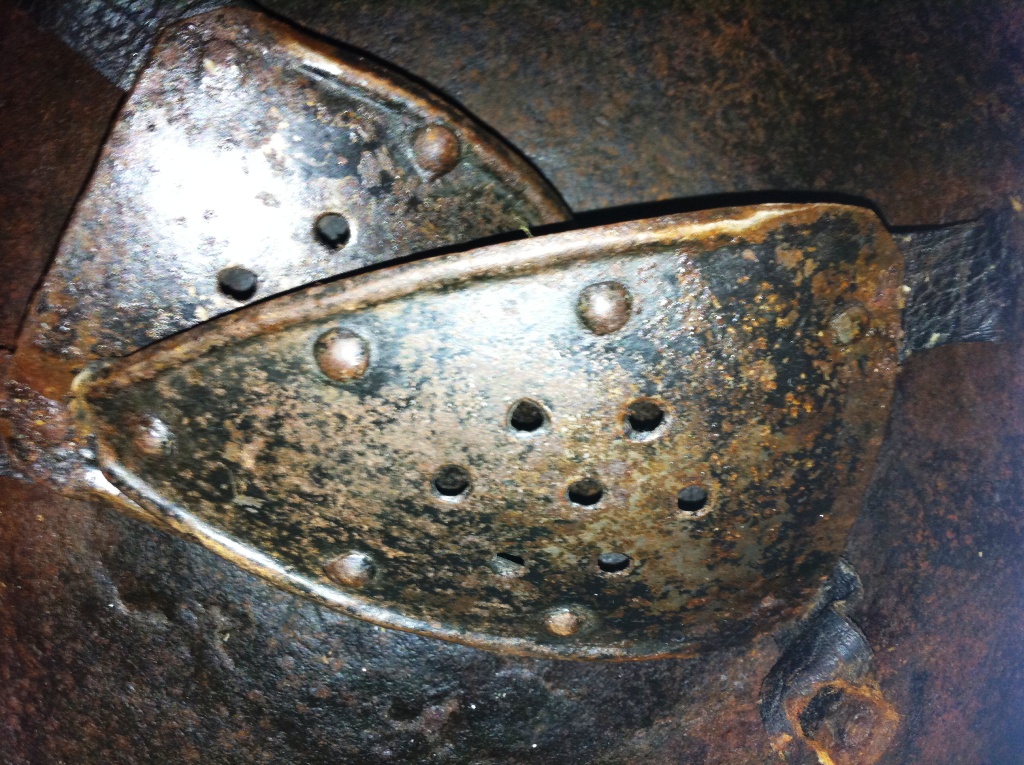

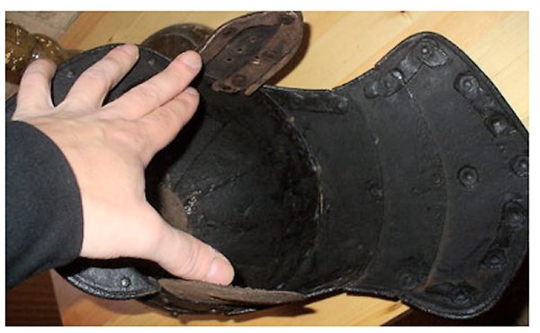

Default MORE PICS
MORE PICS

Hi Cerjak,
I noticed that black varnish already in your first images. It is characteristic old arsenal paint used on many weapons, including firerarms, and items of ironwork as a means of conservation. It should in any case be preserved!
Michael

Default NEW PICS
NEW PICS

Hi Cerjak,
Michael
Hi Michael
Do you have any idea how I could preserve this paint and in the same time stop the rust .
I only want to preserve this helmet exactly as it is untouched.
Jean-Luc

Hi Jean-Luc,
My recipe proven best for over 30 years - and many hundreds of years of arsenal care before! - is, as always, olive oil.
Not only will it stabilize and preserve the remains of lacquer, it will at the same time intensify the original surface color!
Michael

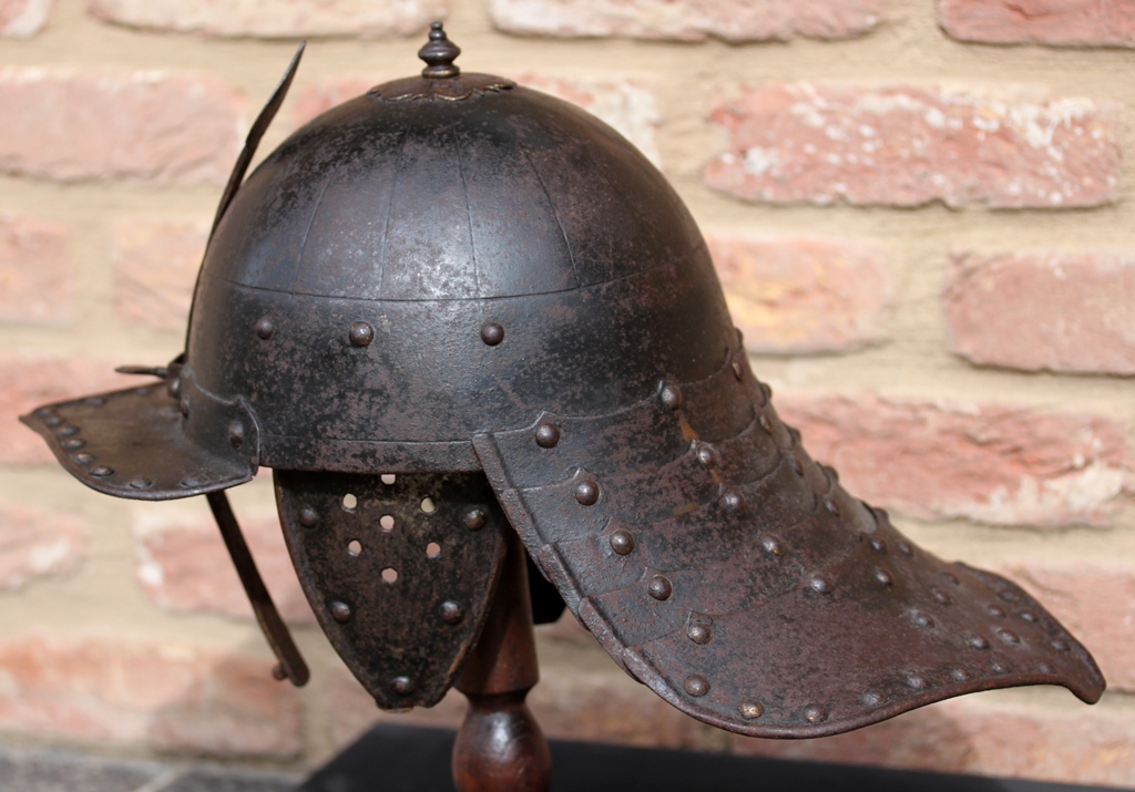

cerjak, I just read the new posts on this thread and it s sunday, but on one working day next week I ll make some photos of our lobster tail helmets and post them here. Black paint was indeed used on our metal items as way of preservation in the past. Currently we use mainly Ballistol weapons oil but olive oil will be tested too starting from now
Thank you Sergiu
It will be great to see your photos.

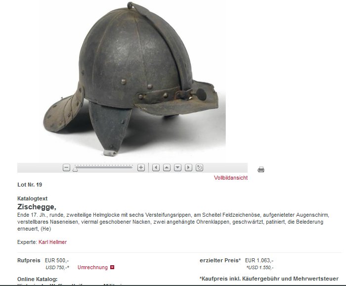

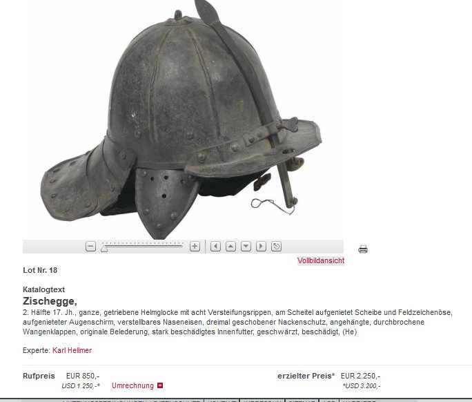

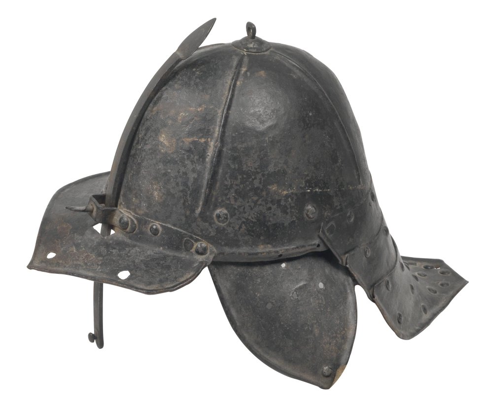

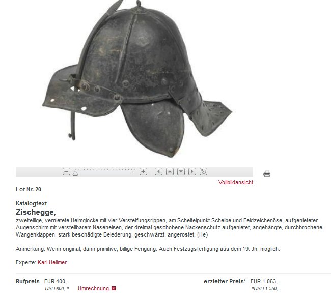

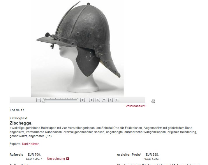

Default Four Zischagges Sold at a Vienna Auction House
For results please see right bottom corner of description scans.
m

Michael,
Thank you to have find the time to send those other Zischagge photos.
Now I can see that my Zischagge is in fantastic condition and also much more elaborate helmet.( specially the The laminated tail &eyeshade )
Of course I have paid much more for it but don't have any regrets.
I will follow your advice and he will have this week end his olive oil and nothing else !

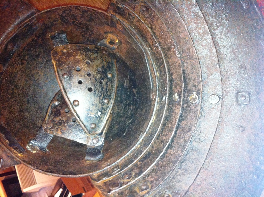

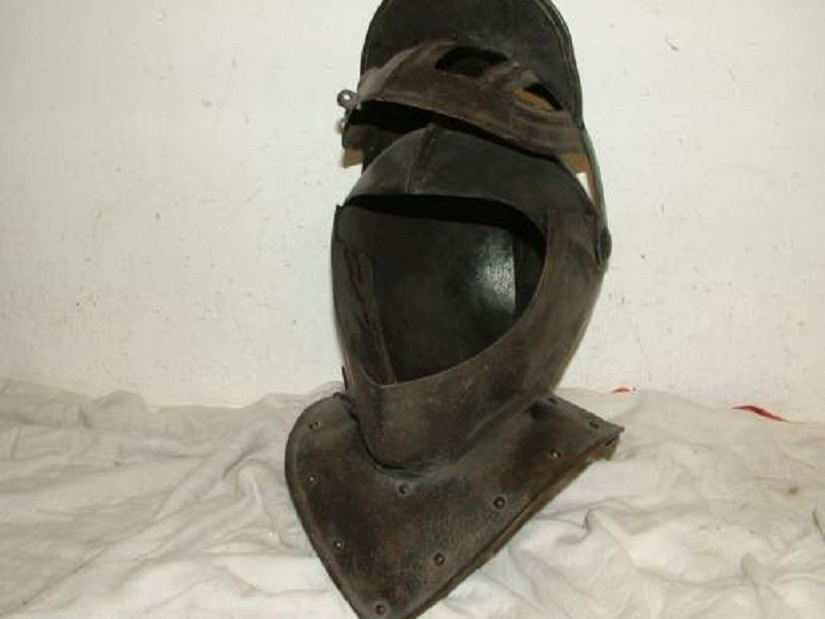

Default New helmet
[QUOTE=Matchlock]Hi Cerjak,
Thank you for taking the words right out of my mouth on preserving patina and causing as little surface change as possible!
I, too, have seen too many completely overcleaned and brutally ruined pieces and have often uttered my opinion here on the forum. There are different opinions on this matter however, which we all have to accept in the end.
And: as long as museum people keep killing patina and presenting surfaces shining 'as new' - which those items mostly had not when they were actually new hundreds of years ago! - the collector's view will be spoiled and he too will tend to follow the 'example' given by so-called 'authorities' and will kill the surfaces of his weapons as well ...
Finally, you are absolutely correct about the fact that the solid quality of your Zischagge cannot be compared with the lesser items I posted, so you really should not worry about paying more!

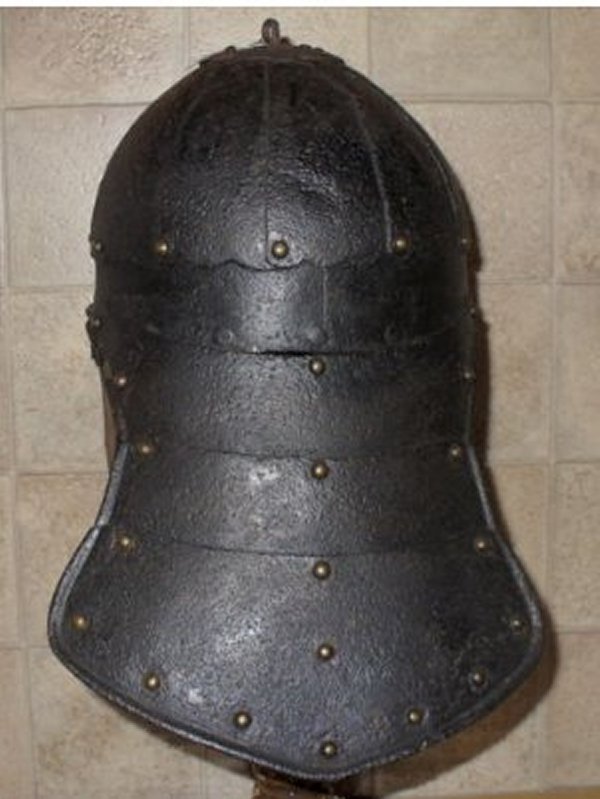

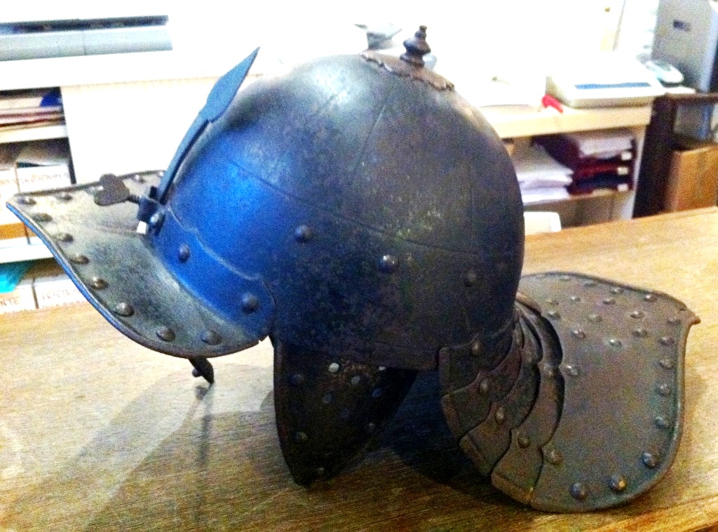

Dear Michael
Once again could you give me your opinion for this helmet said to be a German Helmet From early 17 th century.
In my eyes it seems to be a nice one but I always afraid to do a mistake.
I hope you could help me ...
Best regards
Cerjak

Hi Cerjak,
Thank your for trusting me that much but as I have stated various times, pieces of armor are not exactly my field of expertise.
Telling by your photos though, I would say the helmet looks very good and original; it reminds me of similar helmets which are part of late field armor (Feldkürisse), Thirty Years War, in the famous Graz Armory; many of them were supplied by a Styrian maker in 1635, so a date of ca. 1620-30 seems quite right for your helmet.
It also seems close in style to a Savoy helmet.
I do hope this will help a bit.
Michael
