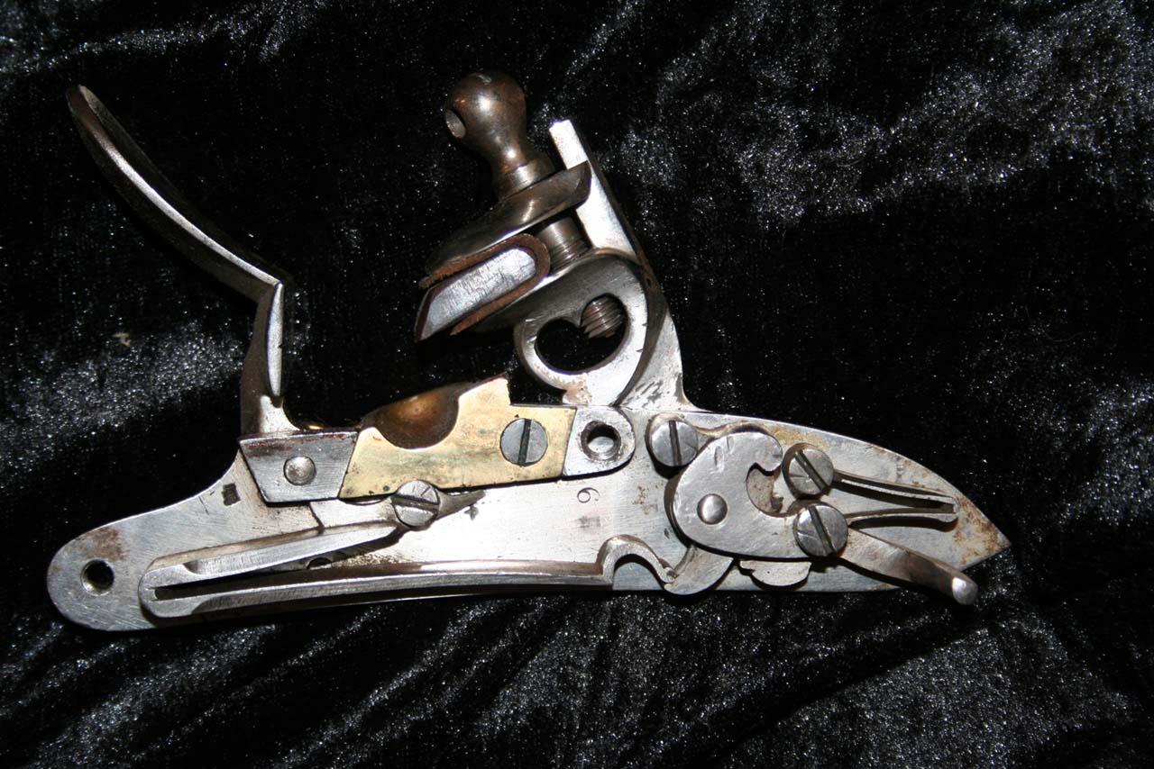

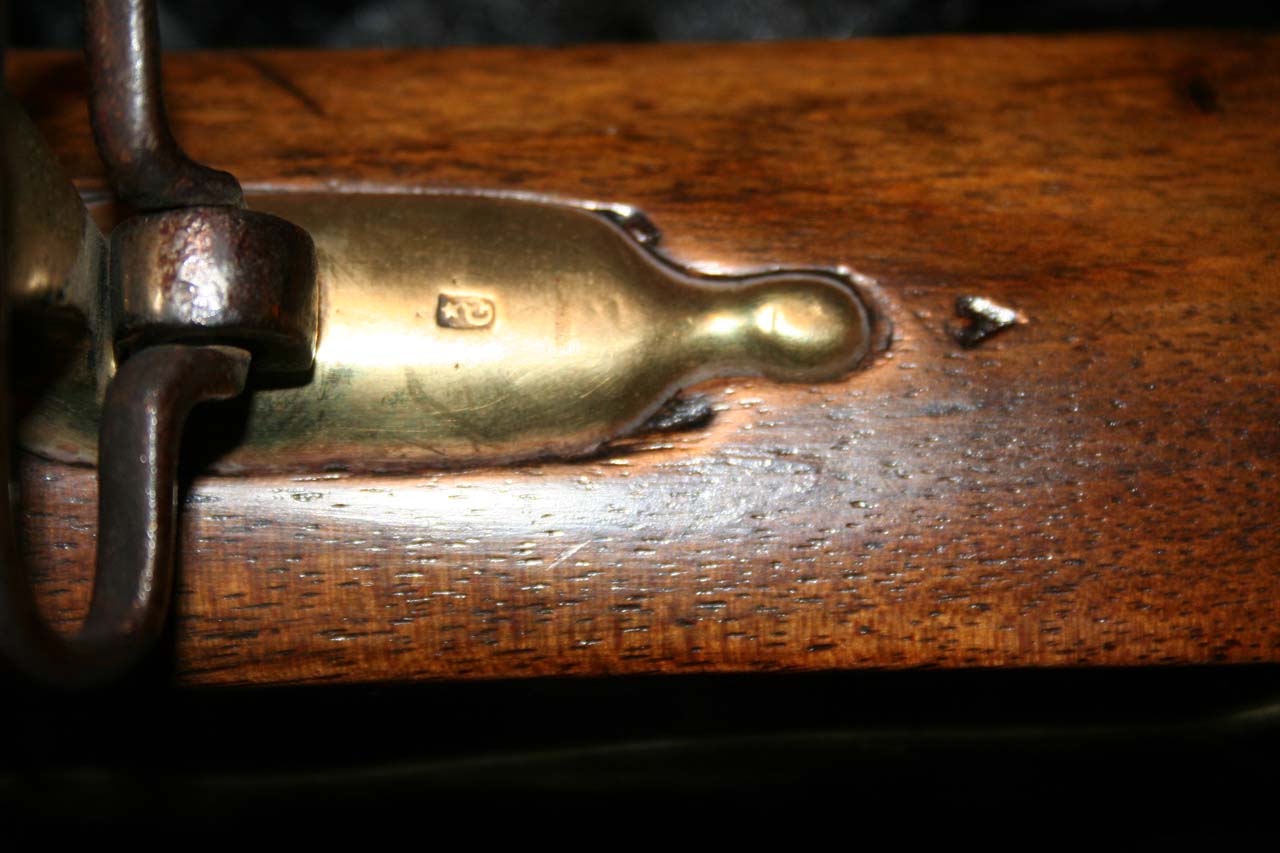

hi. Can anyone please let me know what this lock is off, age etc. thanks, michael

French, for a musket or pistol like model AN IX (1777).
See HERE and HERE

Posts: 1,633
Agree with Fernando. Lock is in nice condition. Good find. Rick.

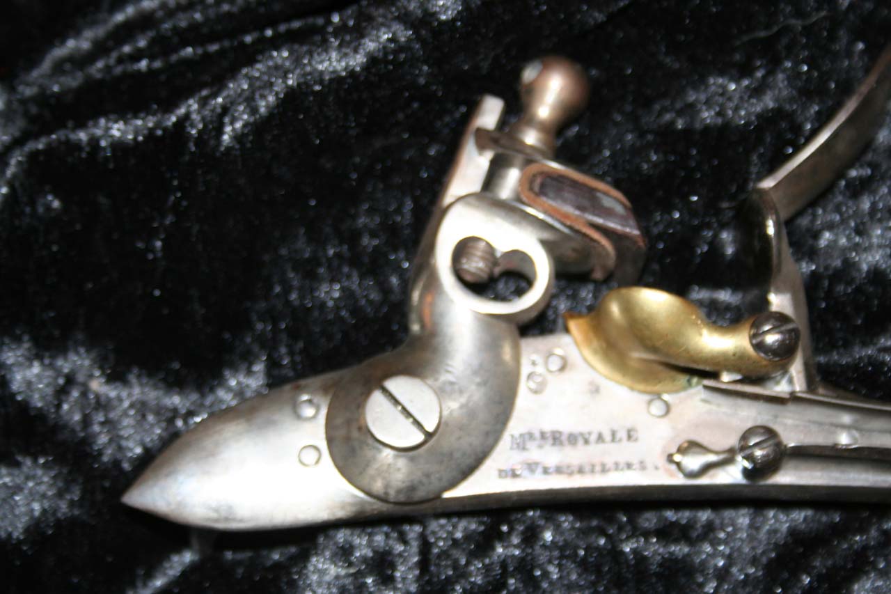

Hola a todos:
Para mí, se trata de una falsificación: La palabra "Royale" indica que está construida después de la época napoleonica, con la restauración de la monarquía y no corresponde a los modelos "reales", construídos en 1816 y despúes, que tenían la cazoleta (pan, bassinet) con guarda-fuego, si bien, igualmente, de bronce
Hello all,
For me, this is a fake: The word "Royale" indicates that it is built after the Napoleonic era, with the restoration of the monarchy and does not correspond to the models 'real', built in 1816 and later, they had the bowl (bread, bassinet) with guard-fire, but, equally, bronze
Sincerely from Argentina. Fernando K
Afectuosamente desde Argentina. Fernando K
Old 11th November 2011, 06:51 PM   #5
Alright Fernando, you got a point; model 1816.
But why a fake ?
The lock plate of pistol model 1816 de la Garde Du Corps du Roy also had a pan with "guarda fuego"
http://pistol3d.com/silex_garde_corp...orps_2_gn.html
http://armesfrancaises.free.fr/pist%...oi%201816.html
Old 11th November 2011, 07:40 PM   #6

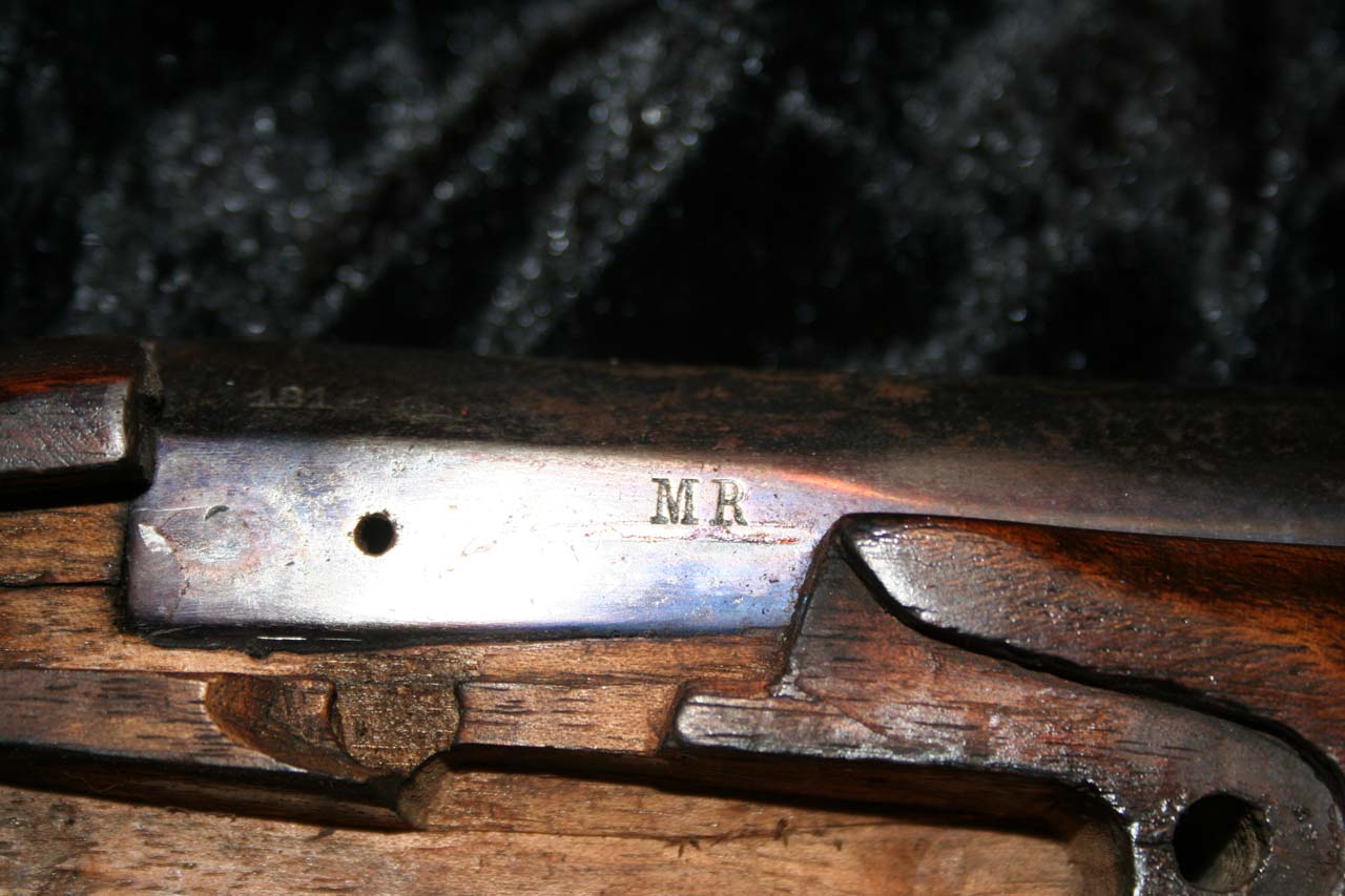

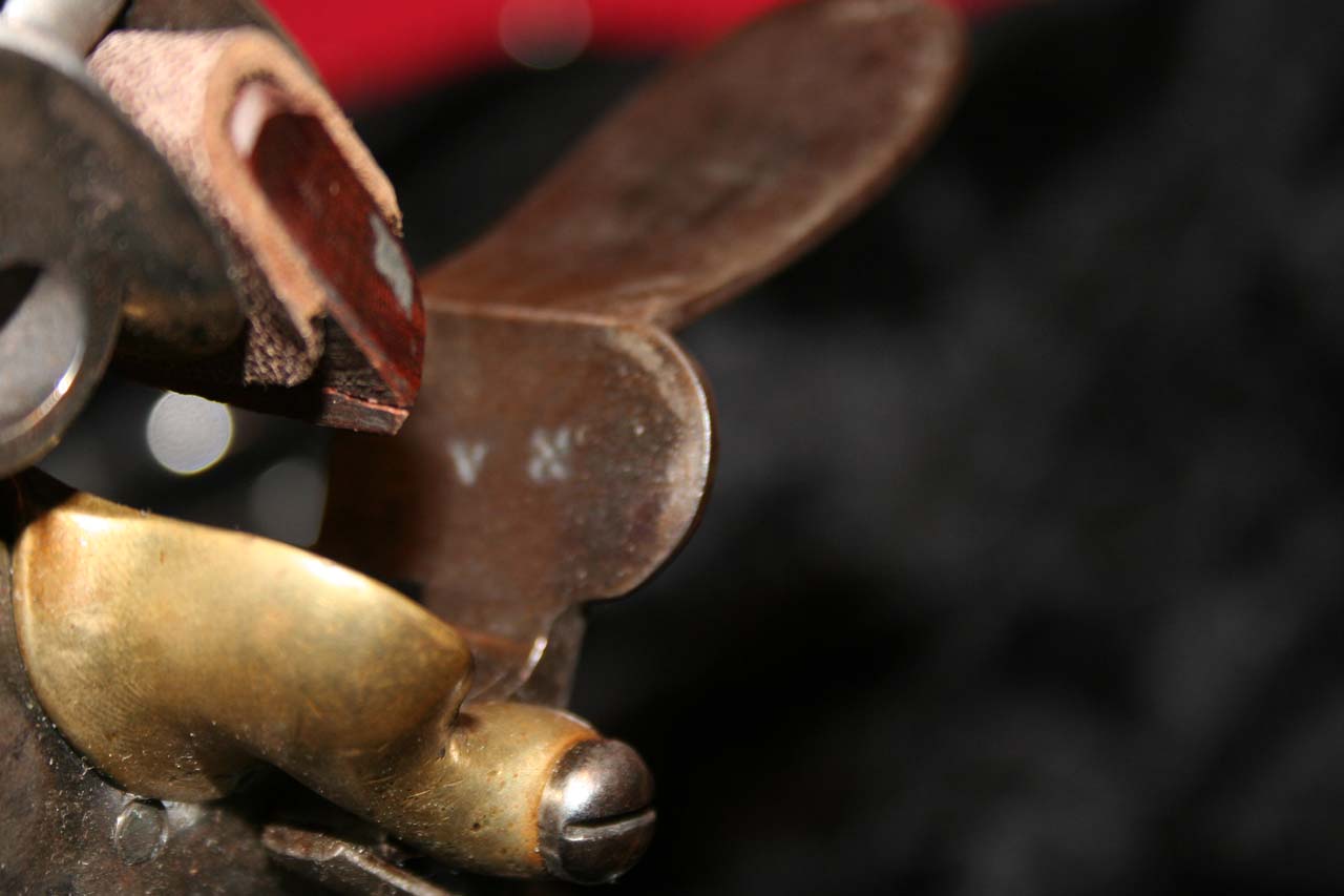

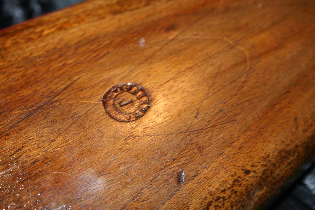

hi, thanks for the feedback. here is some more information on this musket.

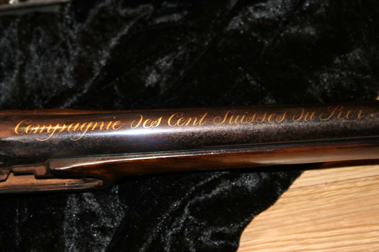

I have also found on the flintlock plate the following what looks like a stamped G with a very small stampd fleur de lis above this.on the frizzen plate are the letters VX. on the barrel near the touch hole is stamped the letters MR also on top surface of barrel are stamped H and in an oval stamp the letter G with a small star above. there are also 3 letters i can,t make out.on the trigger guard again in oval stamp is the G letter with the star above. the stock as the letter V stamp and on the plug a number 1 in the middle and what looks likeversailles around that. along the barrel are in gold the words compagnie des cent suisses du roi
ok chaps what do make of this, I can,t find any information on this at all, bar knowing that the cent swiss was part of the french royal guard.
michael

For more information on the 'Cent Suisses", the Papal Guard, which existed up to 1830, called Hundertschweizer in German, please see
http://en.wikipedia.org/wiki/Swiss_Guard
As the barrel of your musket is signed in gold we may safely assume that it once belonged to a soldier of that elite Papal Guard. I therefore think that you have a very fine and quite expensive item. Please keep it in the present optimum condition and don't clean the surface!

Hi Michl,
Apparently the cent suisses also served in France.
From the link you quote:
"Two of the eight infantry regiments included in the Garde Royale from 1815 to 1830 were Swiss and can be regarded as successors of the old Gardes suisses."
From this link:
"Le corps est supprimé en 1792 par l'Assemblée nationale, rétabli en 1814 par Louis XVIII et subsiste jusqu'en 1830."
I would swear those inspection marks on the trigger guard (and not only) are French poinçons.
Also the gold inscription says Cent Suisses du Roy

thanks chaps, my understanding is that this is a french musket made in versailles for the swiss cent guard, a 100 man unit armed with muskets and forming part of the maison du roi. louis xv11 had this unit reformed on is return to power in 1814 and these man went with him on the return of napoleon for the 100 days that he was again in power. the guard returned later for a time on napoleons fall but was later disbanded.
I can,t get anymore information on this weapon or the cent guards uniforms of the time etc. and yes its a very nice weapon with the blue and gold barrel. and it will just have a coat of renaissance wax durring the time its in my care, michael

Hola a todos
Confieso que me apresuré. Hay llaves (lock) producidas a partir de 1814 que tienen la expresión "Royale", pero la cazoleta (pan) sin guarda-fuego e inclinada. Entonces, la fecha de la llave es a lo sumo de 1814 o posterior.
En cuanto al post (tread) inicial deTerry, es un poco tramposo, porque nos ha presentado la llave sin decirnos que pertenece a un mosquete (fusil) de guardias suizos del Rey.
Los "Cent Suisses" formaban las 4 compañias, conjuntamente con los "Marchaux-des-Logis", en la "Maison du Roi"
Hi all
I confess that I hastened. There are keys (lock) produced from 1814 that have the word "Royale", but the bowl (pan) without guard-fire and inclined. So the key date is at most of 1814 or later.
As for the post (tread) initial deTerry is a bit tricky, because we have been presented without saying that the key belongs to a musket (gun) of Swiss Guards of the King.
The "Cent Suisses" were the four companies, together with "Logis des Marchaux" at the "Maison du Roi"
Affectionately. Fernando KAfectuosamente. Fernando K

hi chaps, did not wish to mislead in any way, just wanted to know what date you placed on the lock without knowing anymore about the weapon, it would of just been so easy to say well its so and so on seeing the whole musket. as you now know its a 1814 date french Charleville musket for the swiss cent guard of louis XV111. the guard was made up of 100 men armed with these very nice looking muskets each made to the highest standard of the day. On the return of napoleon the cent guard went with him. they did not reform after the 100 days. michael
