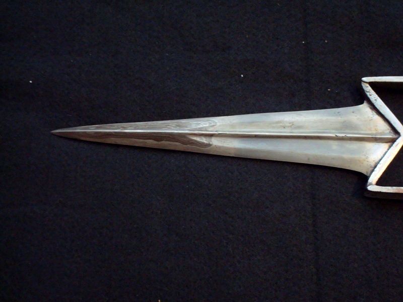

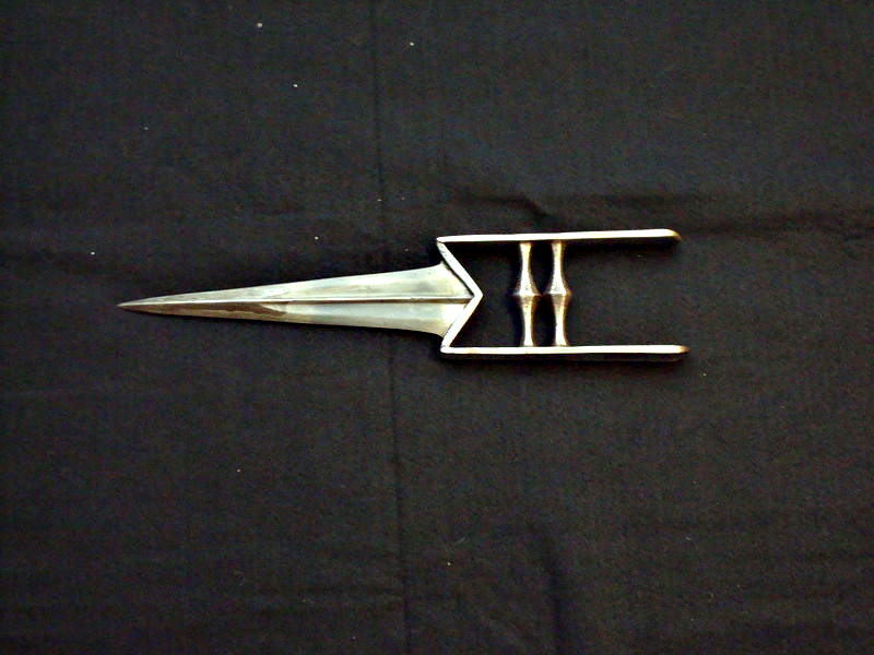

Here is a strange beast. I picked this up this week and it arrived the other day. Now all of the katars that I have seen are made from one type of wootz blade or another but this one is pattern welded. It is quite heavy and thick compared to my others. What I find interesting is the dark steel at the tip. I have seen a number of wootz katars with the tips broken off this makes me think that these wootz tips were a bit on the brittle side? Maybe this smith forged this one out of pattern welded steel to give it a more resilient tip.

Your logic does make sense. Wootz is brittle. When it comes to sword blades, it has great strength against cutting-edge directed impact, but not against front or side impact. This katar may very well be an attempt to addres this weakness (perhaps similarly to scarf-welding effect and heat-treated/tempered edge). I cannot think of another examples/references, but you may be on to something. Good thinking!

I agree that we do see a lot of Katar with tips missing and this would seem to be an excellent method of strengthening that area.

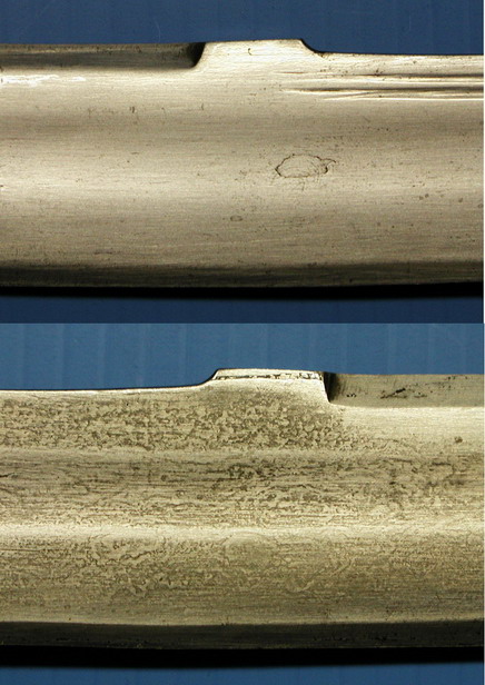

Hi Gentlemen,
I believe the sword you are referring to is owned by Jens, see attached photo.
Regards to all those in their 'dotage'.
Norman.
P.S. It was mentioned in a thread that I started so perhaps I have an unfair edge!!!!!!!

Scarf welding is one of Indian blade making techniques, was done intentionally for purposes of enhancing blade's capacity/resistance against impact. It normally joins plain steel and woots near blade's base. Neither this partucular katar nor Jens' sword are examples of scarf weldeding in it's classical form.
