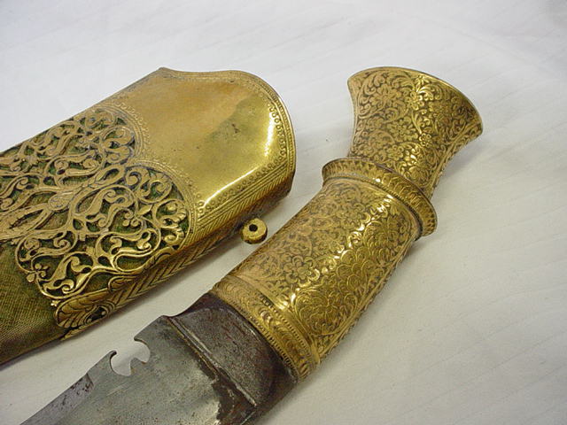

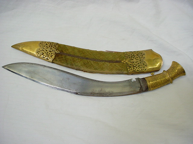

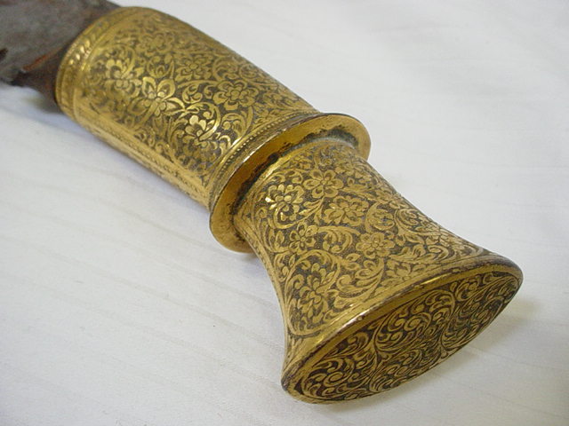

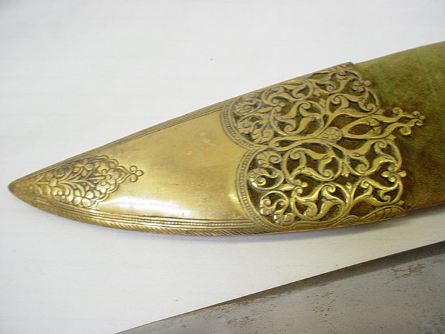

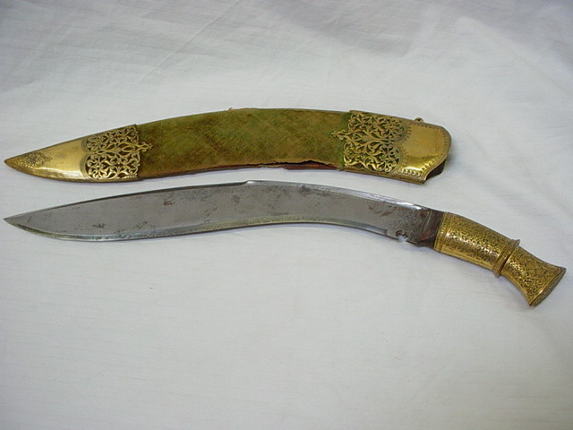

Here are the other pictures for our archives. I believe it to be North Indian with gold over copper. Notice the second edge on top of the blade. It went for $1900!

the seller seems to think the fittings are brass? But surely looks to be gold.
Whats up with the blade along the spine? has a style i havent seen before, the pics arent clear but looks like almost liked its double edged?
one of a kind no doubt, would love to hear what spiral thinks of this one?

The spine is a T-spine until you get to the second edge on the back. Yes a unique piece. Indian versions of the kukri are various.

Lovely piece, Looks gilt on thick brass to me, as Battara says clearly Indian, nicley forged T spine, must be from between 1875 to 1930 I would think, interesting hanging loop for wall hanging, {should be two, with chain between.} Ive normaly seen that on 20th century pieces.
Apart from kaudi bieng in existance not that much Hindu symbolism. I wonder if it could be a Sikh piece?
Definatly a prestigious kukri,though!
Spiral

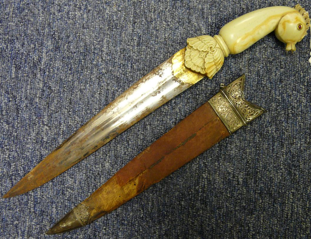

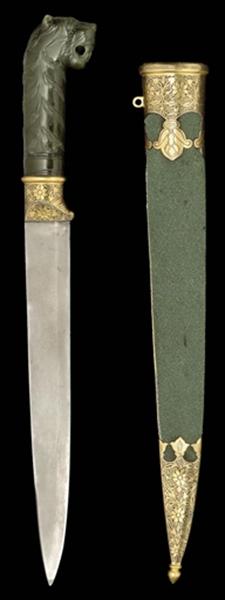

The single loop aspect is also pure Indian as per the images attached and note the daggers in figures 215, 216, 221, 222 & 224 of Arts of the Muslim Knight.
Gav

I have not seen any period paintings close enough but I suspect, as these weapons all appear to be sash mounted, that it was for a safety chain.
Fig 215 quoted above shows a small silver loop chain, perhaps the sash was fed through this loop before being wrapped on the body.
Other suggestions , a decorative or votive charm might have been hung from here....but I think a safety chain/loop....who wants to drop anything on the run.....
It sure is a looker, but why the second edge? That has me puzzled.
Old 19th July 2014, 10:29 AM   #24
spiral
Posts: 1,712
Sorry for my slow repley , just came across this thread while researching something....
In one word.
Stabbing!
Spiral

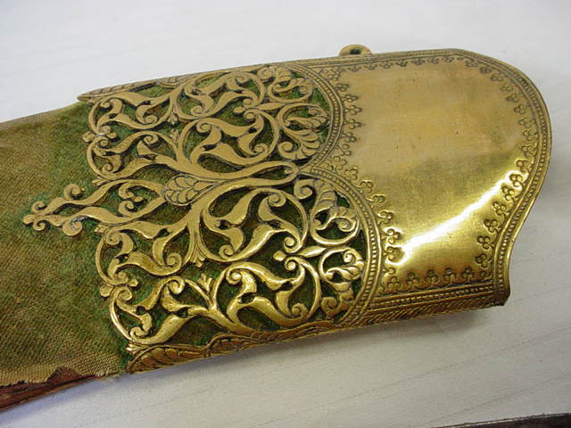

Indeed Gav!
It certainly looks a quality piece... Only one bit , I don't like, that of the blade riccaso extending below the hilt line.
Both aesthetically & practically that seems unnecessary to me.
But Id gladly home it for further study!
Spiral

Certainly a non traditional point you note but it does flow through there...and in all honesty, after seeing the thread surface again, I can say the photos do not do the piece justice..not in the slightest.
