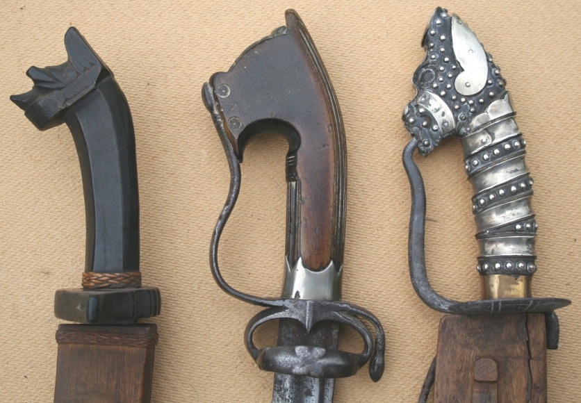

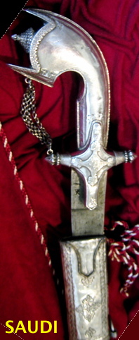

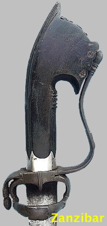

There has been trade between the Arab countries and S.E Asia for a long time.
Does anyone else see a similarity between Nimcha hilts and the bat hilts of the Philippines ?
My question is this:-
Influence or Coincidence ?
All opinions welcome
Roy

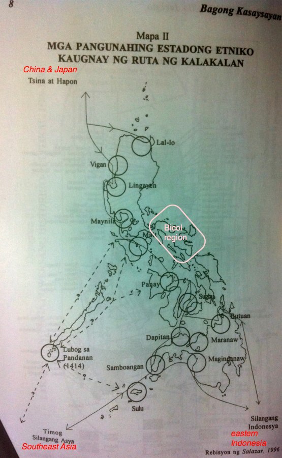

PS:- Now that we are sure that the Minisbad comes from Bichol, I note that this area appears to be predominately Catholic, but was there trade with the Arabs in the past ?

Salaams, Last question first .. Yes ! absolutely and as far back as the 8th century Oman was trading as far as China. The weapons look great. Clearly there is a link with the hilt style either with the Magreb or the similar hilt in and around the Zanzibar region (though I admit I have difficulty separating those two styles ) Interestingly Chinese vessels were running silk, spices and other goods up the Red Sea before the Portuguese arrived in the late 15th C. In fact, the Portuguese blockade of the Red Sea effectively bankrupted the Mamluke Empire shortly after. I see a European trade blade probably Caucasus 19th Century on at least one sword, The great question is regarding the hilts... Who influenced who? Also fascinating is which way around did the influence happen since the Philipines were for several centuries directly ruled by Mexico not by Spain/Portugal therefor it is conceivable that Magreb influence could have arrived in the Philipines via the Atlantic and Pacific or the shorter route if traded in by the Arabs or the other big three trade merchants The Portuguese, British or Dutch East Indies Companies (or all of them !)
Ibrahiim al Balooshi

I had always thought the nimcha hilt portrayed a stylized horse. IMO it is important to maintain consideration for an independent evolution of form… When compared to the "business end" of an edged weapon (though itself quite diverse in appearance), the hilt is comparably wide open to artistic and stylistic interpretations and/or variations. Given the rich history of edged weaponry in many cultures, might it be possible two distinct peoples may have thad he similar idea of portraying a stylized version of two different animals in roughly the same fashion?

These are excellent examples you have posted Roy, and an extremely well posed question. I just wanted to thank you guys for a great topic and some well developing discourse!! Looking forward to seeing this one run!!!
Ibrahiim, Dom and Chris, I like the way you guys think, and where the perspective is headed, it'll be good to see another hilt mystery seriously considered.

Well to go with this, according to documents and research there were Muslim contacts with Southern Luzon up to Manila (which therefore includes Bicol region) since before Spanish contact. So it is possible. But to be clear the minisbad hilt is in that of a deity I believe. Therefore it may be a mix of styles local and Arab that result in the minisbad hilt form.
Also don't forget that there is the possibility of independent origination of these forms.
Just looking at all options..............
BTW - great minisbad - where do you get your stuff?

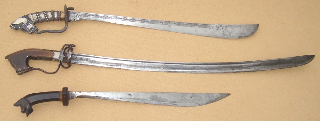

This has to be one of the most interesting and fascinating of forum conundrums I have ever seen !
Here we have a direct, though as yet, unresolved link between Western and Oriental weapons ~ We dont know where it originates or when. I am amazed that this has not raised the roof on this Forum , yet, only 5 contributors! Five !
Where did this weapon originate? I have seen semi believable half explanations from the experts .. Some say Morocco others Zanzibar. Tobias Blose is pictured wearing one (Captain of a trained band in London) in a portrait painted in 1617.(I assume that was before trade blades started flooding Africa) Page 28 Anthony North Islamic Arms.
Then there is the great tidal wave of trade blades. Is this a trade blade or a trade sword? Does it originate in the Caucasus, Germany or elsewhere in Europe. How did it get to the Philipines?
Last question first~ Owned/administered by Mexico this weapon could have got there by two routes.. The Atlantic from Spain \ Mexico and on across the Pacific to its destination...or... Into the great trade hub controlled by Zanzibar via Dutch British and or French East Indies Traders.
In the case of the latter transfer ~ in its wake this sword appears to have morphed in the version Saudia and or Yemeni shown in the discussion. Either way this has to be a gripping story though I have to add that Im not convinced it is even European since it has the look of a Chinese or Oriental hilt mixed with a Spanish crossguard/knuckle bow format. Could we be looking at an early Chinese hilt? It is possible since the Chinese were trading before the arrival of the Portuguese in the Red Sea pre 16th Century.
Is it a Dog? Is it a Dragon? Or are we all mislead? Is it a Caucas Nimcha variant ? What in fact is the difference between a Moroccan and a Zanzibar sword of this type? Are they the same? The blades seem to be.
It is certainly an excellent ships weapon; ideal on Junk Dhow or European sailing vessel..
What we know from Anthony North is that these weapons could have either straight or curved blades and he tends to attribute them to a European source though frankly looking at the Philipine link it has to be more precise to be convincing in my opinion.. There must be more to this.
On the face of it, evidence seems to indicate a west-east transit since no weapons in the Zanzibar area appear with Philipine decoration, however, as a general question of its birthright I still think this is a vital topic into which this Forum should jointly sink its teeth !

The resemblance is interesting. Nonetheless, more research is needed in order to support any of the theories IMHO.
Let us note too that the Bikol culture is closely similar to Visayan. This is because the sea currents flow from the Visayan to the Bikol coast, resulting to exchange between the peoples.

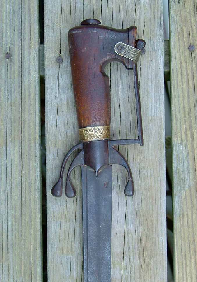

Quite some time ago I posted this sword:
http://www.vikingsword.com/vb/showth...ghlight=nimcha
Don't you think it might be pertinent to the current discussion?

I would guess this begs the question: how many other sword hilts found in the Philippines show possible Arab influence ?
If the answer is few I would lean toward parallel development .
This is a Nimcha Hilt; I see great differences between this and the Zanzibar hilt .
Here's a link to the original discussion of this sayf; let's throw that into our cooking pot .

Well, the fact that only a few Phil. swords had "nimcha-like" handles does not constitute the evidence for parallel development. Just as likely, only few Phil swordmakers decided to imitate the foreign pattern. Only few Aceh swords have Gulabhati-like handles, but there is no doubt that the pattern was imitated from the Indian original, and not parallel-developed.
Mine has not only nimcha-like handle, but also nimcha -like quillons. The scabbard betrays the SE Asian manufacture.
Am I wrong?

Yes, I think my example has been quite well repaired at some point in time; the pommel seems to have been broken in the past and there is a replacement wedge that can be seen . Therefore the brass strap to help hold it all together .
A google image search is helpful; lots of nimcha/Zanzibar sayfs to be seen .

In the Philippines, a former Spanish colony, many residents call the local Muslim population in the Southern islands Moros. They also self-identify that way (see Muslim Filipino). The term was introduced by the Spanish colonizers. In fact Arab settlement in the Philippines is not significant and not comparable to the Sri Lanka situation simply because of geographical distance. Moro was a term used to describe Muslim Philipino people not Arabs.
For Sri Lanka; this tells us that Arab trade was set up early and was continuous with Persian and Arab merchants settled in Srilanka and that full ethnic and cultural integration was highly advanced even before the full Portuguese, Dutch and British involvement. Since sword transmission follows or is in parallel with trade we should expect some influence in weapon design.
The Nimcha. The Italian and/or Venetian sword appears as the origin of species and can be seen transmitted along the North African Medittereanean Coast in particular cloissoned versions in Algeria and other examples of a similar theme as far west as Morrocco in the Mediterranean. It seems to have been a preferred weapon of the Barbary Coast ~ Pirates.
A few swords somehow arrived in England early in the 16thC though on long English blades.
The eventual and inevitable transfer to what is now Saudia probably by caravan (or a combination of sea and land routes and because of trade and religious expeditions to Mecca would have exposed the sword style to Saudi, Yemeni and Omani (Zanzibari) patrons. Once into the Zanzibar Hub I see the inevitable spread potentially to all stations east though I suspect this happened in slow stages thus the variety of different morphs showing up today.
The further addition of European trade blades clouds an already dimly lit scenario but has to be considered.
The Sri Lankan Kastane style may have developed earlier from the Arab merchants and settlers since they were already well established by the 15th C. It is also entirely possible that the early Arab traders brought the version to Zanzibar and since they already knew the trade route to China and the Philippines perhaps there is a link.
It is always possible, however, that the Philippines weapon did in fact develop separately as a parallel but purely accidental similarity. (I see more similarity between that and the Sri Lankan Kastane than with the Nimcha.)
I cannot see any trace of transmission from Spain to Mexico to Manila to Zanzibar ~ It seems to be the other way round.. logically. Also no transmission appears between Manila to Acccupulco to Spain thus the Philippines is perhaps a bridge too far in this discussion. At the same time I believe the Tobias Blose style in Anthony Norths Islamic Arms; page 28 in 16th Century London is a hybrid.
It strikes me that The Nimcha could have transferred to different cultures in a mixed timescale possibly over 400 years to an unrelated variety of places and been locally altered restyled and changed. Then in about the 18th or early 19th Century the net effect of a blanket of trade blades has muddied the waters with cheap creations appearing in Yemeni, UAE and Omani souks. There are examples of straight and curved blades; some european; some local copies although there are a few fine Iconic Nimchas on expensive Ivory hilts, highly adorned such as the Zanzibar style and the cloissoned Algerian Nimcha and in some good Saudi examples with cross guards.
That brings from me a conclusion based upon the question quote "Does anyone else see a similarity between Nimcha hilts and the bat hilts of the Philippines" ? The question was this:-Influence or Coincidence" ?
In so far as ~ Italy/Venice, Mediterranean (Barbary Coast Algeria - Morocco), Red Sea, Saudia, Zanzibar and Sri Lanka yes for sure ...
~but in respect of The Philippines; Im not convinced about influece..but coincidence; yes.

The Zanzibar swords in question are, I believe, not kattaras as has been apparently suposed, but the East coast nimcha/saifs, which can be seperated from those of the North coast by a number of details, most notably annoes and also a shorter quillon block with a punched-through tang hole rather than the hollow center found on the Moorocan type guards. I tend to view these as Swahili, and I see them all along the coast, rather than just from Zanzibar or Yemen to which they are commonly attributed.
Certainly one sees a resemblance between these types, and the flat-tang no-guard Berber sabers, and the middle-eastern Arab saif, and all seem closely related.
I have always considered the Philipino head pommels an extension of native animist culture. Their stylization seems more that of the Pacific than that of Islam to me.
The handling of the ears is notably different than on a saif (where there are never[?] a seperate front and back ear and where the nose comes to resemble an ear) or shah shish qa and yatagan (where the ears are seperated but stylized in a very different fashion than in SE Asia).
The iconography cited for saif is always the horse, while the SE Asian hilts depict a great range of deities/animals, all resembling each other in style.
Then there is the Turkish style pinky pull found on "nimcha"s; a feature of Turkish knives, including yatagan, not generally seen on their longer swords.
At the end of your handle, a hook is good. Hooks look like heads.
Just thoughts; no conclusions.

thanks to royston for bringing up the topic. and i agree with the opinions that it's all merely coincidental.
as far as trading activities are concerned (precolonial per illustration, and thereafter), the bicol region had always been in the backwater. thus if there were a sword design that trickled down to bicol via trading, we would have found a similar design along the trading routes, within the philippines and also in the neighboring countries. but there's none.
also as pointed out, the designs in philippine (and southeast asian) weapons can be traced to the olden animistic beliefs. thus the 'motive' for the region's sword designs was different vs. middle eastern sword designs.
incidentally, may i inquire what thus was the inspiration behind the hilt design of arab swords (aside from the usual practical considerations, like easier drawing of the sword from the scabbard)? thanks in advance.
Salaams, Thanks for the clear map. Your question as to design is perhaps best answered by the origin of species of this sort of Arab sword which seems to stem from Italian and Venetian types perhaps moving down the Med along the Barbary Coast as far as Magreb and certianly eveident in Ageria morocco Saudia Oman(mainly Zanzibar) and Yemen. As a biproduct of it being around in the courtly neighborhoods of Rome and Venice a likely cousin to the early style appears on the waistbelt of Captains of the Great Bands of London (no doubt having visited such places) thus worn by Tobias Blose in my earlier letter. Your point about animalistic (Zoomorphic) hilt is understood but cannot be verified since the highly zoomorphic hilt from a morphed Nimcha appears on Sri Lankan Swords. It is always possible that the Philippines variant is a derivitive of that sword, however, it is agreed that it appears to be unrelated parallel development compared to the Arab Nimcha generally .. Regards Ibrahiim al Balooshi.
