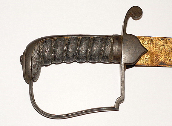

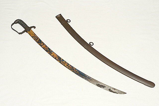

Dear friends. I HAVE A SWORD 1796 PATTERN LIGHT CAVALRY OFFICER'S. WHO CAN TELL MORE PRECISELY DATE OF MANUFACTURING OF THIS SWORD?

Wow! an extremely nice M1796 at that!!! This hilt seems very much like the higher end examples which were I believe produced by Prosser. I would need to dig out notes, but these were of course private purchase so never had the usual government acceptance stamps. Most of these seem to have been produced around 1810, and the hilt is similar to the rare 10th Hussars officers pattern in style but that type had a special escutcheon on the guard with the feathers for Prince of Wales.

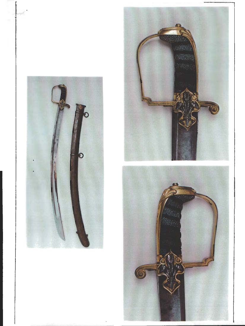

Here it is Alexander, from Robson revised "Swords of the British Army".
The 10th Hussar pattern as shown is extremely rare, and as explained by Robson as well as a number of other references, were specially designed for these officers. The distinct characteristics in the hilt such as the squared corner inset at the root of the knucklebow are of course much as seen on yours.
As these are known to have been produced by Prosser by special commission from the Prince of Wales, it well illustrates the status of this maker. Your sabre seems to reflect some of the earlier characteristics of these hilts.Prosser was probably already using the form when the design replacing the heater type shield ecusson with Prince of Wales feathers came about around 1807.
These are my opinions and I hope that Richard Dellar, who is the true authority on these British regulation rarities will see this and come in.

Hello Jim and all, sorry to come late into this thread. Here are two swords both by Prosser which have pretty similar hilts. Both have etched blades rather than blue & gilt. The top sword bears the markings of the 16th Queen's Light Dragoons (XVI QLD) and is by Prosser Maker to the Prince Regent. That positively dates it between 1811 when the regency was declared and January 1816 when the 16LD were converted to Lancers. The second sword belonged to an officer of the 1st regiment of Bombay Light Cavalry. I date this around 1818 - 1827.

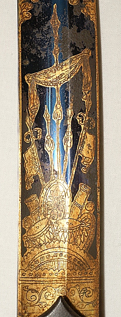

So Alexander, you have a 1796 light cavalry sword with a hilt in the style of Prosser which I would date about 1814-15. The blade decoration (from the little we can see) however does look distinctly un-British. Is there a GR cipher? or Royal Arms?

And Jim, here's a better photo of Lambton's sword
