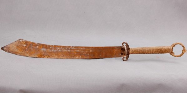

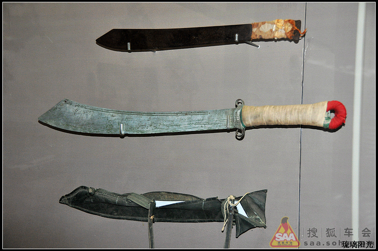

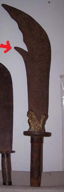

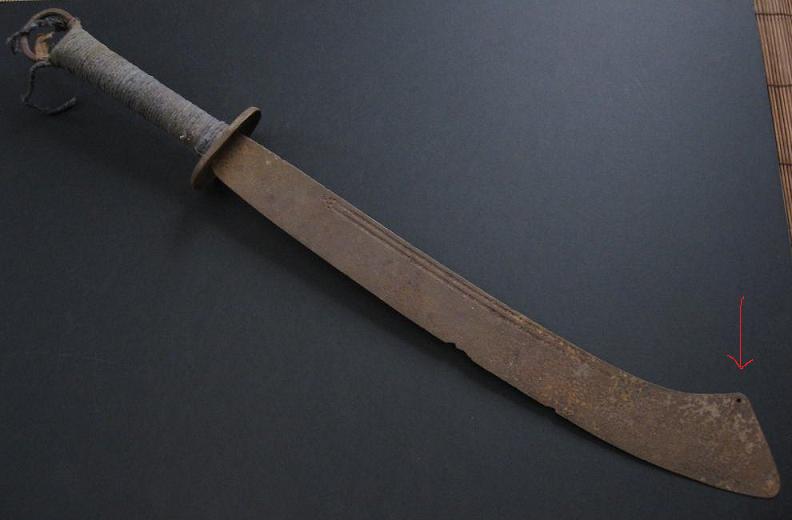

As pictured below I have seen a hole near the tip of the blade in many many 19th century Chinese dao. I have seen both colorful cloth attached there as well as metal rings like in the second photo. Not to mention metal rings with colorful cloth attached to them. Although predominantly it is just a naked hole. In the past I have read others say the hole was used as a place to attach one end of a sling or back strap to carry the sword when on the move. All of the above sound logical to me. What I am wondering is if any one owns, or has seen examples of the slings or sling pieces, or photographs of people actually using them. Any additional thoughts on the blade holes are welcome as well. Thanks

Maybe they are for hanging it on the wall when you're not carrying it, relating to European butchers' cleavers, etc. Have I read that these swords frequently have no sheath in the original cultural setting?????

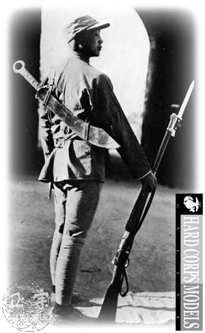

it is for wearing on the carrier's back, strap going through
koto is offline   Reply With Quote

I am happy to see some responses to the original post. Thank you both for your input. Good question about the use of scabbards in their original setting. Sadly it seems that generally speaking significantly more solo swords survived than scabbard examples, so we may be seeing a skewed perspective related to the original issue. That combined with what seems to me such minimal related written material available in English, as well as photographic material leaves me with a lot of questions unanswered. I started the thread hoping someone might share some old pictures, artifacts, or literary sources that go beyond someone in the present just saying something they heard from others. That type of information seems tough to come by though in Chinese sword study.
here is a pic I can find, showing the way wearing such kan daos

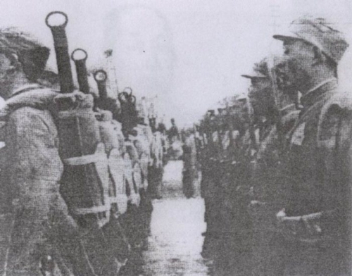

Nice picture. Here are a few more related to military dadao scabbard use. Relatively speaking many pictures can be seen with organized forces using similar leather scabbards. This is an area that has useful photographic evidence available. Although it does not really clear up the original question of the hole in the blade. It does speak to the fact that a highly mobile group needs a means to transport their weapons. Its not a great stretch to consider the less a person moves around, and or needs to carry other gear too, then there could be less of a need for a scabbard. Just a thought, and also relative to what Tom mentioned about the use of no scabbard at all.
What would be great though is an old article or excerpt of one describing an armed non governmental group, or a photograph of possibly a civilian defense group carrying weapons similar to what we call "village" type swords that often have the holes in question. A foreigners snapshot of say a "Red Spear" group coming through town would be very interesting. No doubt this information is few and far between, but it does surface in little bits at a time. With the help of like minded friends of course

Interesting how the sabers are hung to be drawn over their left shoulders. I assume they're right handers? I wonder if that gives them a greater draw length than they would get if the blade was slung with the hilt over the right shoulder. Hmmmm.

Here is another one with them all hanging on the left as though it was standard operating procedure for this group. Good question on why.

Back when I was a kid, I had a 24" machete that I'd rigged with a shoulder harness. One thing I learned was that drawing it over the right shoulder (if you're right handed), you can only draw the blade if it's as long as your arm or shorter.
Based on a clumsy experiment, I think you can draw something over your left shoulder that's a few inches longer than your arm. If I had to guess, that's why the soldiers are carrying on their off side. Someone with one of those daos may want to try the experiment and see.

The draw on these Dadao is pretty easy and simple. There are a few little factors that help.
The leather scabbard is not rigid so the draw doesn't have to be a long straight draw of the full length...more of a roll out effect than a straight line effect.
The scabbards are fully open across the spine region with just 2 very small clips.
In military excursions, they are slung on the shoulder for marching and are a secondry weapon in these 20th century pictures. In combat they are known to have discarded the scabbard and sling and most other items before getting medieval on their enemy.

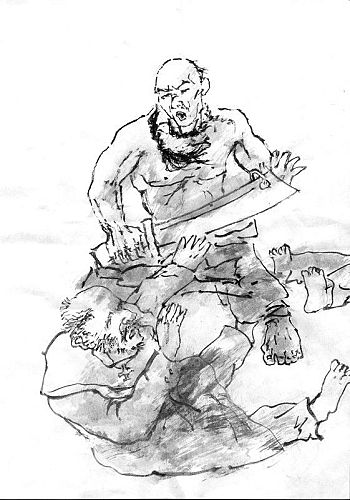

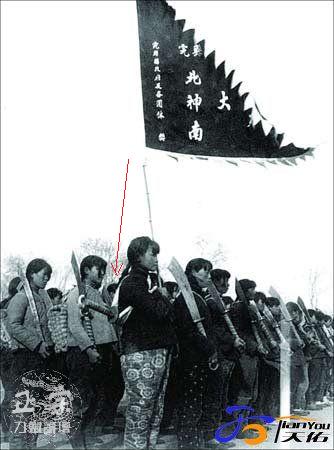

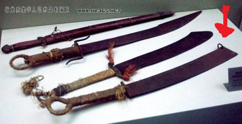

When looking at these old troop photos I wonder how many of those blades had holes in them even though they have a scabbard. I have seen many photos in the past of swords like these, lets call them "military issue dadao" with what appears to be there original scabbard. Presently I can not recall any specific photograph with both a hole in the blade and scabbard present simultaneously. That being said, it caused me to look in my photo collection which turned up some interesting examples. Unfortunately I do not have any pictures of "military issue dadao" with blade holes and scabbards together, but here are a couple with holes.
I have also attached two other thought provoking photos. The first one is an illustration that may be familiar to some. Apparently the holes in this case were used for aesthetic embellishment. Clearly the second photograph is interesting in many ways, but related to the question at hand I thought it was unusual to see the way the woman with the arrow pointing at her was carrying the sword.
I am still not any closer to new answers. Although I do a two new questions. Has anyone seen a "military issue dadao" with both its scabbard and a hole in the blade. Also, what do you think the context of the last photo is with the woman and the swords. Being able to read the flag would be a great help. Any other related thoughts generally speaking would be great too. Thanks

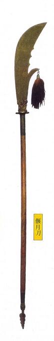

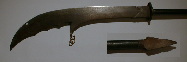

I am still interested in others thoughts and or evidence related to the use of the blade holes in various forms of Chinese dao. I have also posted some pictures of a couple guan dao head (偃月刀 yan yue dao) that have the feature in question. Although I have yet to see a period guan dao example with a tassel adornment attached to the hole/ring, it is standard on modern Chinese martial art practice pieces. This combined with the other evidence I have available at this point suggests to me that these various dao blade holes are more ornamentation related than utility. Any thoughts?

My thoughts are ornamental on the polearms, though in motion and martial use the tassle which sits in this hole may have a martial application like the tassle on the Jian, but you'd have to ask practicioners of the Yan Yue Dao to confirm this.

Thanks for your input Gavin, and the links too. Here is a picture of a tasseled guan dao head from the Thomas Chen site linked above (Thank you Mr. Chen).
