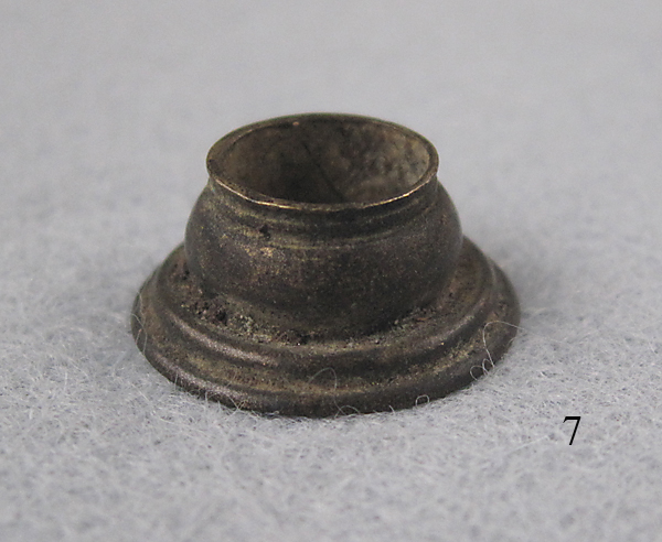

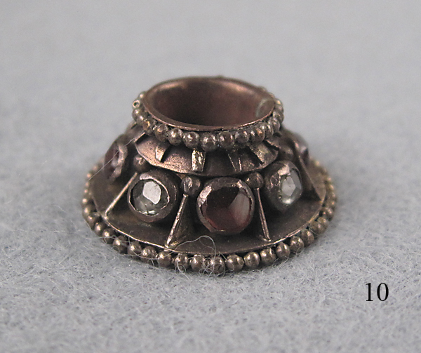

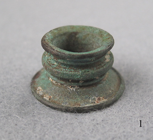

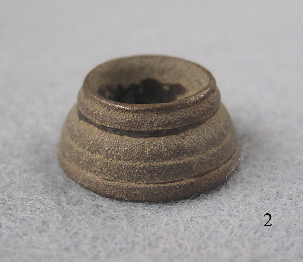

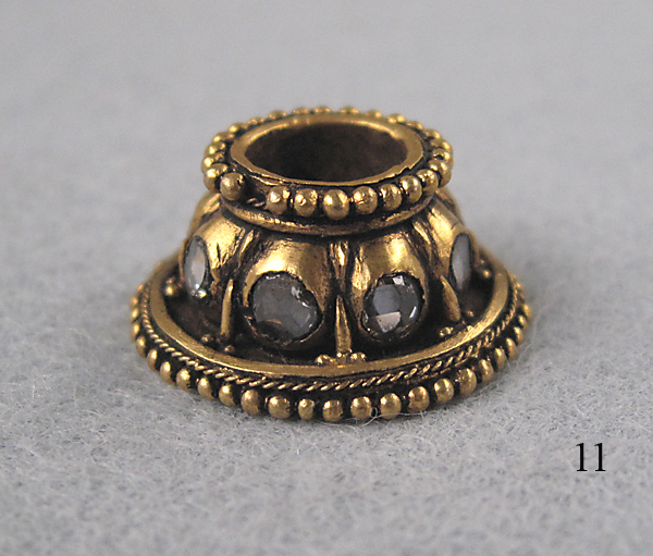

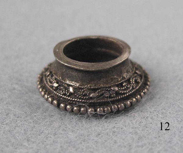

Old 5th November 2010, 12:39 AM   #8
Posts: 7,229

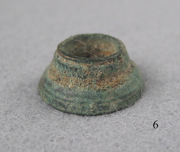

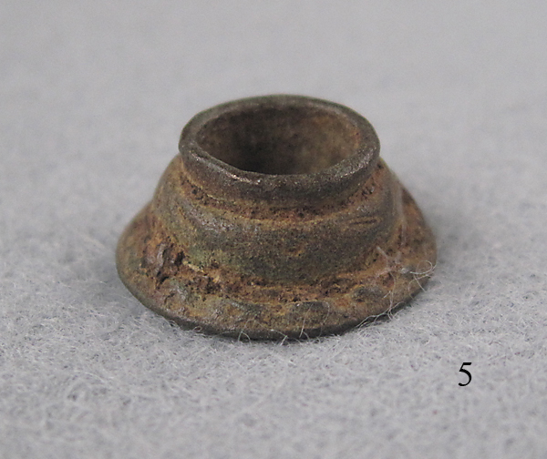

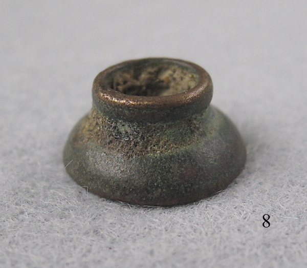

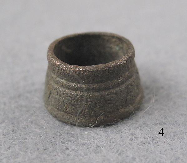

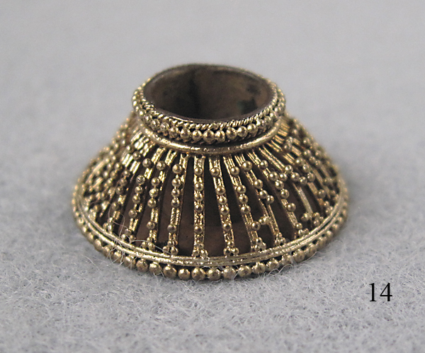

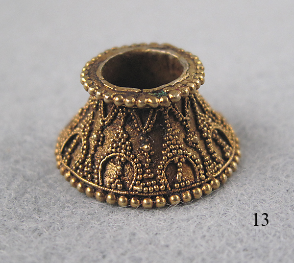

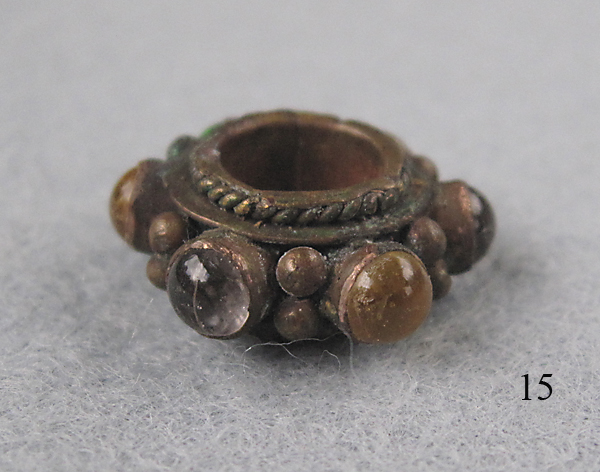

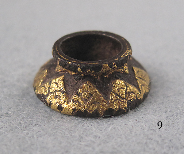

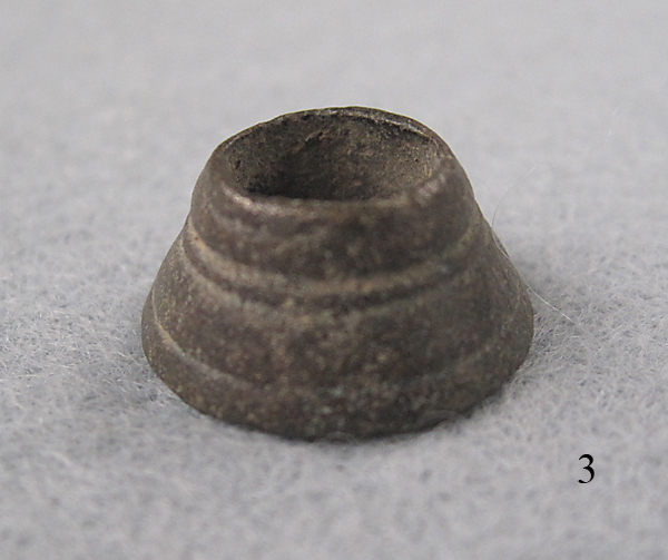

Below are 15 mendak.
Numbers 1 to 8 are cast, I believe in bronze, but some could be either brass or copper. These are all very early mendak, mostly excavated, they are solid cast, and I believe were the early mendak form that took the place of the methuk.
Number 9 is iron with kinatah work, again from an early period, my guess is possibly Mataram.
All the mendak from 1 to 9 are strong, functional mendak that would support the base of the hilt and help to prevent it cracking during use. Without this mendak, the base of the hilt would impact upon the top of the gonjo, the edges and irregular form of which could encourage failure of the hilt under pressure.
Numbers 10 to 14 show what the mendak became when it changed to a decorative accessory, rather than a functional part of a weapon that was required to withstand sometimes severe or jolting forces during a strike.
Number 15 shows how the methuk changed to a decorative form in Bali.
Often we find that Balinese hilts do not have a mendak (uwer), so we might ask the question of why those Balinese hilts without mendak (uwer) did not split. If we look at the form of the base of a Bali hilt, where it comes down to the gonjo, it is slightly rounded, which brings the contact point of the hilt to a slight radius and that radius is what contacts the top of the gonjo, which automatically removes or at least greatly reduces the risk of splitting.
The Javanese hilts seem to have gone in a different direction and opted to retain the spacing of the hilt from the gonjo, which would indicate a different method of use.
The above is only theoretical and in the absence of a time machine it could be argued backwards and forth till the cows come home, but it is perhaps one reasonable explanation of how this loss of the methuk occurred.
Old 5th November 2010, 12:41 AM   #9
Posts: 7,229
And the last three.
