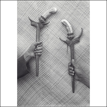

In the recent thread about Sajens sheath I posted an old picture (between 1890-1920), where two keris from Aceh with very similar hilts are depicted. The surface looks like worked with a white metal.

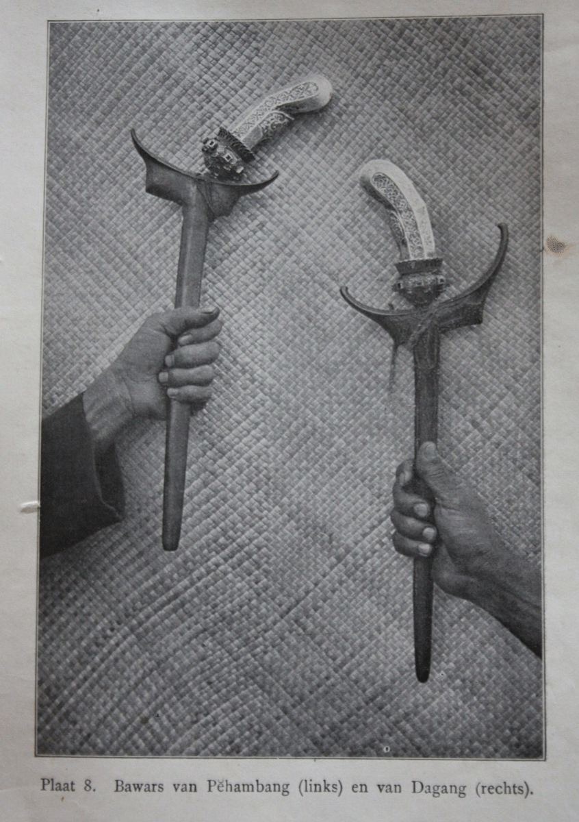

Here already the same photo but with the caption and the first page of several about Bawars - will make a list of the important parts later on...

The total is 4,5 pages including a legend around a specifi bawar...
Here the highlights:
*Sign of dignity for the "heads" of gayo given by the Sultan of Aceh - the "owner" of the lands.
*They were passed on each generation to the new ruler
*They are very old (written in 1914)
*The blade has the wavy form and size of the Javanese keris.
*It should be worn in a much longer sheath
*Most of these sheaths have been lost by new ones
*They are worn in a girdle in the front of the body.
*Most often as it is too precious it is covered in clothes and worn by one of the people
*The ones in the photo have a grip made of silver, a cup made of suassa set with rubies of which many have been lost over time.
*The sheath is short but very old and made of a beautiful type of wood and with some decoration in the wood.
*Apart from the local kings also some lesser heads have them but it is doubtfull if these were really gifts by the Sultan of Aceh.
*Probably many of these were locally made to improve the status of the lesser heads.
*The "copies" also have been passed down the line and now are also pusaka's
*The are less beautifull with grips of copper or even wood.
*The were also used at feast to give the wearer more status for example on a wedding.
Well that is it for the moment.

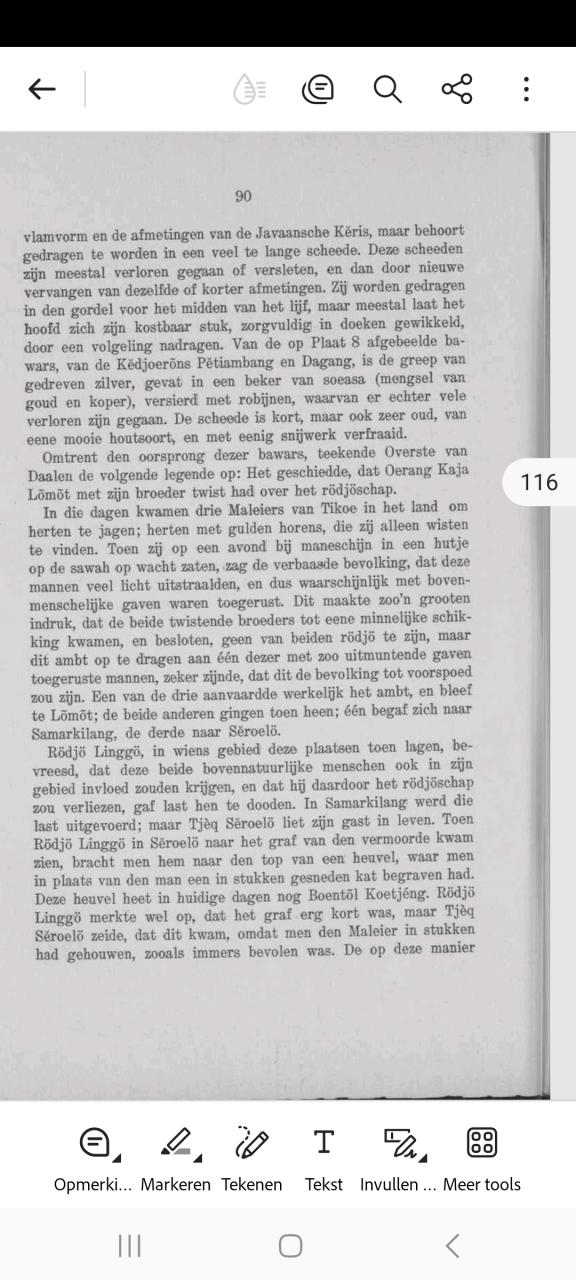

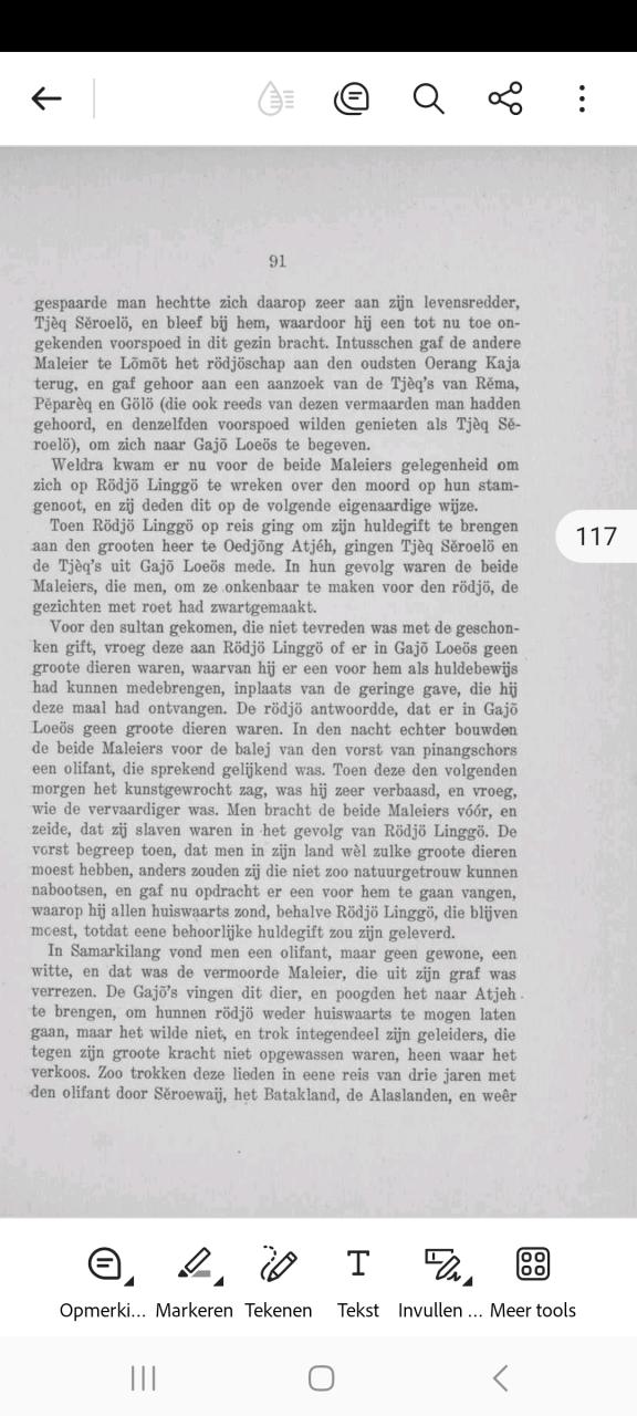

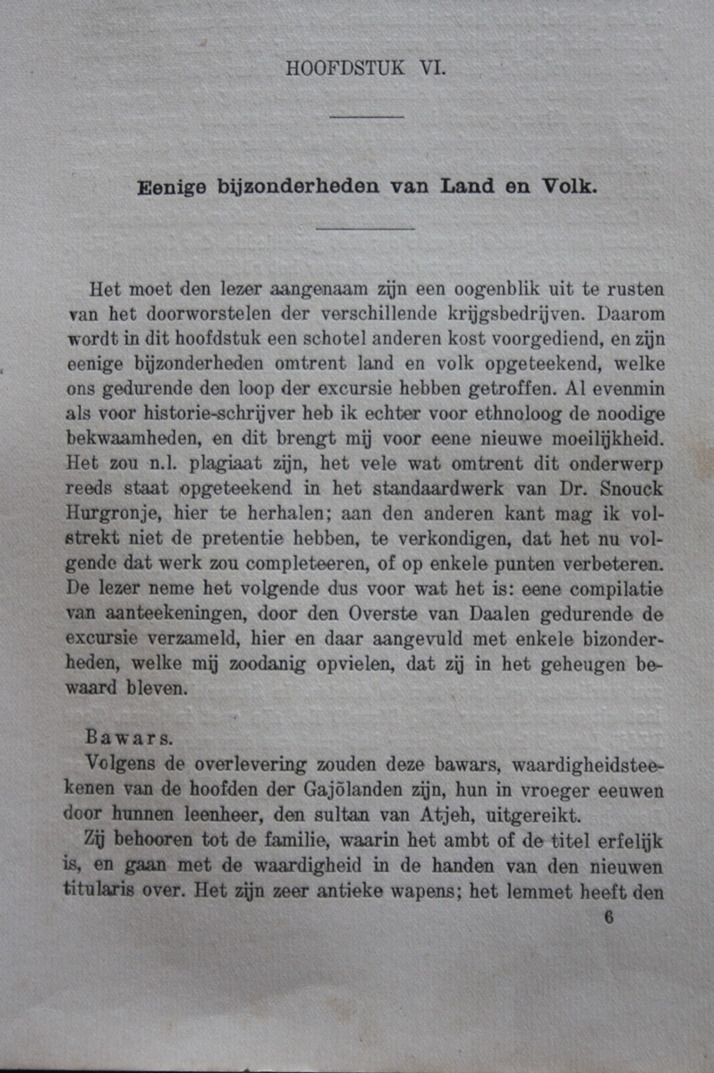

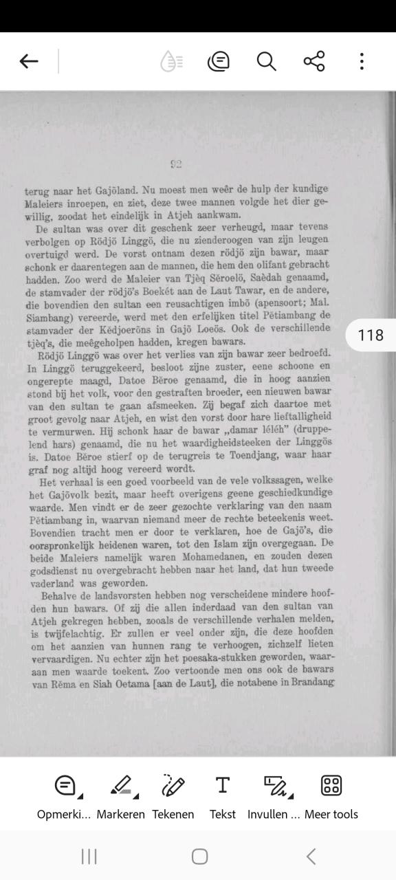

Can anyone tell me from which publication thi page is?
Hello Albert,
Have a look to post #4.

Hello Albert,
Hello Detlef,
Unfortunately the mentioned (and the 'missing ones') are not in the book of Kempenees.
So it remains a mystery.
Can anyone help?
Albert
Hello Detlef,
Can anyone help?
Albert
Hi Albert,
It is from page 89 on and further
Kind regards,
Maurice
Old 3rd March 2025, 05:15 PM   #15
Maurice
Maurice's Avatar
Join Date: Jan 2007
Posts: 1,464
Unfortunately in Dutch...
Old 3rd March 2025, 08:51 PM   #16
Albert
Albert's Avatar
Join Date: Jun 2005
Posts: 213
Post
Great Maurice! Thank you very much.

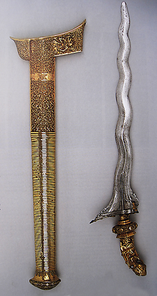

Originally Posted by Gustav View Post
Dear All
Has somebody an example of such hilt? My only sources are Tammens and this picture, and when I saw it for the first time I was really perplex.

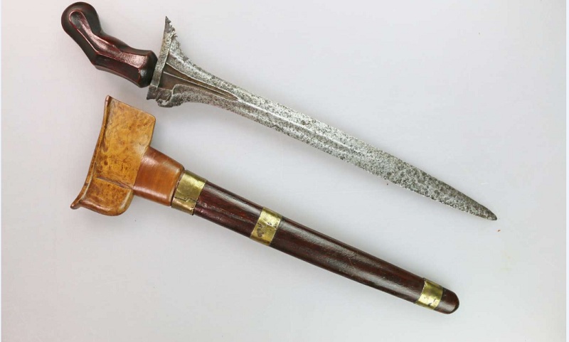

Here is a picture of a keris with a Bewar hilt from a just completed auction yesterday.
Old 23rd March 2025, 08:04 PM   #18
Jep,
went to high for me!
