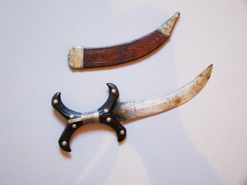

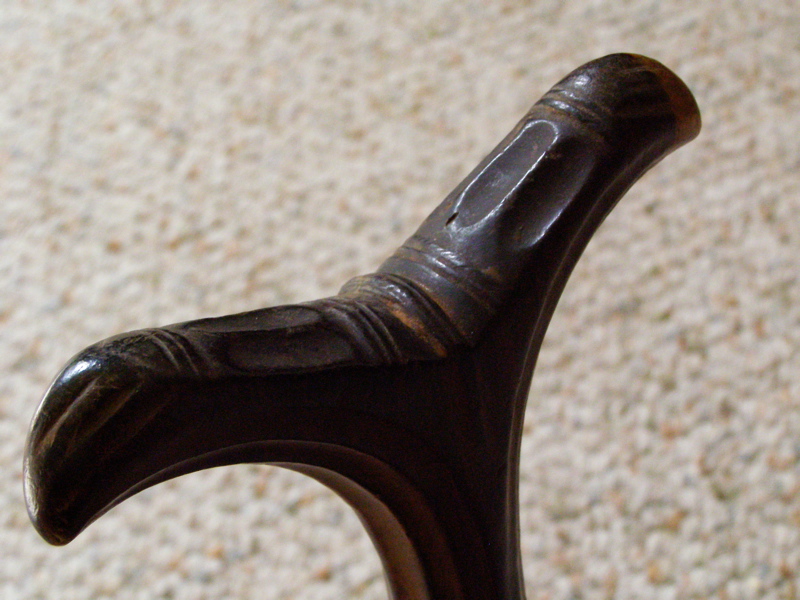

Jim,

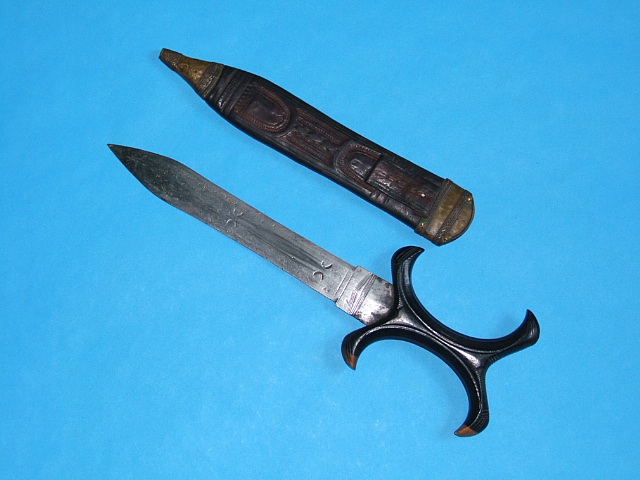

Do you think the use of "Hadendoa" to describe this form of dagger is etymologically incorrect? I'll be the first to admit I've always identified this stylized anthropomorphic hilt as a "Hadendoa" dagger without consideration to the larger sphere of tribal identity with whom this type of knife was/is associated.
Was it the historical role of the Hadendoa (in support of the Madhi I presume) that resulted in this association? I read somewhere the Hadendoa would sever the tendons of British horses using these daggers...
Anyway, here's a couple photos of my own example. Aside from the blade form, I think I found a distinction in the treatment of the top of the hilt with the double-notches that repeat on either side:

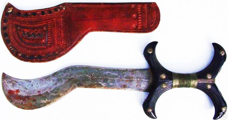

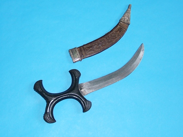

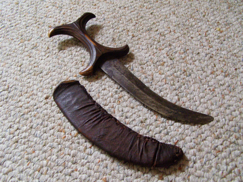

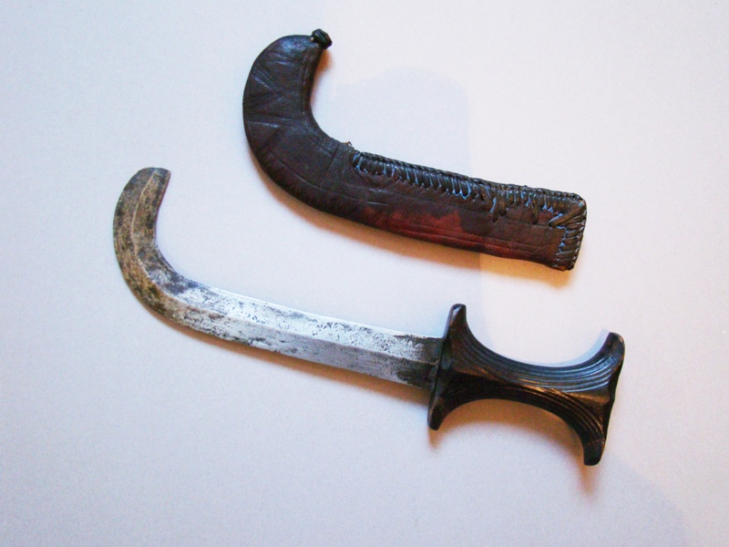

This style of knife is probably carried by a few different tribes in that region much like the jambiya in Yemen and parts of Saudi Arabia. Here are a few more versions of this dagger.
