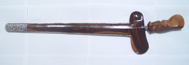

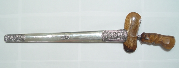

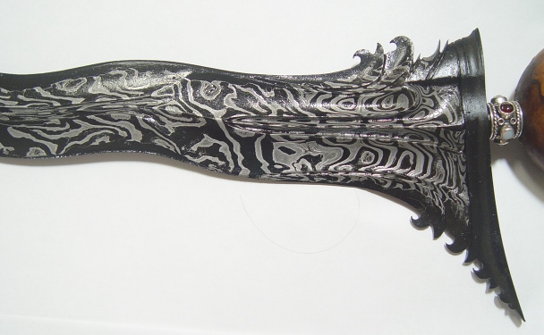

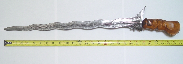

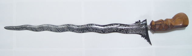

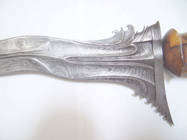

Some members saw this keris when I picked up in Timonium earlier this year. I thought that you (and others) might like to see it after it's round trip to Bali.
The first two pictures are as I picked it up while the others are after it's return to me.

Ah Mickey, that truly is awesome! Nice staining and a good job on the sheath. What's up with that second set of sogokan. I've never seen that before. A very nice and unusual keris.
BTW, how long was the turn-around time on the work?

This keris deserves a place in the books! The ricikans are most unusual, especially the 2 'depressions' surrounding the sogokan.
Old 10th September 2005, 05:30 PM   #8
nechesh
nechesh's Avatar
Location: Cincinnati, OH
Posts: 940
I totally agree with you Kai Wee. The ricikan seen quite unique here. Not only the impressions around the more common sogokan, but the way the sogokan seem to start up again further up the blade. This appears to be a very special keris.

For a long time I have been under the impression that the art of traditional Balinese restoration, polish and staining was a lost art, in fact I know of Balinese dealers that send their blades to Solo for staining, so my question’s is as follows:
You mention your blade took a round trip to Bali, is this blade restored, polished and stained in Bali to your knowledge?
It is hard to see in the photos, but is the blade polished in the traditional manner?
Do you believe the color of the stain would match that of the blade as it left the maker?
If it is all done the traditional way, would you mind sharing your source with the fellow forum members either via pm or in the forum?

Just to share, the older Balinese pieces which have not been re-etched has a lower contrast, and a more 'steely' looking white portions, probably due to polishing or perhaps just because they are older and have lost a bit of the sharpness in contrast. Sometimes, the 'black' looks almost bluish in these older pieces. The recently washed pieces I've seen have this 'matt white and jet black' look. Not sure if the method is more Javanese than Balinese?
Old 11th September 2005, 06:38 AM   #11
Posts: 7,397
Bluerf is right. I have noticed that on my Balinese keris. It is older and the nickel is silvery while the rest is a darker bluish-grey color.

I do not consider myself an expert in regard to the keris and I do not mean to start an argument amongst the members of the Forum, but we have had discussions in the past about the colorations of the keris after treatment with warangan. It was noted that a possible cause for different colors was impurities in the warangan. I suggest that the differences are possibly due to at least two reasons. One being the characteristics of the “iron” that the keris is made from and the other impurities in the warangan. Other factors are possibly the temperature of the warangan solution during the process and the length of time that the solution was left on the blade. (Leaving the blade in the solution too long will even turn the nickel bearing material black which is in itself a specific form of a Javanese finish.)
I have a dozen or so Balinese kerises. All of them except for the one shown in this thread were patinated in Bali while I was present on the island. The oldest of these (I make this assumption because the pamor is adeg which is laid out in luks and the piece has been washed and polished so many times that the luks themselves are practically nonexistent) shows the dark gray base that Battara mentions in his post. Others have colors that range from dark black through the almost gun blue finish that BluErf mentions. In fact some of them range from black, dark blue, brown and up to and including a golden color in the base material of the same piece. (That is the material other than the nickel bearing material.)
I cannot say that the patinating of this blade was done in Bali. I can only say what I requested that the individual to whom I sent the blade was to do with it. I do know that he passed the blade down to Bali in order to have the scabbard made and he even had a different grip and mendak made and installed before he sent the ensemble back to me.
Due to these variations in the final colors of Balinese kerises that I know of as facts, I am extremely reluctant to get into a contest regarding the judging of the proper color for the patination of a Balinese keris.

To say it old is one thing, Boedhi said it, because of sangling, old Balinese keris could not be like yours. But to say it beautiful is the thing because it is truly beautiful. A work of fine art, sOuo ...dynamic. WF !! I've some pieces original from Bali, this one, I think, was made from Java. The compliments shall be to those masters from Javanese. My deep respects.
purwacarita is offline   Reply With Quote
Old 23rd September 2005, 05:02 PM   #18
nechesh
nechesh's Avatar
Posts: 940
Something tells me you are incorrect on this one purwacarita. Everything about this keris says Balinese to me.
Old 23rd September 2005, 07:14 PM   #19
Posts: 6,420
Purwacarita , having made your statement I guess you will have to provide us doubters with concrete proof .
West Jawa , Bantam perhaps ?
East Jawa , Blambangan maybe ?
IMO Balinese empus were quite capable of producing this quality of work in the 17thC.
Old 23rd September 2005, 08:07 PM   #20
nechesh
nechesh's Avatar
Posts: 940
Just to qualify my remarks, i should say that not EVERYTHING about this keris says Bali to be. The warangan, for instance, MAY very well have been applied in Jawa and the newly commissoned sheath COULD have been made by Javanese craftmen in the style of Bali. Certainly the new uwer (mendak) MIGHT very possible be Javanese. BUT, the blade itself IMO is in all PROBABILITY Balinese.
Old 25th September 2005, 10:53 AM   #21
purwacarita
purwacarita's Avatar
Join Date: Aug 2005
Posts: 54
Hi Rick. I was not saying that Balinese could not make this quality. I could not provide concrete proof, sorry, I don't know about empu in Java. Pamor at sor-soran is not 'till the edge, it reads peace keeps the commitment accompanied, ...but the peace ends in the middle of the blade where it should go straight up along the blade so to read properly peace along the way 'till death. The sogokan also ends at sor-soran, yet another sogokan comes from the edge (interference from death?), ...thus I think is work of creativity which does not concern reading of symbolic language in the keris. Though symbols may vary between different communities, ...I had a strange feeling to admit this one as Balinese. Our empu will struggle to make keris to retain its symbolic meaning to our certain community.

On your pictures, was a measurement on inches or centimeters ? I believe it was in inches (black tick with "1F" would mark 1 foot = 12 inches). Please remind me if i'm wrong.
My old eyes told me, the blade has at least 21 inches long. In centimeter, it would be 21 x 2.54 = 53.34 cm. long. In traditional Java sheath, I must order a custom made, quite long pendok. In Bali sheath, I believe, it would be fit perfectly . Bali or Java, or even a newly made madura, still I wish I had this blade

The thing measures 22 inches (55.88 cm) from the tip to the junction of the Pesi and the Ganja. This is the largest (real type) Balinese Keris that I have ever seen. It is several inches longer than anything else that I have in my collection. This is why a new sheath had to be fabricated from scratch. It is wide enough to be refitted to many good old sheaths, but too long for probably most that are in existence.
In fact the Keris was so good that it’s size didn’t register on me until I started looking at some of my material for something that could be modified to accept the blade. The tip went well beyond the end of any thing that I had in hand. I couldn’t even find a standard US size box to use (when you include the length of the Pesi) to send the blade off to be redressed unless it was of ridicules dimensions. The UPS guys chopped up a large box make something for shipment.

Hi Jose. I was wondering if you could define your use of the word contemporary. I also suspect this blade was actually made on Bali, but i do not believe you will find anything like this coming out of Bali today. How broad is your use of the word in this context?
Old 20th October 2005, 05:24 AM   #29
Posts: 7,397
Perhaps I should have been a little more specific. I was refering to the scabbard and the silver sheath. But on the subject, Nechesh you don't think they are doing work like this on Bali anymore? I know that it would be more expensive, and thus the stuff for the tourist market is not even truly laminated.
Old 20th October 2005, 11:38 PM   #30
nechesh
nechesh's Avatar
Posts: 940
Ah yes Jose, i would definitely agree that the sheath is contemporary. In fact we know it is since Mickey had it made to order.
To answer your question, i am fairly sure that keris of this quality have not been made On the island of Bali for some time. I'm not quite sure where all these higher end contemporary Bali-style keris that keep popping up on eBay are being made. Either Jawa or Madura i would imagine. But i don't believe that there has been much high end keris production on Bali since the before WWII. I would be interested in any evidence to the contrary.
