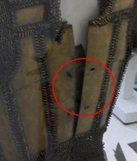

Rasdan is impressively correct about the Moro dimensions. They often used bronze or brass chain-maille, 4-in-1 pattern for conneting the plates. Your's also looks 4-in-1, and you might want to consider brass, which is cheaper and more easy to work. I will start working on restoring my Moro armor in a little bit, repairing the plates and mending the chain-maille (with the exception of the American bullet holes ). You may also want to check out the armor section of swordforum.com as another source, and do a search there on chain-maille. Like your work on the Greek(?) body plating.

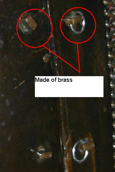

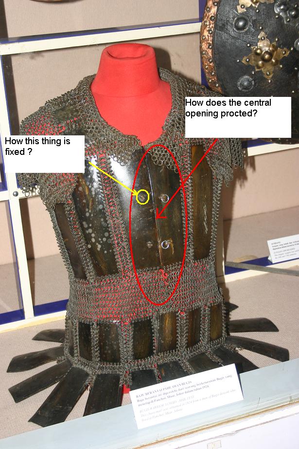

While we are on this topic, i am curious. How does the moro attach the hinges of their armour? Is there an extra middle plate inside the armour that holds that thing that holds the armour lock? The attched picture shows a picture of a bugis armour which is strikingly similar to the moro ones. It is donated by a man of bugis descendants in Muar, Johor in 1924 to a museum in KL.

It is locked into position by 2 metal plates which secure the left and right plates together. One for the top and another for the bottom. See links for examples.
Simple locking mechanism.
http://www.eriksedge.com/PH116.jpg
Another variation used by Datuks.
http://home.earthlink.net/~federicom.../MoroArmor.jpg

What i meant is, how the 'rod' for the lock is fixed. In this following picture, we can see that the plates are made of horn, and the 'rod' is brass. How does the brass 'rod' fixed onto the horn plate? I suspect the horn only has holes for the 'rod' and the 'rod' was made separately and welded onto a piece of centre brass plate inside the armour and then fixed with the lock. The extra inner middle plate also can protect the body if the thrust goes directly in the middle of the chest plates. (Just my opinion). We can see the missing 'rod' from the second picture below. Can anybody clear this up?
Thanks,

The rings may be a modification, for a quick easy release mechanism.
