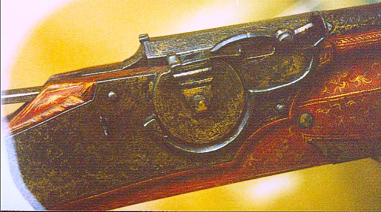

Posts: 182

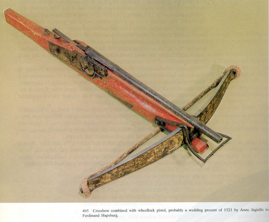

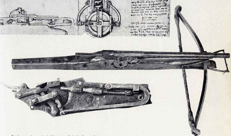

Here's a picture of it from Dolinek's The encyclopedia of European historical weapons. I can't recall there being much in the way of measurements in the book though.

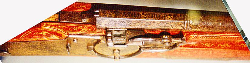

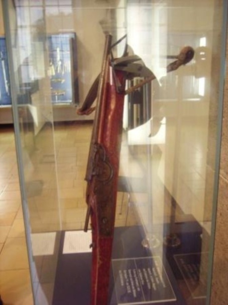

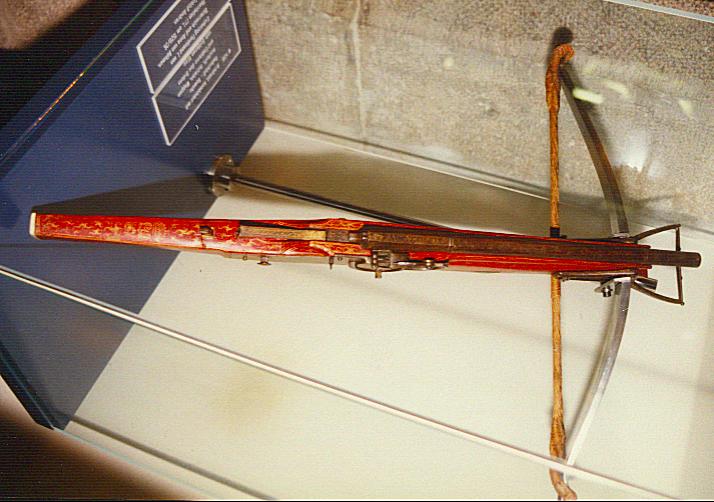

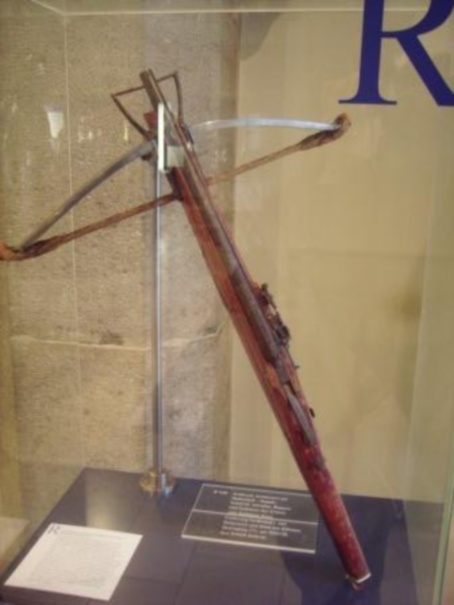

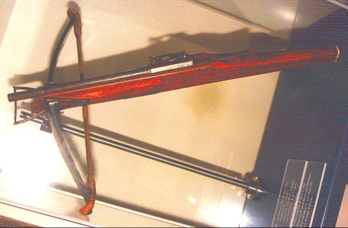

Hi Alexander,
This is the earliest closely datable combined wheel-lock gun and crossbow. It came, as you said, from Schloss Ambras, The Tyrol, and is preserved in the Bavarian National Museum in Munich.
The measurements are:
Length overall: 73 cm
Length of barrel: 39.9 cm
Caliber: 9.8 mm smoothbore

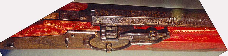

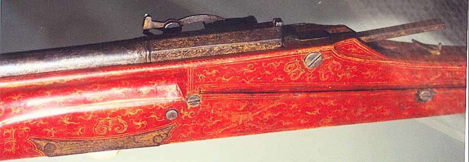

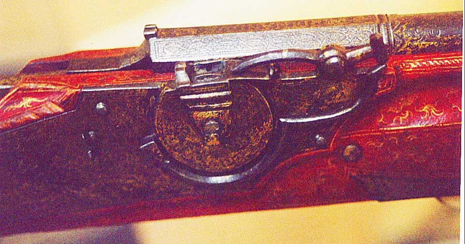

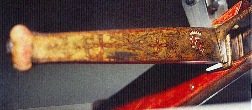

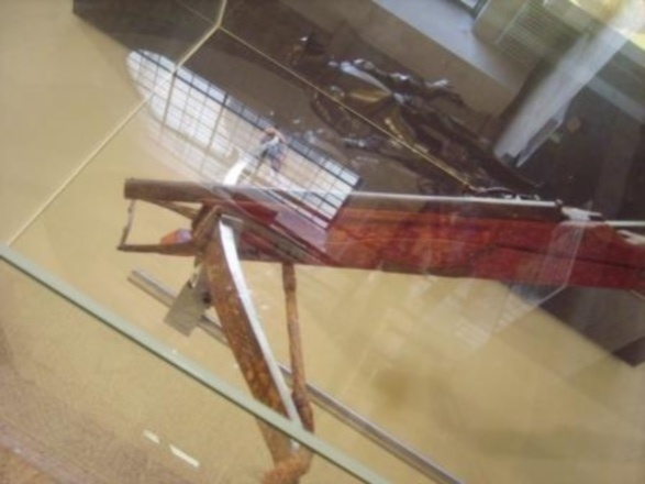

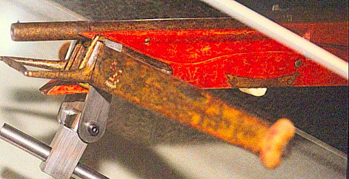

I attach more images that I took myself. Sorry for the unusual poor quality but I took them during various visits there and was not always allowed to use flash. Moreover, they are 20 years old.
Michael

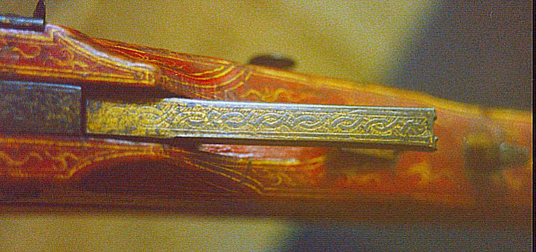

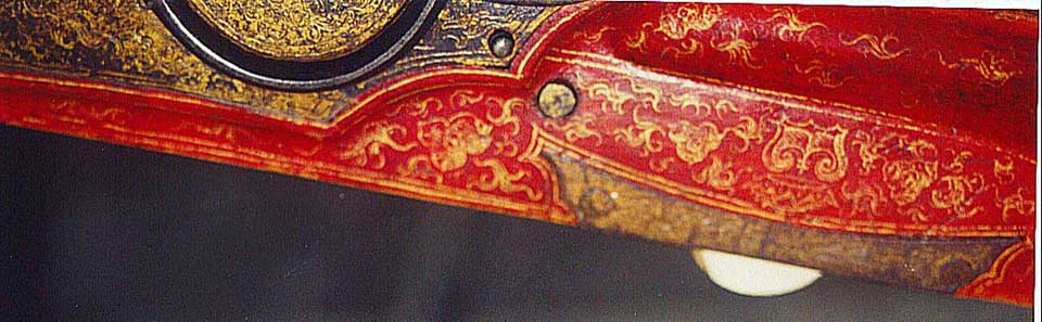

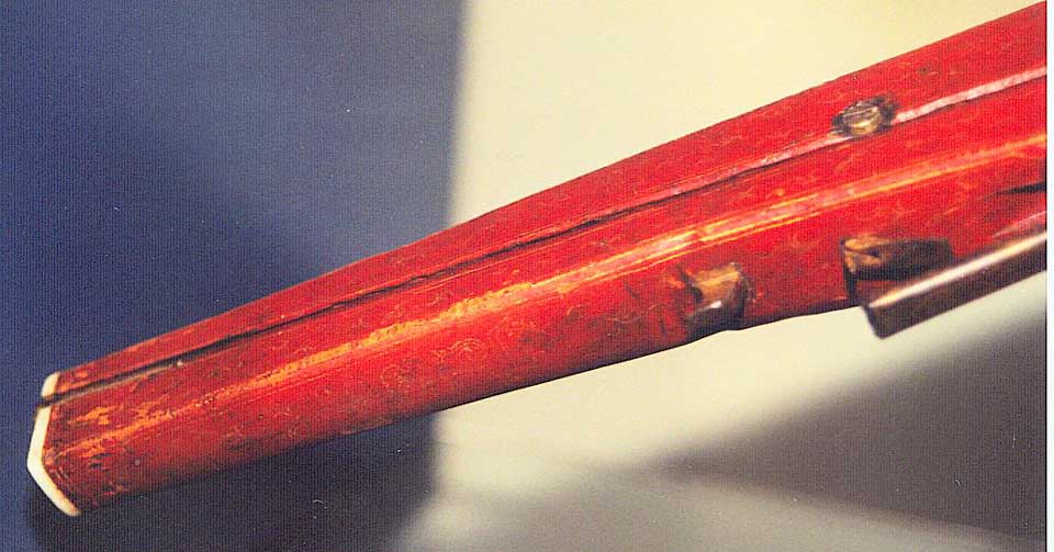

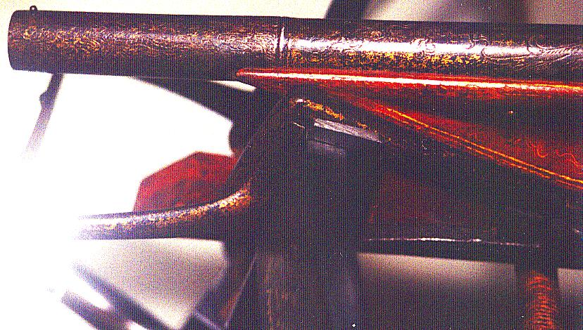

Old 15th May 2010, 06:39 PM   #4
Matchlock
Matchlock's Avatar
Join Date: Sep 2008
Posts: 4,310
More.

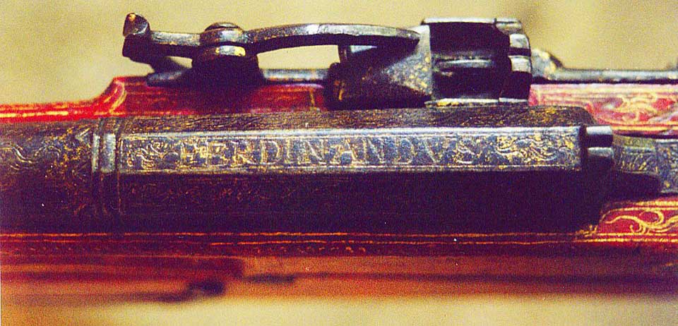

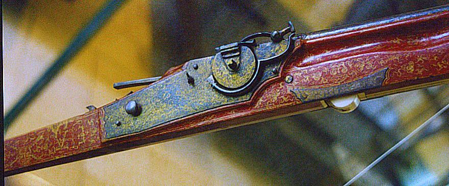

Old 15th May 2010, 06:53 PM   #5
Matchlock
Matchlock's Avatar
Join Date: Sep 2008
Posts: 4,310

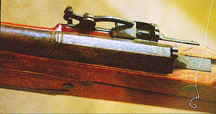

Please note that the wheel-lock dog is incomplete, the top with the jaws is missing.
As is the case with the earliest matchlocks, there are no screws to the mechanism; all parts are riveted.
Michael
Old 15th May 2010, 07:42 PM   #6
Matchlock
Matchlock's Avatar
Join Date: Sep 2008
Posts: 4,310

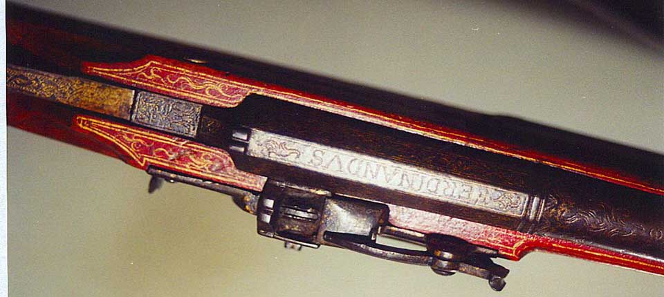

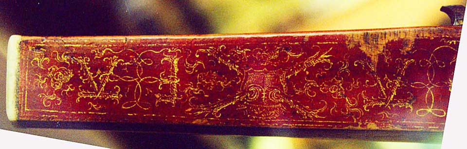

The inscription reads:
FERDINANDVS on the center of the octagonal rear section, inlaid in gold against the blued ground.
F and A on the stock, together with the arms of the Golden Fleece below an archduke's hat.
That's about all I can tell you, sorry.
I attach images of the Order of the Golden Fleece but not from that object.
Michael

Old 15th June 2010, 07:25 AM   #9
Spiridonov
Spiridonov's Avatar
Join Date: Nov 2008
Location: Russia, Leningrad
Posts: 355

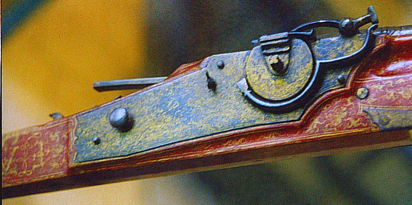

Is the wheel of the lock of this crossbowgun open or closed? I can't understand it looking at photo
Spiridonov is offline   Reply With Quote
Old 17th July 2010, 05:38 PM   #10
Matchlock
Matchlock's Avatar
Join Date: Sep 2008
Posts: 4,310
Hi Alexander,
Please forgive me for not replying any earlier, I somehow must have overlooked your request.
If I am getting you right you wish to know whether the wheel is outside or inside the lockplate. It is outside but extremely small and narrow, like all earliest wheels on locks; it is centered by a spindle and surrounded by a very delicate sickle shaped dog spring.
Does this answer your question?

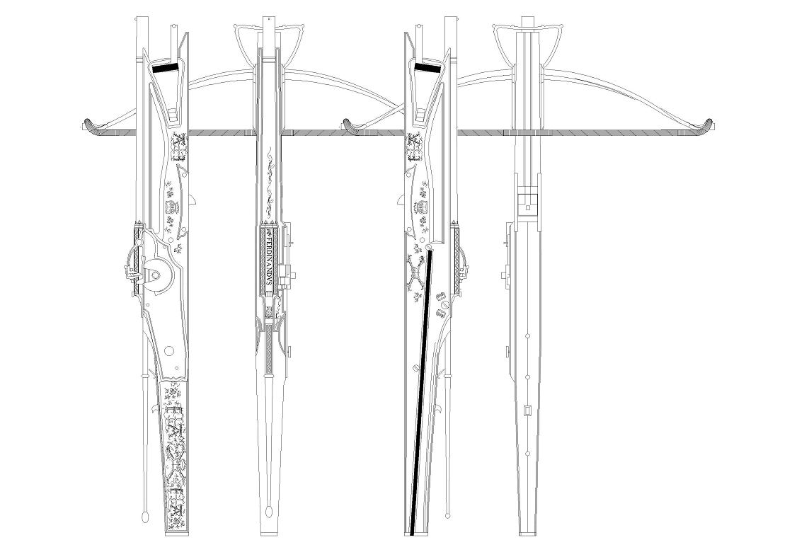

My Belarus friend expresses huge gratitude to those who has answered in this topic. He has given the preliminary drawing for discussion. He will be made replica of this. I can give a high resolution drawing at email if somebody want
Old 27th July 2010, 09:49 PM   #12
Spiridonov
Spiridonov's Avatar
Join Date: Nov 2008
Posts: 355
a have upload it at www.vfl.ru
http://vfl.ru/i/20100728/655de8c20dd...013_1.jpg.html
