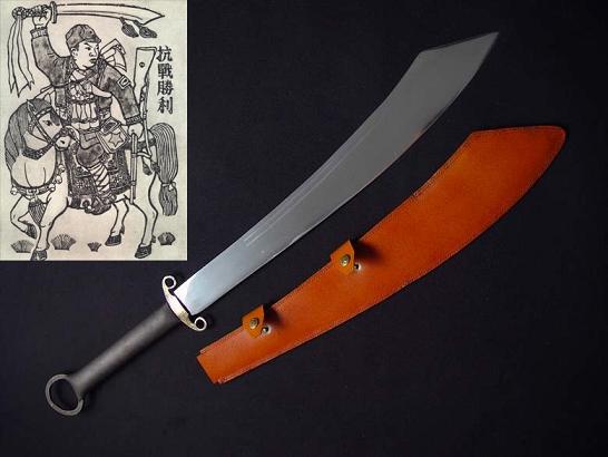

I am curious about others thoughts on the use/function/reason for the ring on the end of some antique Chinese swords. Was it just a convenient pommel to create during the forging process, or were there specific functions it provided in use or symbolism etc. I realize examples of this can be seen very far back in Chinese history all the way up to WWII soldiers swords. Feel free to comment about any that you may have thoughts on. Thank you for your insights.

Hi Neil,
I suspect the main use of the rings was for storage and transport. Weapons could be carried on poles or suspended by hooks on a wall, and the blade wouldn't get dull. On knives, it also makes a useful loop for pulling a blade out of a sheath, or a thumb ring. Still, the ring hilt is most common on military weapons, and I think it mostly for transport and storage. If you look at civilian daos and jian, they don't have the ring so often.

Also, as we can see in Neil's picture, the Chinese do love to have tassels and trailing silks/ribbons on weapons. The big ring means that you would have much more 'scope' for this, as you could literally improvise by tying scarves or just strips of fabric. No need for anything specialist. Not that I'm an officianado of Chinese warfare or anything, but didn't separate groups/factions/regiments have colours that identified them? Would this also have a purpose for the trailing silk ribbons?
Or distraction etc?
Just a thought.

Ribbon's/ a scarf tied to the pommel I think are decorative as used in Wushu...as in the picture Niel posted....you could use the ribbon/cord perhaps to lash the weapon to your hand so it knocked out of your hand you could easily retrieve it. I remember one old drawing in Alex Huang's book Iron & Steel: Swords of China there is a demon depicted with a sword with ring pommel that is chained to his wrist (Page 80) Ring Pommels are seen in Tang Dynasty swords.
On a side note...I remember in some TV show they said the ribbons/ strings near the head of the spear head you see on wushu spears modernly was used to distract the eye of the enemy...and to prevent blood from coming down the shaft and making the pole slippery...and that spinning the shaft would spin the blood off that had accumulated on the strings at the spear head...I have no idea if there is any truth to this...maybe just a good story
