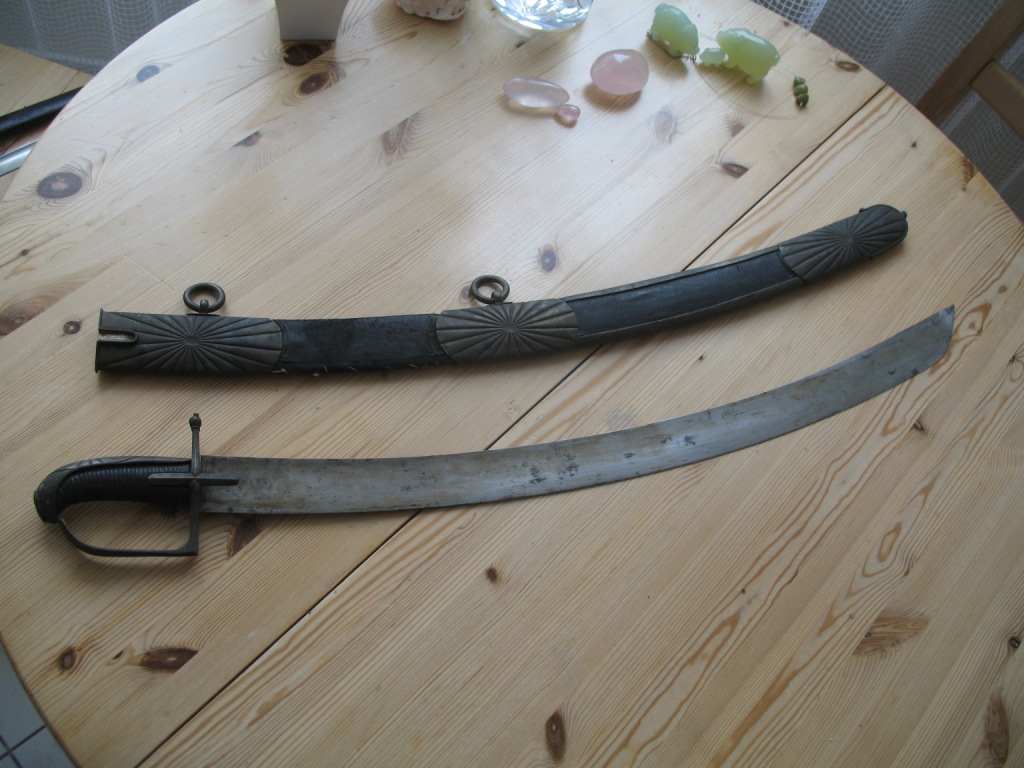

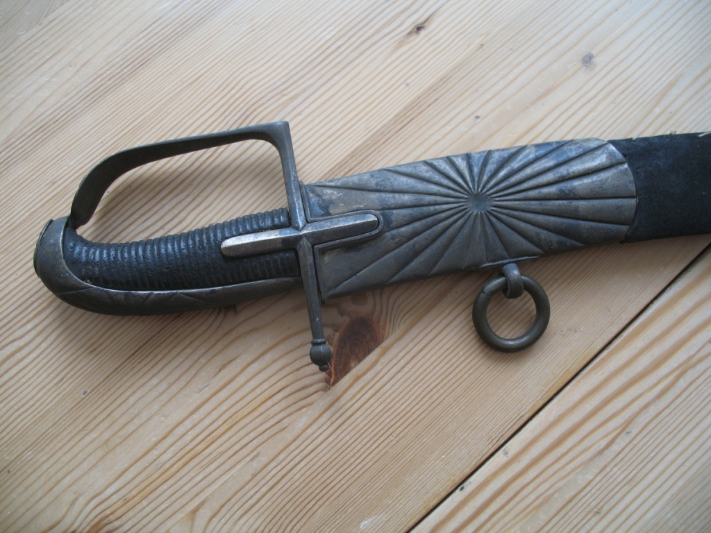

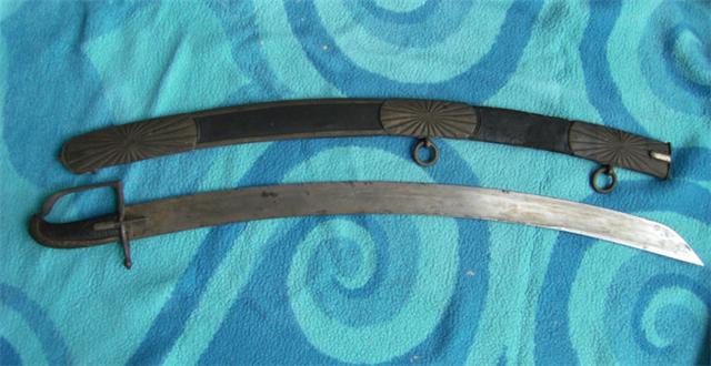

I wonder if anybody could classify the saber. Is it Austro - Hungarian ? Many thanks, Martin
Old 7th April 2010, 12:59 AM   #2
Posts: 10,851
Hi Martin,
This is a great sabre and of extremely desirable form which appears to be Austrian from about mid to third quarter 18th century. This 'rayed' motif was very popular in these times in the motif on sabres in the Austro-Hungarian Empire, and similiar is still seen used on Hungarian infantry officers sabres M1811 (type II). This is shown in Eduard Wagner's "Cut & Thrust Weapons" (p.414, plate 44).
The rectangular ear and langet crosspiece is of the style seen on Austrian cavalry sabres and the straight outward quillon terminal also is characteristic.
There is a rather difficult to locate reference on Austrian weapons, the author is Dolleczek and is often cited in Wagner. I have seen pages of this reference and though it has been some time, it seems the line drawings reflected these heavy, chopping blades of this form. It is believed that these heavy 'hatchet tip' type blades were one of the primary prototypes for the M1796 British light cavalry sabres.
Austrian cavalry weapons of this period are highly sought after, with this being one of the driving forces, with the M1769 pallasche also influencing the British M1796 heavy cavalry sword.
It seems I have seen other sabres with this rayed scabbard mount motif with hilt elements en suite on sabres identified either as Austrian or Hungarian of this period. It is difficult to draw a line as they are so similar.
All best regards,

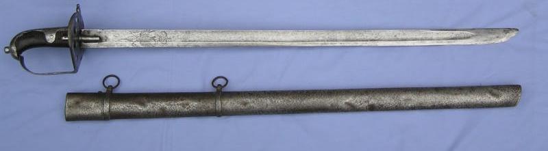

Here's one:

Lovely sabre Martin. Has the blade been shortened?

Originally Posted by Richard
Here's one:
Wow!!!! Now thats what Im talkin about Richard!!! Absolutely beautiful
Thank you so much for sharing that here,

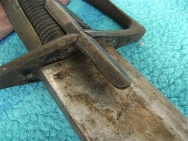

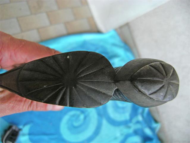

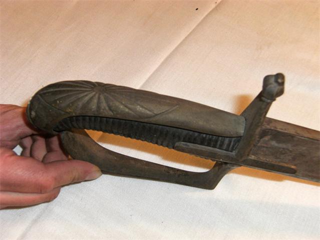

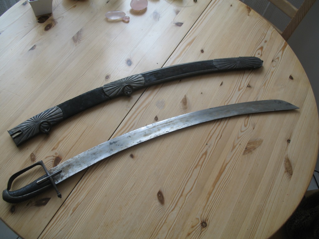

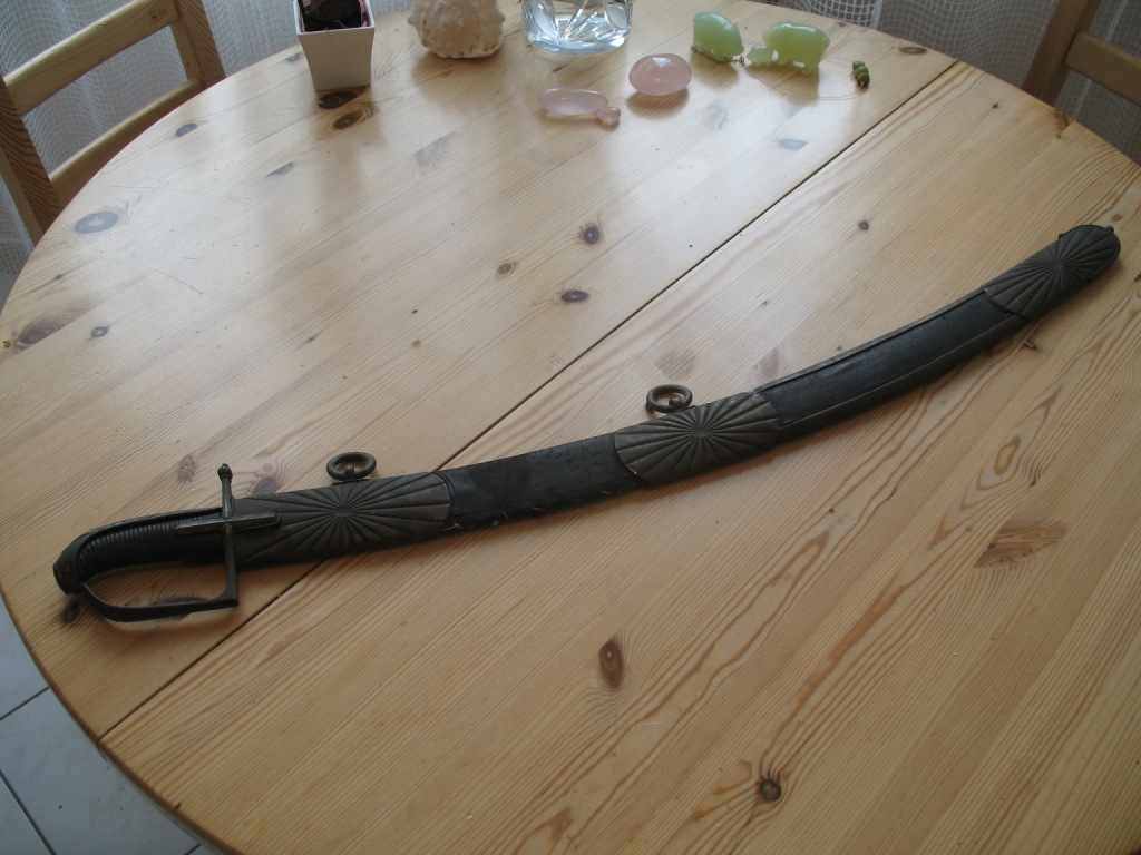

Hi Ian,
I donīt know as I bought it while I am in Africa and the sword was sent directly to Prague (and I am looking forward to seeing it in natura). But I donīt thing so. It could be fallacy, Enclosed please find another 2 photos.

Hello Martin,
It doesn't look like the blade has been shortened after seeing your last two photos. It does have a really meaty looking blade.

Thumbs up Follow-up
Received from a non-registered reader:
I have a copy of the Dolleczek book they mention ... the sabre is from the 1748-68 period as it is fairly plain, but brass mounted. It would appear to be an NCO's weapon as the men tended to have plain scabbards.

Thank you Lee.
This sabre is my "pleasure". The mountings are silver plated brass.

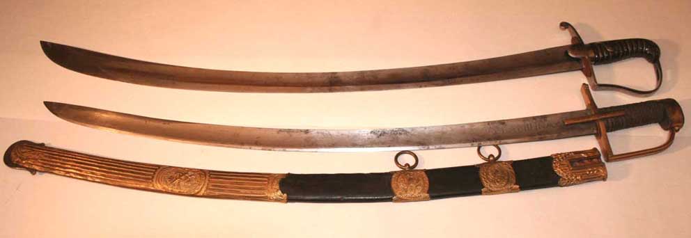

Default a follow on
Hi, here are two of my sabres, they are both takes on the earlier austro hungarian sabres. The first is a french sabre,from around 1767 and you can see that it takes its form from the earlier weapon. The second is the 1796 british light cavalry sabre and again you can see the earlier sabres form in the blade. Michael
