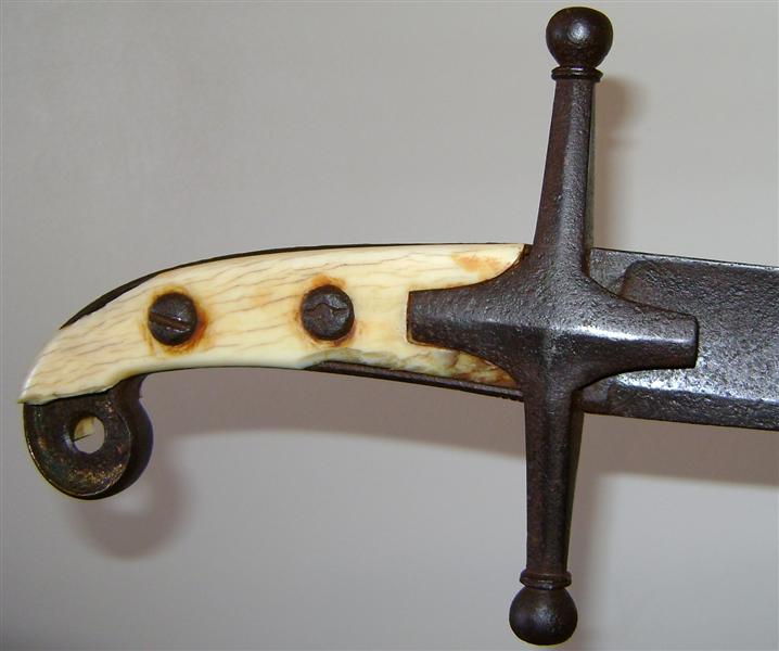

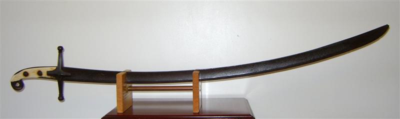

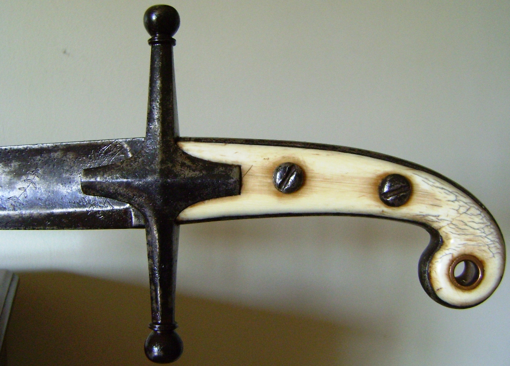

A friend has just offered me this sword, in a deeply rusty condition. He says it has been in the house, from as long as he remembers.
After a couple hours browsing and researching in my residual library, i found no paralel for this example.
I assume it would be a cerimonial or parade superior officer sword, either in Britain, USA or even Portugal, if it had a brass or golden guard, military office symbols (chief of staff and the like) and a slimmer grip and blade.
However this one seems to have been made for business, with its sturdy ivory grip, held by efective (no decoration) screws and a western strong (cavalry) blade, 81 cms. long and 35 mm. wide at forte.
The blade might have been original blued as, after being cleaned, remained 'naturally' dark. The martial decorations, composed of florals and drum (in one face) and canon (in the) other, might have been filled in white, and not the usual gold ... so it seems to me eye.
Doers anyone recognise these decorations as being typical of a determined country?
Or, above all, is this particular sword pattern variation recognisable?
Any sugestions will be so much thanked for.
Fernando

Hola Nando,
Engraved, not etched, meaning earlier than 1830s.
I have owned Napoleonic weapons with very similar art.

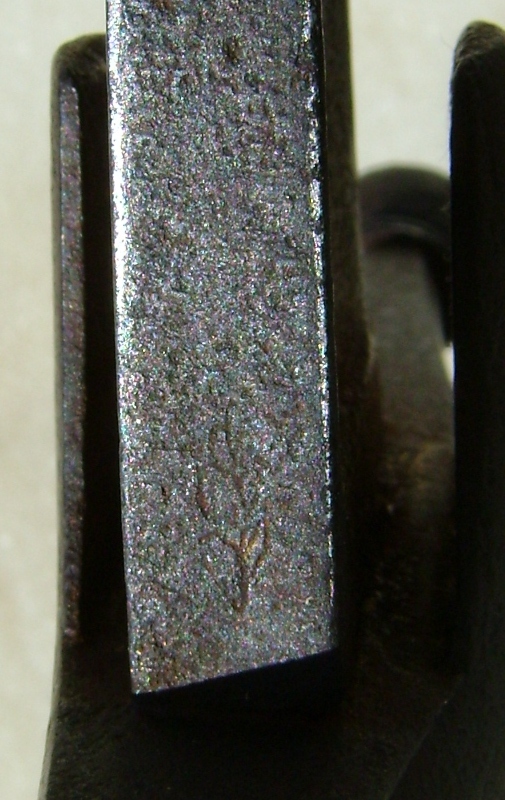

Does it have anything inscribed on its spine? Is the spine flat?
Best
M

Hi Fernando,
This is of course the famed officers sabre that became known as the Mameluke, as it was adopted by France, England and America in recognition of these renowned warriors of Egypt. The sabres used by many of these Mamelukes with the familiar Ottoman hilt immediately influenced French officers who began using this style sabre immediately after defeating the Mamelukes at the Battle of the Pyramids. The British adopted the hilt style with the pattern 1831 sword for general officers.
In America, the Marines became influenced by the style during the wars with the Barbary Pirates (1801-1805) and eventually adopted the hilt style, however 'officially' the sabres used by thier officers were a French style of European form from 1804-1818.
The first mention of the 'mameluke' sabre in Marine regulations was in 1825, and subsequently in 1833 and 1839, these swords were mandated for Marine officers. In "The American Sword" (H.Peterson, p.167) it is noted that "...despite the fact that the 1825 regulations were the first to make the mameluke hilt mandatory, there is some indication it was already being worn by some Marine officers".
From illustrations I have seen, these earlier ivory hilts were often carved with a kind of 'palladian' type arch and other subtle detail. The shape seems very much like this very plain example. It is interesting that the plain ear and langet on the crossguard which is squared off rather than rounded seems to have been known on these hilts.
The inscribed panoply of martial motif on the blade seems characteristic of many sword blades for officers in these times, and are found on many various European officers sword blades. It does seem somewhat possible this could well be one of the sabres privately acquired by a Marine officer on this early period just prior to 1825. The styling, simple hilt (noted as often typical on early Marine swords) and the military motif which was generally applied in many trade produced blades may be considered in this.
The only question would be why the E Plurbis Unum and eagle are not present if this was made for an American officer, unless this was a sabre made in the period, perhaps in France but was not specified toward export to America. There are other possibilities of course in these times of England at war with France, then England and America at war, with France remaining allied to America from the time of the American Revolution. In these times there was dramatic cross influence of military fashion, and the one point with this sabre is that it is an officers mameluke sabre, and probably of c.1820 quite possibly that of an American Marine officer from private purchase.
With this speculation I would of course look forward to the results of further research and other observations.
I have always considered these officers mameluke sabres to be more dress swords, but this one I really like as it looks strictly business The patination and minor damage simply add to that charisma in its presence, and if proven to be one of these early Marine sabres, that effect would be well understood.
All very best regards,

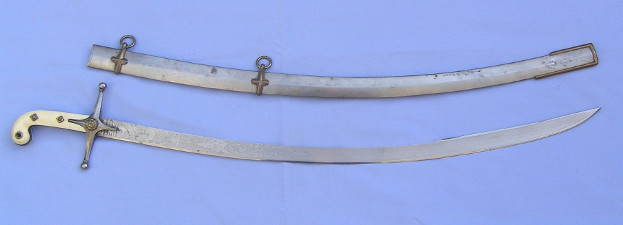

Hi Fernando
If I had to guess, I would say this is British from around 1810 - 1820. My hesitation comes from the fact that there is no obvious British insignia on the blade. Other observations are that the blade decoration looks typical of Solingen of the period and the truncated langets are quite unusual. I would very much doubt that it is French as the hilt lacks the normal ostentation of French swords and most French mamelukes had horn or ebony grips because the French didn't the access to Indian ivory that the British enjoyed.
As Jim says, this style of sabre became the height of fashion in Europe after the Egyptian campaigns of 1799-1802. It is said that hardly one French soldier came back without a souvenir mameluke sabre in his pack and I'll bet the same applies to the British as well. Judging from contemorary paintings of the period, their adoption in the British army was also far more widespread than many reference books would have us believe - both for dress and field usage. On the basis "if you can't beat them, join them", the mameluke sabre was adopted in official dress regulations in Britian in 1822.
Here is one of mine which was made by Prosser and dates from 1819-1821. It was carried by an officer of the 3rd Light Dragoons.
Richard

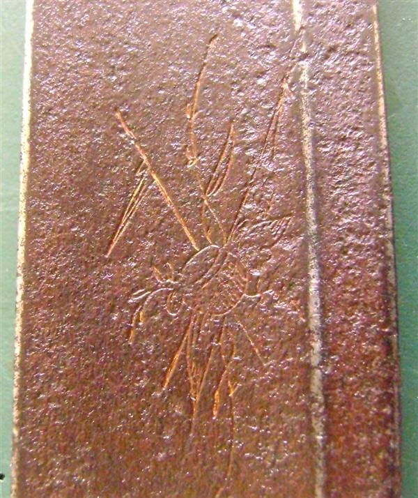

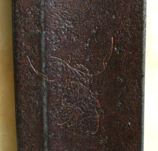

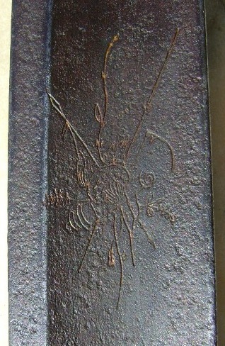

Thank you so much for your extremely interesting coments, Gentlemen.
Manolo, the spine is flat. The only engraving i can see on it is a little efect on the forte section, more looking like a floral decor than a graphic mark ... unfortunately.

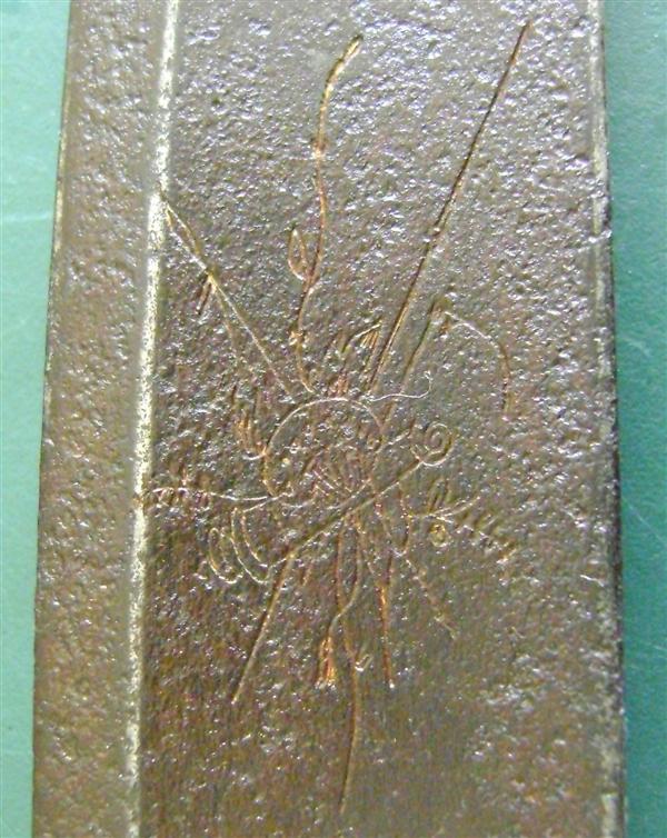

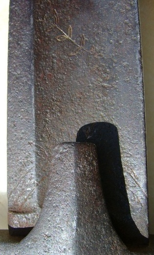

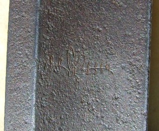

I have taken new pictures of the engravings, but the results were not such a success.
There are five decoration parts in both faces. One at the forte, partly hidden by the langets, composed of florals supported by semi circumferencial lines; next to it an isolated branch, followed by the main (martial) motif. The next is flower; finally a little narrow crosswise efect, of cursive type.
I still think this blade had (has) some dark finish to it, with the decoration in some whitish contrast.
I see Jim's point in that some of the martial efects in both faces may be lances ... eventualy with pennons. But aren't these, together with flags, drums and cannons, a mix that probably only pretend to be an allusion to the military theme in general?
Also i find well placed Richard's impression in that this must be a Solingen blade, as also accepted by Jim.
A private purchase, most certainly.
But then we have this riddle with the hilt; it does indeed lack the usual presumption of a sword to be used in parade or cerimonies by a General Officer. Also in Portugal these hilts were available for General officers, from which i have pictures of entire swords, as also loose hilt examples in one of my books.
It would then have probably belonged to a mid rank officer, definitely for use in combat. Also to consider that Generals had swords of plainer version to go on the field; would this be plausible?
Equally worthy of note is that Wellington, the person who highly influenced the fashion of Mameluke sabres in Europe, has been in Portugal between 1809 and 1814, in charge of the Anglo-Portuguese forces, during the Peninsular War.
I would also emphasize that the grip plates in these hilts are usualy held in place by the lanyard eyelet in the back end and their prolongation to beneath the upper langets in the front, the grip buttons being only for fantasy. In the case of this sword, not only the plates penetrate into the langets, as also the buttons are actual rather strong screws; even admiting that such screws were a later adiction ... still a symptom of this sword use in battle.
Once again thank you for your precious input. May i however, consider this an open thread, with a strong desire to soon find more about the identity of this sword.
Fernando

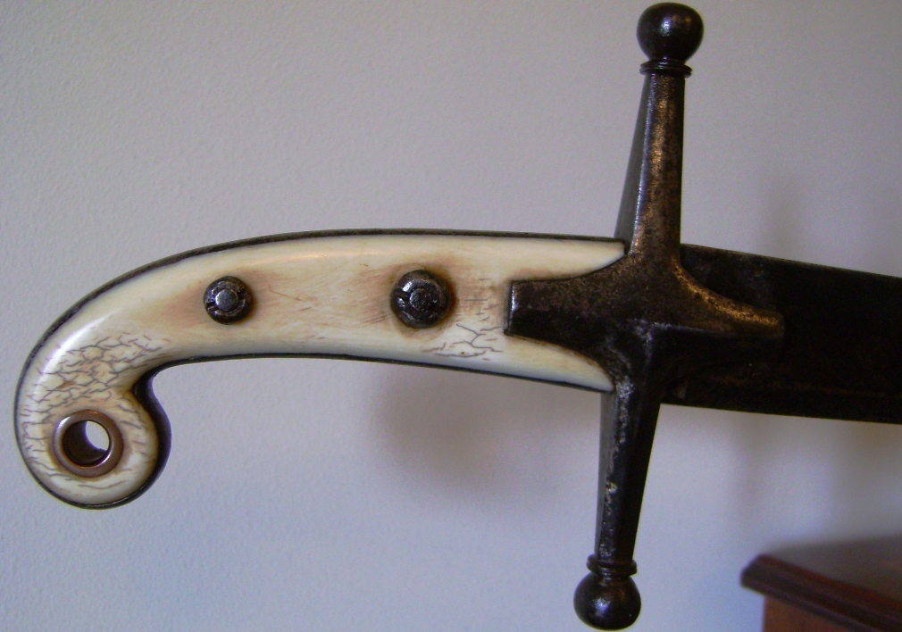

Let me post here the new look of this thread's sabre hilt, with a new pair of ivory plates. The restorer sure knew how to select an aged looking part of the material.
Pity the steel parts were much too cleaned ... at least beyond my desire.
