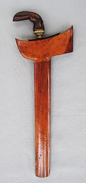

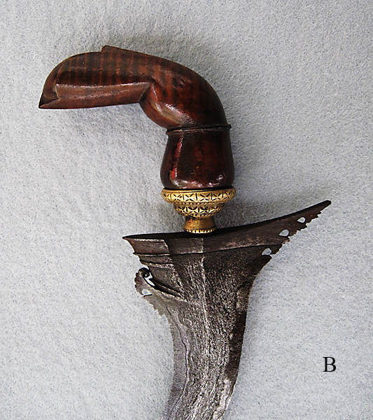

Here are a couple of keris that are outside my area of knowledge.
Would anybody care to give an opinion on geographic point of origin?

B-i think keris pandai saras from kelantan..nice blade actually..

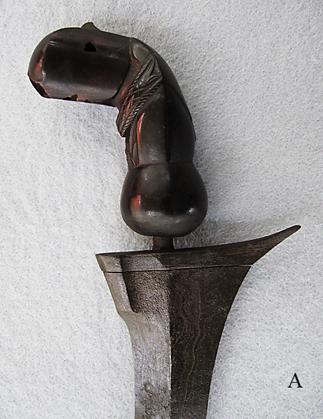

A is a Sumatran blade, like those we commonly see from South Sumatra, Palembang area. The sheath and hilt does not look Palembang or even the typical "Straits Bugis" forms. could be from a more inland area, closer to Minang heartlands.

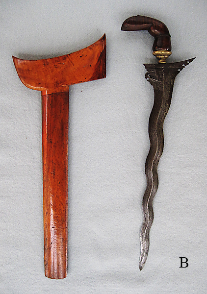

B's hilt and sheath looks Terengganu to me. The pendoko is unusual. Frankly, a little bit weird. The blade looks like N. Peninsula for sure, but the greneng and janggut form is something unfamiliar to me.

The way the gandik is recessed into the form of the blade and the steep taper of the sor-soran area (to borrow Javanese terms) would suggest an area of origin North of the Malaysian borders.

Thanks for your comments, Kai Wee.
Yes, I agree, a first impression of that straight blade would certainly be Palembang --- until you hold it in your hand, when you find that there is significant difference in percieved weight and balance (tanting) and differences in the material used from a Palembang blade.

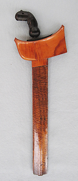

Here are a couple more pics of the two keris in their wrongkos.
Does anybody else have an opinion they would like to share?
I've had these two keris for a while, and I do have a little bit of info on them, but as I've said, this is outside my area, and I really would appreciate the opinions of people who know more about keris of this style than I do.

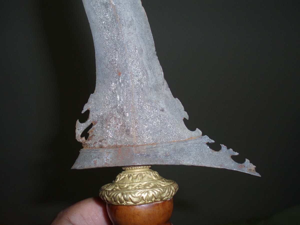

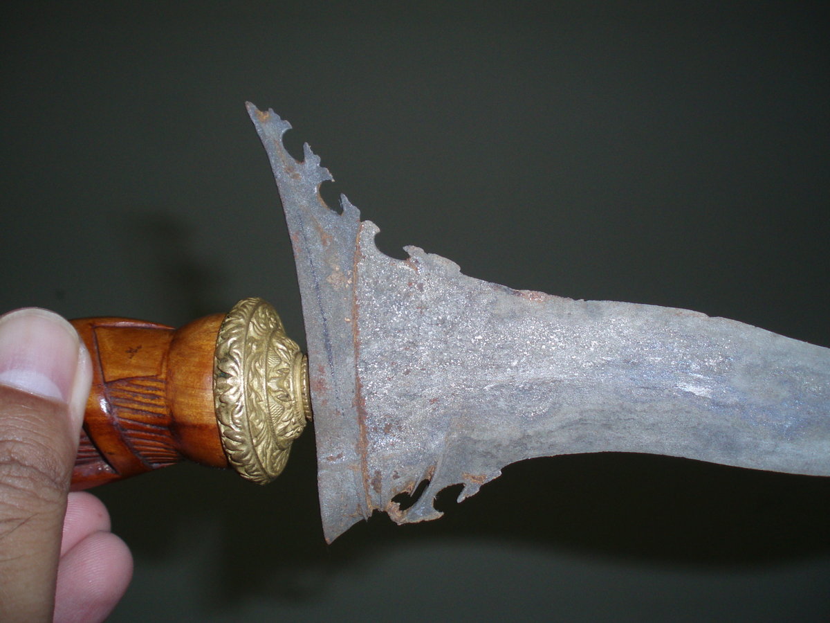

The 2nd keris having a peninsula blade called keris pandai mamat. Attached is sample picture of keris pandai mamat.

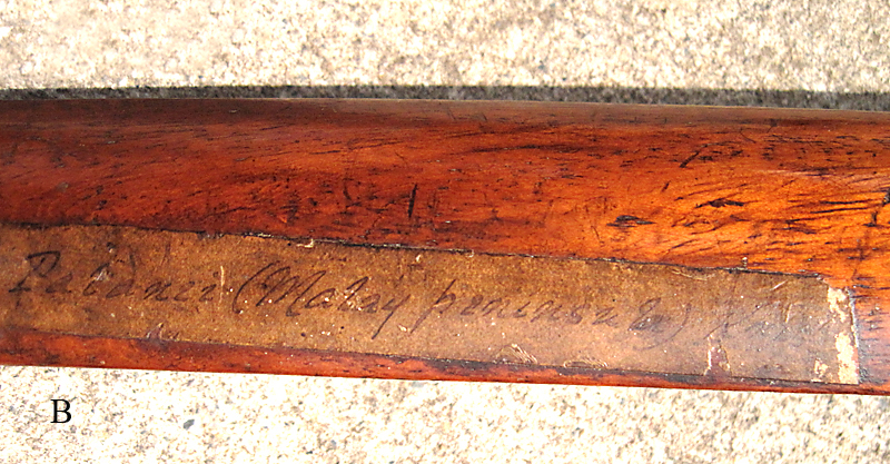

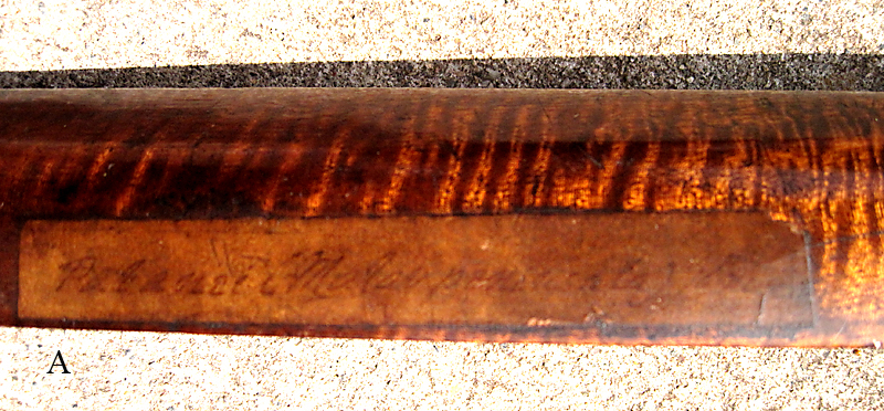

Below are photographs of the stickers glued to the scabbards by the merchant seaman who first collected them in the Malay Peninsula prior to 1910.

Both are very interesting keris neither of which fit the classic Pattani form.
The hilt of A does recall to mind hilts which I have seen in the collection of Nik Rashidin although horn is not very common as a hilt material in Pattani pieces or Peninsular pieces in general. They do happen though.
The blades, particularly that of B are also well within the realm of what is found in Pattani and Kelantan. In fact had I hazarded a guess I would have said B was a Kelantan blade but as I have already noted in my posts on Hanggoye's recent addition, the two run together in the middle.

The labels say "Malay Peninsula", but the place name where they were collected is decidedly unclear. I've had it under magnification many times over many years, and I don't know the place name with any exactness yet.
Is it Patanei or Palanei ?
Is Patanei a valid or antiquated spelling for Pattani?
Is Palanei the name of a place?
I don't know. Do you or anybody else know?
