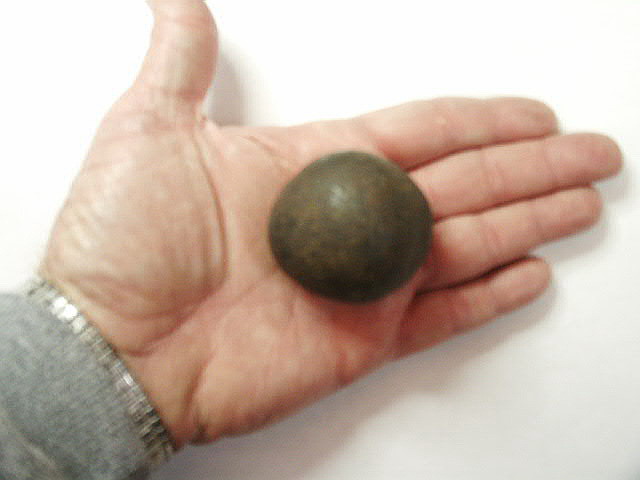

Attached is a picture of the ingot (mill ball?) I sent to Dr Ann ( taken from your great thread "Magnetic Weapons")
Is this the type you are asking about?

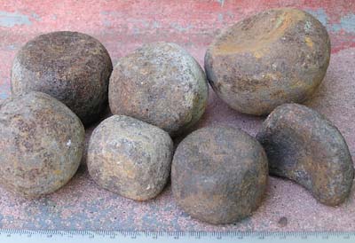

Since the last time this topic cropped up I found another photo of an original ingot, and a good illustration or two of the crucibles used to make them (which, of course, define the shape of the ingot ). The easy diagnostic feature on ingots is going to be some evidence of a former meniscus (that curve of the surface that contained liquids have near the edge) where the liquid steel met the crucible wall...here are two real ingots, three crucible shapes and some steel shot from a ball mill, you can see the complete lack of similarity!

Jeff, Thank you very much for your post and the pictures.
Form this, there is no doubt what mill balls look like, so you have cleared that problem very well - once an for all .

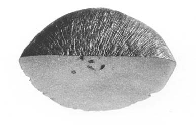

This is not an attempt to prove that these are wootz ingot or mill balls. It was discussed many times in several forums so I will leave it to the expert to decide. But since I was offering for sale few of these wootz/mill balls I feel I should share with you some facts and findings
I sacrificed one of this balls and submitted it to the good hands of Giora Biran, a blacksmith and a friend and this is what we have done:
The ball was cut into two halves with a disk and one of the faces flattened.
(Please note the crack in the center, also known as “pipe”. I will refer to it later.)
One half was heated to about 800 degrees and hammered down (in several heating cycles) to a flat bar shape:
One face was polished and etched to reveal a very clear pattern:
A small part of the bar was further forged to a small kitchen style blade (more and bigger blades are being worked out now), polished and etched:

1) These balls were cast in a crucible. The depression and the “pipe” seen on the cut ball is very typical to what happens in the cooling process in the crucible.[br]
2) It is hard steel. We did not measured the exact hardness but Giora estimate it to be (after hardening) around 60
3) The pattern is clear and very similar to what we have seen on Old Indian wootz blades.

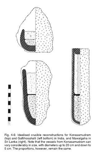

1) Definitely NOT cast in a crucible. The depression is the wrong shape to be derived from solidification shrinkage, the internal porosity is in the wrong place to be associated with the depression.
