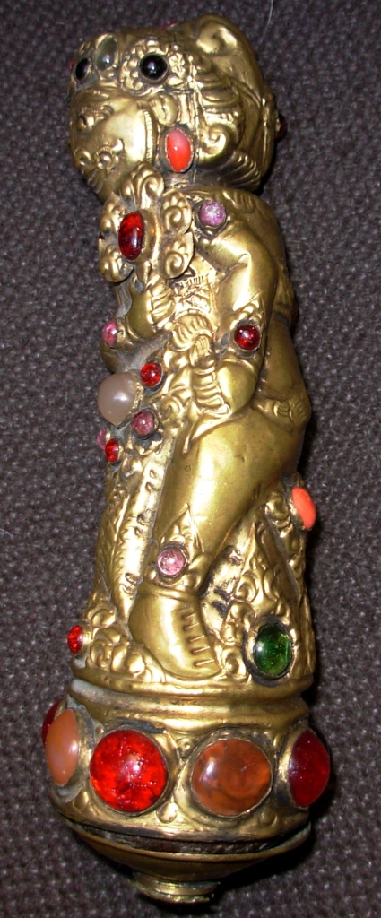

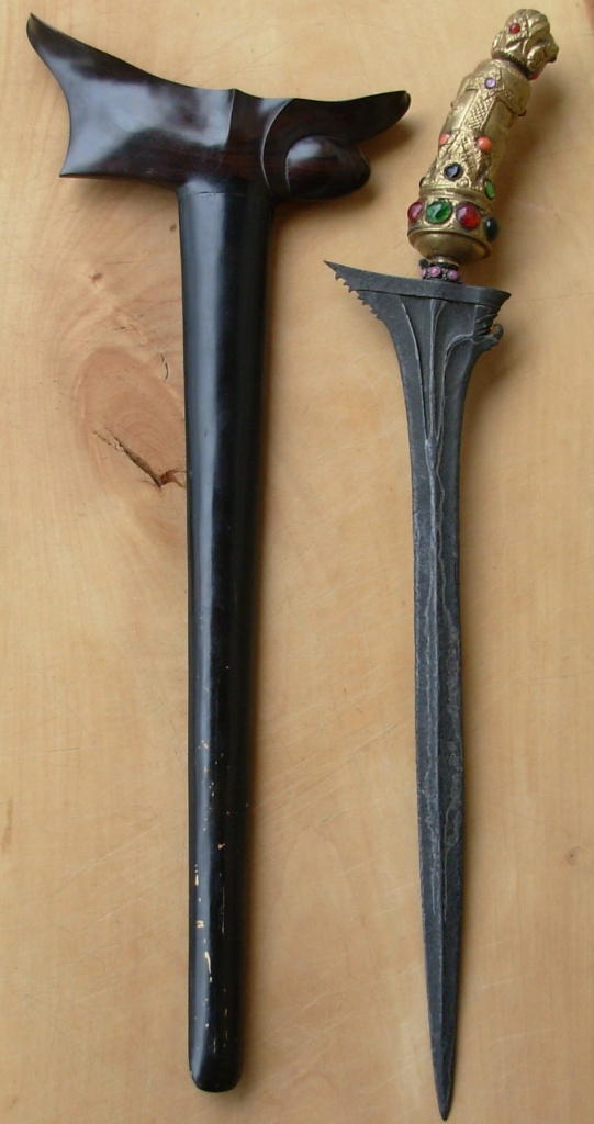

Seeking information for this wedding Bali Wedding Keris
am grateful for any information
gruss chregu

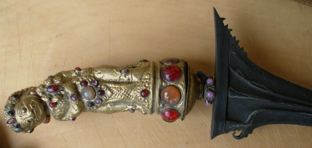

I am not sure what you mean exactly by this "kind" of keris. It is a fairly average Bali style keris in a form of Balinese formal dress (in regards to the sheath) which would, i suppose, make it appropriately dressed for a wedding. This sheath appears to be a fairly well carved one and looks to be of ebony and some other wood on the stem. The blade doesn not have the typical Balinese, high polished surface and stain. Could be it was restained outside of Bali or it might be from Lombok where the high polish staining was not always used. The handle looks like a somewhat low quality version of what i have heard many describe as a Bayu hilt, though i am not certain if this is actually supposed to depict Bayu (a wind god) or not. I cannot tell if it is just brass or if a god plating has been added over it, but the "stones" seem to be mostly pastes or low quality stones. I have attached an example of a higher quality version of this hilt style. This one also mixes pastes with actually stones which is not uncommon in Bali.

Yes, thank you, i am aware of the fan in the hand. Still, like all things to do with keris i have heard this attribution disputed. This is why i approach all definite identifications with caution.
I think that in this day and age all restrictions on gold worn by non-royals is most probably gone. After all, Indonesia is not a monarchy.
I also stop short of referring to all but the most obvious keris items as "tourist". Certainly this is a low quality example. Even the one i posted is not on the highest quality. If this keris had indeed been used in a wedding (and i guess this is possible) then this hilt would have seen actually indigenous use. can't really call it tourist then if that were the case. I am sure that in times where money is short people use what they can afford. As i noted this one looks brass w/ mostly pastes. It should be pointed out however that in Bali at least, the use of glass pastes instead of actual stones is not necessarily a sign of poor quality as some very fine Bali hilts will attest to, having pastes mounted right next to sapphires and rubies.

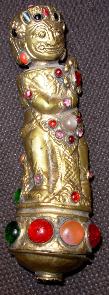

Sorry, I don't think that the hilt tourist made and I think that not all "stones" from glass, the orange one and the milky one on the stomach seems to be real stones and the hilt shows some wear. Of course it's a very simple hilt and the blade is also not very fine worked while the sheat is of better quality.
Maybe a composition? But this is difficult to say by pictures.
i don't think anyone is really suggesting anything different here Sajen. And again i will state that pastes can be found on very high quality Balinese dress as well as low grade like this one.

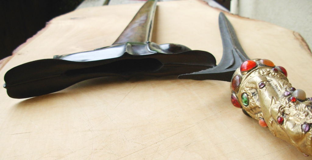

I would imagine that this sheath, though of higher quality than the hilt, is still not particularly old. It too is probably mid to late 20th century.

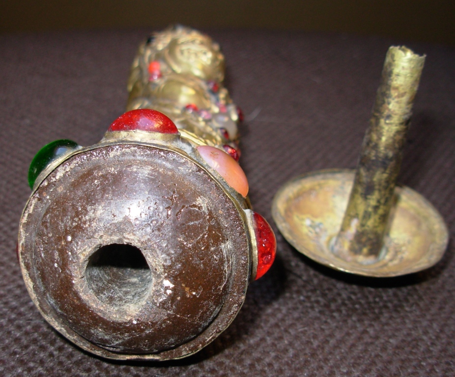

Many thanks for your efforts to help me ignorant too. smile.
you still add to that a few better pictures.
The handle is made of brass. the red, green, black and purple "stones" are made of glas
The silver-colored belly, the Orange and brown on the bottom, the orange hiter the leg and below the ear and the head is silver-colored stones are. I think.
Again, summarize the blade handle simple quality mid 20th century Bali
The Sarung good quality mid 20th century also
