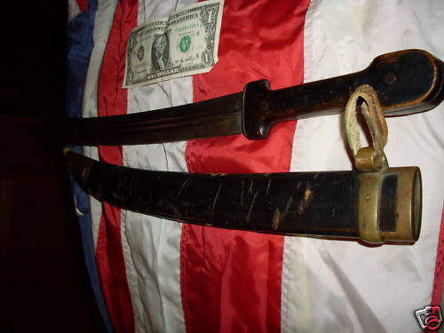

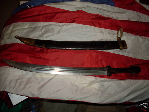

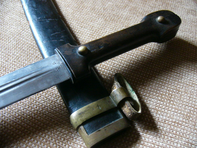

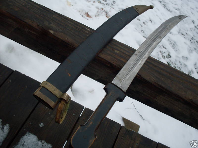

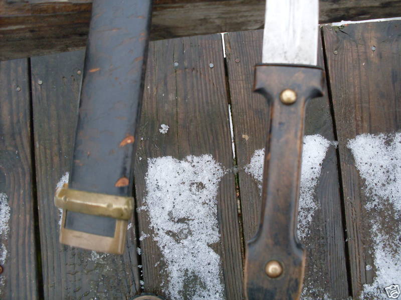

This is my last adquisition, This bebut sword from Russia. This type of sword aren,y my favourites, but I think the final price was good and finally I decided to bid. When I received sword I put pictures with details.

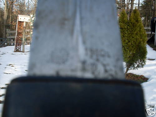

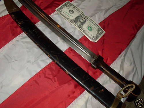

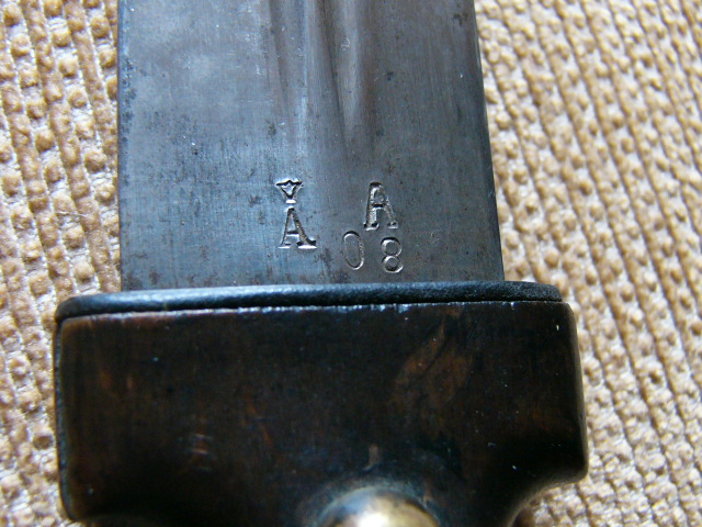

Better pics of the stamps on the blade and the scabbard would help. Check the leather: old and damaged vs. artificially aged, the blade ( too intact for a WWI weapon?) and the handle ( old wood vs. new staining).
99% of bebuts these days are made in India and China.
Sorry for the jaded view, but the contemporary market is brutal.

Hope you are correct, but how can one be sure without decent pics of the stamps? I, for one, cannot read the inscriptions at all.

2 Ariel: chinese and indian fakes are very bright and clean, and item's blade has original patina.

Aging steel blade is a piece of cake, they do it all the time.
You might be 100% right, but - no disrespect ! - I want to see the markings.

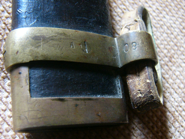

One thing is already making my antennae twitch: no markings on the upper scabbard fitting.
If I were the owner, I'd send good pics to a russian forum: some of these guys are incredibly knowledgeable and frightfully paranoid ( from daily exposure to bitter reality).

Ok, coming from someone not familiar at all with this particular model, but with some experience in fakes... yes, ageing metals is easy, which, coupled with less than ideal pics gets the job done.
Given the quality of the actual pictures and my level of familiarity with the model I don't dare to pass a judgement about the finer features or the lack of the usual brass fitting around the "guard", but I would like to point out a detail from my experience with other pieces: using a sharp instrument (knife, cutter, etc...) to add some wear to a leather or wood scabbard is a common practise. Usually it's done hitting it in a semi-random way. Overdoing it it's also fairly common, and tends to be a hint for a closer look. In this case, the scabbard is covered by marks from a sharp instrument, quite extensively, and quite homogenously, included the side that would be worn facing the body (see pic).
Again, let me be clear, I'm not passing any judgement. I can't: I haven't enough data. But, again, except in the most blissful cases, the signs that make us decide if an object is genuine or not are anything but clear and evident. More often than not, it's the accumulation of small details what makes us decide against a piece's authenticity. When there's enough lights in the board which are blinking red, we take a decision and call it "instinct", "nose" or "experience". It's normally well-applied accumulated knowledge, but it's sometimes hard to define or verbalize.
I just wanted to raise a flag that I feel deserves to be up, a call for, maybe, a pause and a deeper thought, that 's all.

This is an original M1907 bebut, not a copy. You've gotten quite an excellent deal on this piece!

It is so moronic, that the piece is likely to be authentic...
Congrats, you got yourself a steal!

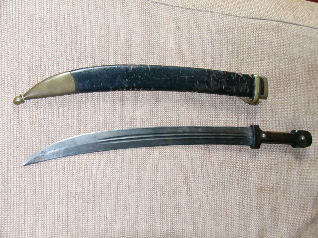

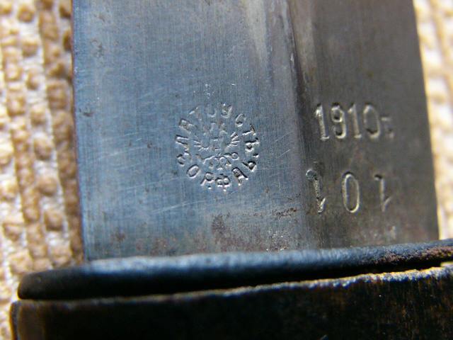

Few days ago I have received sword and I think is real bebut sword, not copy,the patiba in handle seems good and marks too.
I wait your opinions.
thanks in advance
carlos
Old 24th January 2010, 05:18 PM   #16
Looks OK to me

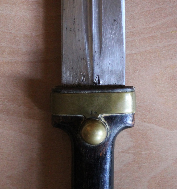

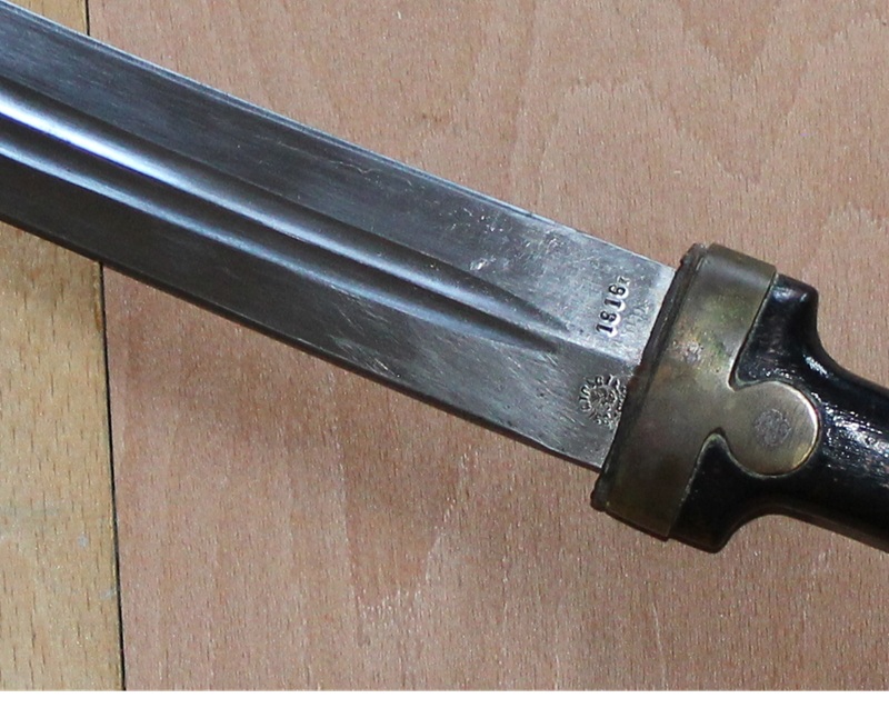

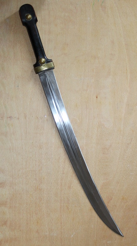

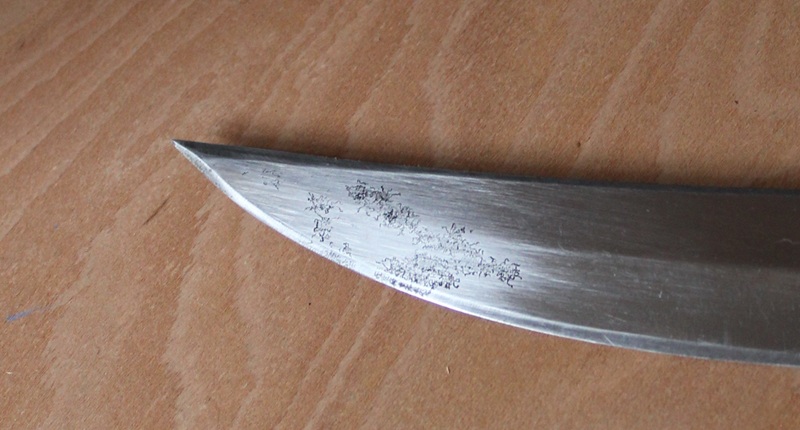

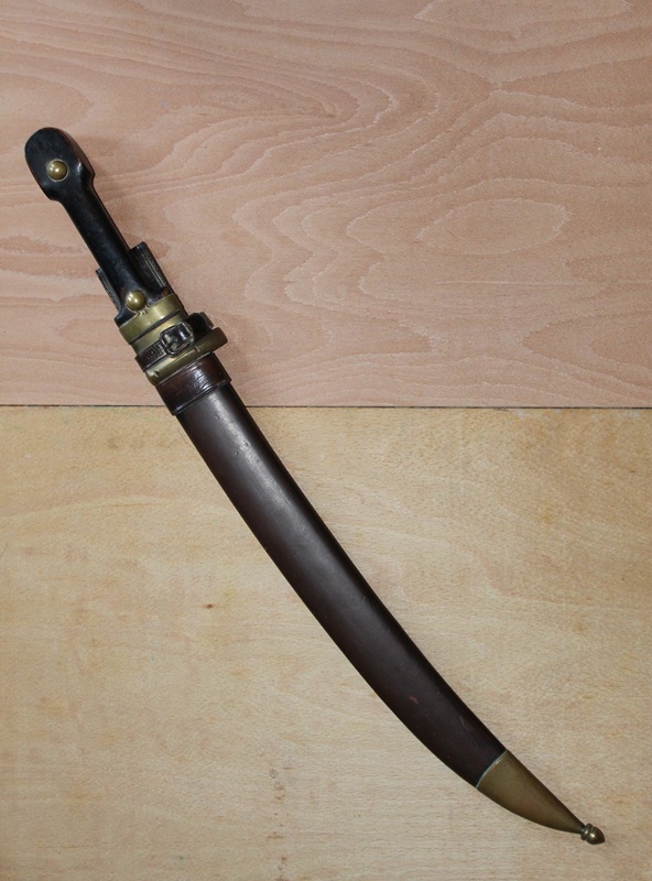

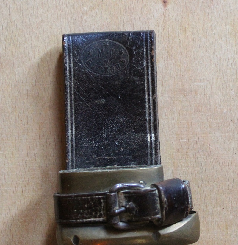

Old 5th June 2026, 09:42 AM   #17

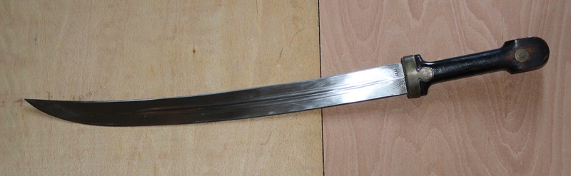

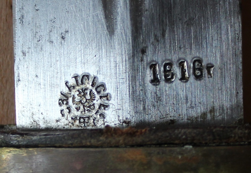

Posts: 6,032
Default 1916 Bebut
My latest piece. Not cheap but when compered to the fairly resent massive inflation of really quite ordinary ethnographic pieces, really quite good value. I was never into military stuff as it was always too expensive but these days I think the table has turned.
Now I have this piece in my hand I can see why they are rather sought after. I am gathering a small group of Imperial and Soviet Russian edged weapons and this fits nicely with the two versions of the m1881 {shashka} sabre and the M1927 Shashka. I wonder if I will ever come across the straight bladed military Kindjal which I believe was only in production for the last two years of WW1 and therefore far less common. Do any members have one to show?
All the stampings seem correct and especially nice to have the Moscow? stamping in the leather frog. The scabbard is not leather but a rubber or rubberised resin, resinous lacquer over wood. Lovley clean blade except for a spidery stain at the tip which I cannot remove without being more aggresive to the metal. I have to say that I am happy with but pricey. Ouch!!
The stamp on the leather seems tp be mr БИТКОВЪ, company name ??
Hi, Tim.
My friend from Russia sent me this information:
The Cyrillic letters "МГ" (MG) stand for the Russian abbreviation "Magazin haberdasheri". "Битков" (Bitkov) is a surname.
Alexander Alekseevich Bitkov (1871–?) was the owner of a gunsmith shop in Moscow, which supplied goods to, among other things, the Russian Imperial Army. His establishment was one of the largest in Russia in terms of the range of weapons and related goods. He emigrated from Russia in late 1918, amid the revolutionary events and the nationalization of private trade.
Turkoman.khan is offline   Reply With Quote
Old 11th June 2026, 03:31 PM   #19
Posts: 6,032
That is very cool, thank you.
