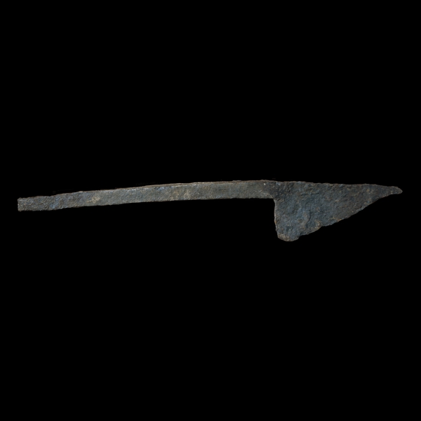

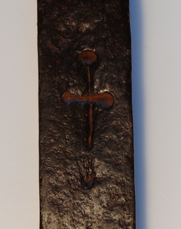

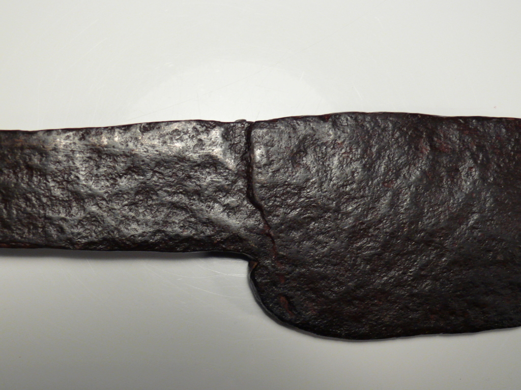

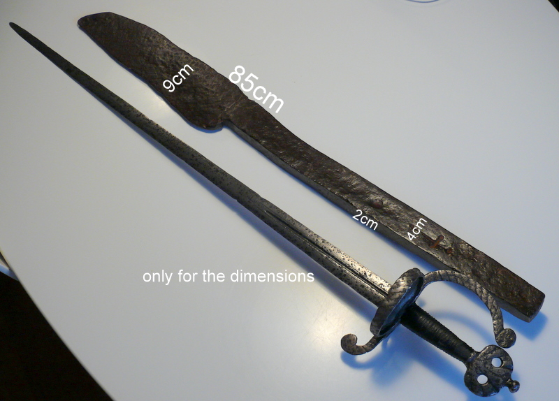

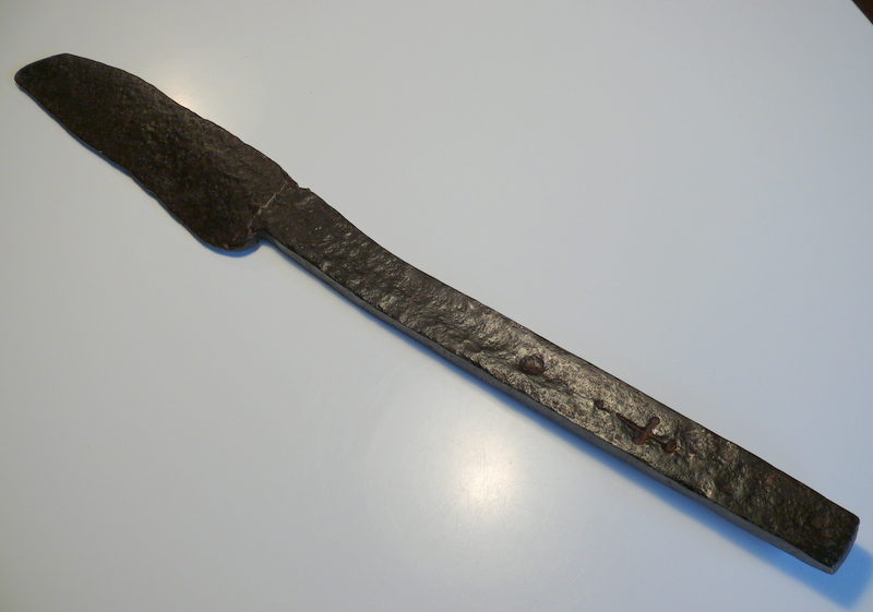

Old 11th November 2009, 03:40 PM   #4
cornelistromp
cornelistromp's Avatar
Join Date: Mar 2009
Posts: 1,071

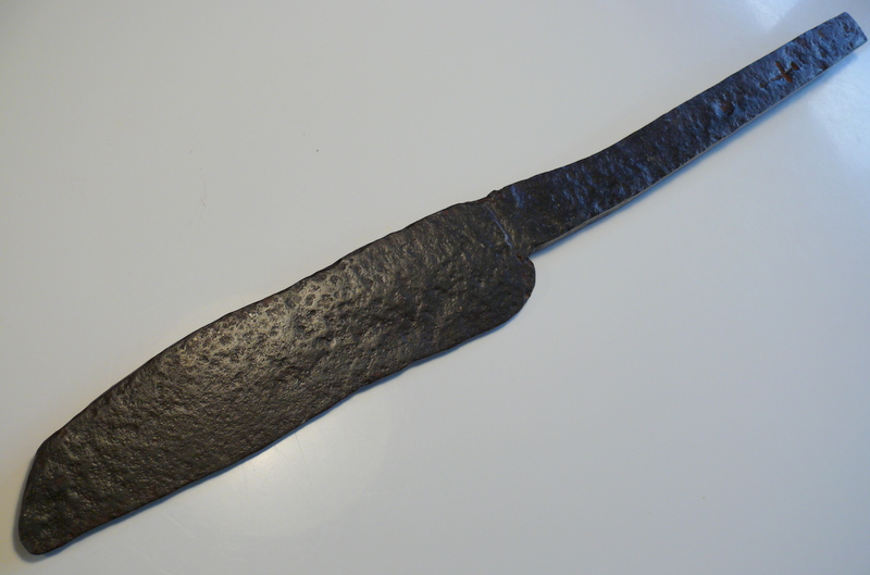

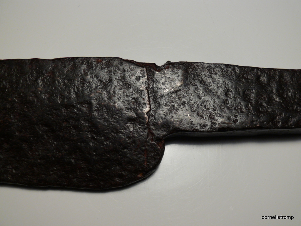

from own collection!
Can somebody provide some info concerning the cross mark?
thanks+regards
Old 11th November 2009, 06:01 PM   #5
katana
katana's Avatar
Location: Kent
Posts: 2,658
Hi Cornelistromp,
the item looks to be more agricultural than a weapon, although a number of agricultural tools were utilised as weapons.
Unfortunately, there seems to be evidence of arc welding , a recent repair ? or worse ....an attempt to deceive. It is therefore possible that the 'blade' and the 'tang' section were originally not together.
Kind Regards David
Old 11th November 2009, 06:36 PM   #6
cornelistromp
Join Date: Mar 2009
Posts: 1,071
Old 11th November 2009, 06:37 PM   #7
cornelistromp
Join Date: Mar 2009
Posts: 1,071
Originally Posted by katana
Hi Cornelistromp,
Kind Regards David
Hi David,
Agricultural tool,can you tell me for what purpose , have you seen something similar, maybe you can post in this thread ?
on the pictures it looks like welding because of the relief however
there are absolute no traces of welding, the parts have been hammered together when it was made approx 700 years ago.
Best regards

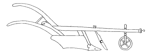

Old 11th November 2009, 08:51 PM   #8
katana
katana's Avatar
Location: Kent
Posts: 2,658
Hi
possibly a blade from a plough (a coulter).....the first pic is of a medievel plough . The second is from the British museum and is described as .....
Iron plough coulter
Roman Britain, 1st-4th century AD
From Great Witcombe, Gloucestershire
The coulter was a technical innovation introduced to Britain by the Romans. Its function was to make a vertical cut in advance of the plough-share, which then undercut the furrow made by the coulter. This made it easier to cultivate heavy soils. Roman coulters were therefore stout knife-like iron blades with a heavy shaft by which they were secured to the plough's wooden beam.
W.H. Manning, Catalogue of the Romano-Britis (London, The British Museum Press, 1985)

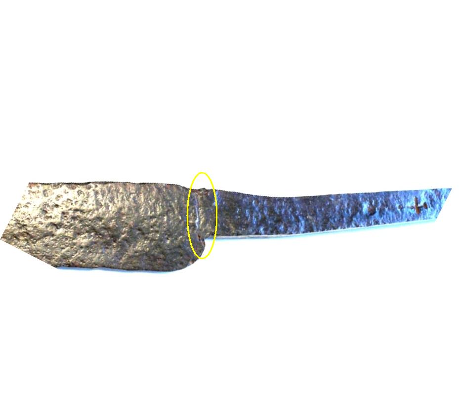

Could you post a picture of the other side of the crack (shown in the first picture of your last post) as this is where I suspected the 'weld'.
Even if this is a 'coulter' .....who's to say that during war it might be utilised as a weapon.
Plough shares to swords
Best Regards David

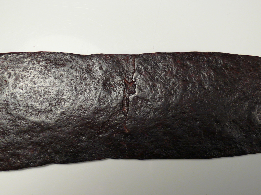

Old 11th November 2009, 09:06 PM   #9
cornelistromp
Join Date: Mar 2009
Posts: 1,071
Hi David,
thanks, so this is something for the agricultural museum
herewith a picture from the other side.
btw you can see a similar line on your picture from the museum.
Best regards
Old 11th November 2009, 11:16 PM   #10
katana
katana's Avatar
Location: Kent
Posts: 2,658
Hi Cornelistromp,
still an interesting object in its own right. It is always disappointing to find a piece which you believe is a weapon ...then to find out it is something else
I have done this myself ....... a number of times
....here's one ...which others had a little fun with
http://www.vikingsword.com/vb/showth...ight=asparagus
All the best
Kind Regards David

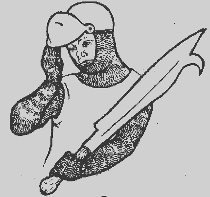

thatching tools, particularly the eaves knives (no.5 below) - looks like a long single edged knife on a 3ft pole, look very weapon-like, as do hay knives.
drawing of thatchers tools:
more
hay knives also come in some rather odd shapes, used for cutting hay bales and trimming hay stacks to shape. (google on 'hay knife')

Default Plough Coulter
Hi
The original item is almost certainly a plough coulter - the origins of the word for knife in Latin 'cultellus' also gives us words such as cut, cutter in English and couteau in French.
Many agricultural tools could have been used as weapons, or turned into weapons.
Bill hooks can be concave (i.e. with a hook), but also convex or even straight bladed (see www.billhooks.co.uk), or with a back blade, or a hook.
Fitted to a long handle they become the English slasher, the American brush axe or the French croissant.
Given an even longer handle they become pole arms - various names given, depending upon the blade shape and country of origin - in the UK the most common was the bill....
Billhooks were just known as bills until the 19th century - sometimes with a prefix such as hedging bill - hookbill is another spelling - origins probably hackebeil (DE) or hakbijl (NL) - meaning a chopping sword or axe....
The Dacian falx, one of the few weapons to strike fear into the Roman legions, was shaped like a big billhook. Falx in Latin means sickle, or with a suffix it means billhook (falx vinitoria, falx silvaticus, falx arboraria - spellings may be off at it is late at night here in the UK, and well past my bedtime...)
