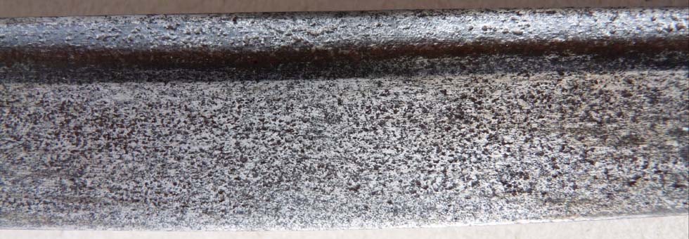

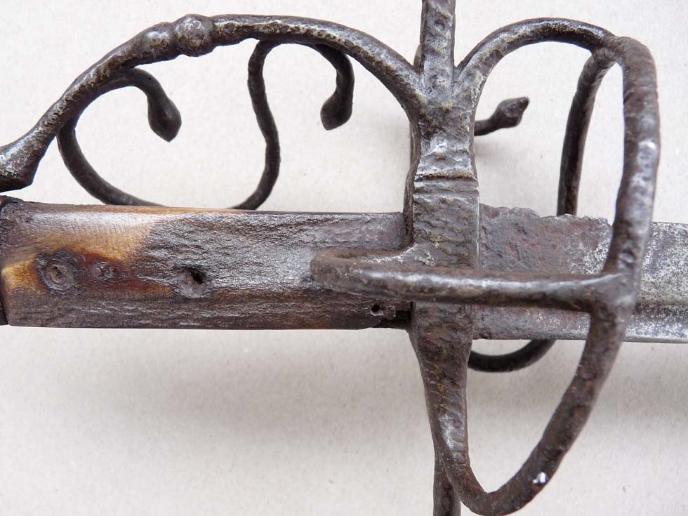

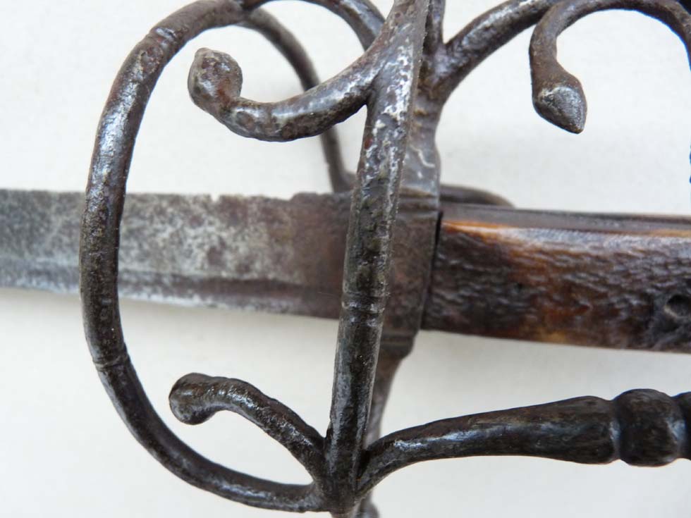

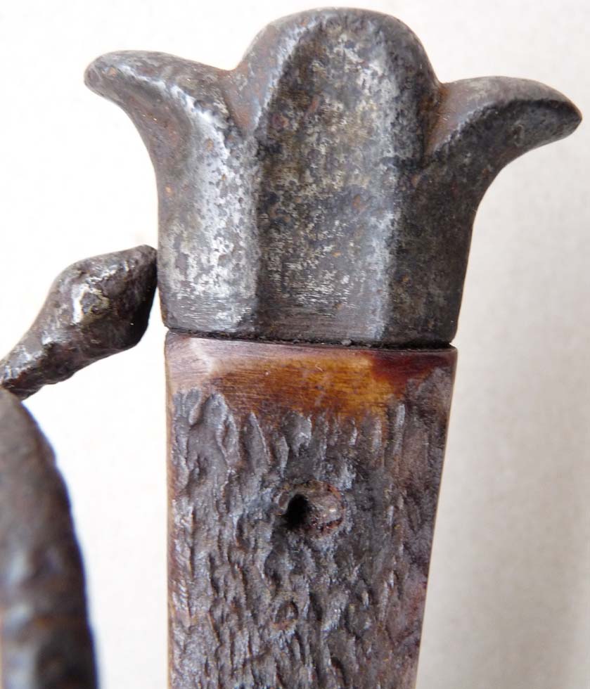

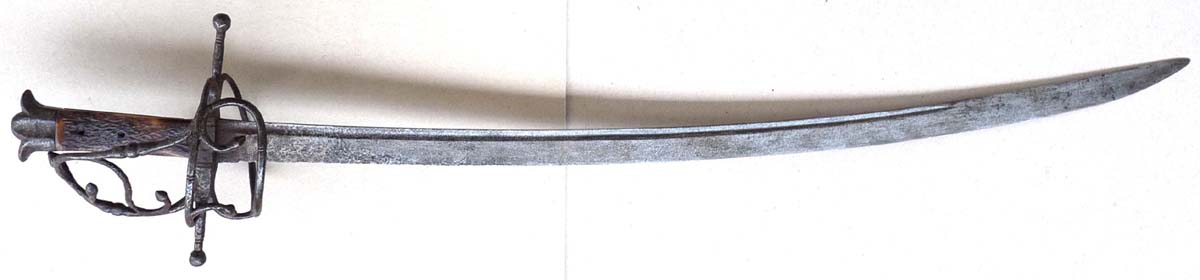

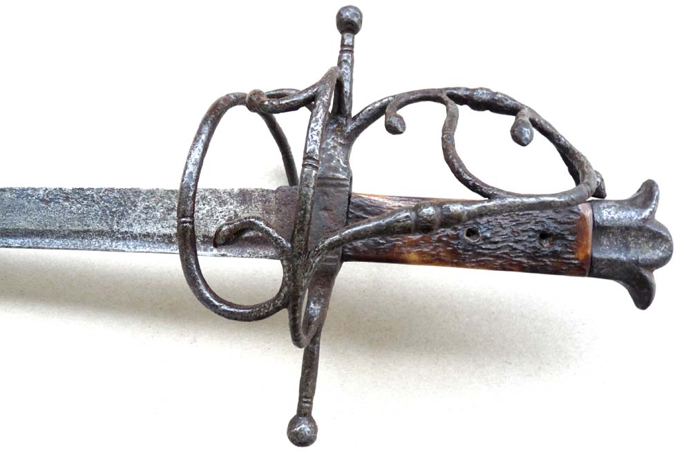

I posted this as part of my thread on 15th and 16th c. Italian edged weapons but am afraid that it might have been overlooked among the flood of material provided there, so here it is in a thread of its own.
It has been in my collection for seven years. No other similar saber is known in any museum or private collection.

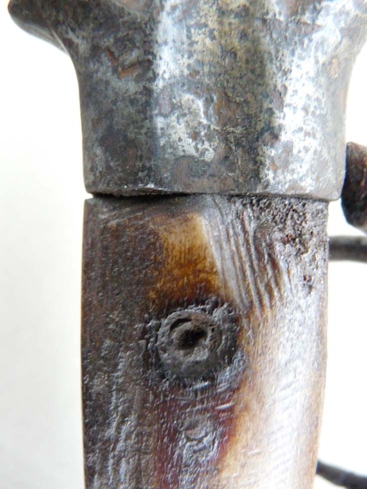

Ca. 1510-15, retaining natural staghorn grips (maybe a working time replacement) fixed by iron tubular rivets and the single edged blade preserved in its original length but reduced somewhat in width by long and heavy use, the tip double edged; the overall length of the saber is 94 cm. This one may well have seen service at the famous Battle of Pavia in 1525.
Note that the rare trefoil pommel is not riveted but copper soldered to the tang which, together with the two piece staghorn grips fixed with tubular rivets, denotes that this light saber is characteristic cutlery work, just like a Grosses Messer or Seitenwehr (Kurzwehr) - does anyone know the English term - Cornelis?
The item is preserved in virtually 'untouched' condition throughout; the blade is partially pitted and jagged, the hilt retains much of its original blackened surface and is pitted. After I applied olive oil to the iron surfaces (the contemporary so-called tree oil used in armories for hundreds of years) the rust turned to a bluey black which, interestingly enough and according to my experience, is absolutely typical of all ironwork surfaces between roughly ca. 1480 and 1540.
This piece goes perfectly together with my four early 16th century Landsknecht matchlock arquebuses to which it also closely corresponds in its overall length of 94 cm.
Michael

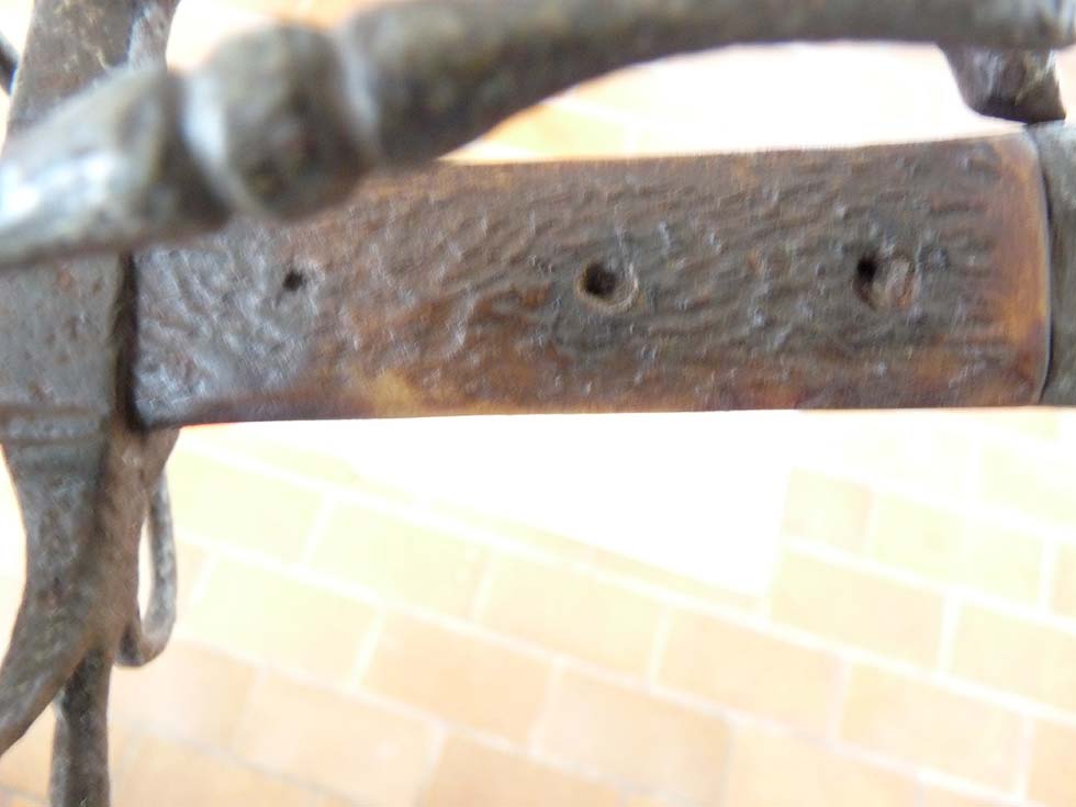

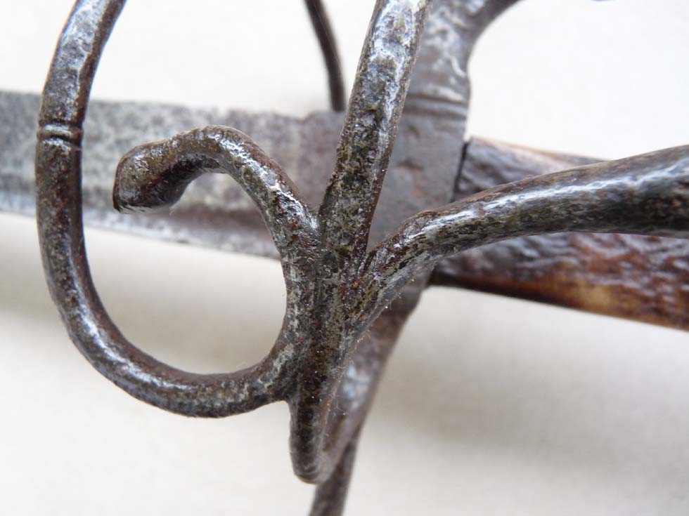

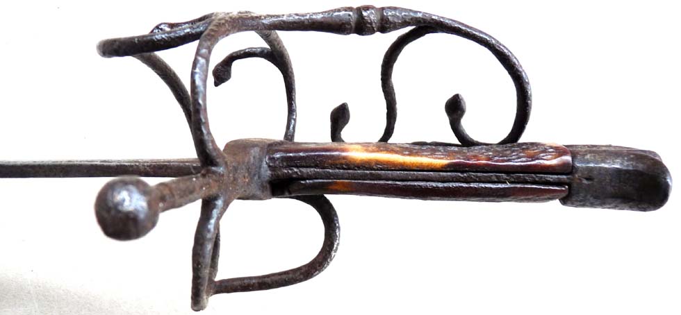

The rest of the images.

Hi Michael,
Amazing!!!!!!!!
extremely rare and extremely beautiful landsknecht saber
congratulations Michael, this one would also fit perfectly in my collection.

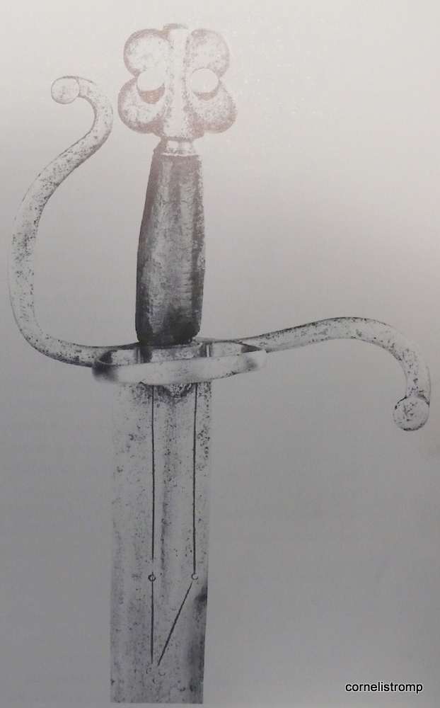

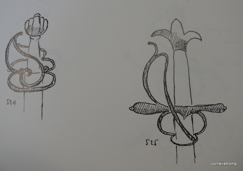

A similar developed basket look-a-like hilt is published in European weapons and Armour by Ewart Oakeshott. see pic.
I also found some pommel similarity in the sketches of R-J Charles taken from paintings of Lucas Cranach 1516-1586.
CF the thumb ring; the first illustration with this type of thumb ring known, published by A.V.B. Norman, is in the portrait of Melchior Hornlocher by Hans Bock I, dated 1577 (Basle oeffentliche Kunstsammlung, inv NR 80).
your saber is definitely earlier,however because of the developed Hilt later then 1530, I assume it can be dated between 1535-1540.
Best regards

Absolutely stunning, a true conversation piece!
From a general point of view, it shows great resemblence to the famous Swiss hand and a half saber.
I would call it a hybreed between a messer and a Sinclair saber.
The entire construction, sans the gard, is pure central European messer. This kind of construction prevents the replacing of the guard alone, hence I think is the brazing at the pommel.

Nice piece Michael
As has broadaxe cleverly pointed out the hilt and more elaborate guard shows more central european origin than oriental / central asian.
Thus I would kindly disagree (if I may ) on terming the weapon a "sabre". It is true that such pieces are sometimes hard to label by precise definition and often fall into several categories , yet I would like to bring up one point.
The most prominent feature of a "sabre-proper" (for lack of a better term) seems to be its canted hilt (at the very end , usually accompanied by a small pommel) and , not so much the curved blade (overall it gives you a kind of a "S" profile ; mind you there are various breeds of single edged and curved bladed swords , messers and falchions that arent really a product of central asian influences).
For comparison look at the hilt on the original weapon posted by Michael/Matchlock and compare it with these:

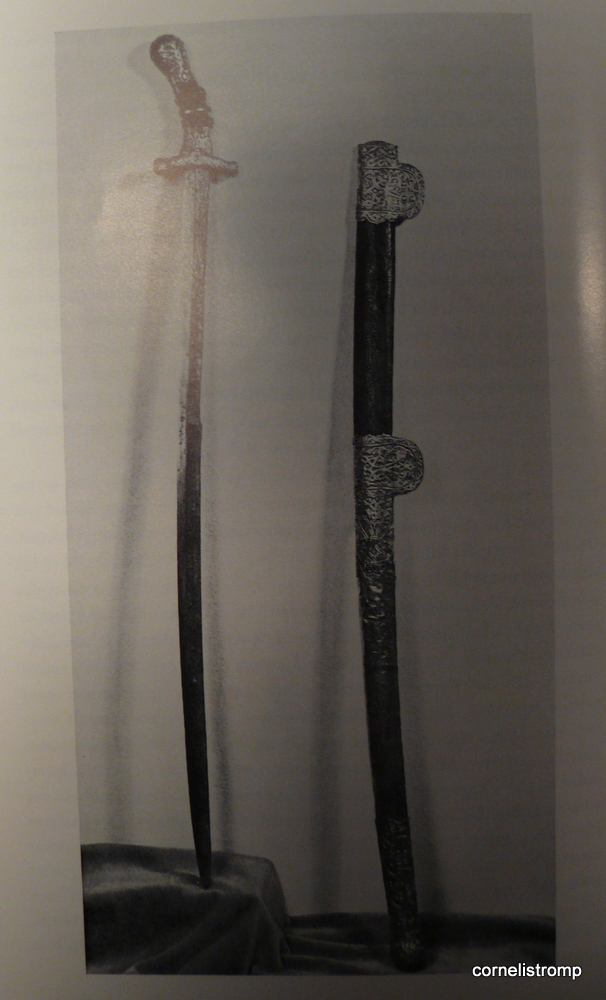

sword of sultan mehmed :
Note the canted hilt at the end.. also the curvature on the blade isnt so much dramatic , but the overall "S" profile can be visible
To give some other examples of typical sabre hilts here is a
Classical Hungarian 17th century sabre (again the way how the hilt ends is interesting):
15th century "Schiavonesca" saber :
Note that despite having a sword-like hilt it is indeed canted at the end and again forms a sort of a overall S-profile.
A closeup on the messer that belonged to Kaiser Maximmilian I :
One can spot the "knife like" ending , with the grip being straight, which is different to that of central asian influenced sabres. Going further some messers actually have quite a curve on their blade (albeit without the yelmen , another "saberish" feature which is missing on Michaels piece). Of course there are examples that are a bit of "wild cards" and have both sabre as well as "genuine european messer" features ,but they seem to be quite rare.
For those aforementioned reasons I would somewhat hestiate calling it a sabre. Not here to spark any heated debate , but I am geninuely interested whats your take on the issue.
Samuel

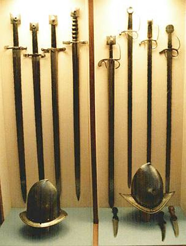

The term you're using - Arquebusier's saber, why do you think this weapon was carried by an arquebusier?
Thanks!
Old 20th October 2009, 05:41 PM   #15
Matchlock
Matchlock's Avatar
Join Date: Sep 2008
Posts: 4,310
Hi Cornelis and Samuel,
Thanks for ensuring me that the thing is definitely a saber.
Ariel, I do consent that what I, for reasons of historical art terminnology, have come to call the late Gothic trefoliate pommel can certainly be seen as a formal predecessor of the 'cat's head' shapes on later schiavonas although we must not forget the vast variety of Late Gothic and Early Renaissance stylistic elements many of which were still 'alive' one or two centuries later, especially in Italy.
To me, the significant square pommels of the ca. 1450 to 1500 Venetian swords seem to be closer relatives to the later schiavona pommels.
Also, as to the discussion of the relatively refined hilt on my saber and its consequent dating I enclose more North Italian, mostly Venetian, sword hilts, all of late 15th to early 16th c. date (the one on b/w ill. 45 with a later ca. 1550 guard but retaining its trefoliate pommel and grip of ca. 1500), two of them featuring a horizontal side ring, all preserved at the Palazzo Ducale, Venice.
So when I sort of open the dating range of my saber to 'ca. 1520-5', do we have a deal then?
Michael
Old 20th October 2009, 08:13 PM   #16
Matchlock
Matchlock's Avatar
Join Date: Sep 2008
Posts: 4,310
Thanks!
Hi Dmitry,

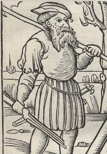

I think it was most of all the relatively light workmanship (which is far from the solidity of a Katzbalger) and the missing of a pronounced yelman on the blade that convinced me that this was not an item of primary but rather of auxiliary armament, meaning that the main weapan for this landsknecht to rely on must have been an arquebus.
Please note the small swords resp. sabers of the arquebusiers in Ruprecht Heller's painting The Battle of Pavia, National Museum Stockholm (dated 1529, the battle took place in 1525) with their developed hilts! (s images attached). These hilts are very close to that on my saber while the pommels in this painting are what we would normally assign to the 1550's-60's!
Michael

Hi Michael,
the sword hilts in the painting look a bit like this one.
Best regards

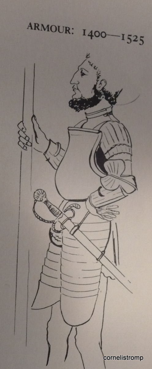

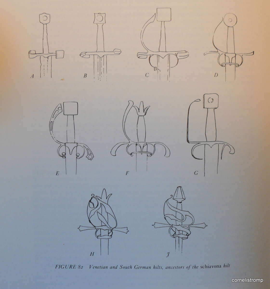

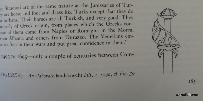

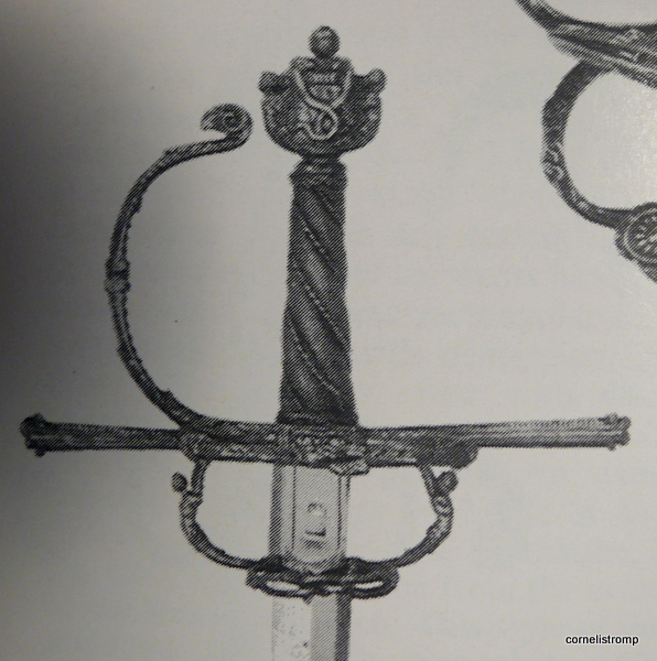

Default late landsknechtswords ancestors of the schiavona?
Ewart Oakeshott states that the early venetian but also the later form of landknechtssword (later forms are developed landsknecht hilts with a half developed basket or a full basket, in the picture H en J) are both ancestors of the Schiavona hilt.
picture 2 quote from Ewart Oakeshott European arms and armour;
"it is generally held that some of the late form of landknecht sword hilts had a lot to do with the development of the schiavona too".regards from Holland

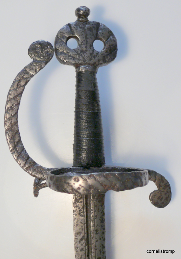

How would you date the light Italian sword the hilt of which resembles those illustrated on the Pavia painting?
Hi Michael,
Do you mean the sword in my collection, it is not so light piece
I would date it around 1560-1570, but this one is not so easy
the shell shaped pommel with pierced holes appeared already at the end of the 15thC.
the simple hilt form with ring guard and knuckle guard with disk shape terminals
like this are seen around second quarter of the 16thC on-wards. the Counter guard with this type of "hook" and thumb guard can also be seen on many later 16thC swords (Fe Tussacks) and the same striped decoration can be found on a 1510 sword hilt published by Oakeshott in European A&A.
best regards from Holland

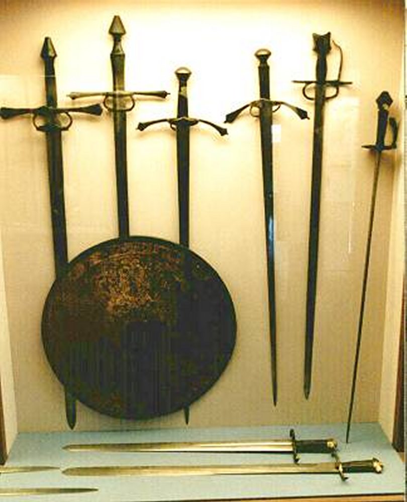

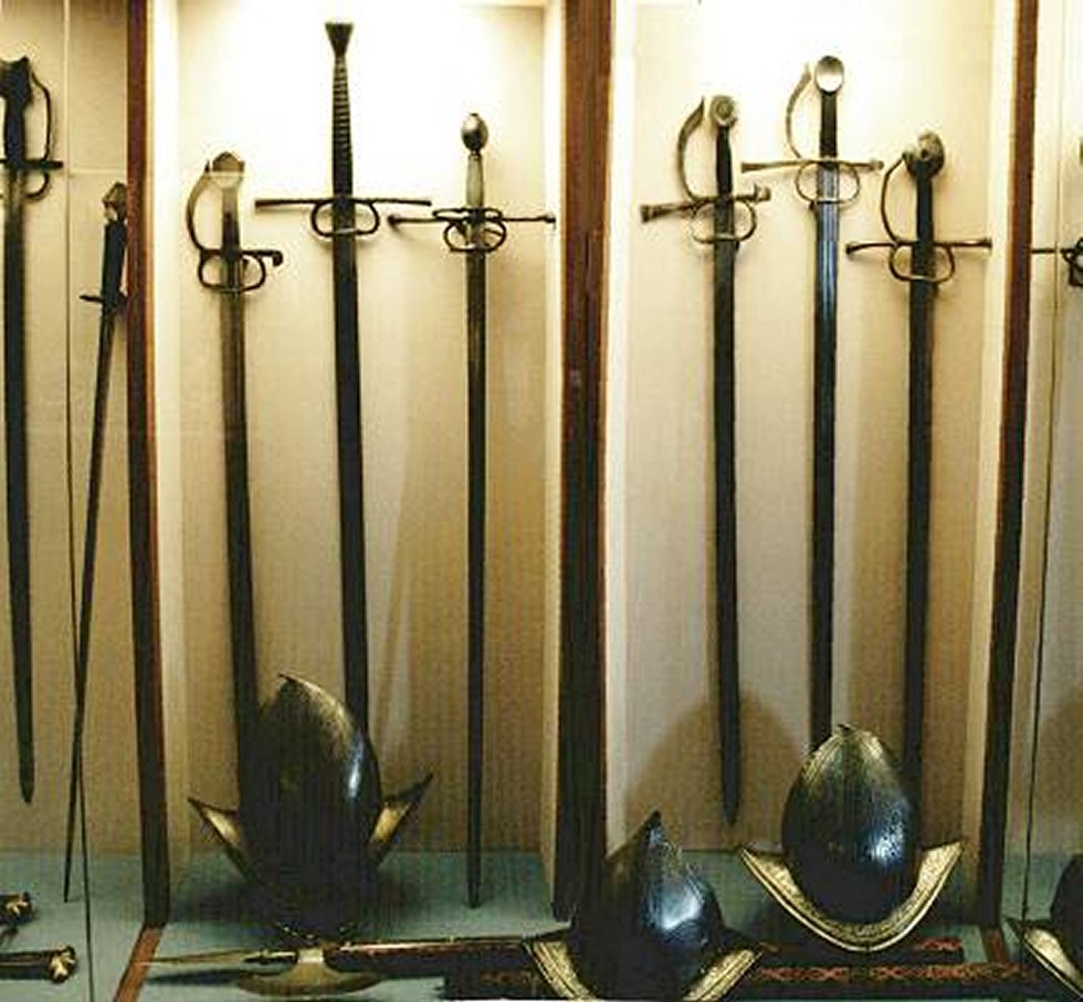

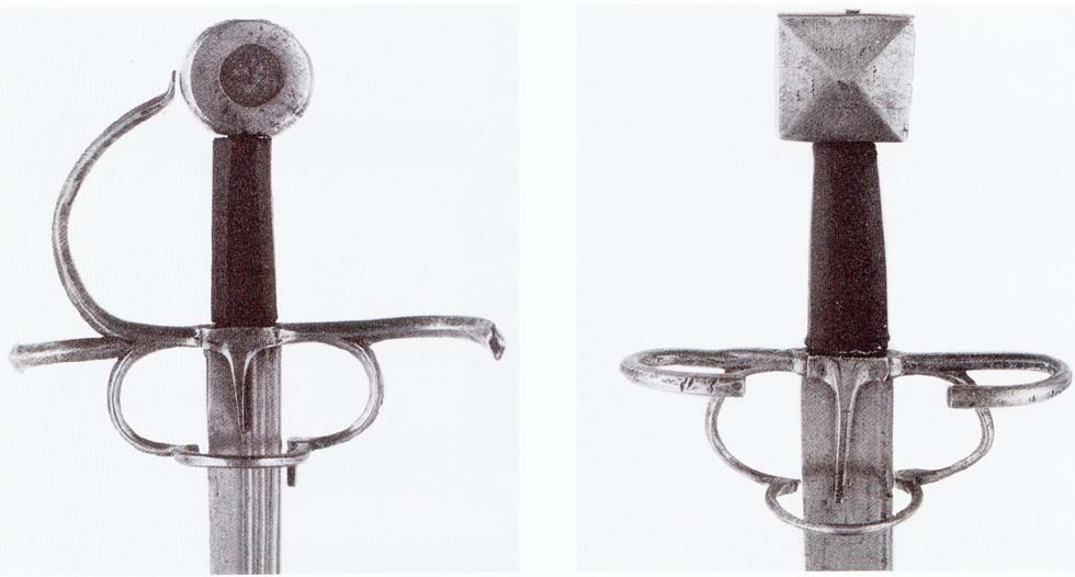

I had a few Dutch Houwers in my collection. see pic.
A houwdegen was used by foot soldiers who had limited figthing skills
therefor the houwers have very simple, blunt and wide broad blades (without fullers) and were mainly used for striking blows and with blunt points not for stabbing.
The hilt of the houwer is originally Italian design and were exported in large numbers to various countries including the Netherlands.The hilts had pommels of Norman type 46 (1600-1630) and did not have inner guards and/or thumb rings.
my Sword has a 16thC cut and thrusting blade a 16thC pommel type and a
16thC inner guard type.
The Specialists of HermannH dated it end of 16thC and Italian/steyerish .
Personally I think it is a bit earlier but due to the thumb ring around 1560-1570.
(The earliest thumb ring on a painting known is from 1577)

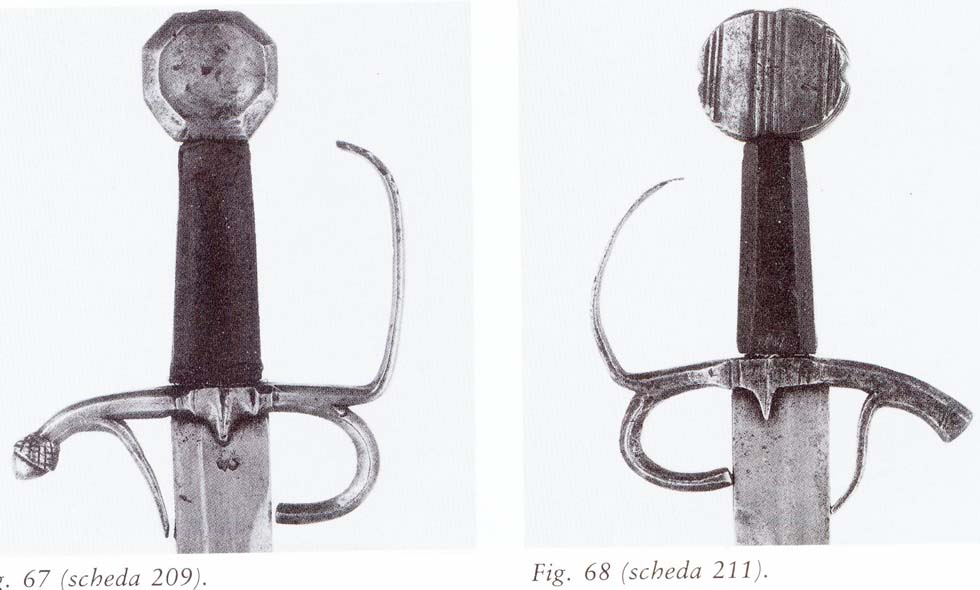

Pommelknob?!?
the type of big round pommelknob was in fashion in Italy mid 16thC.
CF pictures of wallace A537 and wallace A551 both dated 1550.
and of course as on the Pavia painting

An illustration by Flavius Vegetius Renatus from his famos work 'Vier Bücher der Ritterschaft' (four books on chivalry), published Erfurt, East Germany, in 1511.
The landsknecht bears a short sword with exactly this type of threefold pommel as on my saber, a halberd and a short arquebus, obviously without a lock mechanism.
His companion on the right is equipped with a short sword featuring a pommel of early bird's head shape and lightly curved quillons of earliest Katzbalger type.
Michael
