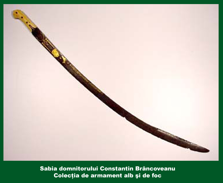

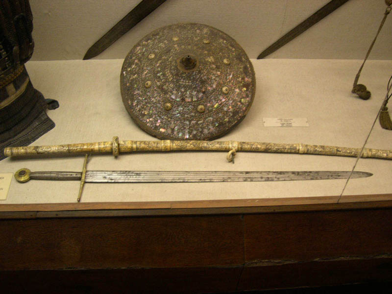

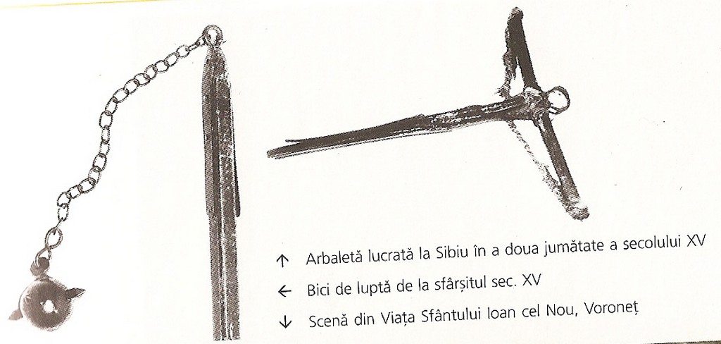

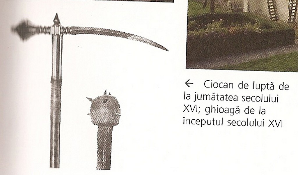

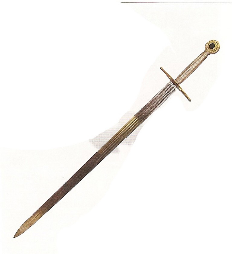

It would seem that it would be most likely that the swords of the Wallachian forces would likely have come from the weapons producers of Germany, and consisted of knightly weapons associated with heavy armored European style warfare. Also, the swords of Byzantine Bulgaria may have also been prevalent. However, the question seems to be, would Vlad III, Dracula, the son, have used a sabre?
While the Ottomans had taken the Bulgarian regions, it seems important to try to establish when the sabre became prominantly in use by the Ottomans, and would Vlad III have adopted its use. So far I have found that the form was 'recognizable' by the end of the 15th century, and that Hungarian sabres, whose form derived from Ottoman sabres were not actually seen until the 16th century.
I have not found any evidence of any sword attributed to Vlad III, although we have had visits to museums in Transylvania and others shared here it seems in past years.
I'd like to know what others think on this, and of anyone is aware of any sword in any museum attributed to, or if the type possibly used, by Vlad III.
