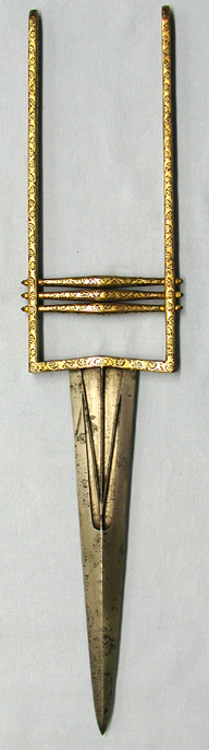

True what Brian writes, the katars were mail ‘openers’, and some of them were even specialised for doing the work. I doubt, that there was a mail shirt, which one of these specialised katars could not open. Unfortunately it has not been proven yet, as far as I know, as the museums and the collectors don’t want to deliver the test shirts – sadly, as it is in the interest of a scientific experiment.

as for the katar, i really dont know what to say. heavy spears had the same thickened point, as did some sword blades. there are enough illustrations and sculpture showing it as a lethal stabbing weapon. if not for armour piercing, then what is the point (no pun intended )

Concerning katars - sorry, don't think it's gonna work - if one has a mail, chanse he has a horse. If one has a horse, chanse he has a lance/sword. Would not be wise to try to use a katar.
Additionally I would refer to mail-ripping kindjals - they are usually on the big side (20 inches) with a stiletto-like extremely thin "spike" on top of them. Unfortunately Astvatsaturjan does not have a picture, somewhere I had the one of my own...
Hi Rivkin,
I'd suggest that, once you get someone off the horse, an armor-piercing knife is useful. After all, that's what the European misericorde was for.
On the other hand, I do agree with you: I don't know much about Indian martial arts, but I certainly wouldn't want to count on a katar as a main battle weapon. However, off the battlefield (i.e. in a dark alley, an ambush, a skirmish, or whatever), I suspect it was quite useful. After all, the thickened point doesn't prevent it from being used on unarmored foes as well as armored ones. I'd suggest we simply look at it as an Indian version of a cinqueda and go with it.
Otherwise, I'm quite enjoying the discussion of indian armor, so I'll fade back into the woodwork.
F
Old 30th July 2005, 07:08 PM   #27
Posts: 6,026
Small heavy bladed knives and katars would be very useful getting through heavy and padded cotton armour as Fearn says. By the mid to late 19th century some oriental metal armour had become quite light and only partially protecting the torso. These knives might well never have been expected to be in use against metal armour around the close of the 19th century. Tim
