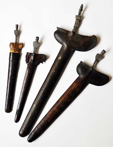

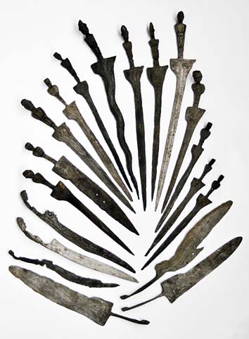

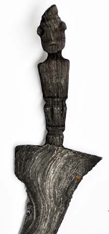

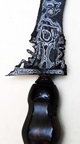

Dear All,
First of all, I apologize for disturbing you to deal with this "name game" again. These are some of my humble collection of what GB Gardner (1933) said as "keris majapahit". Although, the local name was probably "keris sajen" (keris for offering) or even colloquially named as "keris kepala besi" (or 'iron headed kerises' in Bahasa Indonesia).
My old question is, why did Gardner name such kerises as "keris majapahit"? Is there any relation with "keris from majapahit Kingdom"? Or maybe, "kerises usually used by people in Majapahit"?
I am waiting for your enlightment...

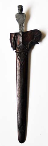

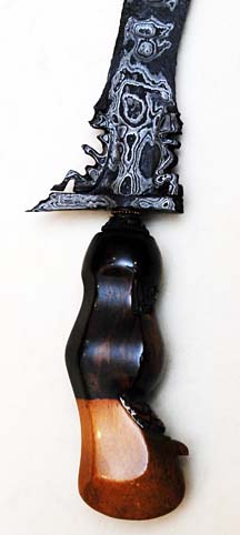

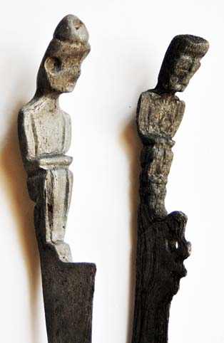

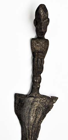

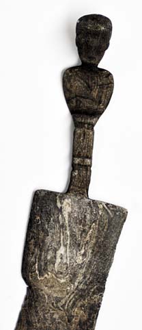

These are some more close ups...
Thx
GANJAWULUNG

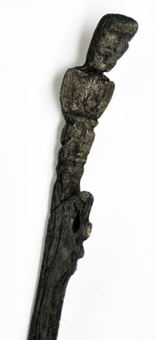

Default MORE close ups
Some more close ups...

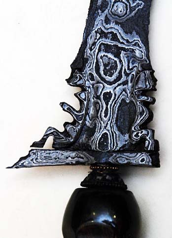

Default With Its Warangka

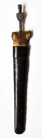

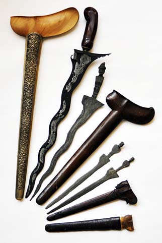

Thanks, David. And these are more pictures of the sajen kerises -- some of them are "pichit" (name in Malay version), with their warangkas....
GANJAWULUNG
Old 21st May 2009, 06:00 AM   #6
Posts: 7,228
I don't know the answer to this one Pak Ganja. I have a gut feeling that the name might be tied into the finding of the keris under a stupa at Borobudur.
I never heard this name used in Jawa in the late 1960's and the 1970"s.
Here's a link to some of my "iron ancestors" (intended reference to the upcoming publication.)
http://www.kerisattosanaji.com/kerissajen.html

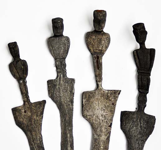

Default Size Comparison
Size comparison between Yogyakartan keris, medium size and smaller size of "keris sajen"...

Old 30th May 2009, 07:28 PM   #26
ganjawulung
ganjawulung's Avatar
Join Date: May 2007
Location: J a k a r t a
Posts: 991
Default PUTHUT kembar
These are more pictures on hilt part of "keris sajen" or as Hifi mentioned, "keris puthut" and some shots of a keris with dhapur "puthut kembar" or twin hindhu-priest with East Javanese hilt...
GANJAWULUNG
