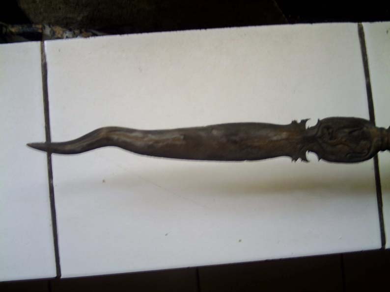

In this OLD OR JUNK section I need you guys again, specially those guys with superman eyes.
I found this foto from a person who want to sell his spear. (in webside).
But the foto is difficult to see.
Also if it is possible for information about this spear.
Guys, will you help a boy name Bre? Please?
I dont know how to describe this spear, Is it karna tinanding naga kikik or what? Thank you Guys.

As for your tombak, if you will read the forum rules (these rules were set by higher authority than myself ) you will see that discussion of blades currently for sale is forbidden. You must understand that there could be legal consequences with the seller if our opinions here were to talk someone out of making a purchase. Buy the piece and we will be happy to discuss it. The same if it is taken off the market. This is legal protection for the forum,

Excuse me, but I am going to step in here and suspend brekele for ten days for discussing an ongoing auction and or posting a picture of said item.
See you in ten days brekele; please read the forum rules carefully.
