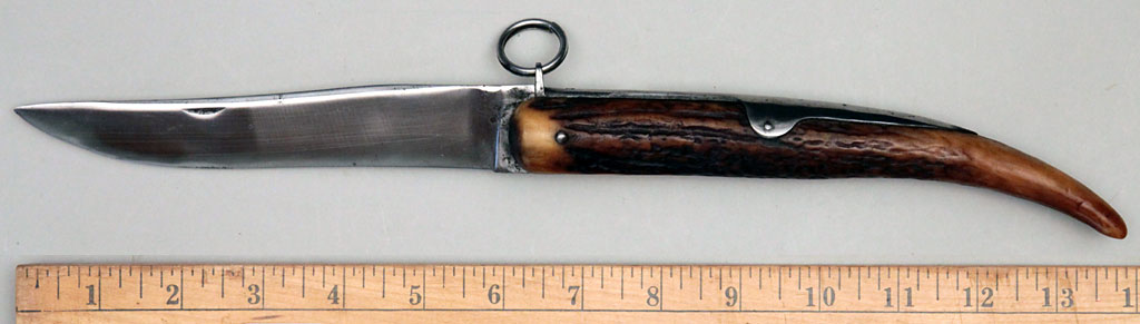

just for devilment, the okapi ring pull knife comes from so. africa where they were made under license from solingen, where they are no longer made. the CS 'kudu' is a modernised version of the okapi (both in my photo earlier) a solingen version is also there. someone once told me more people die in so. africa by okapi than any other non-firearm related cause. the ratcheting noise doesn't stop anything from happening...
the levers on the navajas used to lift the lock out of engagement are not that easy to use in the best of circumstances, under pressure of an engagement with another trying to do the same to you would be rather difficult, if not impossible. might be a bit easier on a ring pull, but still....

just for devilment, the okapi ring pull knife comes from so. africa where they were made under license from solingen, where they are no longer made. the CS 'kudu' is a modernised version of the okapi (both in my photo earlier) a solingen version is also there. someone once told me more people die in so. africa by okapi than any other non-firearm related cause. the ratcheting noise doesn't stop anything from happening....
I have a 6.5" bladed South African specimen in my collection and also two Cold Steels. The Okapi does not have a carraca like feature and the two Cold Steels, one a Kudu and the other an Elan. do have a ratchet, but not in the manner of the Spanish and Italian navajas, as their four and five`teeth' respectively are rounded so as to slow down the opening/closing but do not stop the blade at any one position nor do they emit a strong noise, hardly audible in fact.

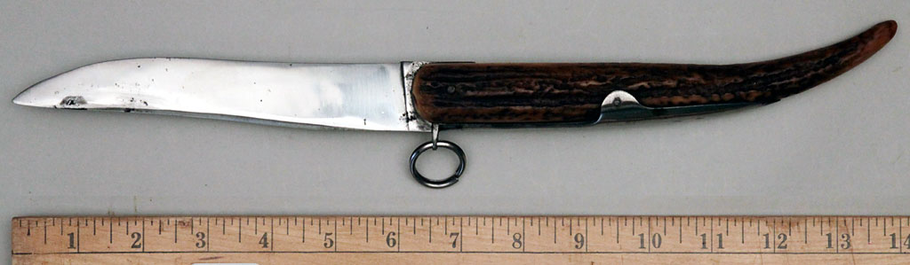

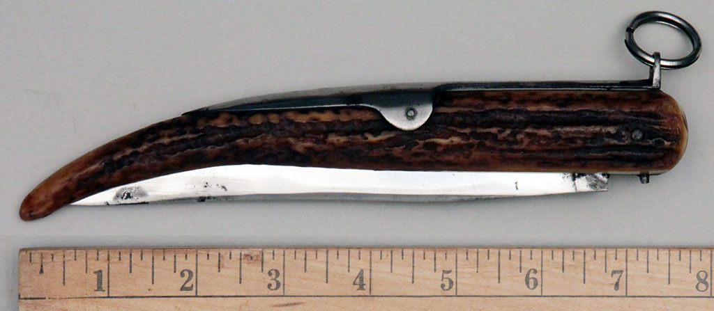

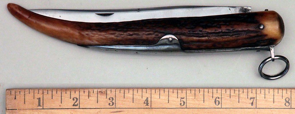

Thank you Chris for your attribution of my navaja. The blade is fairly thin (0.06 inch ~ 1.52 mm). The end of the blade first engages the spring at about half open (90 degrees).
Lew had an old 'pull-ring to unlock' clasp knife that he regarded as French, 19th Century. It has been burnished up, but traces of age remain in the crevices. This blade is thicker and the fulcrum more robust, but with just the one stop (it may be seen sticking out in the closed photos below).
Lew must have really liked this style of knife as he also had several variations of the Okapis (both German and South African made) as well as having Kudu knock-offs.

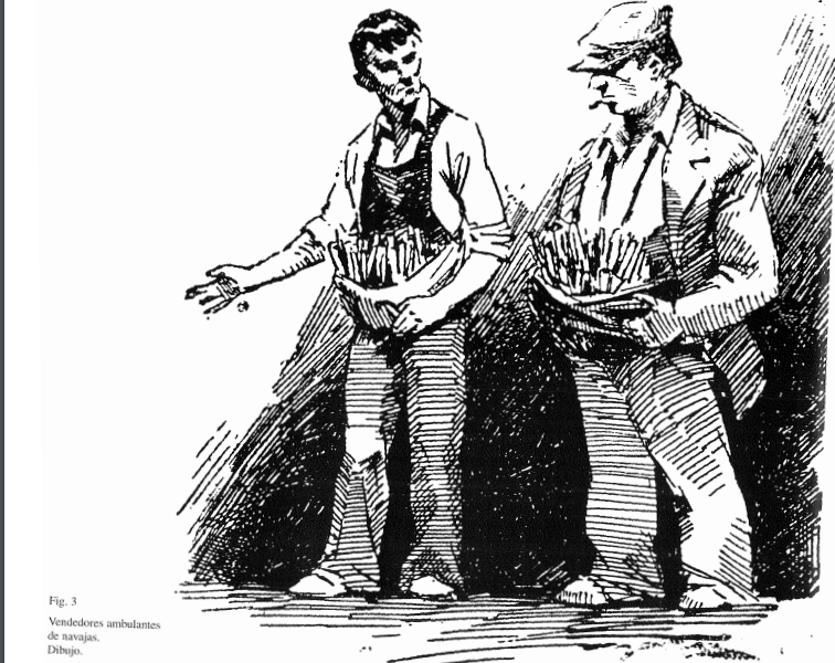

Old 4th July 2017, 05:29 PM   #53
Red face Vinced ... but not convinced
This is somehow raining in the wet but ...
Looks like Mr. Abel Domenech, with all his knowledge, doesn't have a doubteless explanation for the carraca either, as he starts by admiting that, the (real) reason for it is lost in time. That the noise of carracas may be prevented by lifting the backspring is evident; but the basic idea was to produce noise, or one would have bought a silent one, with a palanquilla only. And then i go again wondering whether the safety factor, sustained by some (several) opinions, could not be developed with techniques other than that of containing the said emphatic noise.
But definitely the carraca riddle is a geneal disease.

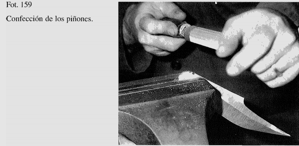

It is amazing how, in an comprehensice (328 pages) work called INTRODUCCION AL ESTUDIO DE LA CUCHILLERIA ARTISTICA DE ALBACETE, by José Sanchez Ferrer, we may see detailed pictures of navaja construction as well as detailed data on the birth of the navaja, complemented with carraca notes but, the reason for its existance versus the angle of safety ... zero words. However the preciousness in its making as well of its charismatic noise is well pointed out.
The author emphasizes that, having heard of carracas with up to fifteen pinions, the maximum he saw was one with twelve, kept in the National Antropology Museum. And according to what artisan Pepe Exposito told the author, a carraca is well made when the volume of the successive sounds that it emits when unfolding the blade go from minor to greater until the final one is noticed, this one having a different tone, the lodging of the blade in the spring.
We may see in the uploaded pictures that, at least one Albacete master makes the carrava teeth very sharp and inclined; possibly other techniques make round and softer.
Interesting also the author notes on the navaja date of birth, an issue often wondered and discussed.
Here is the ARTICLE and the written parts that i emphasize, so that my lousy translation may be corrected.

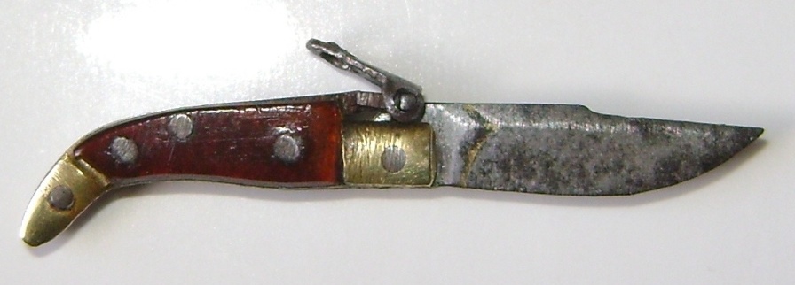

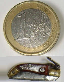

I regret having got rid of my few examples; the only one i have left is this palanquilla 'functional' example ... with 35 mm. (1 1/2") length open and weighing less than 1 gram. Note the care had by the "smith" to replicate all components with their indicated mterials ... and accept my appologies for this impertinent inclusion .
Old 7th July 2017, 12:58 PM   #60
Originally Posted by fernando
Y...palanquilla 'functional' example ... with 35 mm. (1 1/2") length open and weighing less than 1 gram. ...
nice little one. if you ever come to the UK, carrying that one would be illegal to carry without a good reason and could get you a few years in jail as, due to the locking mechanism it is considered an 'offensive weapon'. a man recently was arrested because he had one of similar size on his key chain 'without good reason' the judge was a bit lenient and only gave him a large fine, and a few months in jail.
as a real antique offensive weapon, it fits in here of course.
