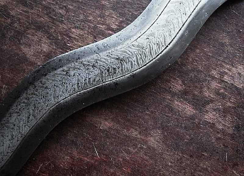

I'd like to read your impressions on these construction methods :

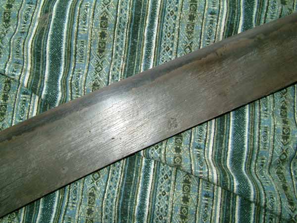

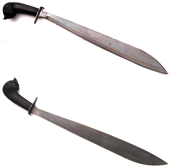

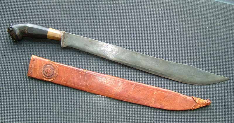

Here is a Visayan sword that I posted a while back in another thread. The edge hardening is obvious after an etch with ferric chloride. What's your take on the method used here?

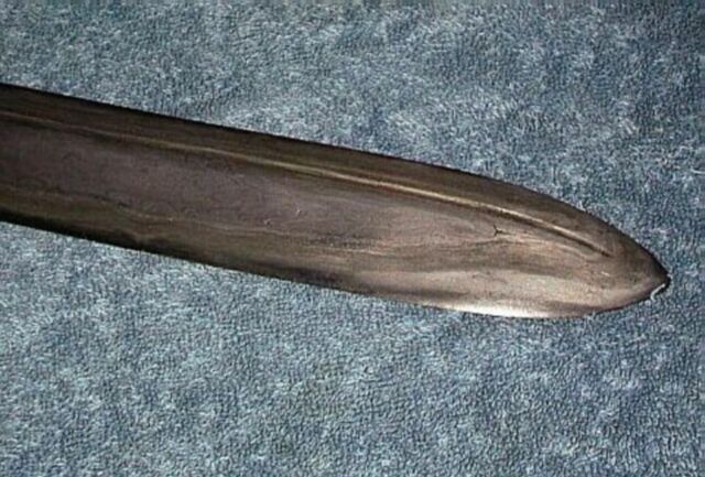

Photos are difficult to read compared to examining an object but I'll give a go. Rick, That kris sundang apears to be a sandwich type blade, which is usual. It is possible that it is panel-welded, but one does not often see that much wander to the core on panel welded swords, whereas it is fairly common to see in the side plates from forging out the tip on sandwich type blades (is it kind of helical, or does it go toward the same edge on both sides?). The cheeks of the blade seem to show some contrast internally/macro. The very central (widthwise speaking) area seems to perhaps have a more complex pattern of some kind, but is not clear in the photo? Is it humped, or hollowed? Does it show core or a sort of 5 layer constuction; I've seen kris sundang with 5 macro layers; didn't etch 'em, but it'd make sense if the outer one on the flats was a decorative one, and I don't think I've seen an old kris sundang (this is a kris sundang, yes?) with hollow ground flats, which might expose the core on a sandwich blade. Oop Yes I have, but only as a distinct groove; not the subtle hollowed flat. Looking some more. It looks like a more or less flattened hex cross section. Near the tip there's a small welding flaw within the pattern of the most outer macro layer (?), but I wouldn't worry too much about it.
The dog head sword looks to be displaying a temper line. It could be an inlaid edge, but seems to exhibit a jagged uneveness usually seen only from welds if they are for pattern, which is possible, but I don't think is what I'm seeing. Not at all sure though, and probably being influenced by my expectations. Close-up? The blade has some longwise lines that may be fold lines, but are more likely grindlines, and some cloudy shapes that are probably sheen/patination/etc?
The close close up I can't see much in; I think I see an inlaid edge; I see some kind of layering, and only right at the edge. I'm not sure what to make of the dark area on the blunt (?) side of the tip.
Ian, I see a temper line on the one you show. Note it is the same breadth on both sides; a macro weld on this type of blade is expected to be scarfed, so it is wide on the flat side, and narrow like this on the cutting bevel. I don't see any sign of folding, but it looks like an old sword to me, and it probably is folded steel with the other main likelihood being imported foreign industrial steel, but as I say, I suspect that was often folded as well, by PI smiths. Notice the temper line stops well short of the base of the blade.

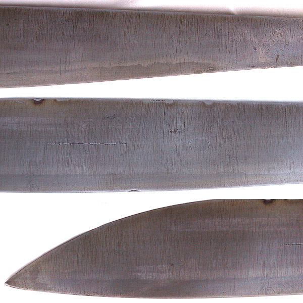

I added some further pictures which do seem to show a laminated blade, as you suggested, and more detail of the hardened edge from each side. Does the prominent white line demarcating the hardened edge reflect a transition zone as a result of the tempering process?

Hi Tom the central core ( I believe it goes all the way through) on the kris sundang is a very heavy jellyroll twist ; that area is also a wide shallow fuller , there is also a narrow deeper fuller on one edge .
The Bonifacio (if I may) seems to me to be cheeks of different steel laminated on a possibly iron core ; that blade has had a thorough etch ; only problem is if it is tripartate construction the lines of demarcation are not readily apparant on the spine .
The last picture is of the Baiwan sword tip ; I believe this may well be the same construction method as the bolo .

And below it what I believe to be an inlaid panel over the core of a very old kris , akin to pamor .

Yes, akin to pamor is a pretty good description of the usual kris sundang construction. What makes you think the one is panel-welded? I take it the core tracks the same way on both sides? An inlaid edge on a single edged blade that runs all thne way thru to the spine would be odd; more usually it is pinched into the edge of the blade.

Now I'm getting confused Tom, which kris are you speaking of here ?
The first kris sundang picture I posted I'm pretty sure that the core is spiral jellyroll pattern if you will all the way through and the laminated edge was forge welded on .
The second older kris with the leaf like central pattern I believe to be applied to both sides of the sword in a fairly thin layer over the blade as you can see it fade out toward the point unlike the other sundang blade .

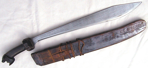

Default Laminated Visayan Blade + Hardened Edge

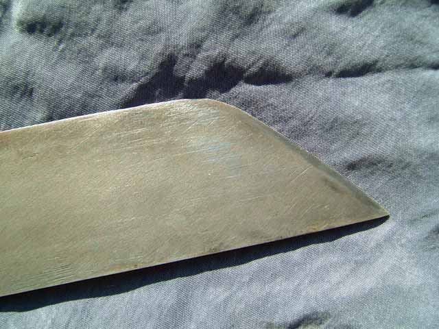

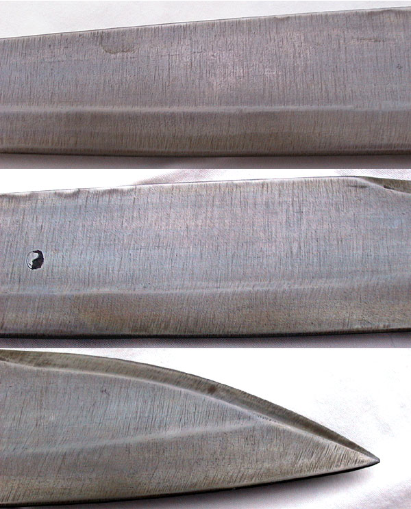

Dragged out this old one and etched it this afternoon to find evidence of lamination of the blade and a hardened edge similar to the binangon I showed above.
We know this one is old because it has an older style Visayan scabbard, a wooden disk guard that is asymmetrical, and the blade just looks "old." The beveled edge has been ground many times and shows clear lamination.

I thank you, spunjer, for the pictures of a very nice looking old sword
Rick, rather than try to further diagnose from a distance why don't you send me your swords? Just joking Rather than try to further diagnose from a distance, I'll tell you a thing to look for. Look at the spine of the blade on the dog head sword, within the clip, at the very tip. If the surface is clean and etched well, and the hard steel goes all the way to the tip, you should either see the edge bit pinched in, or the hard part will end in a line that runs across the spine, perpendicular to the length of the sword (usually slanty, but only very slightly; nothing one would mistake for a scarf weld).
Even in person, there is often no real visual cue to decide between a weld and a hardening line; logic concerning the shape of the line and its relation to any welded grain there may be are largely our tools. There is often a different look to a weld than a hardening line, but one cannot always rely on that in my experiece.

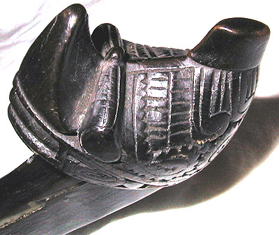

ian,

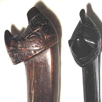

is that a bathead? better yet, and if you don't mind, can you post a "mugshot" of that baby?
Old 1st May 2005, 09:20 PM   #49
Posts: 4,749
Ron:
It's just a common variety of Panay demon/deity figure. Pictures are attached below.
Ian.

Old 2nd May 2005, 02:10 AM   #50
Spunjer
Spunjer's Avatar
Posts: 1,730
thanks ian. i don't think it's a common type, is it? it seems like it's one of those diety hilt that belongs in "Others" category. it's not your typical round head, rhino horn diety like this dude right here ===>
Old 2nd May 2005, 04:43 AM   #51
Posts: 4,749
Spunjer:
You're right to ask how common this particular form of deity hilt might be. I really don't know if this style is common. What I meant to say was that it is a deity hilt of the Panay/Negros form, which is a common finding on these older Visayan tenegre.
Ian.

Posts: 1,254
I think it's a version of a zoomorphic/deity pommel that is common (the nose horn guy; seen some dispute as to who he is...); this particular form of the stylization is not common to my experience, but the subject is not particularly unusual. There are at least 3 standardized stylizations that, at least to me, all seem to be this same guy.
