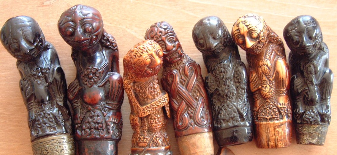

Here some of my hilts of this/these type(s):
Many thanks for your help with this question.
Photo's more than welcome....

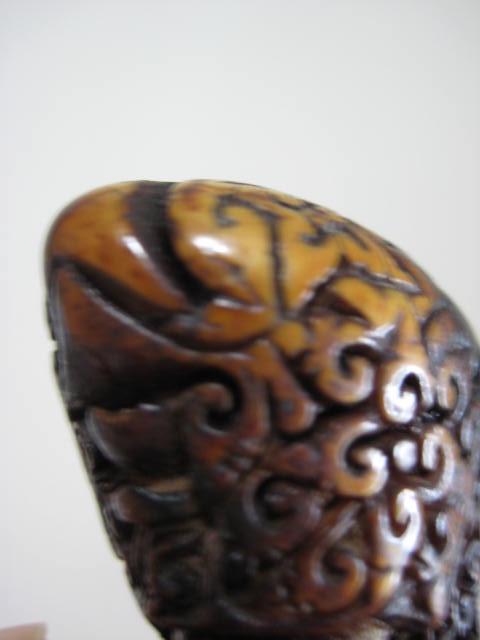

Dear Alan,

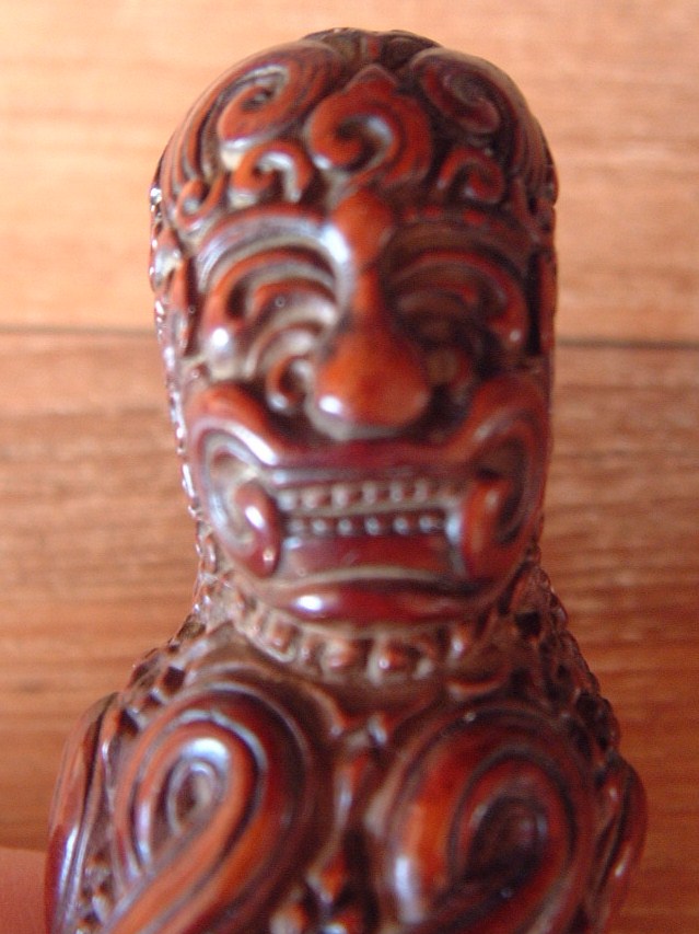

Does this qualify as a raksasa?
jonng is offline   Reply With Quote

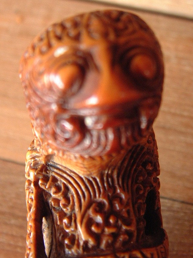

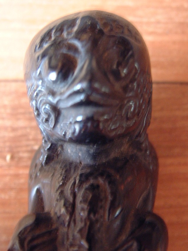

Default Fangs?
Alan,
First thanks again for your extended explanation!
Stil learning a lot on this forum, which is great.
Here an overview of some figural javanese hilts.
They all have a sort of curl next to the mouth.
These curls are stylized quite differently some even more or less floral.
Some close to a "moustache" as you mentioned.
Would these qualify as fangs?
Regards, Erik
Old 13th May 2009, 11:25 AM   #10
Posts: 7,229
Based upon what I can see in these images, it believe it is probable that all of those curls at the corner of the mouths of the figures pictured, are representative of fangs. The qualifications I have included here are intentional, as it is always possible that I could form a different opinion if I had these hilts in my hand.
