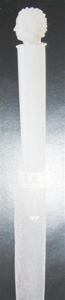

Its OK to present pictures from catalogues as long as properly cited, and it would be great to see the pictures as made for export seems exactly the right heading for this interesting dagger.

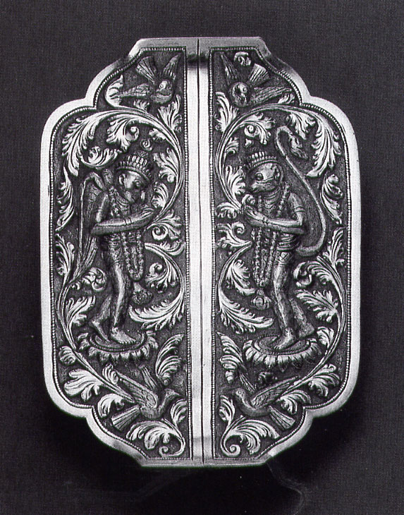

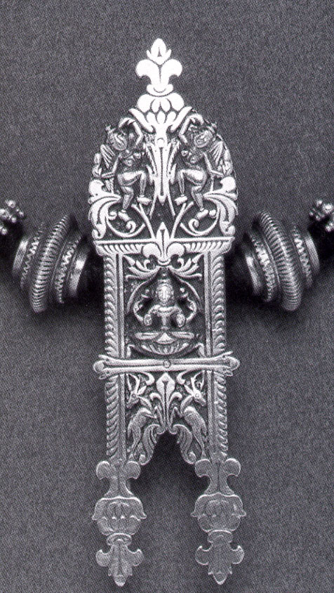

I vote for South India too; to be more specific, for Tamil Nadu.
I base my attribution on the handle decoration; the blade may be European. Alas, Spiral’s pictures are gone, but if I remember the details correctly, the handle ornaments are very similar to the traditional jewelry pieces of Tamil Nadu, as well as the Swami jewelry from Madras.

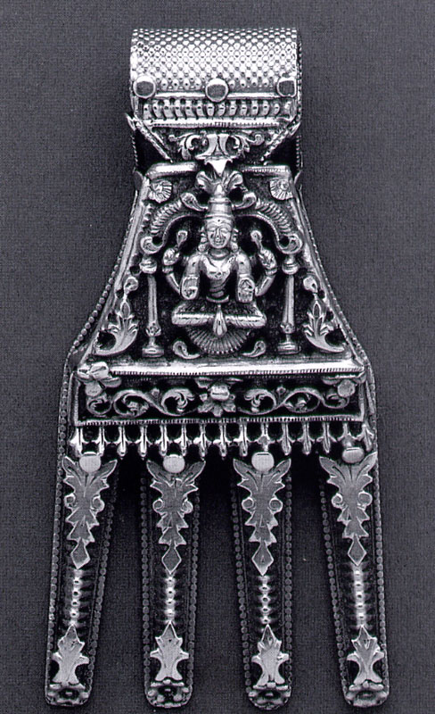

First, look at the gold Hindu marriage necklaces worn by Chettiar women in Tamil Nadu as the sign of marriage; it is removed upon being widowed. On the central ornament pendant the goddess Lakshmi is depicted, sometimes surrounded by the birds, apsaras, lions, yalis, etc. They look pretty similar to the top part of the dagger in question.
Old 27th April 2009, 01:03 PM   #20
Tatyana Dianova
Posts: 785
Now to the Swami jewelry. It is an Anglo-Indian hybrid style of jewelry that flourished from the middle of the 19 c. into the early 20 c. It was created mainly by P. Orr and Sons of Madras, Tamil Nadu. The local term “swami” means “god or goddess” and refers to the ornamentation of these pieces with images of the deities of Hindu pantheon. All of them were created in silver (sometimes gilt) or gold in the same technique as the dagger’s handle, i.e. cast and chased. Orr also manufactured dessert services, trays, spoons, presentation objects, etc with Indian motifs. All were essentially oriented towards Westerners. Below are some examples (alas, no Lakshmi among them…)
To me this dagger looks like a custom order made to Orr’s manufacture, but it is only a theory, of course…

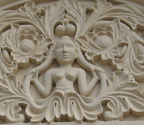

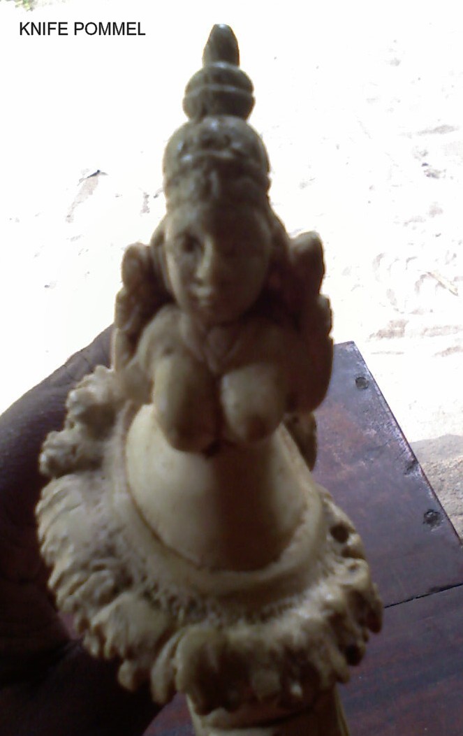

The hilt is extremely interesting. A closer examination makes it clear why the Ceylonese appellation was given. The hilt design shows an interlocking knot consisting of four figures between two forward facing female figures.

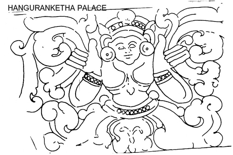

I have attached two sketches of the female figures from the hilt under discussion to make it easy to discuss. Please note ....very rough sketches.
However, see the attached images from the Hanguranaketha Palace or what remains of it from the book 'Diyathilaka Nuwara' written in Sinhalese. The palace was destroyed thrice and the last time in the early 19th century.
The next three are from the large pommel of a knife made of bone? with a backward facing female figure.
Both females in the sketches from the knife under discussion are in frontal view, bare breasted, arms pronated, with elaborate head-dress and are similar to the Hanguranketha examples and the knife pommel illustrated.
In between the female figures of the knife under question is a knot formed out of four figures. This is a regular feature in Ceylonese art. More common with female figures but also with male figures this knot involves multiple interlocking figures. Again I have attached a knot of seven human fgures this time in a circular motif from the book 'Sinhala Desika Wishwakoshaya'.
Surrounding these figures are the floral or wave forms that we are familiar with in the so called piha-kaetta hilt.
Hence, though unusual, the hilt shows Ceylonese origin with of course European influnce in the Cherub. Whether it can be called Piha-Kaetta ... the term is so confused that I shall not attempt to answer that one.
Hope this information is useful and of interest.

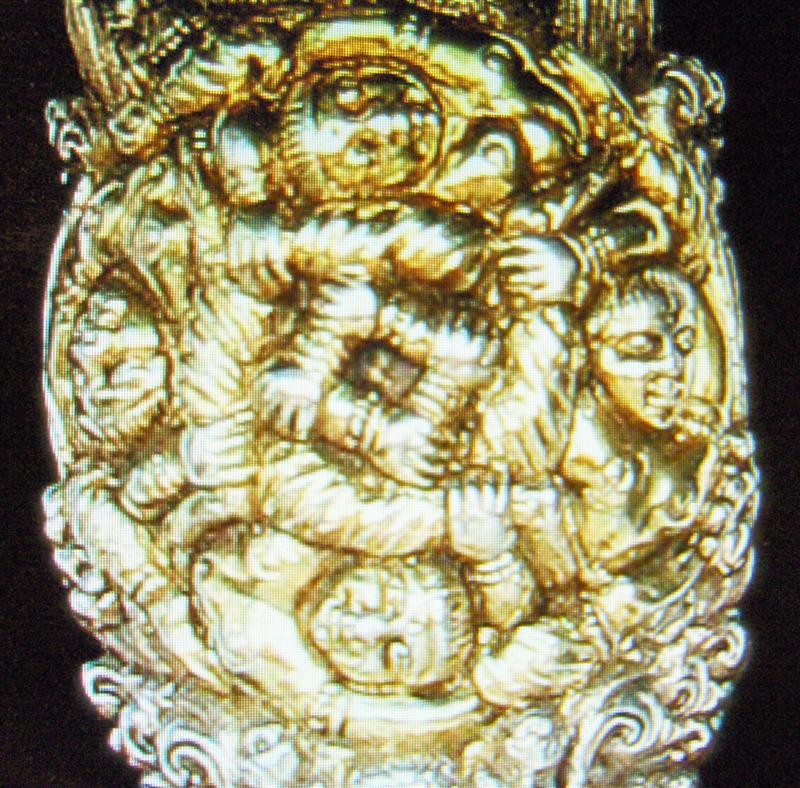

"In between the female figures of the knife under question is a knot formed out of four figures. This is a regular feature in Ceylonese art. More common with female figures but also with male figures this knot involves multiple interlocking figures. Again I have attached a knot of seven human fgures this time in a circular motif from the book 'Sinhala Desika Wishwakoshaya'. "
Are you saying that this circular motif is:
A) A Ceylonese motif only
B) A Hindu motif only used in Ceylon
C) A Ceylonese motif used by Hindus only in Ceylon
D) Something else......
Have attached photo of circular motif....
rand is offline   Reply With Quote

Reference to your question I can say that the interlocking figures are a prevalent featue in Ceylonese temple paintings and in combination with the other features strongly suggest Ceylonese origin for the hilt.

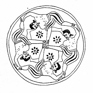

What follows is an extract from the paper SOME MEDIEVAL REPRESENTATIONS OF SINHALA WRESTLERS AND GLADIATORS (1937) by P E P Deraniyagala.
"Wrestling scenes are depicted either in a circle, as a square, or with the figures standing. Sinhala artists frequently employ ingenious combinations of the female figure to depict the chariot wheel, chariot, vase, palanquin, arch, swastika, flowring creeper, elephant and horse, but no such use of the combatant male figure has been recorded."
As you can see Deraniyagala uses the term "Sinhala artists" thus excluding Hindu art. As for me, my opinion is consistant with Deraniyagala's. This feature is predominantly a Sinhala motiff and I would certainly be interested in different opinions. Please remember that there was much cross fertilization in the region. The traditional names for these knots are based on the number of figures and their gender. Never have I seen these with males and females in combination in a single design.
I have added an image with four wrestlers (male) from the temple of the tooth in Kandy taken from the above paper.
The other image from the well preserved molding above the window of the Hanguranketha Temple shows a female figure with arms pronated holding creepers or floral designs similar to the knife hilt under discussion. Following Deraniyagala's suggestions, the interlocking figures in the knife under discussion could be a cart wheel with the outer circle suggesting the outer rim of the wheel and the inner hollow square suggesting the aperture intended to receive the axle head.
Regards.

Anandala,
Great input.....
The quote from Deraniyagala's book is compeling evidence that this dagger is from Ceylon (Sri Lanka). \
You say the circular motif is found in Sinhalese temple painting but do not mention which religion the temple is. Is it a Hindu temple? A Buddist temple? Or is this seen in multiple religons in Sri Lanka? My guess would be its a Hindu temple because of the other figures on the daggers handle.
We seem to have come full circle on this dagger, just like the motif!!!
rand
