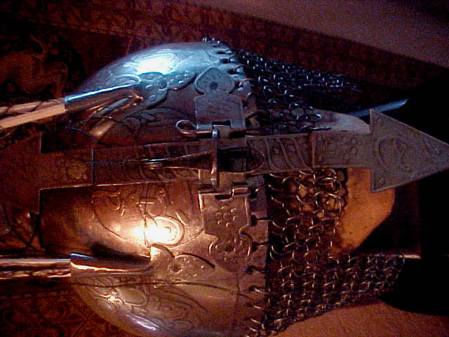

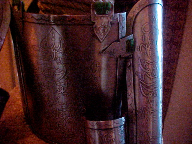

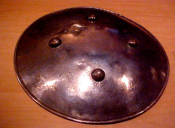

Here's a few photos of some of my contemporary pieces for comparison.
I'll be curious to see what some of our more knowldegable members have to see as well.....if you're too paranoid, I'm in your club as well (and thrifty too! **grin**)

One thing you learn a lot from, but may not want to do if you're only into antiques is actually owning repros bought as repros for reasonable prices, because then you see what's around, and what the differences really are. But of course you only want to do that if you can afford it, and if like Conogre, you are going to enjoy the repros......
AFAIK, screws, though often raised as an objection, are common on European arms and armour starting in the 1600s, and possibly so early in India, as well; surely in the 1700s. Of course, such screws are hand made, and are only traditional in certain applications, usually (certainly to adjust the nasal bar of a helmet, for instance), so seeing modern screws or screws in wrong places can certainly be a tip off to repairs or modern manufacture. It's all so dang complicated; that's why we sometimes find ourselves only able to say "I know it when I see it"..............those auctions took too long to load for my impatient self; I didn't see it

As for Mike's pieces they seem to be of a much higher quality level, I find the picture contrast to be a little too high to properly view them for evaluation though ; Mike try the Gamma correction feature in your image program .

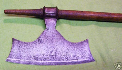

I think the best policy is if in doubt dont bid,there are some nice items going though if you are prapared to look hard enough i won this indian axe today look at the cool pattern welding on the blade and cheeper than the "suspect"shield and helmet,i know what i would rather own ...although i do suspect the axe has had a new shaft at some stage the blade apears to be a gem.......well as far as the picture says i havent got it yet obviously

A friend was over drooling over that axe while the auction was going on ...appreciation for damascus steel over the past couple of years has increased to the point that it nearly become an obsession, but even a non-afficionado would have to be impressed by this pattern.
I also doubt that the idea of it not being authentic ever arose .
VERY nice grab and congratulations.

Thanks conogre TBH im surprised it didnt go for a higher price....imlooking forward to getting my hands on it
