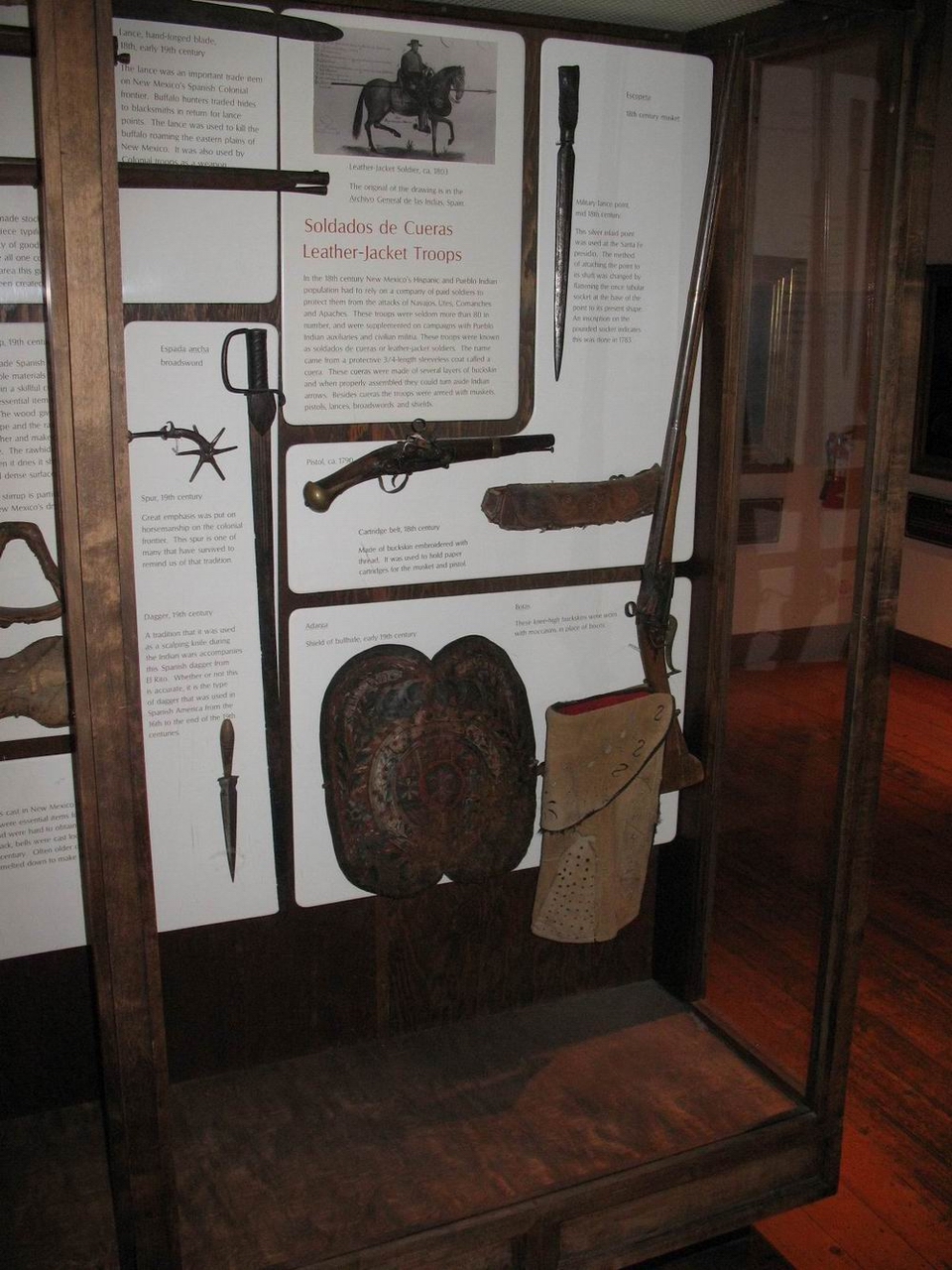

lances where used in new mexico as a mans primary weapon in new mexico right up through the early-mid 1800s as the settlers had relatively few firearms until the mid 1800s. i was wondering if anyone had seen examples of these weapons? in charles kenner's "the comanchero frontier" he writes about the new mexicans making tomahawks and lances "of unrivaled grace" and trading them to the comanches and other southern plains indians..

I hope someone out there might have some examples of Spanish colonial lances or lanceheads to post. I have as noted, seen them over the years in museums and collections and most seemed quite simple. I have not seen the tomahawks mentioned though, and would like to see more on these.

Here is a picture from the Palace of Governors in Santa Fe. There is a lance in the top right corner. Unfortunately taking pictures is prohibited and thus the quality of the picture is somewhat poor, and there is no close-up.
This is too bad, because the lance is really pretty - it features a silver inlay with floral design. I am not sure if it was locally made or imported from Spain. The socket is flattened to make it into a tang.
There are some other nice items in this display, including an espada ancha (with active rust in the fullers ) and a buffalo hide shield, called "adarga".
Teodor
Excellent photo Teodor! Thank you for posting this, I felt deja vu as I looked at it....I was there in October but didnt get any pictures. Great example of the espada ancha, which I hope we'll be able to discuss here sometime soon.
