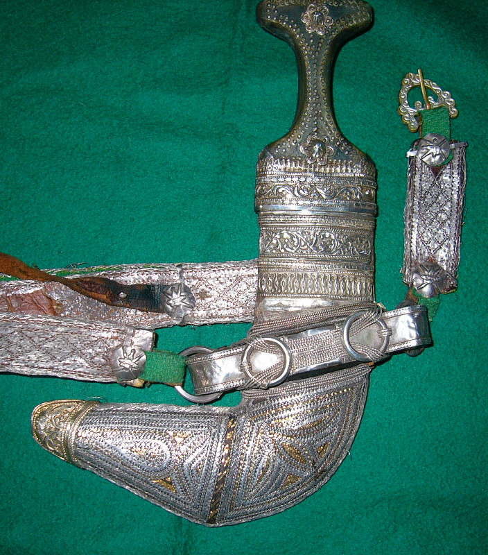

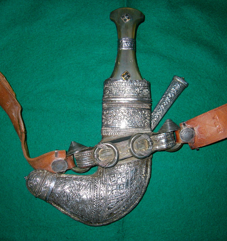

Two more Omani Khanjar for comment and comparison with the others.

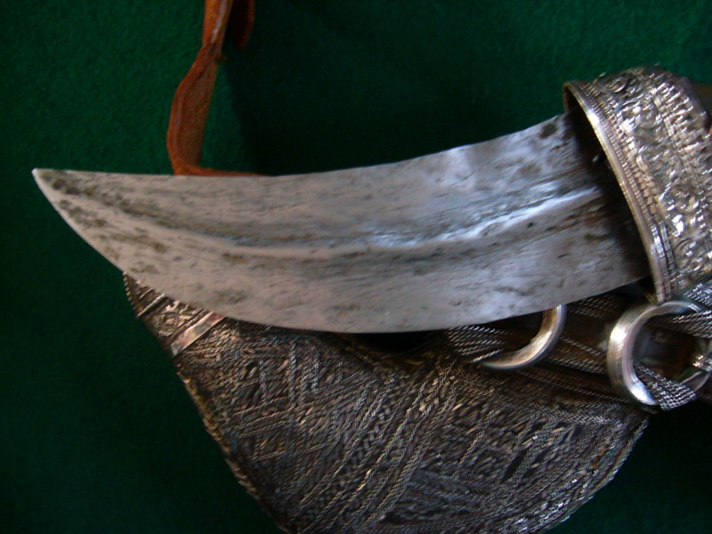

The first one was "liberated" at the time of the Yemeni uprising in the late 60s/early 70s by a mercenary in the Sultans Armed Forces. The blade appears to be "tribal" forged and is very rough but extremely sharp. This particular Khanjar has its Shafra back knife. Age probably around 1940s/50s.

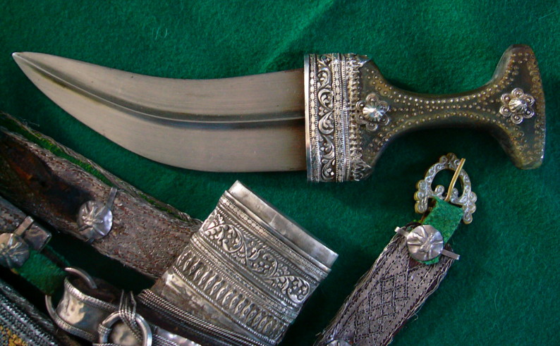

The second one which has gold and silver thread on the scabbard also bears the Sultans Crest on the belt "buttons", is probably around 1960s. It also has the more usual type blade.

Very nice, I do like the khanjar, primarily because it is a work of art, the silverwork and the skill involved to produce that silver work. I recognise that skill as I am a metalsmith and the skills do not come easily that I know.
One thing I had been wondering for years is, is there any truth in the heard fact that a lot of Omani silver is from Prussian thalers obtained from a bullion ship that was wrecked on the coast of Oman at some point in the past ?
Also, any idea how to forge a centre ridged blade, is it by means of a shaped swage or is there another method ?
I ask as years ago I needed centre ridged javelin points and I wondered how they could be made without simply welding a bead and grinding to shape.
Interesting though, your top picture, the patterns in the metalwork are not dissimilar from mine, in fact there are a few similarities and was wondering, could these weapons be located to a certain area or singular craftsman by the patterns they employ ?
