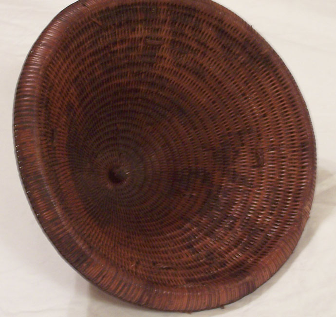

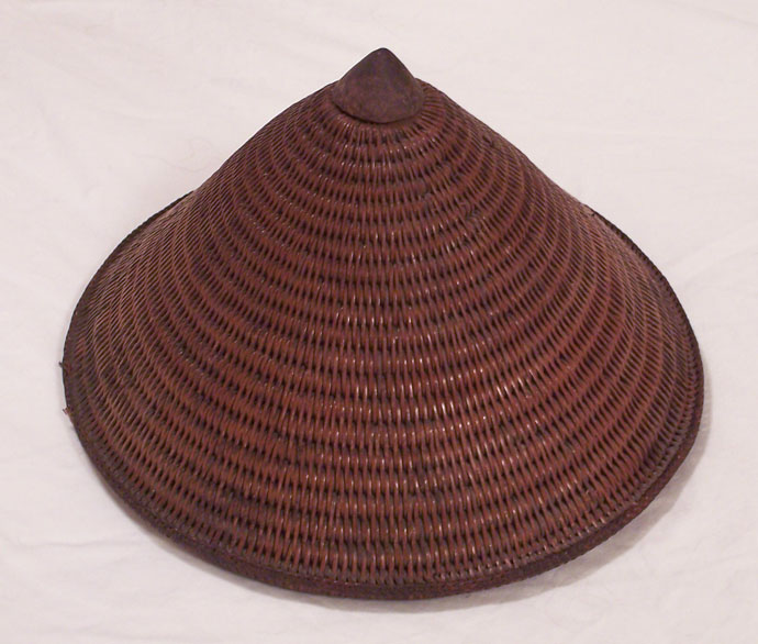

I'm attaching pics of a rattan helmet I picked up a few months ago that I suspect is Vietnamese, but I wanted to get some other opinions. I have a few reasons for suspecting its Vietnamese origin, but without going into long and laborious detail, I'm simply going to attach an illustration of a South Vietnamese soldier, circa 1850. Note that both helmets have a spiral construction, similar to Chinese and Vietnamese rattan shields. As far as I know, there is no Chinese equivalent to this helmet construction, but I'd like to know if anyone else here is aware of any other cultures that constructed helmets in a similar way. I would think Indonesia could be a candidate, but I'm largely unfamiliar with their armor. In short, I want someone to come up with a plausible candidate other than Vietnam.

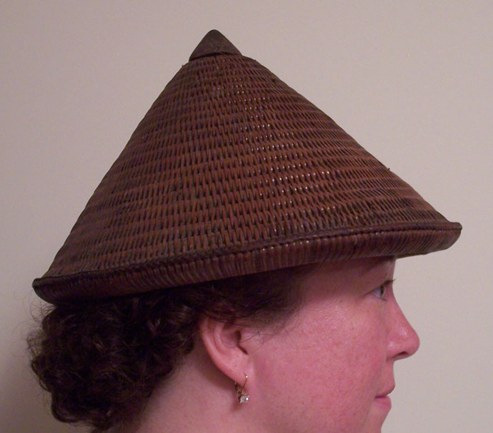

The helmet is slightly oval, being 11.25 inches at its longest and a hair under 11 inches at its shortest. Height is about 6.25 inches. The model in the photo is my lovely wife. She enjoys supporting me in my hobby and can't seem to resist putting this thing on her head.

Neat headpiece, Nick. One thing I'm interested in is how thick the main strand of rattan is. If it's a functional helmet, then the rattan needs to be thick enough to absorb a blow. Otherwise, it could be primarily a fashionable hat, as your wife so ably demonstrates.

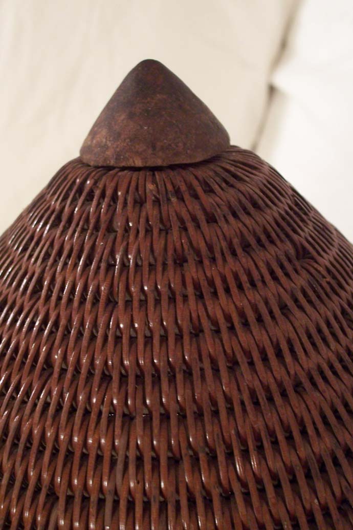

The hat/helmet is very sturdy. At it's base, it is nearly .75 inches thick. I suspect the main spiral of rattan is actually a double layer, but it is weaved so tightly that there's no way to prove this without deconstructing the thing. It probably is tough enough to absorb a sword blow, but more to the point, it's definitely tough enough to DEFLECT a sword blow. The particularly steep incline seems well-suited to deflecting an overhead strike...even the very top is peaked by a cone-shaped piece of wood. I think the construction, coupled by the soldier illustration, makes a good argument that this is a helmet rather than a hat. You are correct, however, that my wife makes it look so stylish that it is easily mistaken for a fashion statement.

Yes, I'm fascinated by that illustration myself. I particularly enjoy the European features of the model. I suspect that somebody brought the uniform back to Europe, had a local gentleman model it, and then somebody drew the illustration from that. I also doubt that the feathers are authentic. The wooden point on mine is removeable with a little prying. I suspect the illustrator inserted some plummage to spiffy up the uniform.
