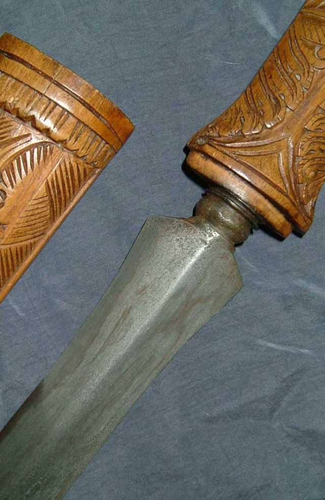

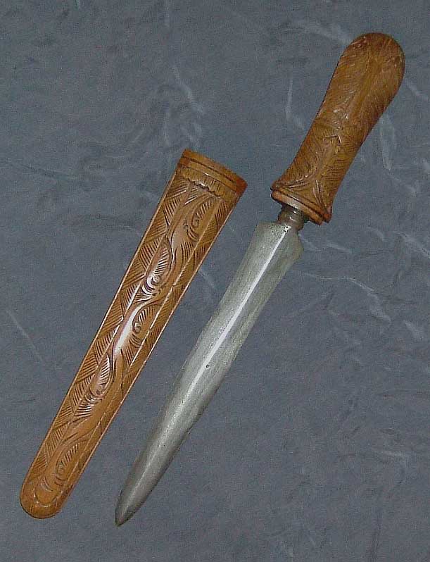

A mounted one with a very similar shape .

The one Rick is showing us is mounted as a dagger. The mounting is probably maduran. Yours was mounted as a spear. Considering the patina of the scabbard it is certainly not younger than late 19th century. There are carved examples of these scabbards known but this scabbard is the most usual one. At the top and at the bottom it had a cord with a knot like you see on european military sabres. The blade could be older because the mountings where often replaced. The wooden parts where rotting away in your hands as they use to say. You can see at the edges and the blade itself that this washing with warangan was frequently done. The surface of Rick's tombak is smoother. Rick's one is younger but is also dated.
Nice tomback too, Rick!!

Both tombaks have similar features, but closer look at the "metok" or ferrule shows that the one wolviex has is seperated whereas Rick's has it made one with the blade, or "seiras".
More commonly seen from Sumatra or Malaysian regions are the seiras tombaks, while the other type are more Javanese inclined, although there are exceptions. The not very contrasting pamor on Rick's tombak also has less Javanese features, and I'm sure with a good washing, wolviex's tombak will show good contrast.
Do retain the sheath please, and give it some good old English oils or other wood oils to "relive" it back again, and maybe a longer shaft for the handle. On that note, I would consider both pieces more as a "lembing", a throwing spear, rather than a "tombak" (lance) from it's more slimmmer and rather "aerodynamic" features. But again, there are a few views on the diffrences between a tombak and a lembing, as it is with a lance and a spear.

Old 7th December 2004, 04:12 PM   #11
Posts: 6,429
Question Adni
Adni , I was suprised at how smooth the surface of my piece is .
Can you make any comment on that ?

It mutually good to be here too Rick.
The smoothness on the surface of your tombak may be seen as a common Balinese styled finnish, but I don't think the tombak is of Balinese in origin. Without handling the piece it's hard to tell, but the metals used looks more "compact" and "stronger" if I may say. Arranged in the "miring" technique with the pamor "adeg", stronger metals, and of course made with an experienced empu, the fusion of the layers are more "tighter" and "compact" which when finally finished traditionally with limestone, can result in a more smoother surface. Not usually done in Malaysian blades, but not uncommon on Sumatran pieces.
Also note of the temper mark from the darker shades on the top half of the blade (especially the edges) where it is submerge during temper quenching. Another feature pointing it more towards a Sumatran origin.
The presence of a wax coating for preservation may also make the surface smooth, but removing the wax layer will expose the courser surfaces.
