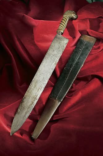

One of the darkest pieces in my collection is this German state glaive (Kuse), originally made in 1663 for an officer of the bodyguard of Archduke Sigismund Franz of Austria (1630–1665).
Originally an ornate ceremonial weapon bearing the Archduke’s coat of arms, the Golden Fleece, the Burgundian Cross, and the monogram “SFE,” it was later stripped of its decoration and repurposed as an executioner’s weapon in the city of Algiers. Today, only the date 1663 and the initial “S” remain visible.
According to the French inscription preserved on the surviving scabbard, the weapon was discovered by Captain Müller in the Kasbah following the French capture of Algiers in 1830. The inscription states that the glaive, dated 1663, had been used specifically for the beheading of condemned Christians under the rule of the Deys of Algiers.
The glaive’s provenance is equally compelling. It formed part of the renowned Dr. Ben Hamon (Hamou) Collection in Paris before appearing as Lot 3373 in Hermann Historica’s 68th auction in 2014. The weapon has also been researched and published by Oliver Hoare, whose work helped bring its remarkable history to a wider audience.
The transformation of an Austrian court weapon into an executioner’s glaive in Ottoman Algiers reflects an extraordinary journey across two centuries, multiple empires, and radically different purposes. Few surviving weapons possess such an extensively documented and fascinating history.

This is a most intriguing artifact - thank you for sharing it. I imagine a very significant proportion of the older arms in our collections would, if we could ever know, also have very interesting stories associated with them.
I increasingly fear that the last sentence of the cataloger's description is a correct assessment of humankind's progress.

Thank you, Lee. I appreciate your kind words. One of the things that drew me to this piece was precisely that remarkable journey through history. It began life as an Austrian court weapon, was later repurposed in Ottoman Algiers, and was ultimately recovered after the French capture of the city in 1830. It’s extraordinary how a single object can preserve such a layered historical narrative.
I agree, many older arms undoubtedly have equally compelling stories, but in most cases those stories have simply been lost to time. I feel fortunate that this example has retained so much of its documented history.

Thank you for sharing, and thereby preserving the interesting history of this piece. If we could bring our collections together and let the items "talk" to one another, what fascinating stories we would hear.

Thank you, Shayde. That’s a wonderful thought. I suspect if these artifacts could speak, they would tell stories far more extraordinary than we could imagine. I feel fortunate that this glaive has preserved enough of its history to allow us to reconstruct at least part of its remarkable journey through time.

Thank you Vendredi for sharing this fascinating and well documented item. I'd like to join the others in noting the importance of finding the historic stories that most all weapons have, and the very purpose of creating this forum has been to investigate, discuss and preserve these details.
This is a fantastic weapon, and despite the grisly history (which of course is often part and parcel of weapons by their intrinsic purpose), this is an absolutely brilliant entry!!!
The subject of 'executioners' swords has come up many times through the years, with most being of course of the broadsword type. This is a most unusual form and as noted, fascinating to follow it through these varied contexts.

Curious, I looked further online and having wondered how this Austrian weapon had come into Algeria, as noted it was likely captured in the important siege in 1683 by the Ottomans. Apparently these were glaives which were polearms distinct to the Hartschieren-Leibgarde in Austria from 16th c. well into 17th as traditional arms in these units and distinct from the others with halberds.
One auction entry described an example with the sequential number 74, which appears to have been the highest number recorded (as per Leibrstkammer in Vienna). Thus perhaps these may have been limited to that number and used traditionally for some time prior to the presumed 1683 capture, and interesting in the presumed 1663 production of this one.
Again compounding the intriguing background of this example!

Thank you very much, Jim. Your comments mean a great deal to me, especially given everything you have done to build this community over the years. One of the things I have always admired about this forum is the emphasis on preserving not only the weapons themselves, but also the histories that accompany them.
I agree that executioners’ weapons are most often represented by the familiar broad swords, which is one of the reasons this glaive immediately captured my attention. Its unusual form, together with its documented journey from a seventeenth-century Austrian court weapon to an executioner’s glaive in Ottoman Algiers, makes it a particularly fascinating survivor.
Thank you again for creating a place where these artifacts and their histories can be researched, discussed, and preserved.

Thank you again, Jim. I really appreciate you taking the time to look further into its background. The connection with the Hartschieren-Leibgarde and the possibility that these glaives entered Ottoman hands following the events of 1683 is certainly a compelling avenue of research. It would provide a very plausible explanation for how an Austrian court weapon eventually found its way into Ottoman Algiers.
I also found the sequential numbering particularly interesting. If these weapons were indeed produced in relatively limited numbers for a specific corps, it makes surviving examples all the more significant. It’s fascinating how each new piece of information seems to add another layer to the history of this remarkable glaive.

It was indeed my pleasure Vendredi ! and thank you for the kind words in return. I have been most fortunate to have had the opportunity to participate in this venue with others who share in these interests, with the teamwork in research and advancing comprehensive knowledge in these arms.
As you note, one of the most fascinating aspects of researching these weapons is discovering the various points of context where they were known to have been used. Case in point, the siege of Vienna where this weapon likely entered the Ottoman sphere.
By analogy, literally decades ago I bought a worn old M1796 British light cavalry saber, which had curious markings CsA on the langet. Over the years there seemed no viable resolution as to what these represented. Finally there was a breakthrough thanks to Richard Dellar ("British Cavalry Swords: Some New Perspectives") when he suggested possibly CsA represented the Castel sant Angelo at the Vatican. It finally turned out compellingly possible that this saber may have ended up there via either British support in these regions in Napoleonic period, or perhaps taken there by the many Catholic volunteers who went to defend the Pope during the wars of unification in 1860s.
Another example of a weapon from one sphere found incongruently in use in another.
With this glaive, it is most interesting that these examples seem to have possibly been made in specific intent for this unit, as suggested by the numeral 74 as highest number found on one. The form itself however seems of course likely produced for broader disbursement so it becomes necessary to discover whether the other numbered examples are distinctly associated with this elite unit in Austria.
As noted, the circumstances with the Vienna siege in 1683, which was one of the most pivotal events in Europe, adds colorful potential to this weapon as likely the best explanation to its entry into the Ottoman sphere, and ultimately into the court of the Dey in Algiers. It would seem the use of this weapon FROM the Christian sphere was likely deviously employed with in this dispatch of Christians with a twisted symbolism.
It is an unfortunate case in the study of arms that often the history held contains unsavory elements, but that is something we as arms historians learn, that we cannot always select the elements that are preserved. There is little pleasantness in war and combat, but is a truth that must be endured as it is history.

Thank you, Jim. Your story about the M1796 saber is a wonderful example of what makes this kind of research so fascinating. Sometimes a seemingly insignificant marking can eventually reveal an entirely unexpected chapter in an object’s history.
I was particularly interested in your mention of Castel Sant’Angelo, as I had the opportunity to visit it myself. Given my interest in judicial history, its association with Giovanni Battista Bugatti, better known as Mastro Titta, the executioner of the Papal States, was particularly fascinating to me. I thought you might also appreciate seeing this blade associated with Mastro Titta.
Your comparison is very fitting to this glaive. The possibility that it passed from an Austrian court setting into Ottoman hands following the events surrounding Vienna in 1683, and eventually made its way to Algiers, would certainly help explain its extraordinary transformation and history.
I also completely agree with your final point. We cannot choose which parts of history survive with an artifact. The darker chapters may be uncomfortable, but they are still part of its story and deserve to be researched and preserved rather than forgotten.

In comparison to the highly functional form of a 16th.or 17th.century european Executener Sword this Gleve seems to me unsuitable for the mentioned purpose.Form follows function as you can see in many other examples of egded weapons.I could assume ,that the story of the poor christian deliquents fits to romantic 19th.century ideas of the unknown orient.
But : Nothing is inpossible at the end .....

I would have to agree it is unsuitable for such a purpose. However if used as claimed would result in a slow decapitation process with hacking to the spine. I've butchered enough wild beasties to know what works.
Past ancestors with good intentions developed provenance for some swords. Some are accurate, others in left field. However the story does evoke the mysteries of the past which is most interesting, and who doesn't like a good story?

Thank you, Akanthus. I understand your point regarding the specialized form of the traditional European executioner’s sword, but I think there is an important distinction to be made here. This glaive was not originally designed as an executioner’s weapon; according to its history, it was subsequently repurposed for that use.
Having handled the weapon, I think its appearance in photographs can also be somewhat deceptive. The blade is quite substantial, rigid and considerably more formidable in the hand than its profile might suggest. With its broad cutting edge and considerable mass, it is certainly capable of delivering a very powerful chopping cut.
We also do not know precisely how executions were being carried out in Algiers with this particular weapon. I don’t think we should necessarily assume the technique was identical to that associated with the specialized European executioner’s sword. There are also interesting historical parallels. Mastro Titta, the executioner of the Papal States, is associated with an executioner’s blade of a broad, pointed form that likewise differs considerably from the familiar Germanic executioner’s sword.
Of course, none of this by itself proves the account preserved on the scabbard, and establishing that history independently remains part of my research. But I would hesitate to dismiss the stated use simply because the weapon does not conform to the conventional European executioner’s sword form. A weapon originally designed for another purpose and subsequently repurposed would not necessarily be expected to do so.

Thank you, Will. I certainly understand your point, although I think we have to be careful about assuming how this weapon would actually have been employed. We simply don’t know the precise manner in which these executions were carried out in Algiers, or whether the technique corresponded at all with the familiar European method of execution by sword.
I would also emphasize that this is a very substantial weapon in the hand. At approximately 58 cm in overall length, photographs don’t adequately convey its mass, rigidity, or chopping capability. Having handled it personally, I can say that it is an extremely formidable cutting weapon. Its geometry may differ from that of a purpose made European executioner’s sword, but that does not mean it would have been incapable of performing the function attributed to it.
More importantly, the claim has never been that this glaive was originally designed as an executioner’s weapon. The surviving account describes an existing weapon that was subsequently repurposed for that function. A repurposed weapon would not necessarily possess the specialized form we associate with weapons manufactured specifically for judicial execution.
I do agree with you on one important point, the story itself deserves scrutiny. That is precisely why I find the piece so interesting and why I am continuing to research the inscription and its provenance rather than simply accepting every element of the account without question. I also intend to have the leather of the scabbard radiocarbon dated, which may help establish a chronological framework for the scabbard itself and provide another piece of evidence to consider alongside the inscription and documented provenance.
At the same time, I don’t think its unconventional form alone is sufficient reason to dismiss the history attached to it. For me, determining how much of that history can be independently substantiated is part of what makes researching this piece so fascinating.
