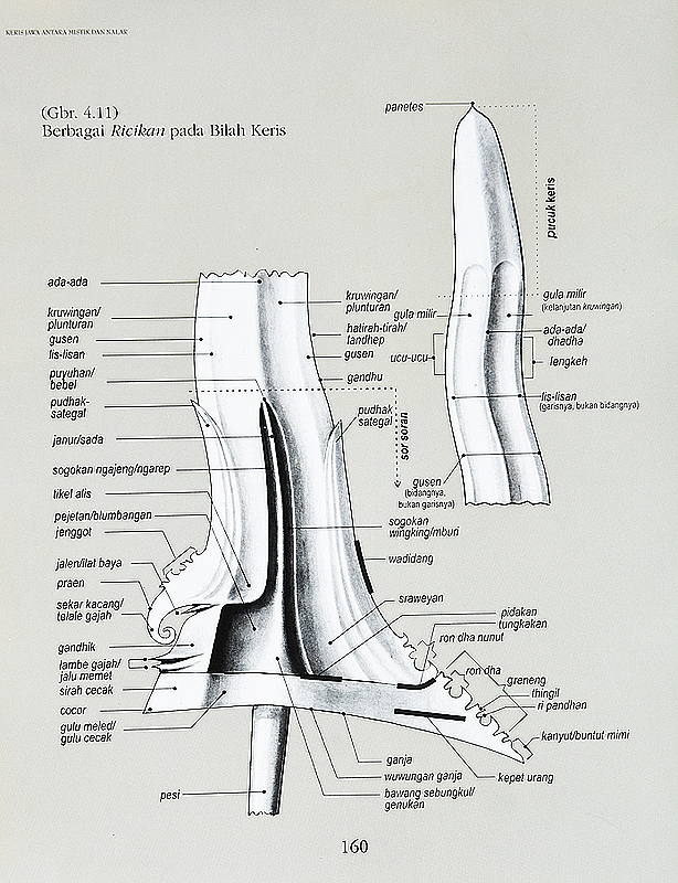

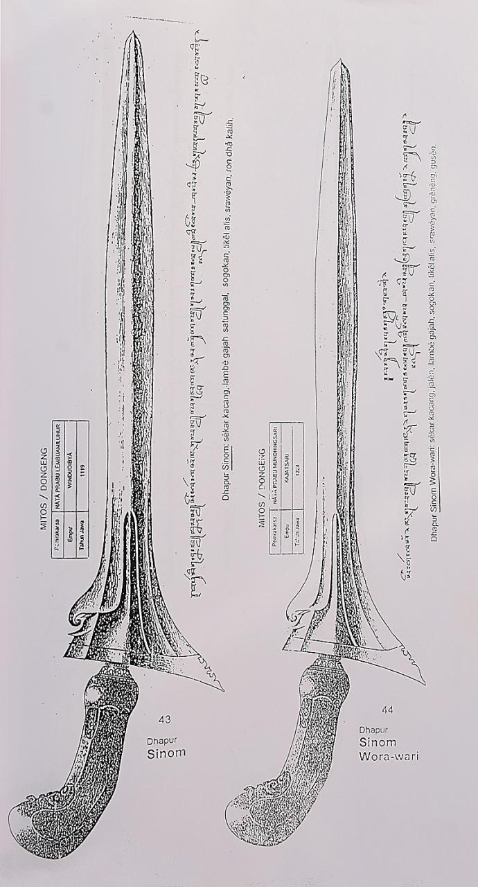

Look carefully at the details, the jenggot is obvious, the remnant rondha nunut is quite eroded, these things might have been added after the blade had been completed. Just little things, but if it strays from the pakem, that puts it diluar pakem, however, I must emphasize that I'm only talking Surakarta Pakem, it might very well qualify for a different name if in accordance with some other pakem.
The Surakarta is these days taken as the gold standard, but if we go through that pakem very carefully & compare with present day more or less generally held beliefs, there are a number of places where we cannot find agreement with the Surakarta Pakem.

Thank you Alan for the explanation (and the reference image - if I recall correctly these would be from the book released by Damartaji group of Surakarta citing KGPH Hadiwijaya as the source).
Thanks for pointing out the possible remnants of greneng sungsun/ron dha nunut. Curious that it has eroded like so while the remaining greneng are in such good shape.

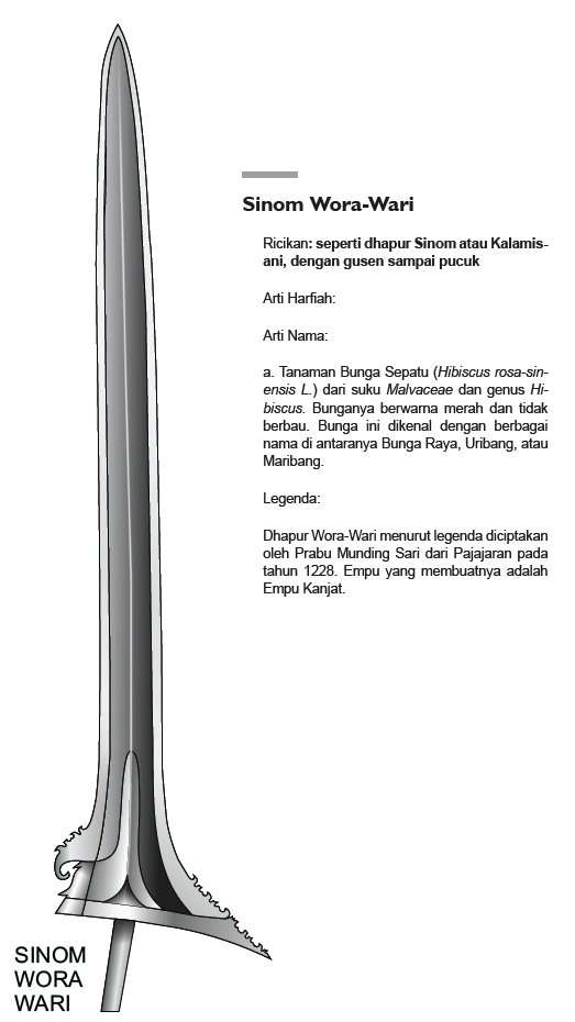

Interestingly, in a book published in late 2023 by Yogyakarta's Cultural Office (dinas kebudayaan) together with Pametri Wiji (a keris enthusiast group there) on Dhapur Keris Gagrag Yogyakarta, a dhapur Sinom Wora-Wari is pictured with jenggot and greneng sungsun (picture attached). It is not known whether the book takes reference from "official" sources in the court of Yogyakarta or more of a compilation of widely-held belief/consensus among keris enthusiasts there.

Yes, the photo I posted is from that publication, however, the publication itself is a miniaturisation of the original drawings and notes. I had possession of this boriginal book for about a week back in the late 1980's or early 1990's, it had been offered to me for purchase, but the asking price was a long way beyond my means. I photographed it at that time & until the publication of the Damartaji book, those photos were what I used.
As you have pointed out Jaya, in these keris matters, nothing is graven in stone.
